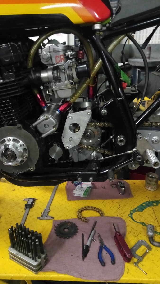

Nice work. I have the P108 on my 750 twin, nicer than the Grimeca or AP version and cheaper to boot!. What forks are you running?
Last edit: 17 Jan 2021 14:17 by DoctoRot.
- richard
- Posts: 84
- Thanks: 15
Re: Kz 750 road racer , dry clutch project
17 Jan 2021 17:52

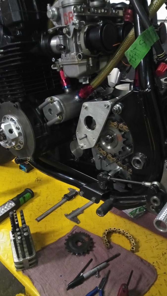

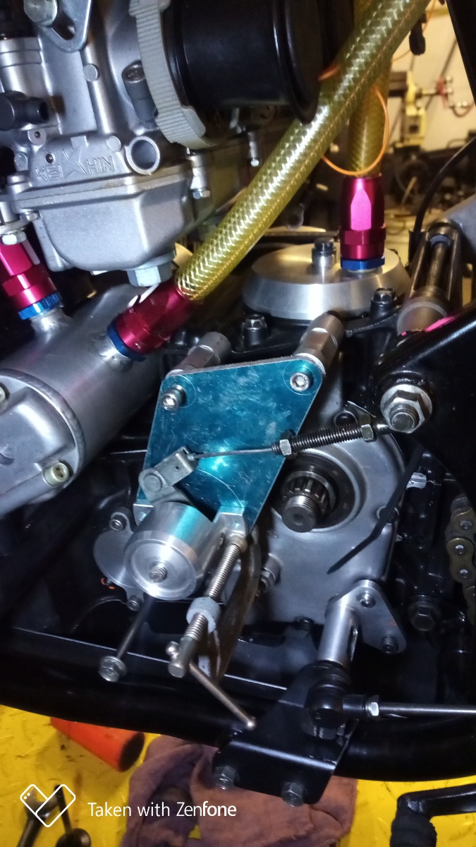

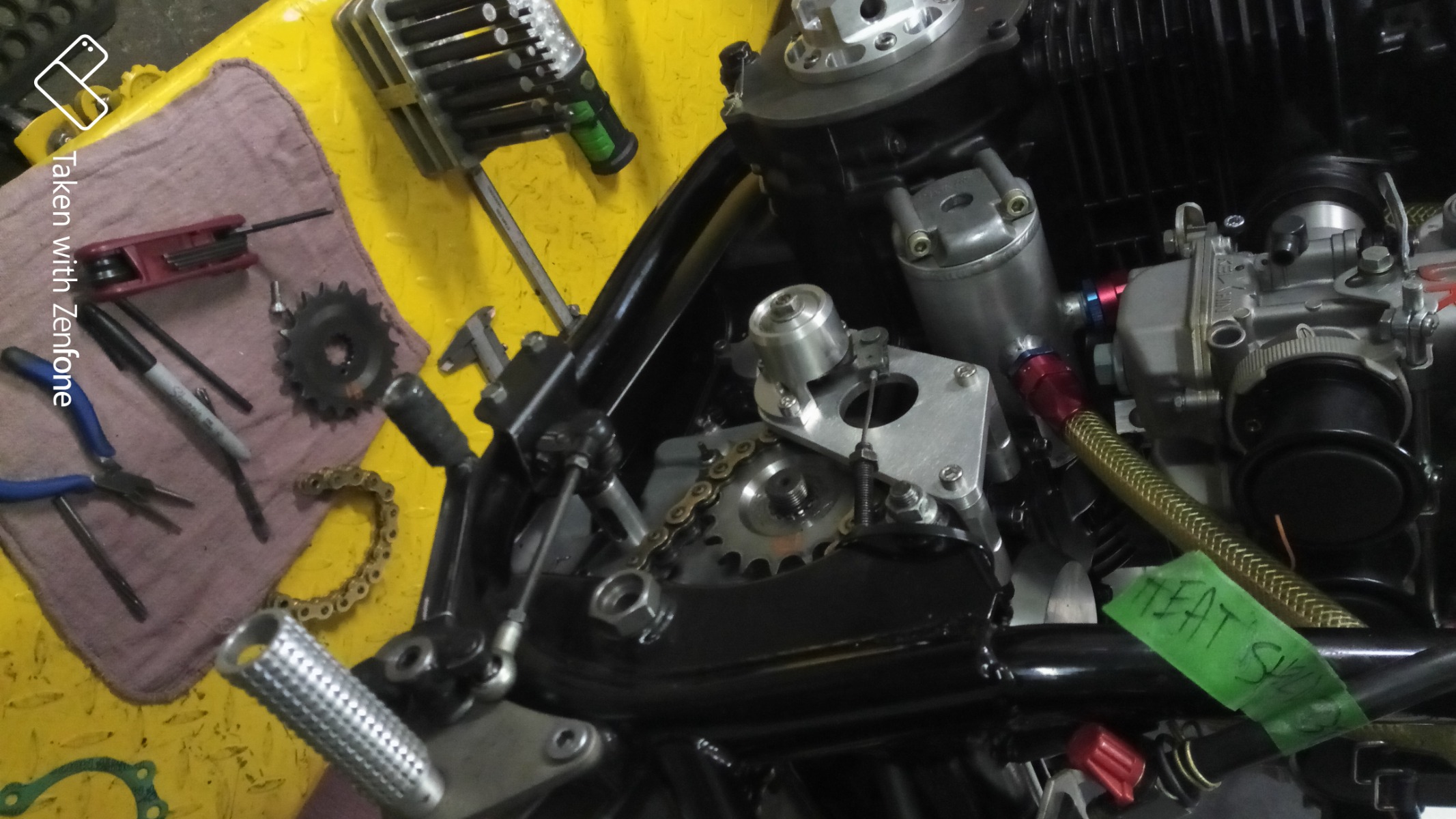

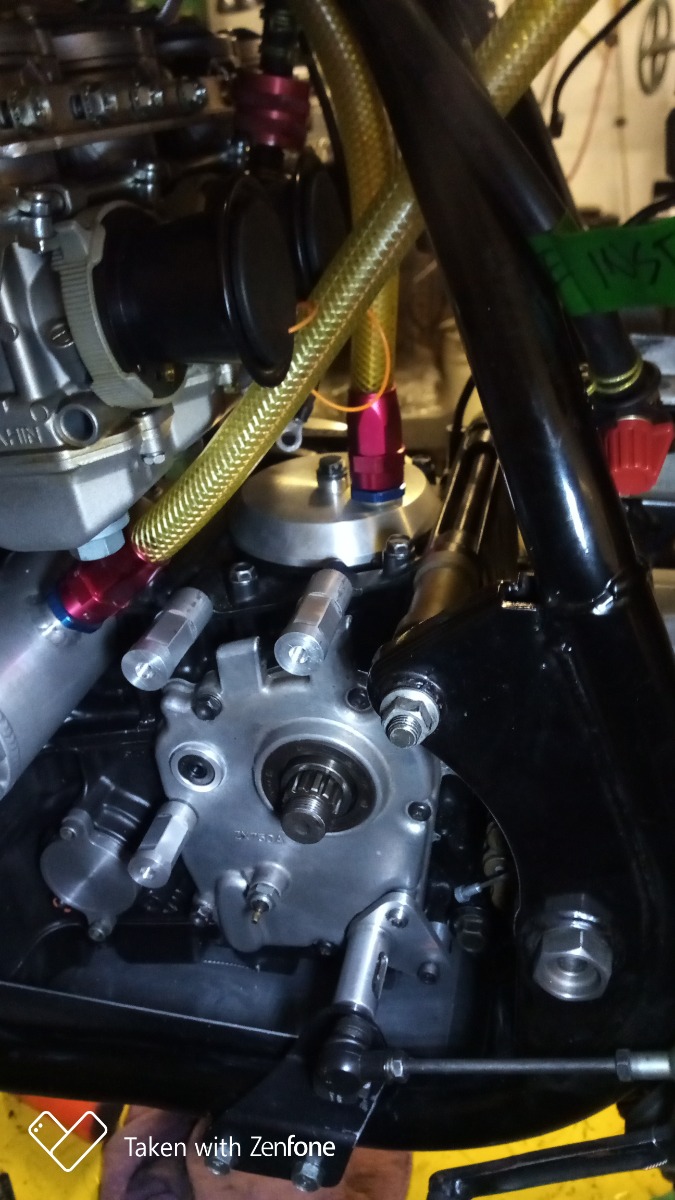

Forks are 06 Kawasaki zzr600

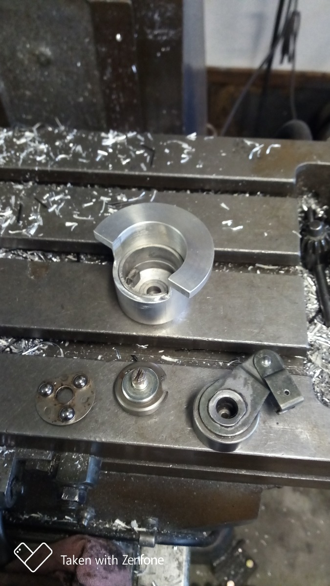

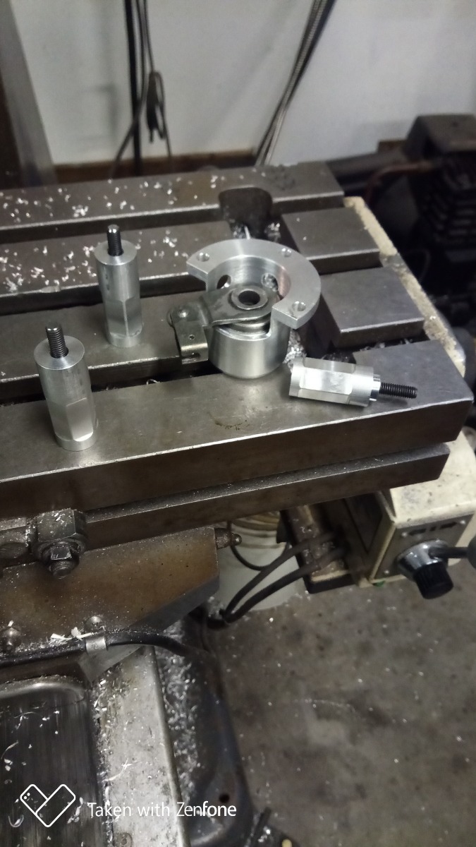

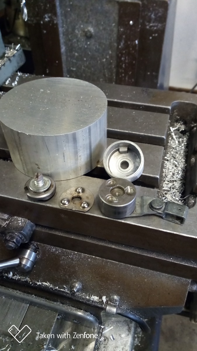

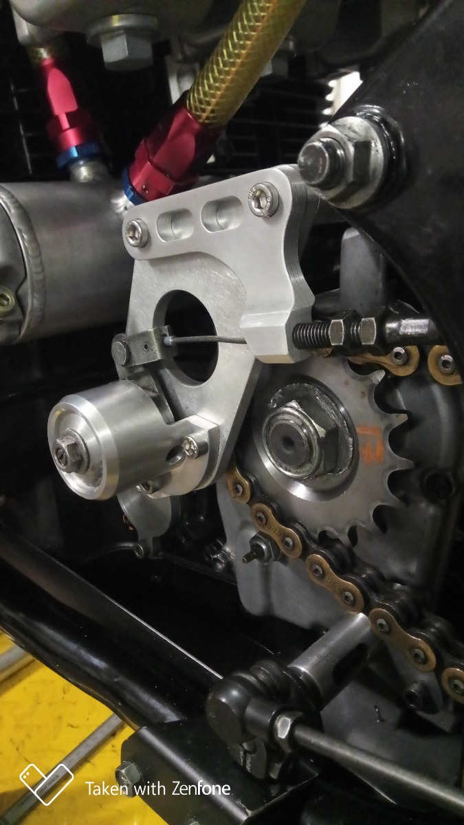

Now starting to work on the
Clutch pull mechanism,used the inner parts from a 81 kz100j sproket cover
Started will a 4 inch slug because that's all I had on hand , I bit of refinement and should be done in a few days

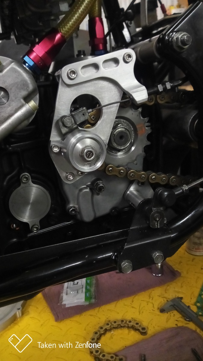

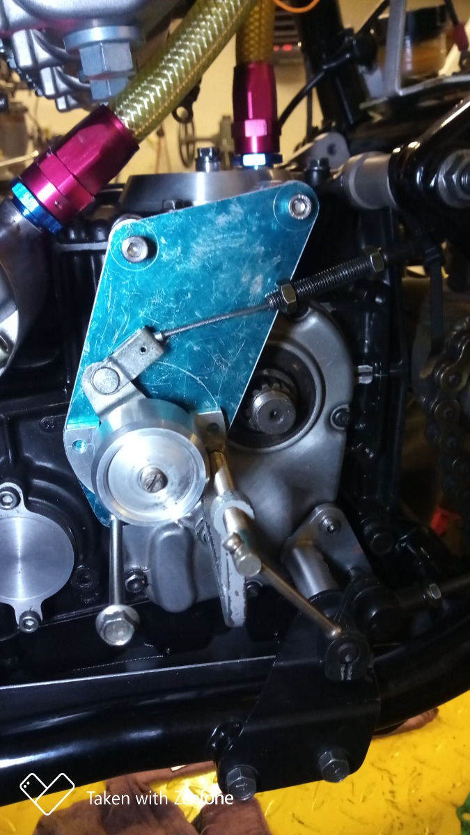

21 Jan 2021 09:30
Cable all taken care of
Will start assembly in the next few days
Hope to fire it up very soon

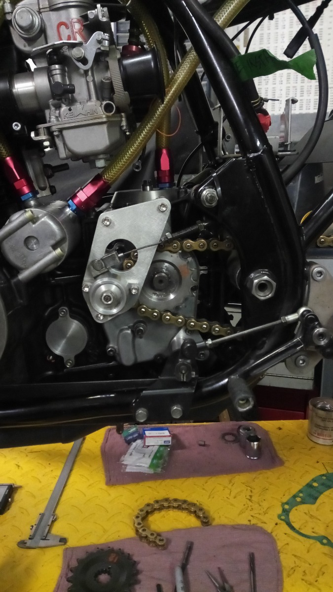

21 Jan 2021 11:33
Happy you like it
Just have to machine the through rod to length heat treat the ends then put the seals into the basket,the goal is to fire it up this weekend

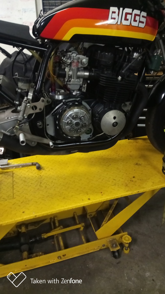

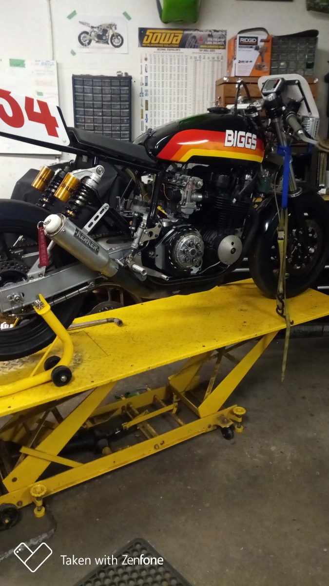

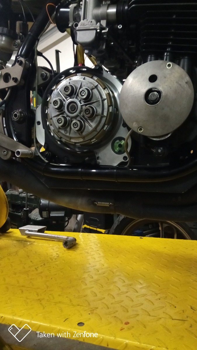

22 Jan 2021 19:22
Everything complete
Clutch pull is too hard
Will have to make an extension
Kz1000 clutch link arm is no doubt shorter than the Ducati unit causing the problem
Oil in the bike ,just need some fresh gas and a battery then hope for the best
It's too cold here in Ontario Canada
For a test ride ,hope to fire it up this weekend just to hear it
