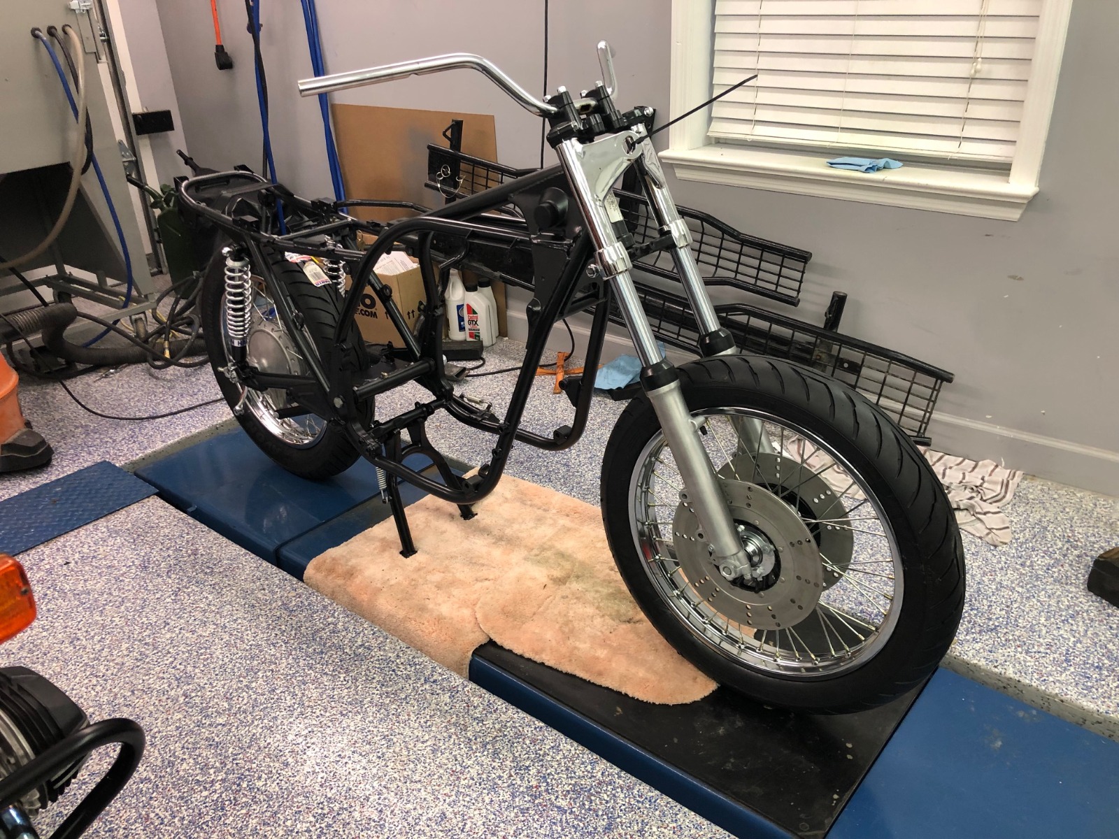

Re: Katit's 1978 KZ650 project
08 Aug 2022 18:17
Looking like a roller. Just loosely assembled, but it's portable now. Ready for engine.
Brakes assembly in progress
08 Aug 2022 18:31
It’s a roller! Not picking but want you to be safe, and maybe this is just your “assembled loosely” but your front axle clamp are not correct. The front nut gets tighten first, then the rear leaving the gap in the rear.
08 Aug 2022 19:05
Hey! I appreciate it. Also it is loose assembly- I want to know about things.
when I do final - I read book for torque values so it probably will be mentioned there. But anyways- reason for posting all the pictures is so people see and perhaps notice stuff.
on brake disks I did final torque on bolts but didn’t bend those lock washers just in case..

- Thanks: 2260
09 Aug 2022 02:45As Mikaw mentioned, the axle clamp has a arrow mark that has to be pointed into the driving dircetion.It’s a roller! Not picking but want you to be safe, and maybe this is just your “assembled loosely” but your front axle clamp are not correct. The front nut gets tighten first, then the rear leaving the gap in the rear.
- Posts: 3136
- Thanks: 1235
09 Aug 2022 05:25
Newer models have the arrow. Older ones don't.
