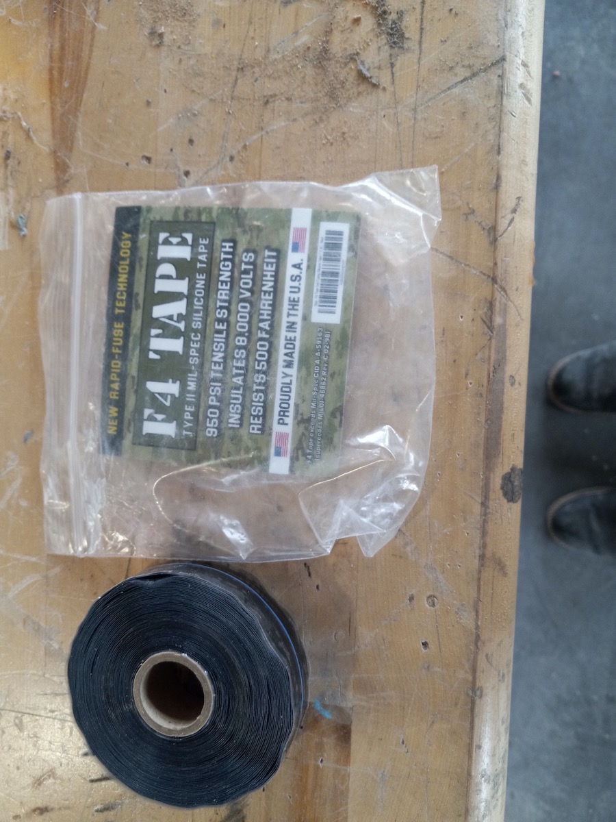

I don't recall where on the site I saw the glowing recommendation for this stuff:
but I really appreciate it. It's kind of an amazing product. There's no adhesive on it; you stretch it out (and since you can stretch it out to 300% of its initial length, you only need to cut a piece of the same length as the wire around which you're spiraling it) and through a chemical/magical process, it fuses to itself. Waaaay better than any electrical tape I've dealt with.

Yes, but you will see this tape gathering dust much better than regular electric tape. I try to use sleeving and heatshrink. I do have this silicone tape, use when needed and when it's exposed to high temperatures. But it's putting lot of tension on whatever you wrap (because you have to stretch it) and it doesn't slide as easy (because it's rubbery).

If your not picky about appearance but, need protection of your wires or whatever your wrapping, this stuff works! I've used this stuff on F-4D Phantom II back in the day. It will stay protected.

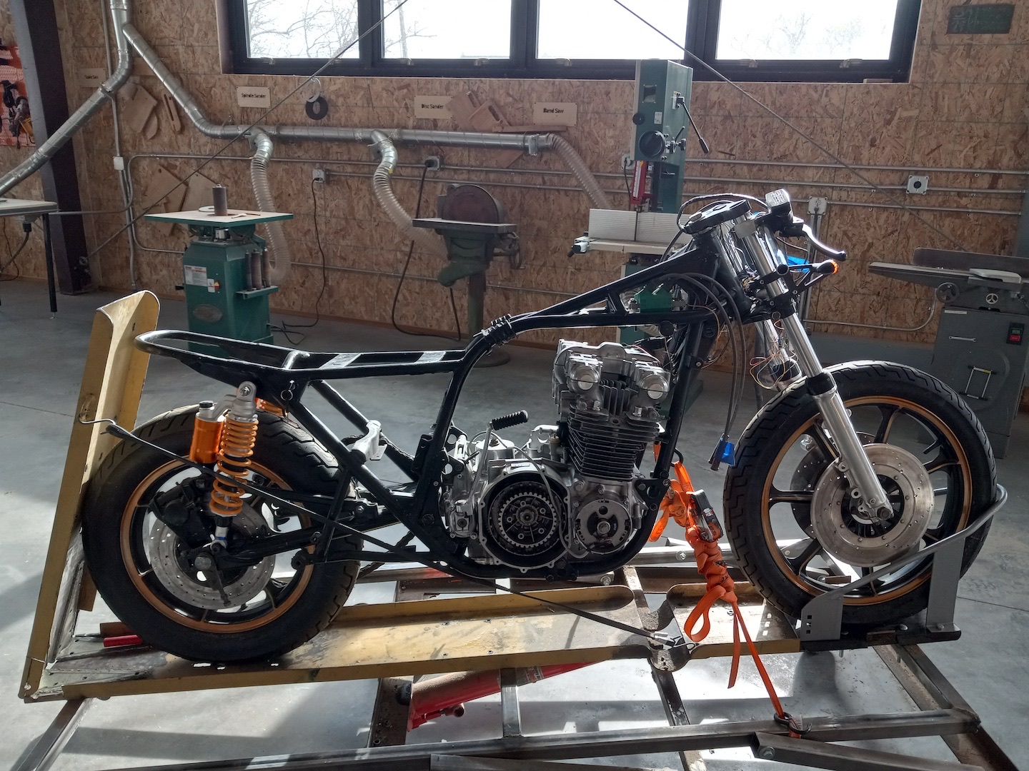

The frame and engine are finally reunited and, yes, it feels so good.

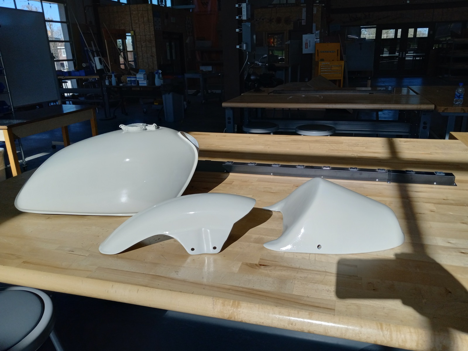

Also, I sprayed the first color on the tank, fender, and cowl. It's Chrysler Cool Vanilla, a color I like a lot that inexplicably only seems to show up on minivans.
For an ameteur paint job applied in a wood shop, I think it came out pretty well. Once this has had a chance to cure, I'll mask it and paint the main color. Ultimately the vanilla will just be the striping and lettering.
