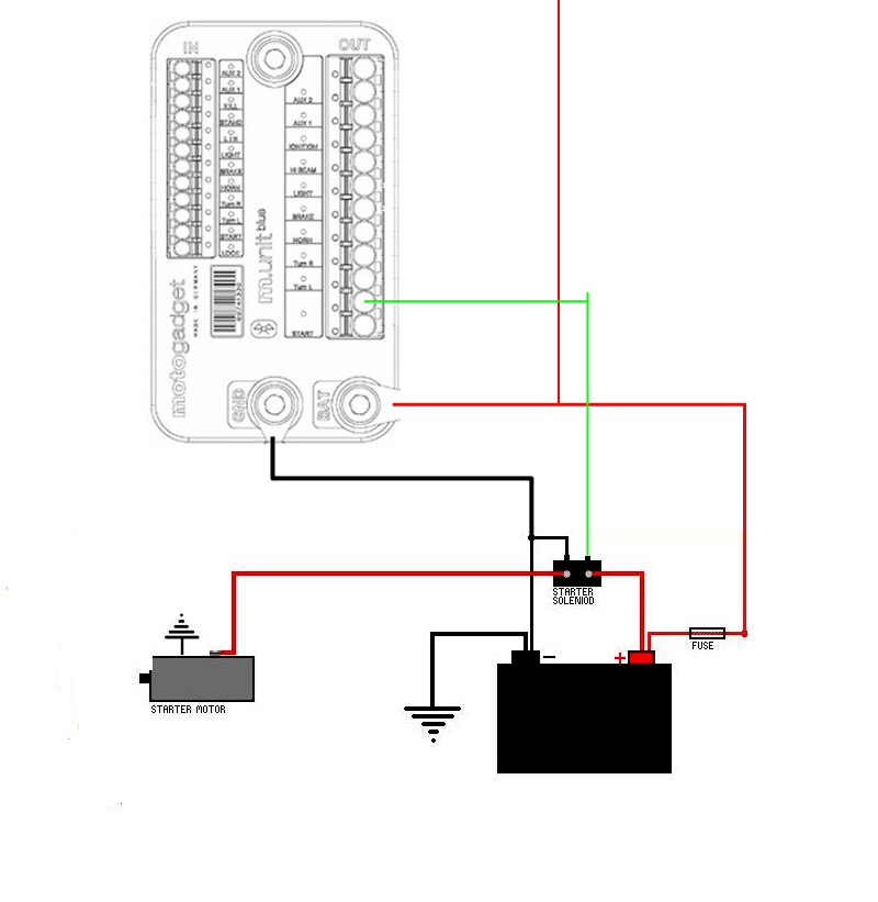

Buzz the fuse is to protect the M-unit not the starter, I have looked at a couple of diagrams and don't think some are drawn very well. You should have two wires to the input side of your starter solenoid. One from the battery, the other with a 40a fuse to supply the M-unit (this could also come directly from the battery to the M-unit as in the diagram below) The other big terminal on the solenoid goes to the starter. The two smaller terminals on the solenoid then go to ground and the M-unit respectively

Got it, thanks!I agree that some of these diagrams (particularly on Revival) are a little needlessly confusing, as they present overlapping alternative configurations and (not to throw shade) tends to favor the assumption that you're buying their solenoid rather than keeping the stock one.

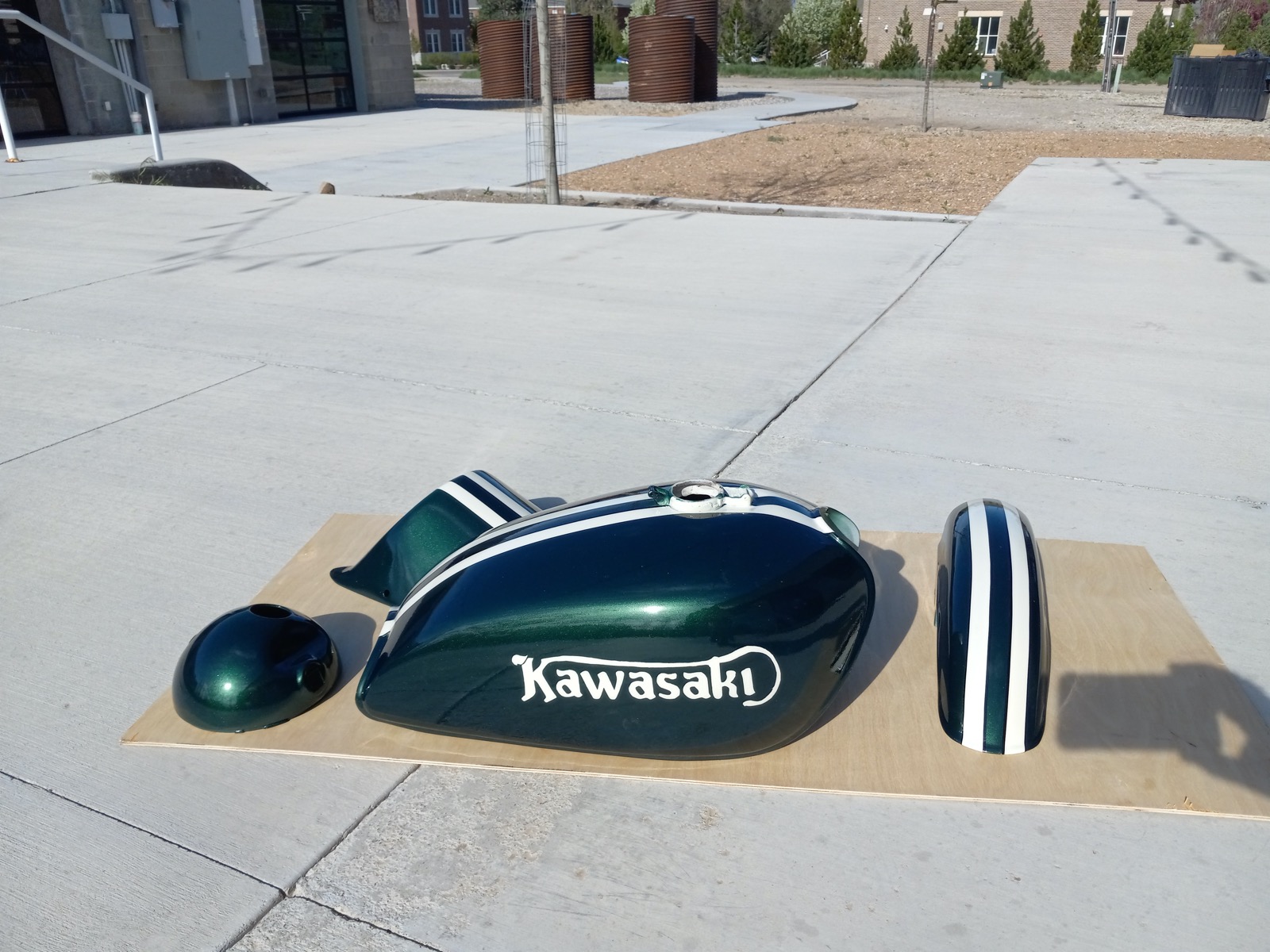

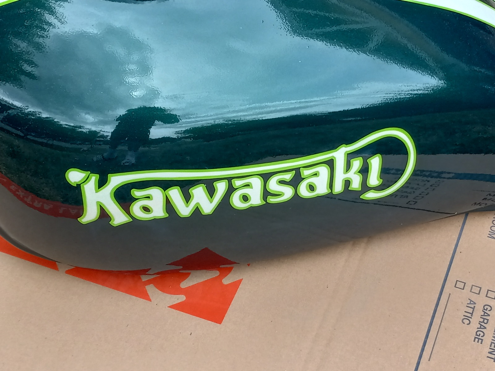

Anyhow, I got some painting done this weekend. It's not a Kawasaki color, but it is green:
My son designed the tank badge, and I think it looks pretty cool.

Looks like classic British graphic (Triumph, Norton etc) which is after all where the whole "cafe" genre started with Tritons etc. At the end of the day the input from your son will come back to you every time you look at it.
- Buzz Nichols

I'm already getting that paternal glow from it

Nice paint/logo work. I was going to say it looks like a throwback to a Norton script but Wookie beat me to it!

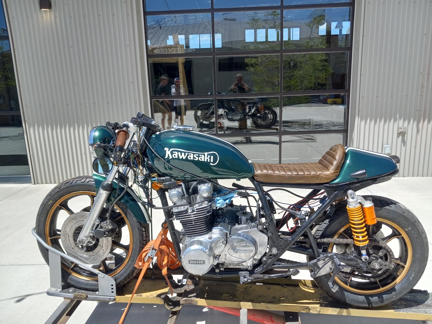

The wiring is done!
I've still got a lot of work to do (wrapping and securing the wiring, setting up the brakes, reassembling and installing the carbs, etc, etc.) but I couldn't resist rolling it outside for a quick photo session

Thank you so much—still lots of work to do, but it's starting to feel like I'm on the downslope.
I'm thinking my next project (I've got my eye on a nearby Z1R in black) is going to be a lot more "resto" and a lot less "mod." Still, this has been a great experience.
