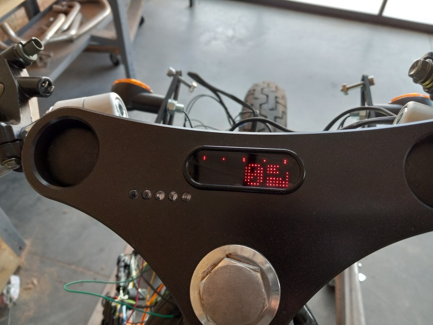

Thanks. I'm still waiting for my 6 gauge wire to show up so I can finish my wiring, and my cup gun shat the bed, so I can't blow paint (although I've finally got everything mudded, primed, sanded, and ready to squirt!) so this was most of my weekend. I feel like I've made some real advances on a skill I totally lacked 48 hours ago, so I'm going to chalk this weekend up in the "W" column.

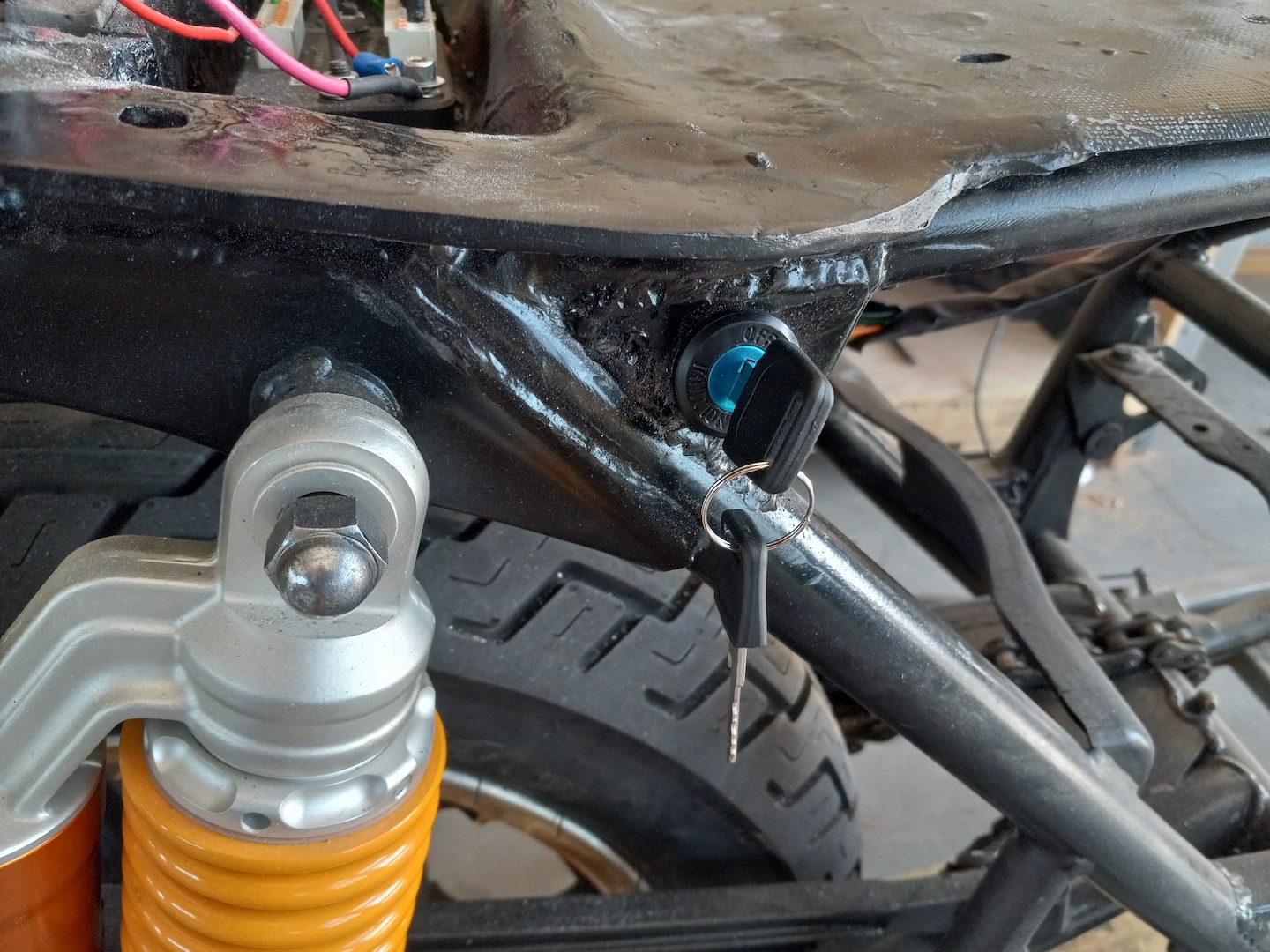

I've been drilling some holes. I found a nice spot to stick a key switch:

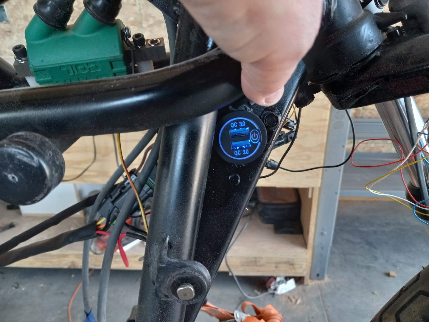

...but, since the real key to the bike with the M Unit Blue is my phone, I figured I ought to also do this:
Seeing that light up made me smile, but I outright giggled when I got to see this light up:
...And that needs a momentary switch to configure it, so I drilled yet another hole for this very discreet little fellow:
