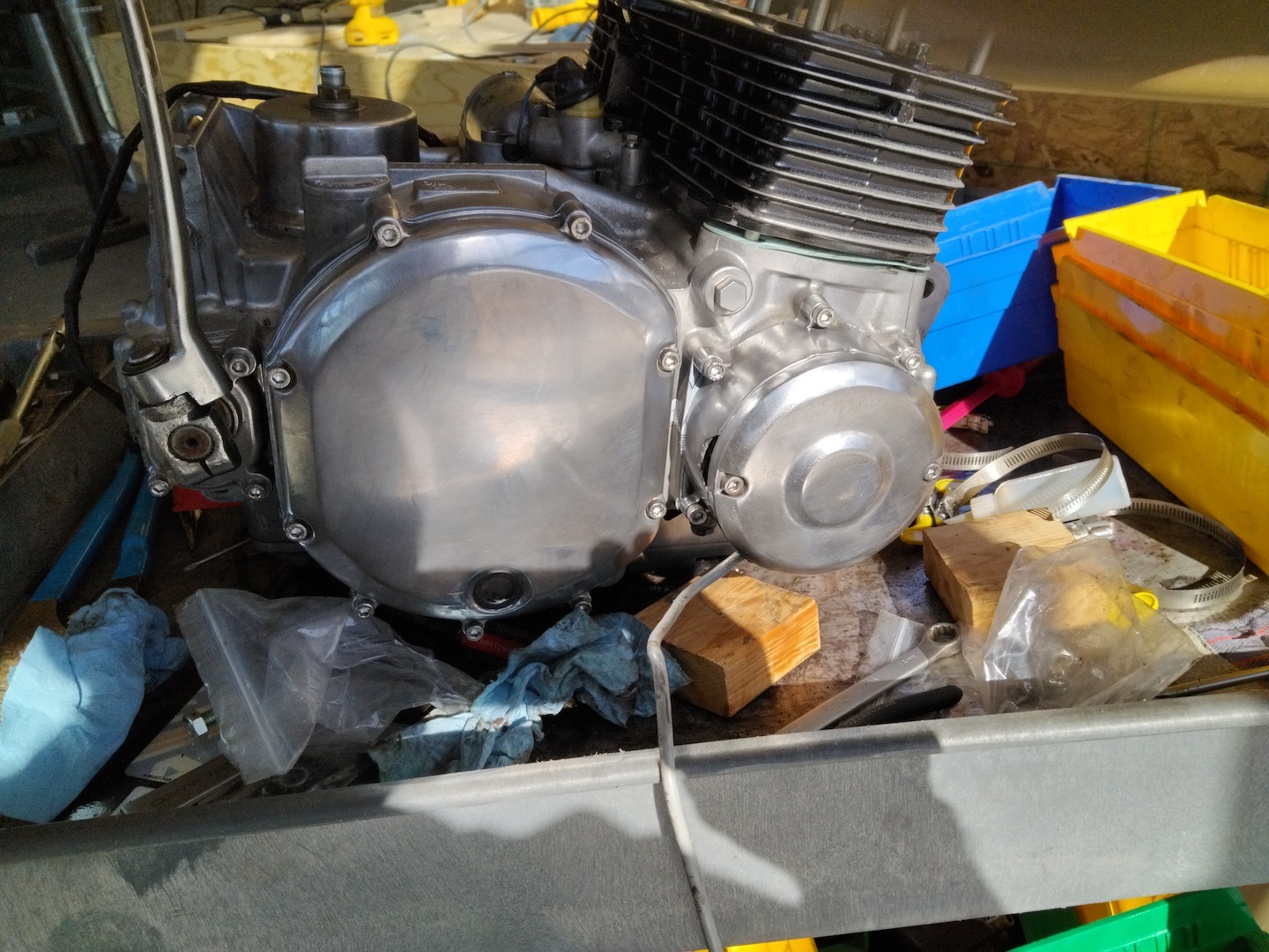

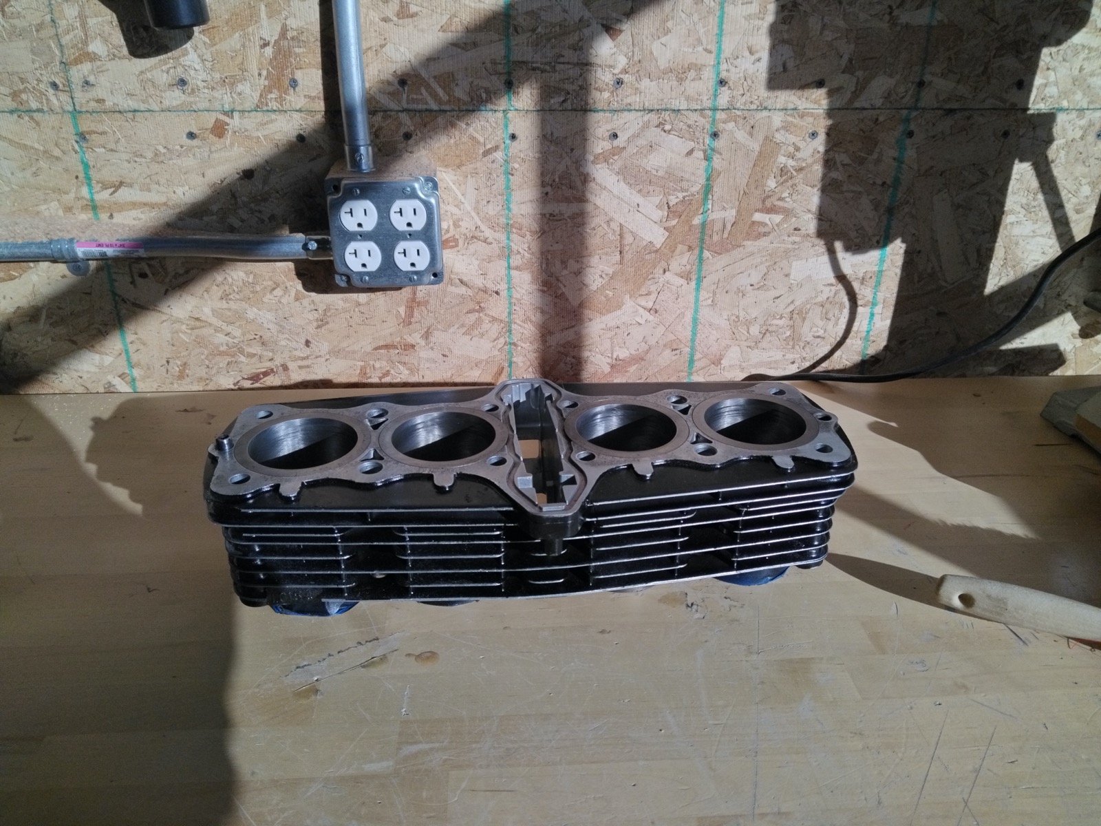

I decided, as long as I had it apart again, I might as well tart up the cylinder block with a little high temp paint and a bunch of sanding. Get a load of those jugs:
I'm pretty happy with how it turned out, and my parts just arrived from Liska, so now I can build the whole motor.

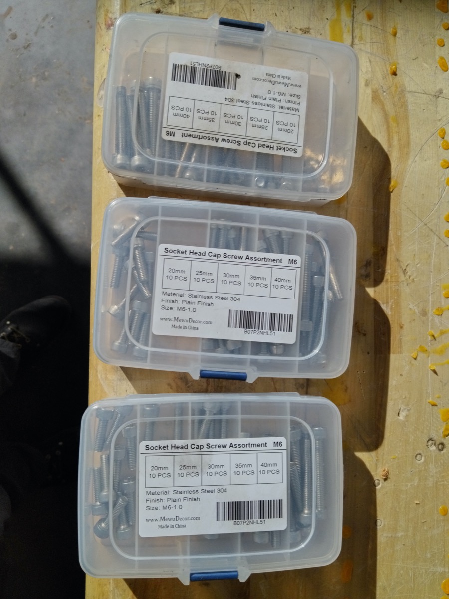

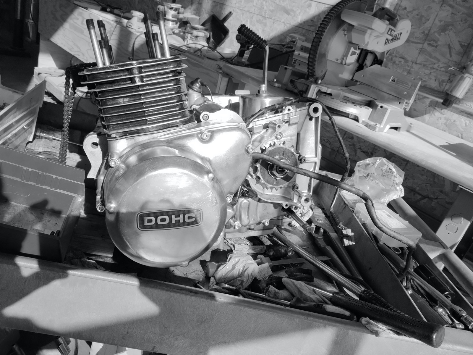

A colleague at the school I work at was going through the old inventory for our robotics program and brought me about 10 of these boxes, dismayed that we were saddled with so many of the same size machine screw:
I quickly assured him that I could find a good use for a whole bunch of them:
Apologies for the artsy B&W picture; I'm still getting used to my phone.
I'm not sure how much it would have cost me to buy that many stainless 6mm socket bolts online, but to do it at the local hardware store (the only game in a rural Utah town) would have required a 2nd mortgage. I'm so happy that I no longer have to overcome dozens of 45-year-old JIS screws to get into this engine.

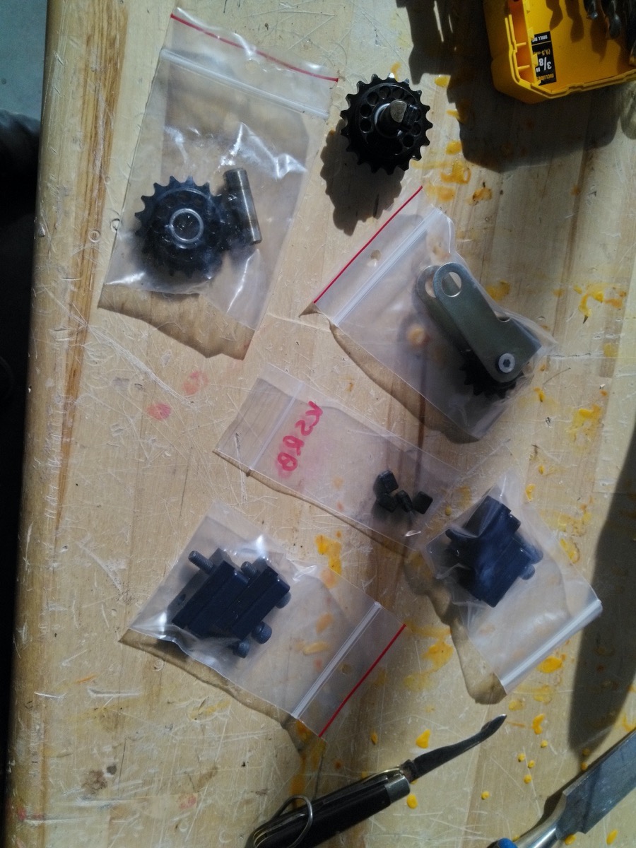

I received a perfect cardboard cube in the mail today:
And it was full of timing goodies from Liska
It looks like I'm out of excuses to not put the motor together.

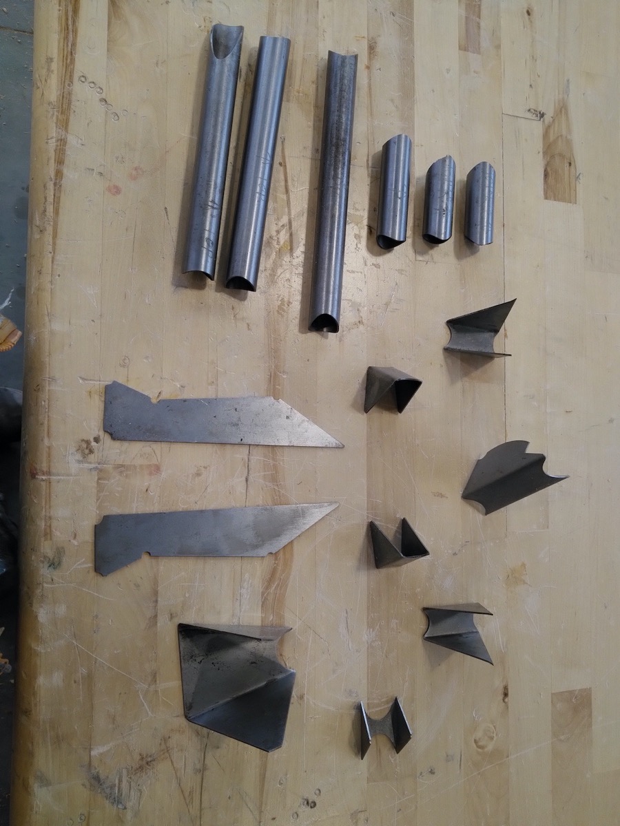

In anticipation of future horsepower, I got the frame brace kit from Half Evil
There weren't any instructions, but I slowly realized it didn't really need any. Each piece is scribed with "top" and an arrow. Again, I was a little slow to realize that the arrow meant that should be the direction of the front of the bike. Most pieces can only really fit one way, and the tube steel parts mostly fit just by jamming them where they go (no magnets or vise grips). Overall, I'm impressed by the fab work of this kit.

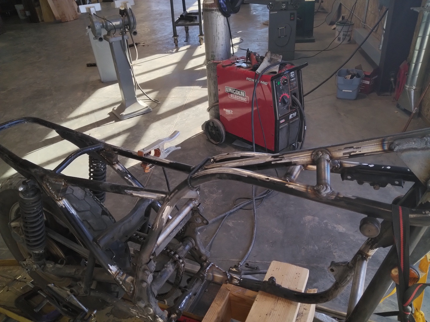

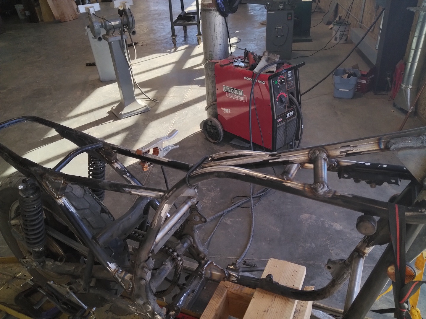

I'm in no danger of being mistaken for a welder, but I did get good penetration, and anyhow that's why I buy the family pack of flap discs:
And on we go.
And on we go.
