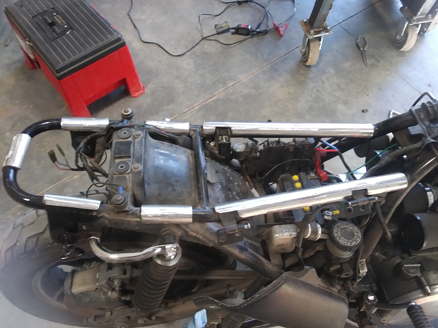

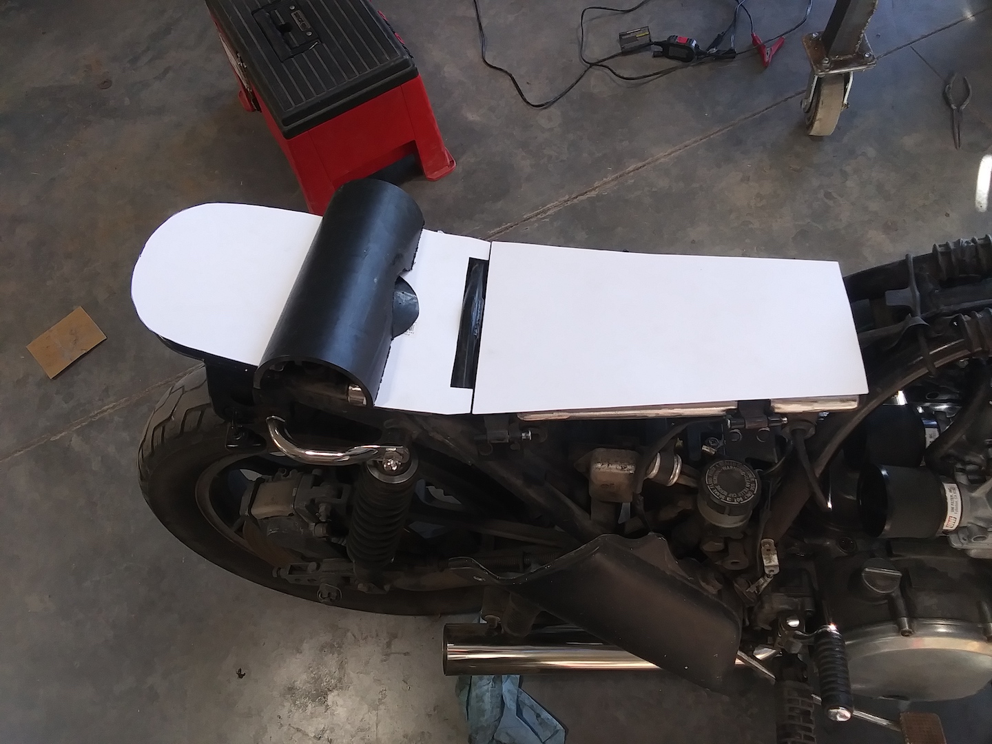

Somewhere there must be a "How to customize a motorcycle" website where it says "Step 1: remove the back fender." Whoever is behind that foolishness needs to be stopped. But I digress.
I don't think I'll be able to fabricate a good looking ducktail without pulling a mold off one—and I don't have one. Therefore, I think I'll make a simple bump stop cowl seat, It's entirely possible that could look stupid on this bike, so I'm going to make it so it mounts onto the existing hinges. That way, even if I do like it, I can always swap it out for the original seat. So, here goes:
I had some steel pipe hanging around that had the same ID as the OD of the frame rails:
So then I did a little CAD (cardboard aided design) work:

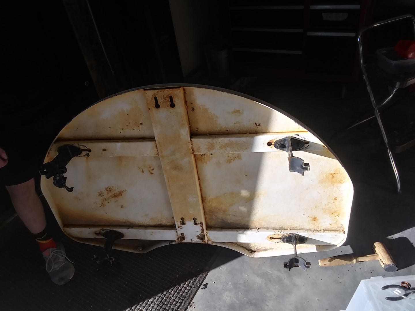

That got around the inner fender. I mocked it up with a piece of ABS, but I didn't have any suitable steel tubing, and ultimately decided it would be better to build a flat bridge out of sheet metal. I harvested the metal from this old backboard:
It's pretty darned heavy (12 gauge), but it's free, and it's got convenient 90 degree bends all around it—a real bonus for a guy without a metal brake. So after a bunch of cutting, grinding, and welding, I came up with this:

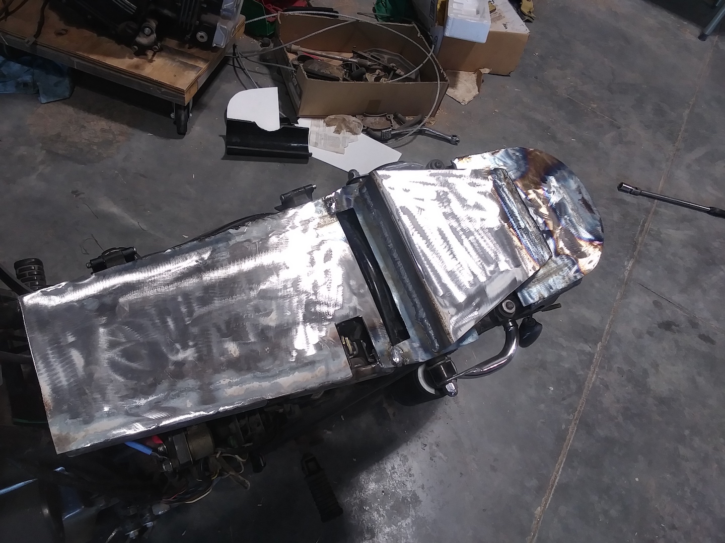

Then I made a mount for a tail light and made some hinges with 90 degree backboard brackets and a few old bushings I had hanging around:

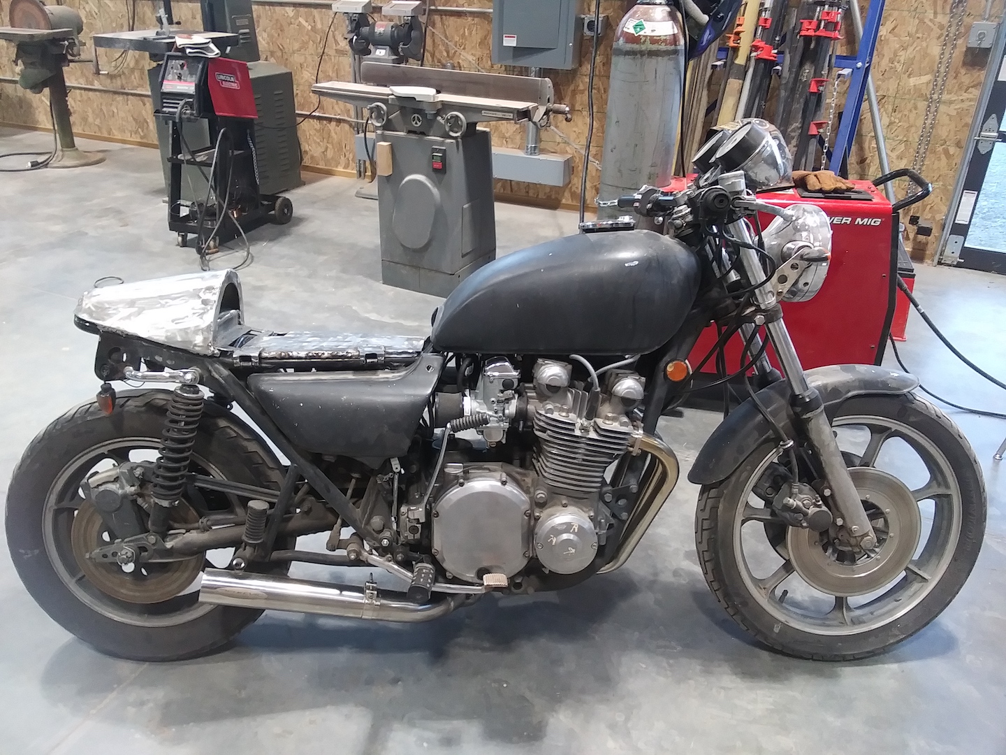

I climbed on and decided the front of the little sheet metal "bridge" was a good (and convenient) location for the bump stop, so I mocked it and a cowl up with a piece of 1/4" plywood, some poster board, and painter's tape:
It's getting to be way more of a cafe racer aesthetic than I had originally intended; I'm no purist about that stuff (or much else), but I usually think bigger bikes tend to look a little odd cafe'd. Still, I gotta say, I'm pretty happy with how it's looking. I'm also happy knowing I can pull it off and put the old seat back on if the finished product underwhelms me. Moreover, even if I do like it, I'm likely to snap up an original fender and tail piece if they crop up, and I think it's kind of cool that, with minimal work, I could have a totally different looking bike on short notice.

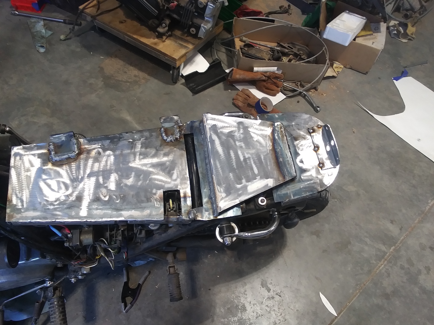

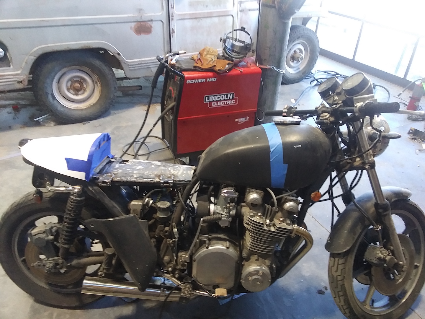

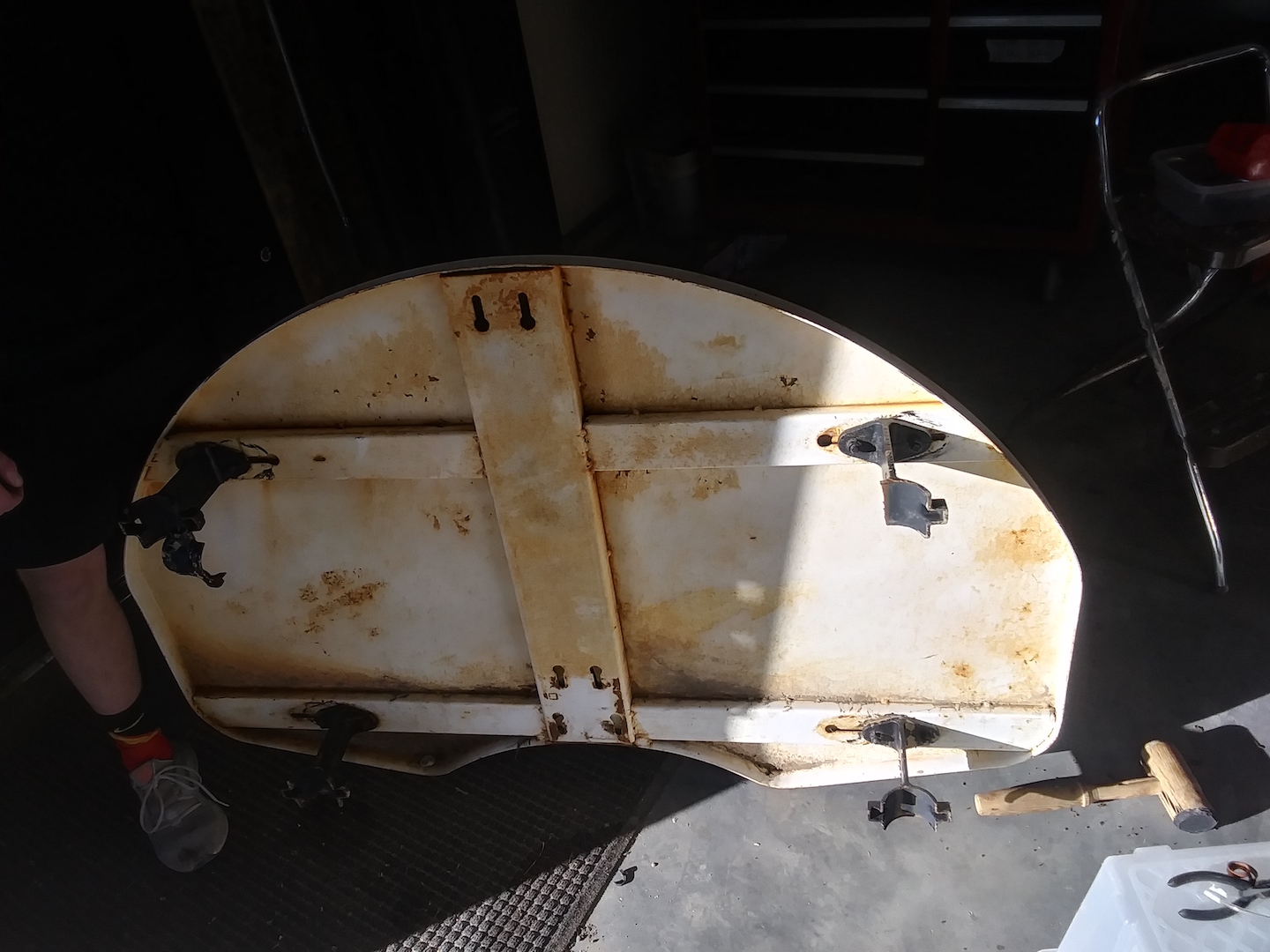

I didn't really need a reminder that I'm not much of a welder, but this cowl was exactly such a reminder:
I formed it from a piece of thin steel I found in my backyard; I think it might have been a panel off of a defunct swamp cooler. It was thin enough to bend with main strength (I don't have a slip roll, an English wheel, or any cool stuff like that) and, really, too thin for my big mig welder. Unfortunately, I just discovered my little mig welder is in need of some attention before it's once more operational. The upshot was, a little welding and a ton of grinding. Still, I'm digging the look so far. I reckon I'll find an old camp mat (I know I've got several) and some upholstery—maybe an old leather jacket, if I can find a 2nd hand store that's open despite the pandemic.
I'm thinking plywood with countersunk carriage bolts to attach the upholstery to the horizontal panel (which I made to attach to the stock mounting hardware) and upholstery attached to plywood with rare earth magnets epoxied into mortises (so I don't have to figure out hinges or anything) for the bump-stop. If anybody has better ideas or insights, I'm totally open to that.

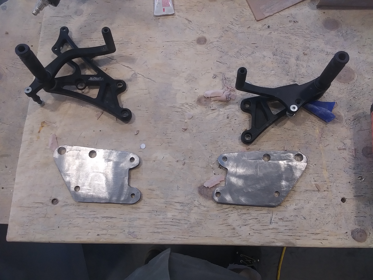

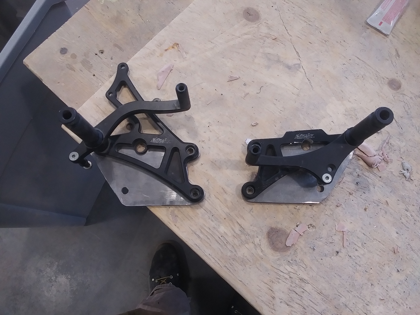

Been busy for a while, but I've managed to do a few things recently. For one, I decided to quit complaining about the PO having removed the center stand and instead take advantage of it, as it provides another mounting point for rear sets. I made these mounting brackets from 3/8" mild steel and drilled them out to bolt on the the mounting points for the pillion pegs and the center stand:
I've had this set of Valter Moto rearsets hanging around for years—somebody bought them new and decided he couldn't use them, so he put them on Ebay for $50. I bought them, figuring I'd find a use for them eventually. Here they are on the mounting plates:

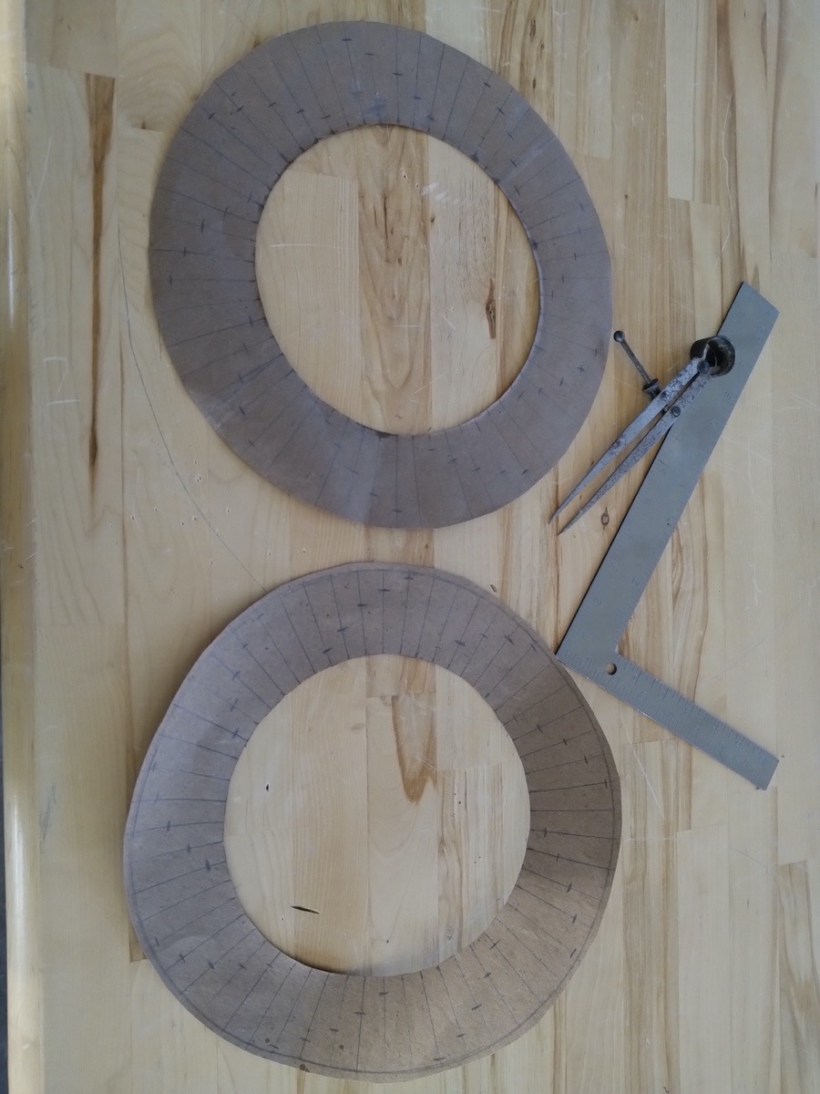

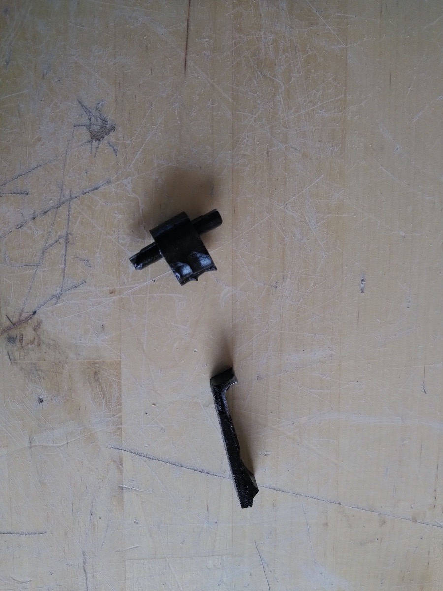

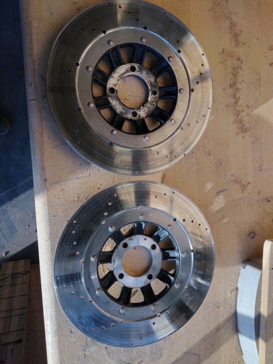

I had a sudden, uniform drop in compression (mid-60's) so I bit the bullet and tore down the engine. This is what I found:
...and pretty much the rest of the timing system is junk. I'm waiting for stuff from Liska and from Z1 Enterprises. Meanwhile, the case halves, cylinder block, and head are off to be vapor honed. While I waited for that, I decided to do a little arts-and-crafts
to inform a little drilling
I didn't intend the innermost holes to be on the shoulder of the disc (I rubber cemented the templates to the back side of each disc so it could sit flat on the drill press), but I'm hoping they'll look cool once they're on the bike.
I've done a bunch of other stuff, but I won't be near the shop until after the weekend. I'll post pics and seek advice then.

Hi great looking perforated disks, So 70’s! Love the spiral hole pattern. Some will add about chamfering the holds, as they know more that I….
