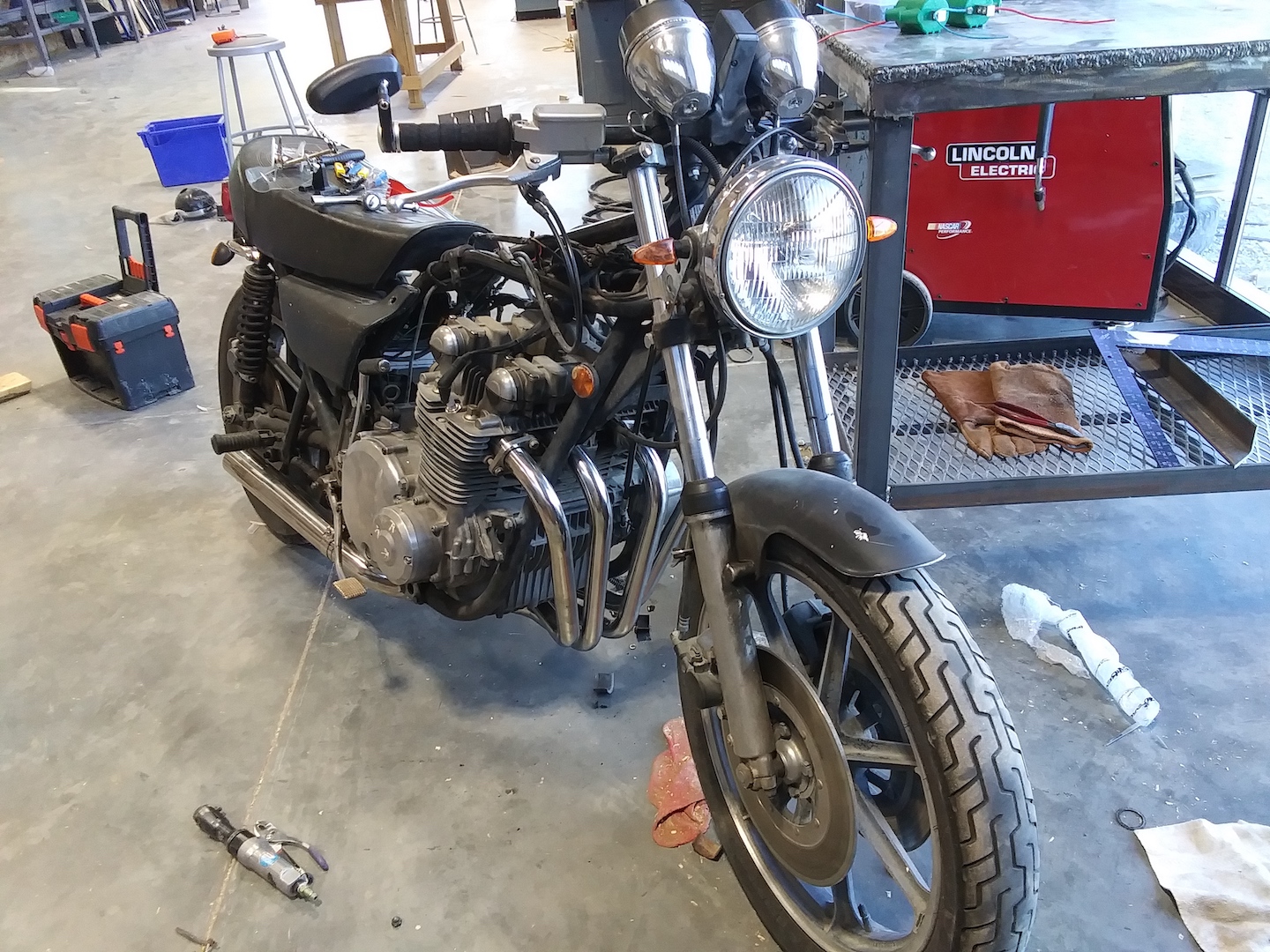

Those handle bars look like something closer to drag bars. A superbike bar will have about a 2.5" rise and more pull back. IMHO i think the superbike bars complement the stock footrests quite well, and the taller rise will help with your too long cable issue. Personally, I would try to get the bike running and driving with the minimal amount of work at this point since its not too far off. Something else could enter the picture and the bike could need a top end rebuild or something else. No point on spending money on frosting if you don't have the cake!

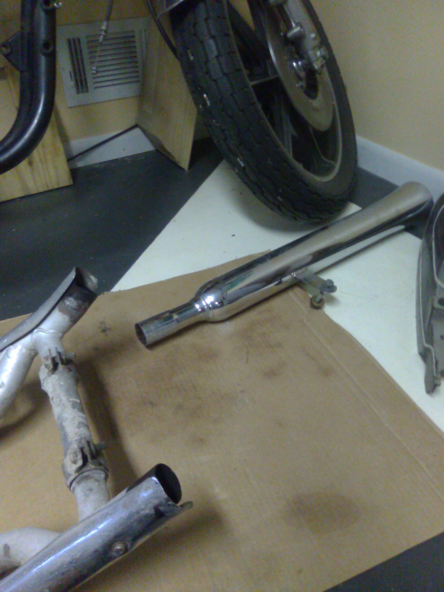

I've already ordered up son 4 into 1's and feel fine about them, but I'd like to be enlightened.
The pipes where they are cut off are enormous—66 mm id. It seemed to me I'd have to go through a couple steps of reducers to get to a diameter where slip-ons would work. Am I missing something that should be painfully obvious to me? It wouldn't be the first time.
You should be happy with the Delkevic,
the pipes are cut off before they flair out, mine are cut 3 inches past the cross over , I wish they were a half inch longer but they work fine, I butter them up with silicone before I slide them on the mufflers (no exhaust leaks)

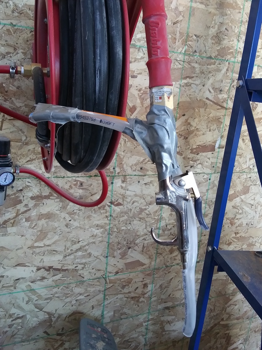

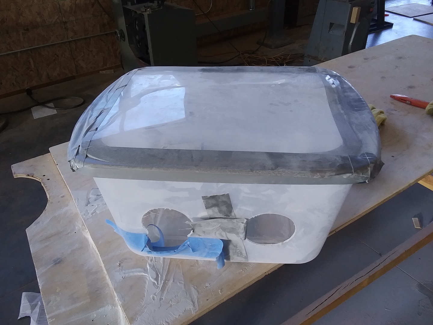

I totally realize this is going to sound and look like one of those dumb Youtube videos with a title like "amazing life hacks," but I decided before I sacrifice a toothbrush (and hours of my life), I'd try to make a soda blaster out of household (shop-hold?) items. After a few minutes on the interwebs, this is what I came up with:

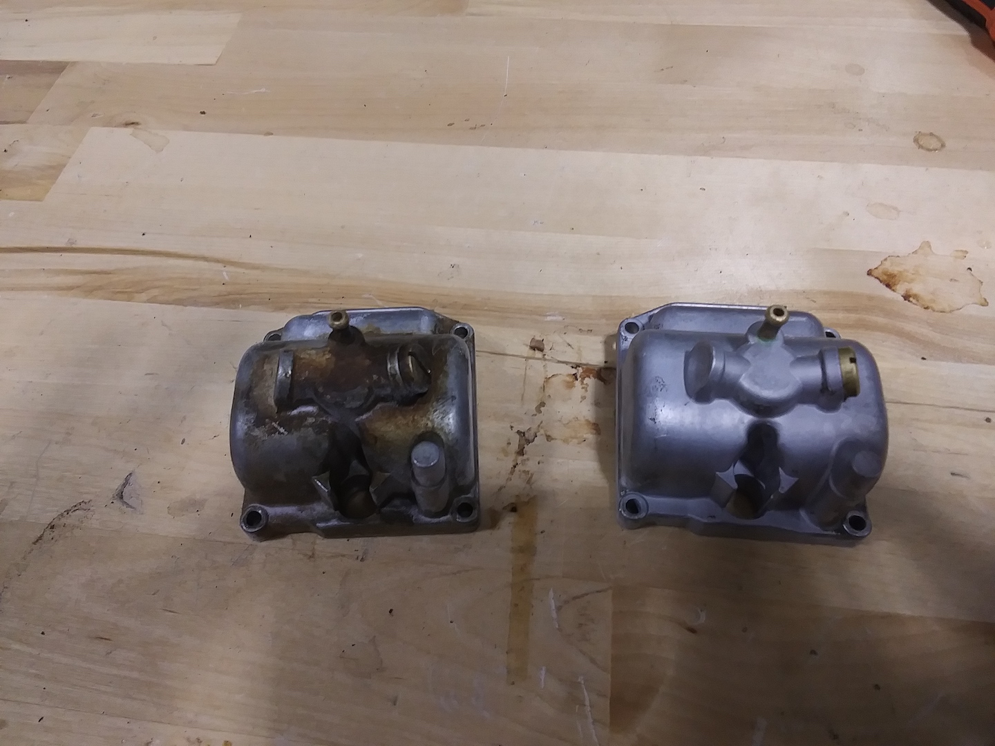

I stuck the end of the tubing with the pencil taped to it (for rigidity) in a box of baking soda and sprayed a float bowl. About a minute later I had this:

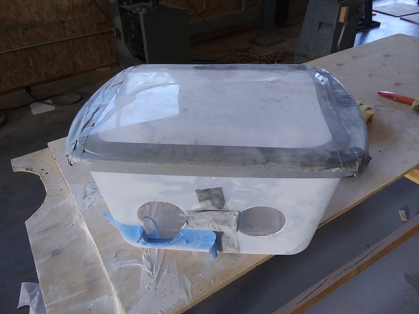

...and a giant mess all over the shop. I know; I really should have foreseen that. So, after a little light housekeeping, I raided the place for some more everyday household items and made this:
From a Rubbermaid tote with a window cut in the lid and a piece of clear Plexiglas taped on it. That not only mitigated the mess (not eliminated—I think in the future I might only use this outdoors), it also allowed me to reclaim most of the soda.
I've got no doubt this isn't as efficient as a store-bought soda blaster, and the culinary soda I used isn't as aggresive as the stuff intended as a blast medium, but it cut the time and effort of cleaning these parts exponentially. For a few minutes' screwing around with crap I had hanging around the shop, I'm totally happy with it.

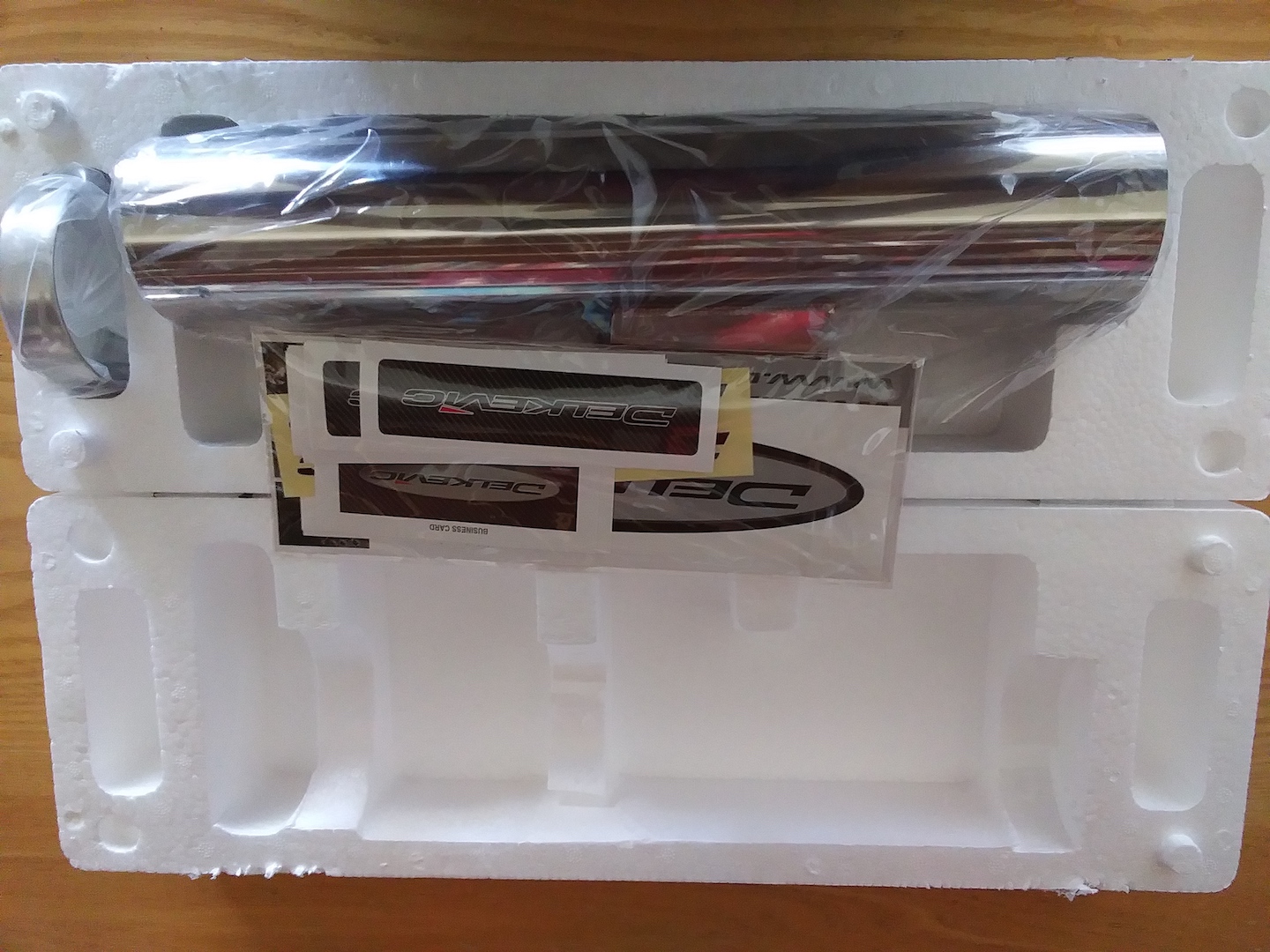

I am indeed quite happy with the Delkevic system. It shipped fast and free, and was lovingly packaged:
And the companies that make bike parts have discovered what elementary teachers have known for years. People like to get stickers:
(That might say something about the maturity of folks who like to wrench on bikes)

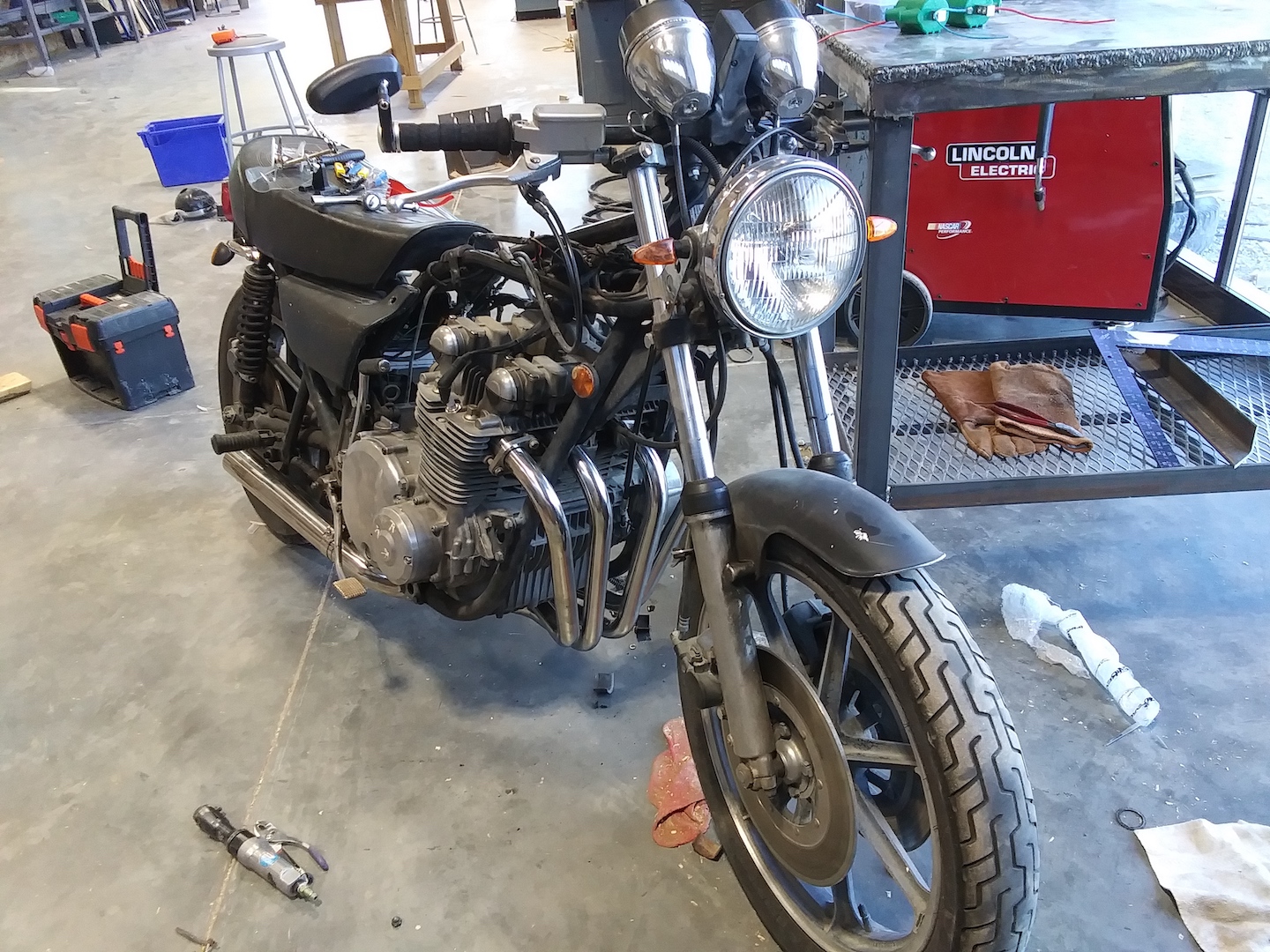

They were a breeze to install, and I think they look pretty sharp:
Now if I can just get the rest of my parts, I'll get to hear how they sound.
