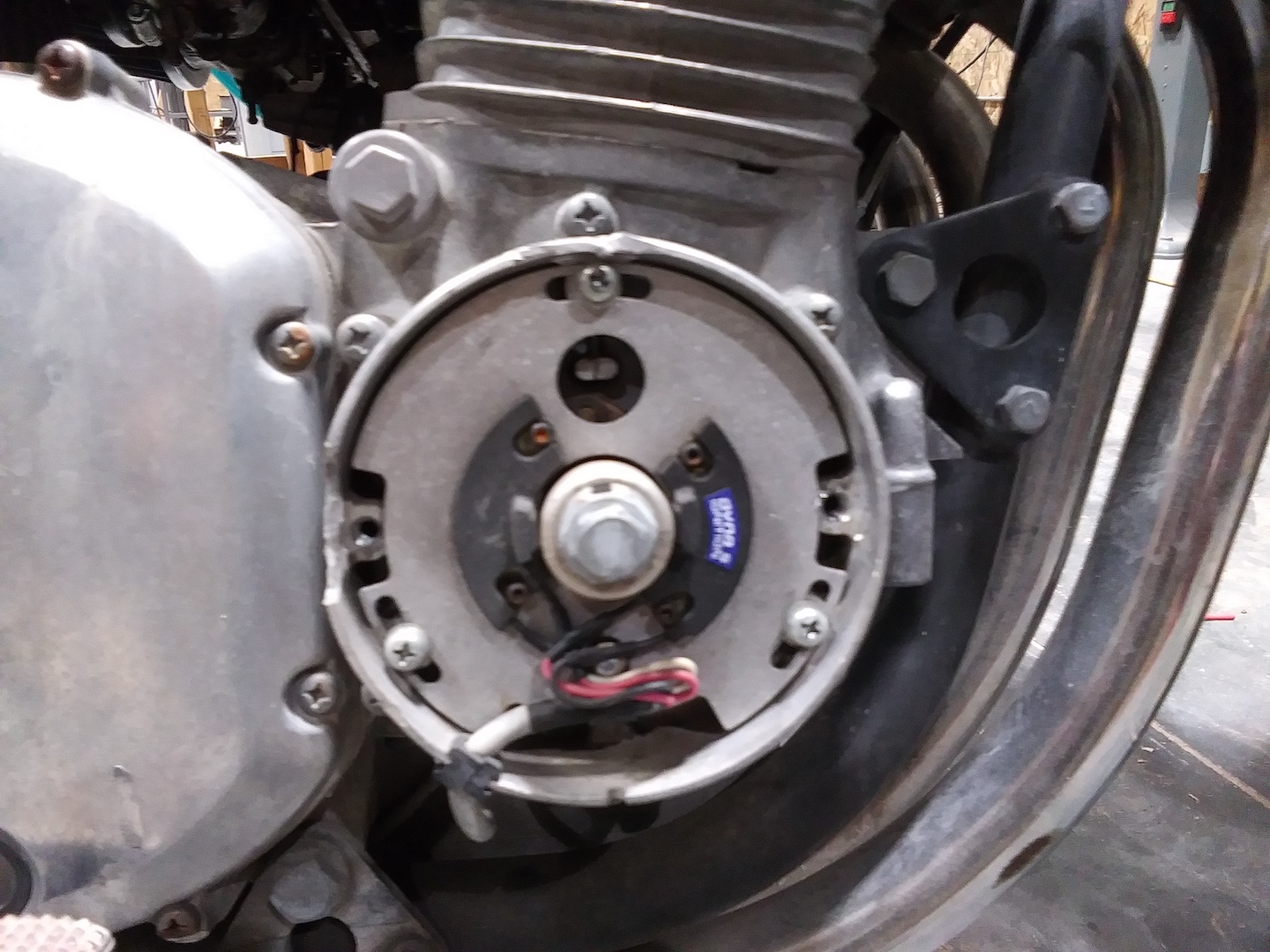

A couple days ago I picked up (for a song) a '78 KZ1000. I got it from a kid who had just recently bought it himself and then (to his parents' delight) sold it at a loss when it quit running. After a day of chasing down squirrely electrical connections, I've got it running but still in need of a lot of love. Here's the machine:

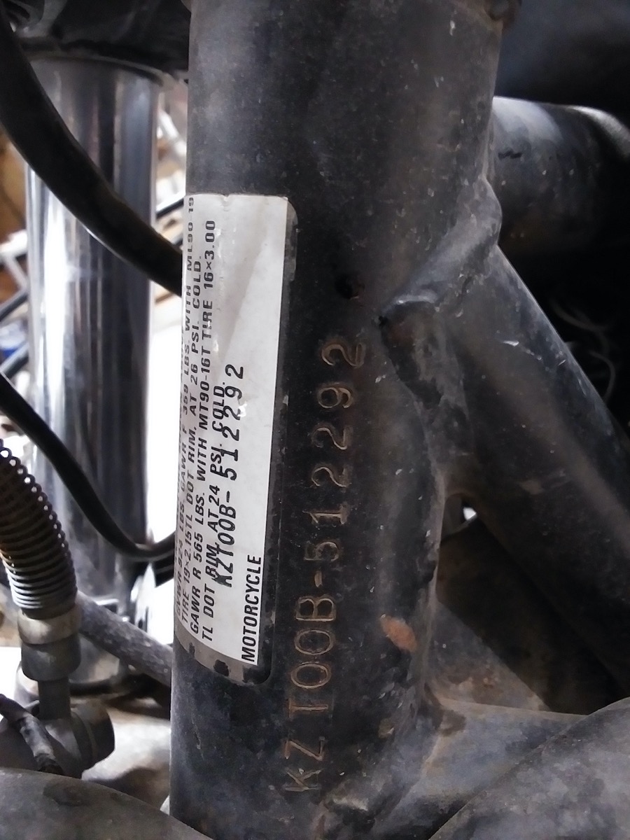

Judging by this, I gather it's an LTD:

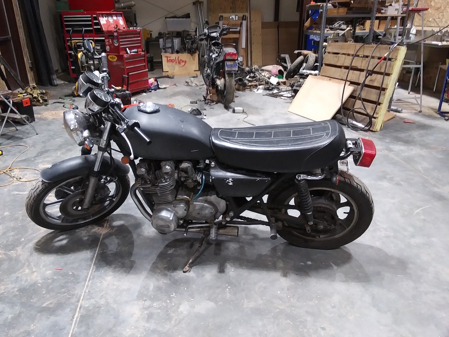

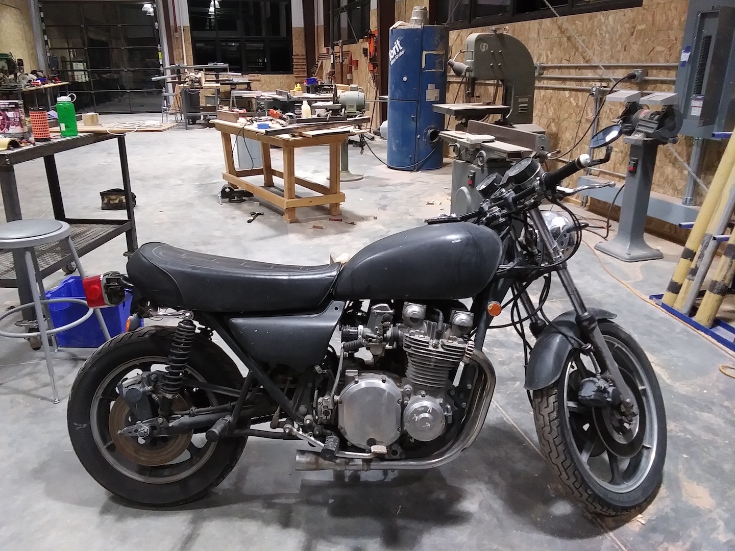

It seems like the PO (that is, whoever sold it to the kid I bought it from) was keen to do some mods, but didn't really have a defining vision for it. The lowered headlight bucket, muffler deletion, and missing tailpiece are suggestive of a bobber-type thing; the missing airbox, dainty after market turn signals, and single bar-end mirror whisper of cafe racer aspirations, and the superbike bars seem more consistent with a board tracker-ish thing.
Unfortunately, it didn't come with an airbox...and only 2 cheap pod filters. I've got a set of Uni's on the way.
Also unfortunately, that Dyna S I was so glad to find goes to the stock (2 ohm) coils with integrated plug wires, which are crispy. I've got a set of Dyna coils on the way.
And perhaps most unfortunately, it came without mufflers and the collectors are cut where they have a cavernous inner diameter of about 2.5", making it a giant hassle to try to stick new mufflers on what's there. I've got a Delkevic 4 into 1 on the way. I'm a fan of the midrange boost in HP that kind of exhaust delivers (although I've never dealt with Delkevic specifically). My real misgiving is that the 4 into 1 kind of adds to this bike's identity crisis. I'm not a fan of the idea that a bike needs to adhere strictly to the "rules" of a single style, but this thing seems a little like a soup sandwich stylistically.
I'd love any suggestions about the direction you think this project ought to take, and of course any technical insights you can throw in.

Thanks—‚I had to resize the pics.
...and, although I've been riding for 30 years, and wrenching on bikes for most of that time, I am an absolute novice when it comes to Kaws. It kind of amazes me that in all that time, with all those bikes, I've never had a Kwaka. So I'll be looking for insights from all you veterans here.

12 Oct 2020 09:57Buzz Nichols wrote: The whole system.
I'm trying to filter every decision through the question "What will happen if I do nothing?" So far doing nothing about the exhaust, intake, and ignition system seemed unacceptable, so I'm going after those.
The Delkevic system was cheaper than I was able to find a 4 into 2 replacement, and the pods were (way) cheaper than I was able to find an airbox.
Certainly, this line of reasoning ccan lead to an "if you give a mouse a cookie" domino effect of expensive decisions, but I'm trying to avoid that. Of course, the aforementioned mods require some carb tinkering, but I'm hoping to keep the plan from snowballing more than that.
...For now.
...Except maybe for some rear sets.
The Delkevic exhausts are a fairly decent system for the cash, iv a set of their headers for my own bike, the DYNA ignition you have there is just as good as any, what coils does it have? if they are matching DYNA and all in working order you are in good shape. Re jetting , balancing and cleaning the carbs is an annoying but cheap fix. Bit pf paint and a new tail piece and you got your spring bike sorted. then its all style from there....and thats when the wallet comes out.
