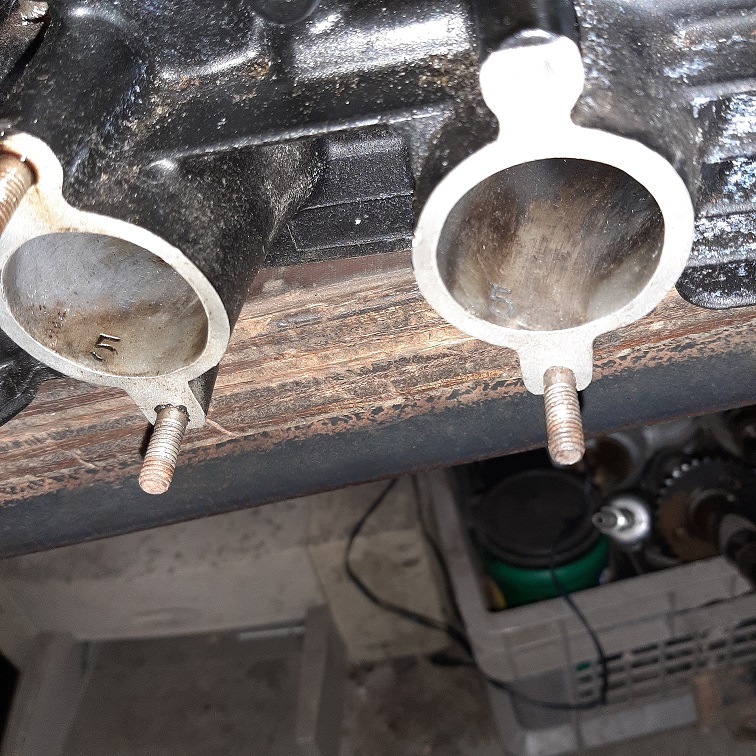

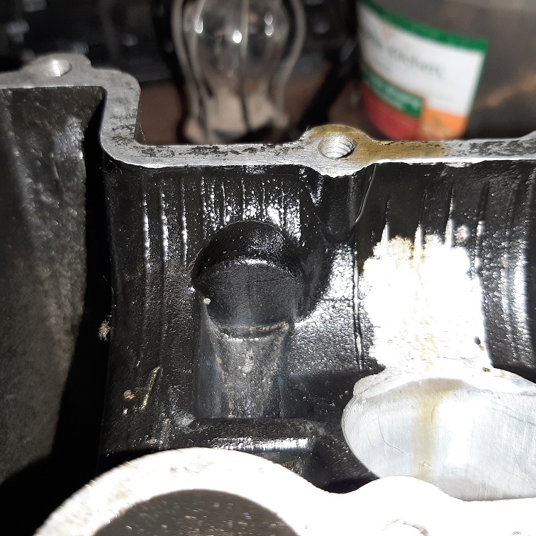

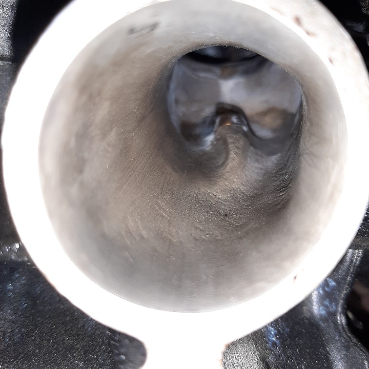

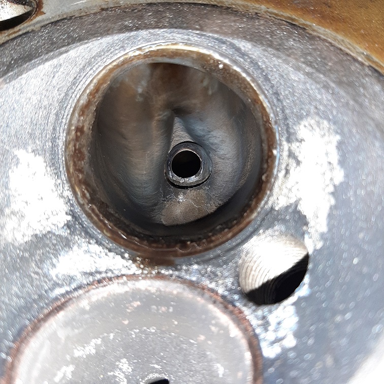

I pulled all the valves and measured and inspected, intakes 1.525 - and exhaust 1.30 -. Nice and no side play in the valve guides. Intakes are Ported and smoothed, I'll polish them to look like chrome. No tach hole. And head relieved for the bigger cams. All intake stamped 5? Going to get it vapor blasted and send it out for a real inspection and valve seats cut. Chris

I have no motorcycle porting experience, but in the Small Block Chevy world, good port work leaves the intake runner walls textured. It helps with additional atomization of the fuel and turbulence to help keep the fuel suspended.

You want to leave the intake runners rough. Some people even dimple them:

Don't polish the inlets , leaving them slightly rough help atomization.
Polish the exhaust to delay carbon build up.
