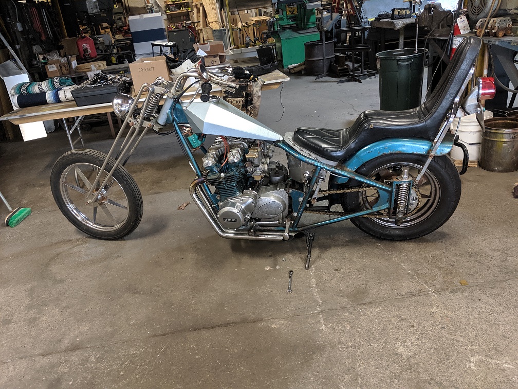

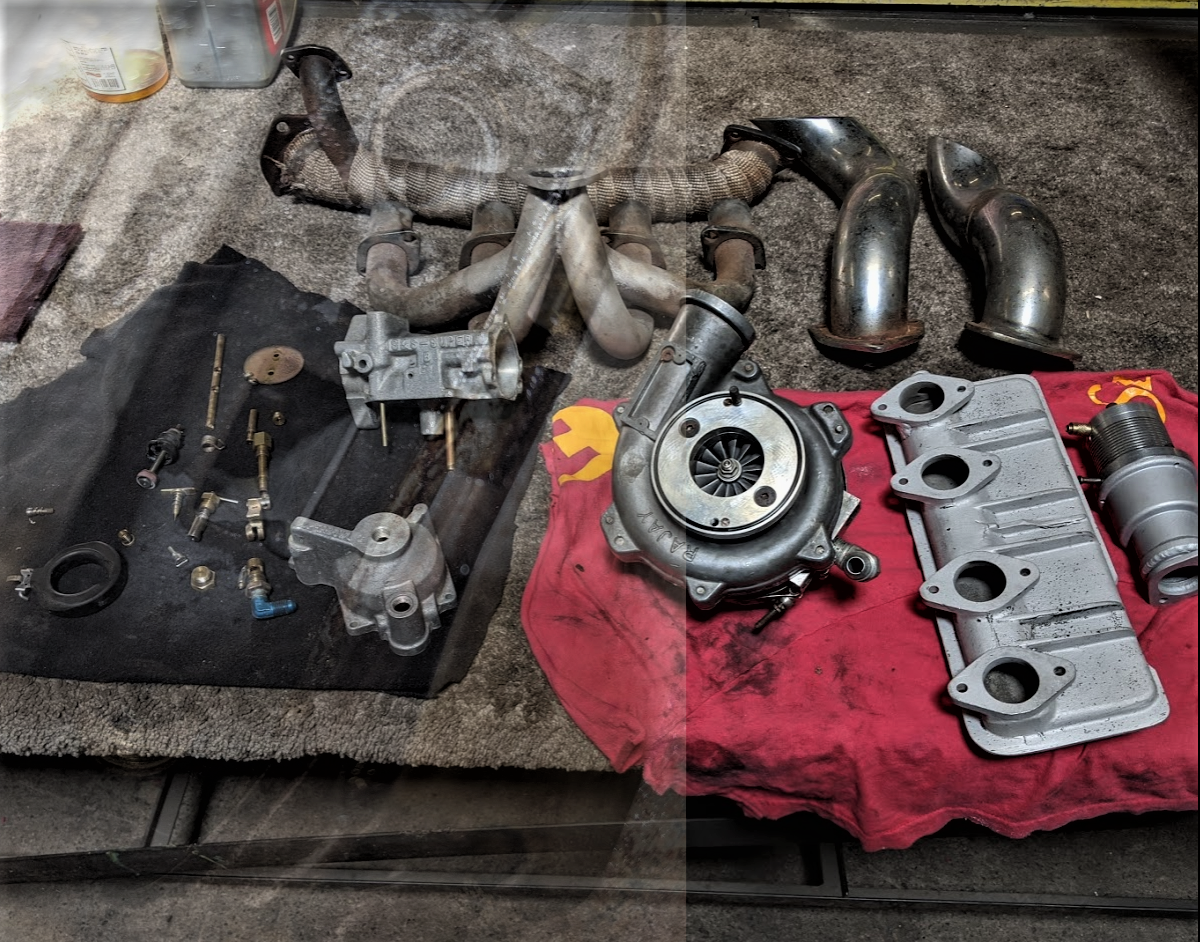

Been looking to do some repairs on my motor, the head has broken fins and the valve seals are shot. I can tell by the dripping oil on my boot.. I've got another head that i'm going to send out to be worked on. Just a bring it back to standard . I bought a Rajay turbo setup on Friday , and am cleaning the pile up . I haven't decided where to put the turbo, in front or behind the head. I've built a few bikes and can fab so I'll mock both to see what i like.. When I pull the head I'll better see the condition of the pistons and hopefully they'll be sufficient for the turbo. Looking at a HD timing chain and new guide and adjuster and Arp studs and nuts. I've already started blasting everything to check its condition. Here's some pics! Chris

You're turboing a bike with no front brake?

I fixed your bike pictures .
Next time click the insert all tab.
Im unsure of the turbo being a good idea on your bike
As pointed out . No front brake
Amen Savior frame
Turbo kit appears to be a rear mounted turbo with a over cam cover pipe feeding it .
Going to be tight at best. Typically only done with that style pipe on a funny bike or top fueler which has more room for pipe.
Good Luck

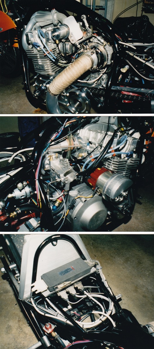

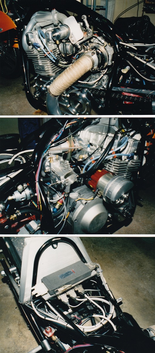

13 Jul 2020 04:53 - 13 Jul 2020 04:55Bent Trigger wrote: Has anyone seen this type of waste gate before? It seems to be adjustable! Again thanks guys. Chris
Chris - That waste gate looks like a BHP (Bill Hahn Products) unit. I ran one on my dragbike back in the day. See pic below
Mike

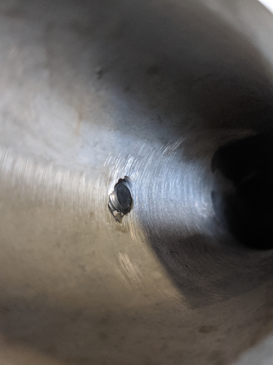

So I found a rebuild kit for the turbo,
www.turbokits.com/Turbo_Chargers/Turbo_R...ay_Rebuild_Kit/1467/
How do I know if it will fit mine? Mine has no tag for identification. And they ask if you have a dual feed bearing, I guess I'll have to disassemble it to get a view. It also includes a factory service manual PDF. Also Is this turbo oil system pressure fed or gravity fed? Someone tapped a 1/8npt on the discharge but never cleaned the thing up. Wonder what they were trying to measure?

Not familiar with a dual feed bearing .
Most all turbo Kaws run a Rajay F 40 turbo.
Oil supply is pressure fed . You tap into the oil transfer block bolted behind the motor , This tapped supply should have a
restriction orifice so it doesnt steal all your oil pressure and oil volume needed by the motor.
Important is that oil feed to center section bearing is on top of the turbo , with the larger drain / return line on the bottom .
These units basically pour oil over the bearing and drain out the bottom . They are NOT meant to fill and hold oil around the bearing .
Never seen that intake before. To bad Mr Turbo isnt operating . Terry Kizer would know
