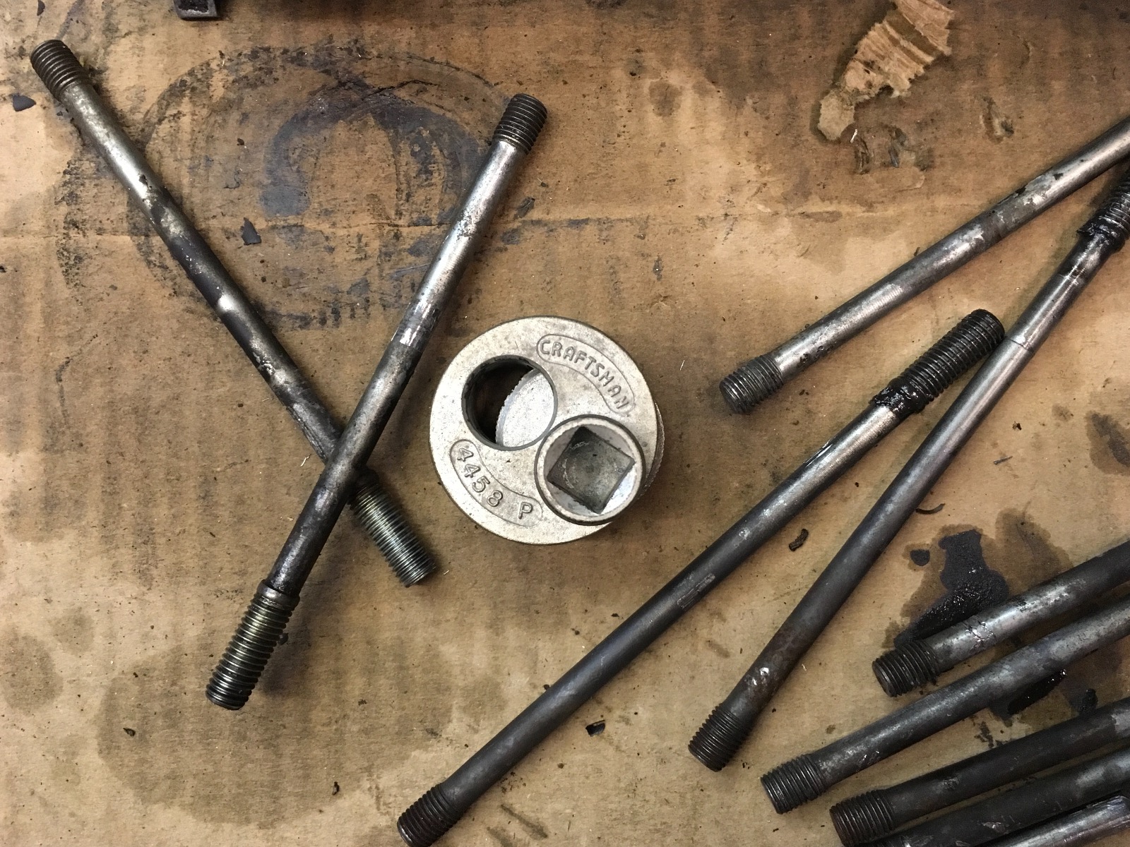

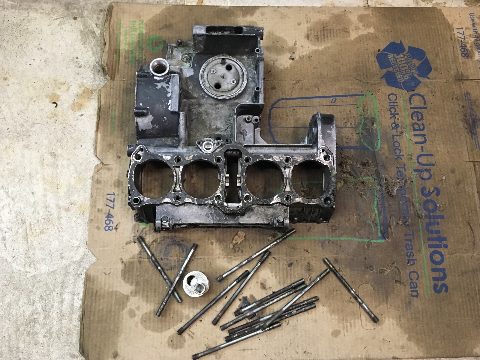

13 Oct 2020 15:24 - 13 Oct 2020 15:30Mikaw wrote: They soak for close to a week until my new fav tool arrived. I got a great deal on a craftsman vintage stud puller. Several gave a sharp “CRACK” as the vintage tool over powered them. Others gave in without a fight, like a Lake Erie walleye. I almost bought the 38$ unknown brand from APE until I shopped evilbay and found the craftsman tool. $15 shipped and had it in 3 days. Worked 13 1/2 hour every day this week, quite tuckered. Tomorrow I’ll get them packed up and off to Vapor Hone Saturday.
Now that looks like progress, Matt! Glad to see that those studs came out without too much drama.
Also, a little tip for when you install the new studs (if you're not already aware) -- place a small ball bearing into a head nut and then thread it onto the stud that you want to install. Tighten stud per specs. This beats trying to use a double nut setup. If you look at the top of the factory studs, you'll see a little dimple which implies that the Kawi engine builders used a similar technique. Hope this helps....
Mike
