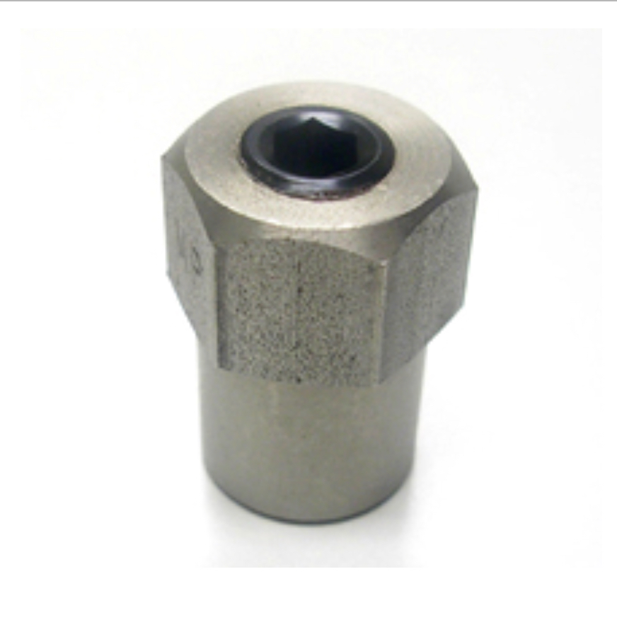

Thank you. I did notice a small dimple in the stud. I saw an installation tool sold at KZ Zone. It was a nut with a set screw to lock it on the stud. Thank you for the advice. I’ll use your method. Another Old School trick!!!
At $19.00 plus shipping you can see the value in a $10 donation.
Hey, you're welcome, Matt! Happy to share whatever useful knowledge that I might have if it can be of help to somebody. And, that KZ Zone stud install tool is pretty sweet - wasn't aware that it existed. A nice design, for sure..
Also, one last comment on using the factory head nut/ball bearing technique -- once you have the stud installed, you may need to grip it lightly so that you can back the head nut off without loosing your torque spec on the stud. If so, I just use a piece of thick brass shim stock around the stud and a pair of vise grips. The brass keeps the teeth of the vise grips from marring the stud. Just a small detail, but I'm kind of fussy with my stuff :) ....

Car guys used that trick years ago for installing rocker arm studs. The nut with the set screw was also used to set rocker arm to valve clearance and worked much better than a jam nut to set valves. What's old really can be new sometimes.

Thanks for reminding me where I had seen the kz zone tool before. It’s basically identical to the adjustment nut used on roller rocker setups.... I knew it looked familiar but old timers took over.

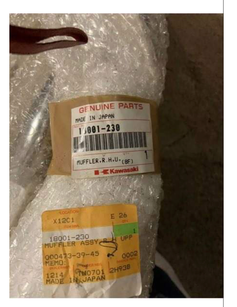

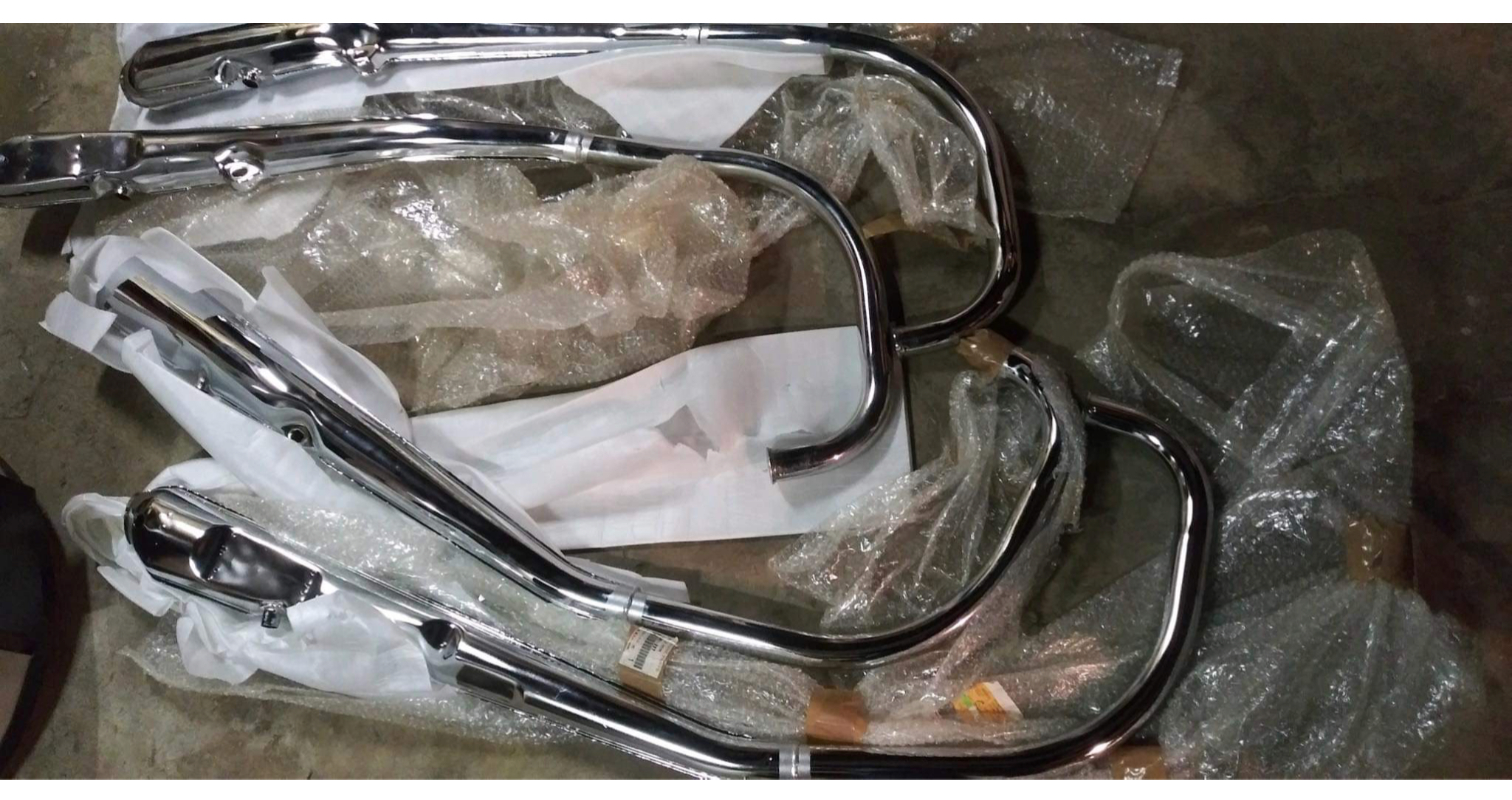

I had a deal fall through about 2 weeks ago on a set of Doremi aftermarket exhaust. The seller wanted $900. But before I could make travel plans to pick them up he called and said he was keeping them for a Z1B he just picked up. We I just made an ever better deal. Like it’s mentioned. Another door opens when one closes. No Introduction needed. Look at the following pictures.

#837347
Damn! those never were cheap. I'm not sure when they changed from the yellow tags on service parts, but I think it's probably been ten years ago by now. The number under the muffler assy script 000473-39-45 means suggested retail is $473.45 with a 39% mark up! I wonder how many $ worth I threw away that got scratched during assembly? Never quite got the hang out of polishing scratches out of chrome.(got pretty good at polishing aluminum though)
