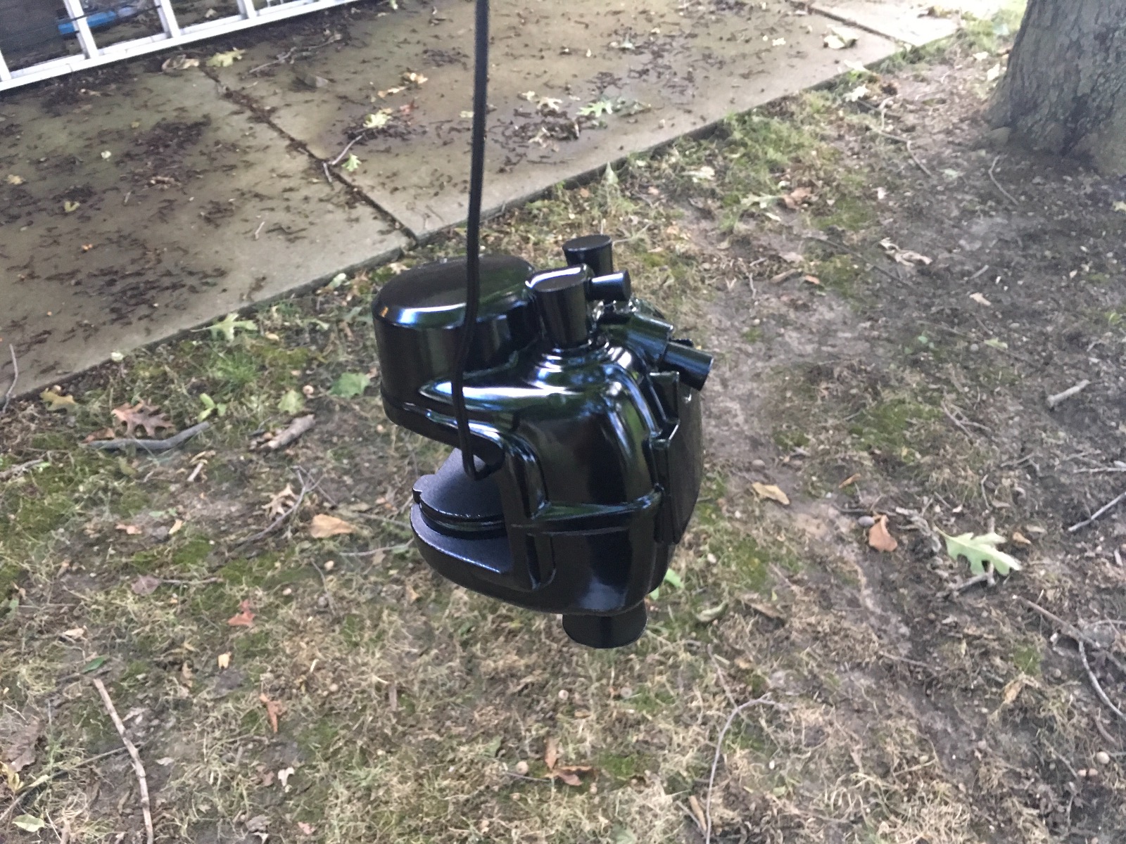

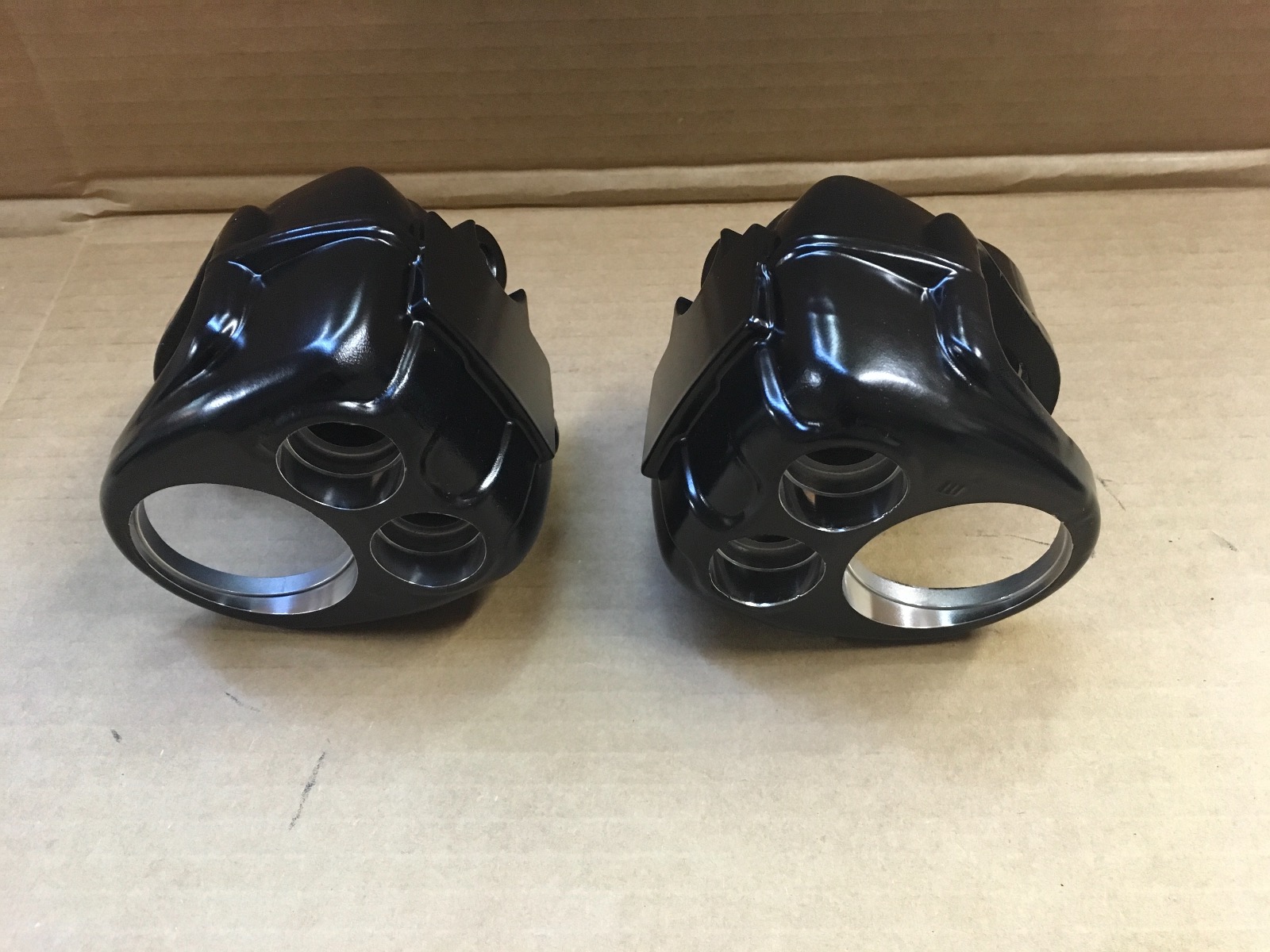

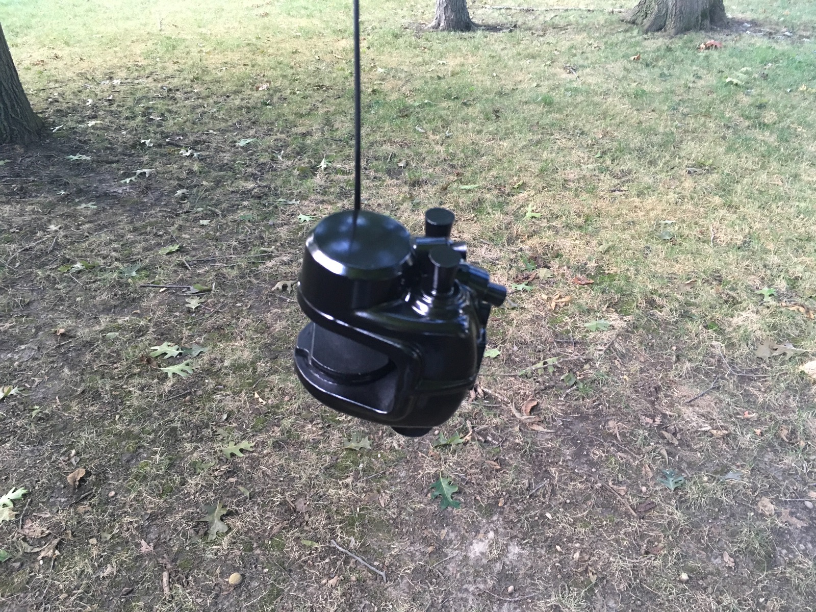

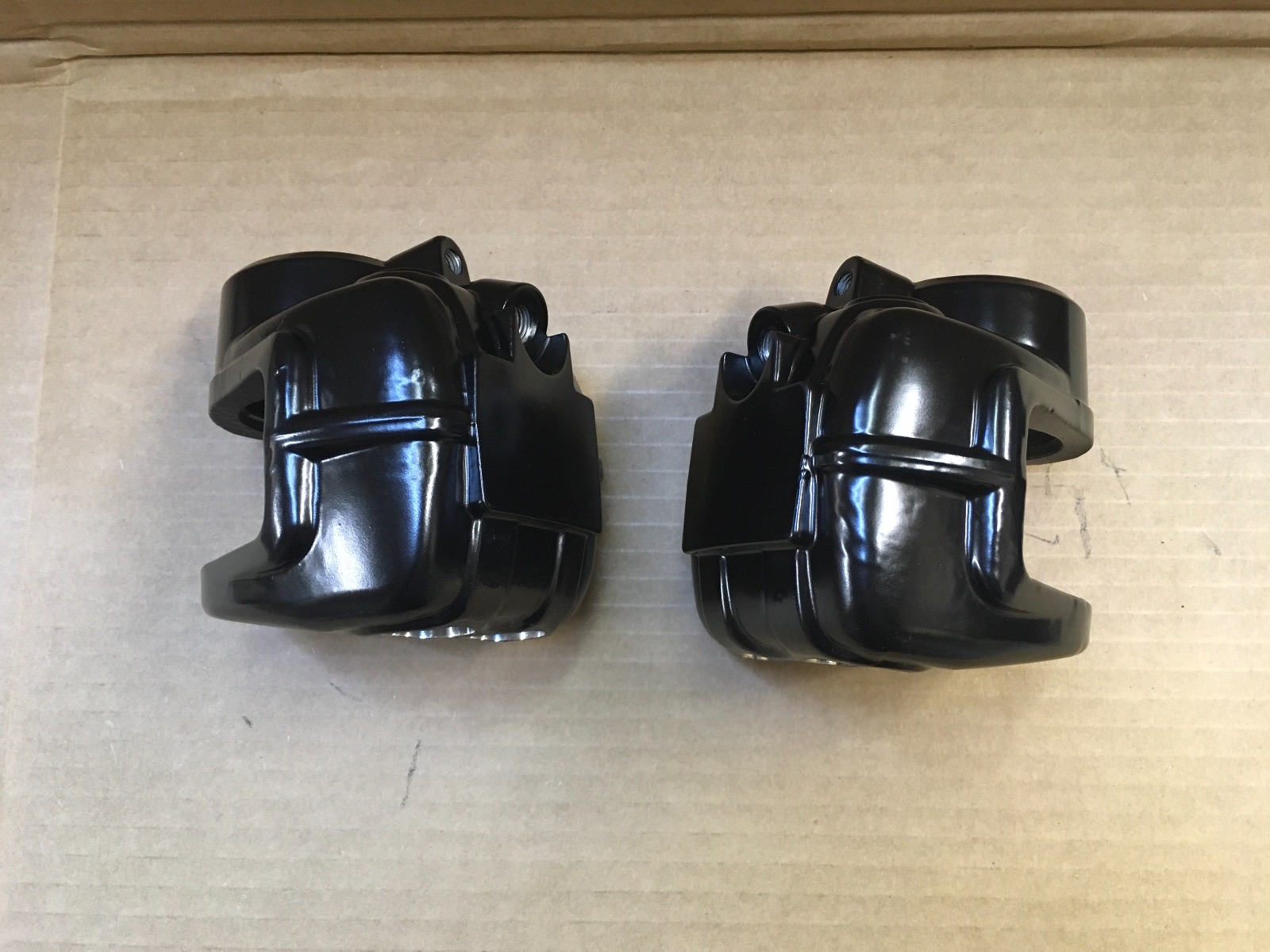

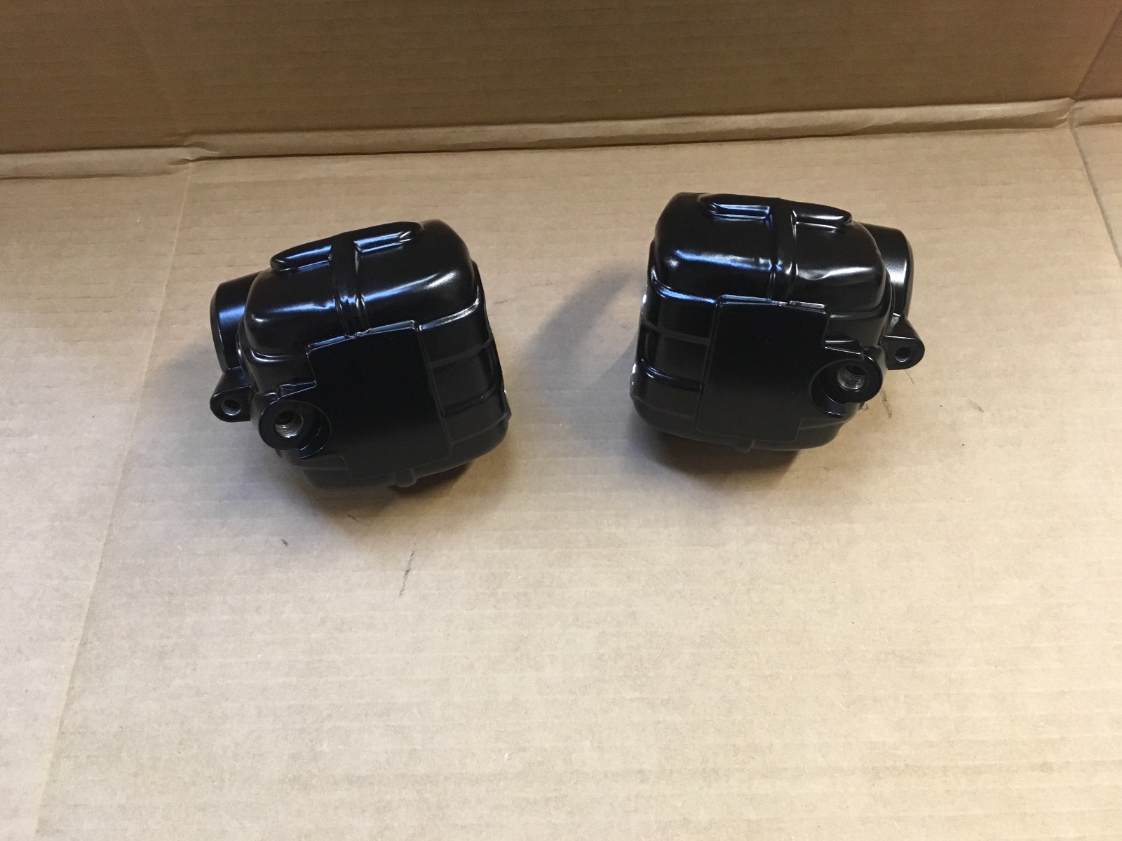

Hard to believe it’s been a week, two coats of caliper paint. Hope it’s all good. Tomorrow I’ll pull the plugs and take a peek

16 Aug 2020 17:55
They look good. Not too glossy.

16 Aug 2020 18:11
Those look like new old stock calipers! Nice! Ed

I’m happy... thanks.
Just remembered I use one of the pistons bought for these on the 1978 rear caliper when I detailed the swing arm, wheel, and brake. Another is ordered up. Be a few days before I get these rebuilt.

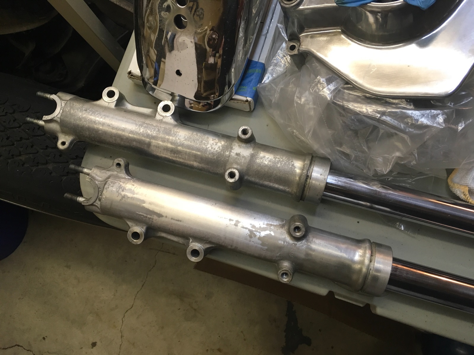

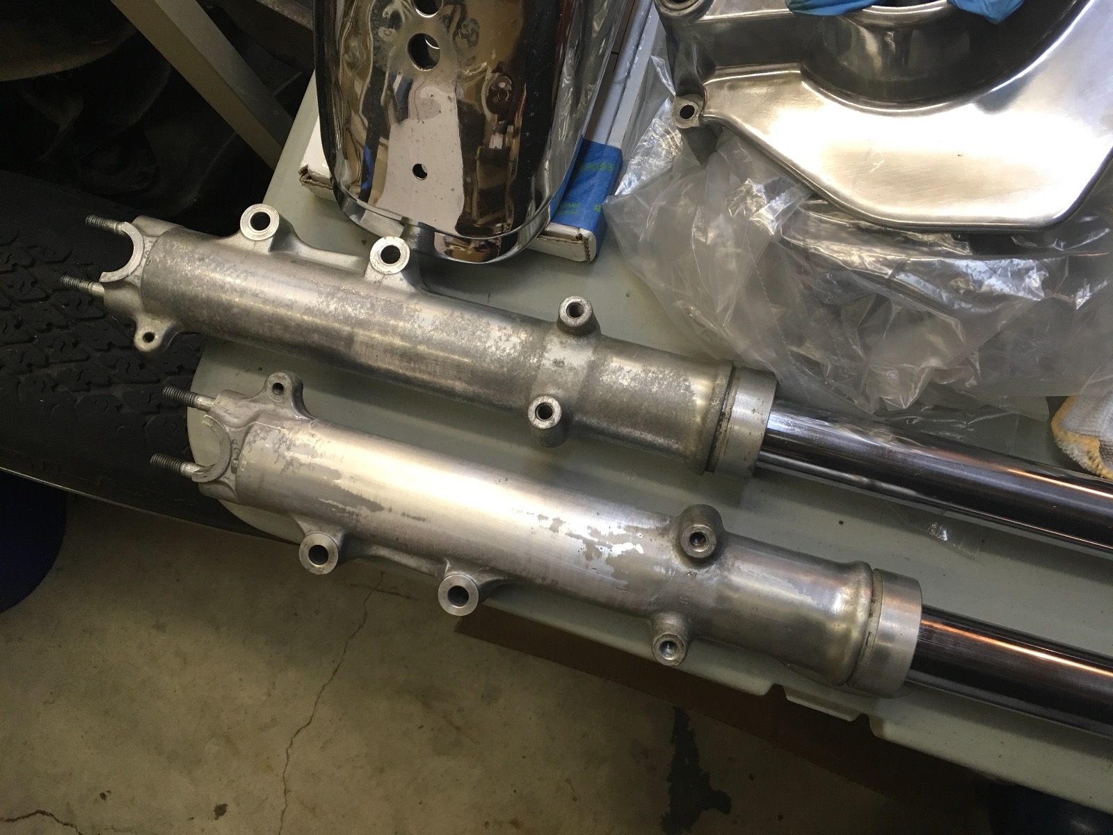

Thanks for the playing Biff to my Mcfly and knocking me on the head. Your right this is a factory restoration. Ditching the polished forks. I’m going to clean up the dings and scratches on the other set I have and send them for vapor hone.

Nice work Matt, Did you think at all of putting your painted brake parts in the oven to cure? I always put heads, blocks and brake parts in the oven on low for an hour. I like 250° Turn off oven and let them sit till cool.
And have you though about DOT 5 silicone brake fluid? Does not eat paint.

I wish those lower legs were here! I can do a nice finish on them. I never did a resto, mine were always highly polished. You should strip the clear lacquer off of them. It will help the next process. I use a spray can of stripper, eats that residue right away.

Thanks, did consider curing the calipers in the over but I didn’t know the temp and time length. I used VHT Caliper paint, is your suggested temp and time good for that paint on aluminum parts?
Dot 5 sounds like the ticket.
