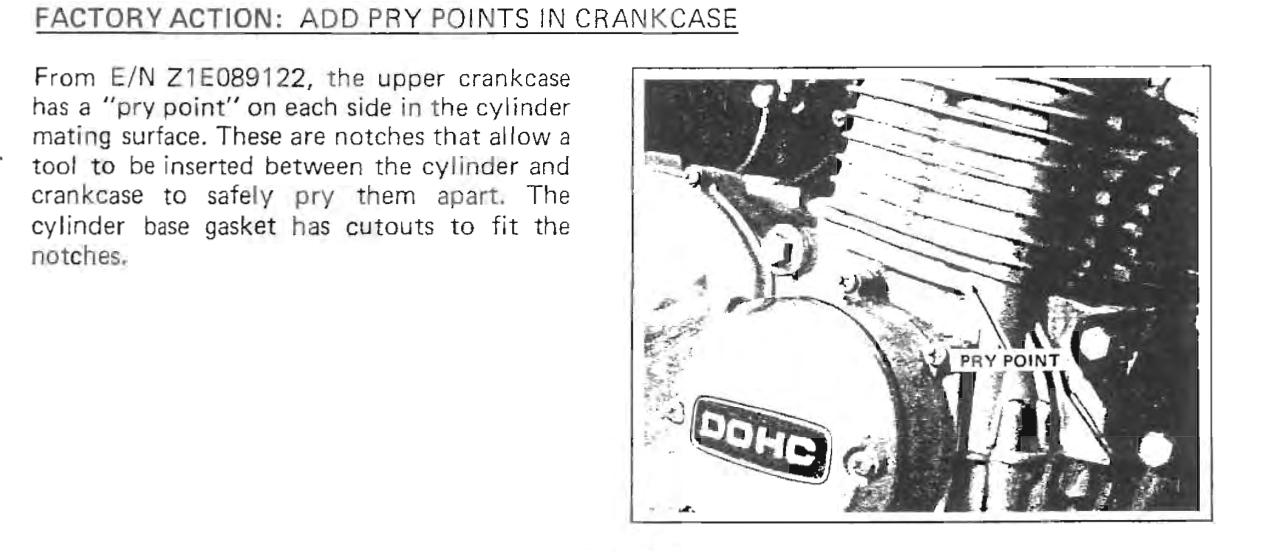

I have always been told that '76 cases had the oil volume casting. Also, that Kawasaki abandoned all attempts to match engine and frame numbers.
I went looking to see if I could find anything in the service bulletins to figure out when a possible change was made. There was a bulletin in early '76 describing an upper case mod to make it easier to pry the cylinders off the case. This mod likely resulted in new castings, and may have been when they also added the oil volume casting. It would be logical to make the change at the same time. Just a guess on my part though.

Kawasaki did not trust round eyes building motors when the Lincoln plant first opened. The Kz900 motors were assembled in Japan and shipped here.
Don't remember when Kawasaki started building complete motors in Lincoln.
When Kawasaki added those fancy pry points to the Kz900 cases, they increased the sales of flat blade screwdrivers by 50% in Kawasaki dealerships!!!!
