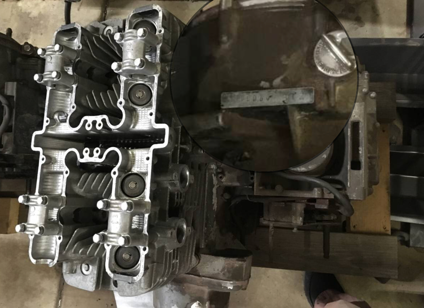

Found some cases. Working on cost. Only they are older than the SB adding the pry points...
  • hardrockminer
  • hardrockminer's Avatar
  • Posts: 3150
  • Thanks: 1248
Re: 1976 Kz 900 A4
27 Jul 2020 05:14
#831545
I think those cases are newer. S/N is greater than the change point for pry points. What it means is that KHI must have made another mod to the cases at some later date.

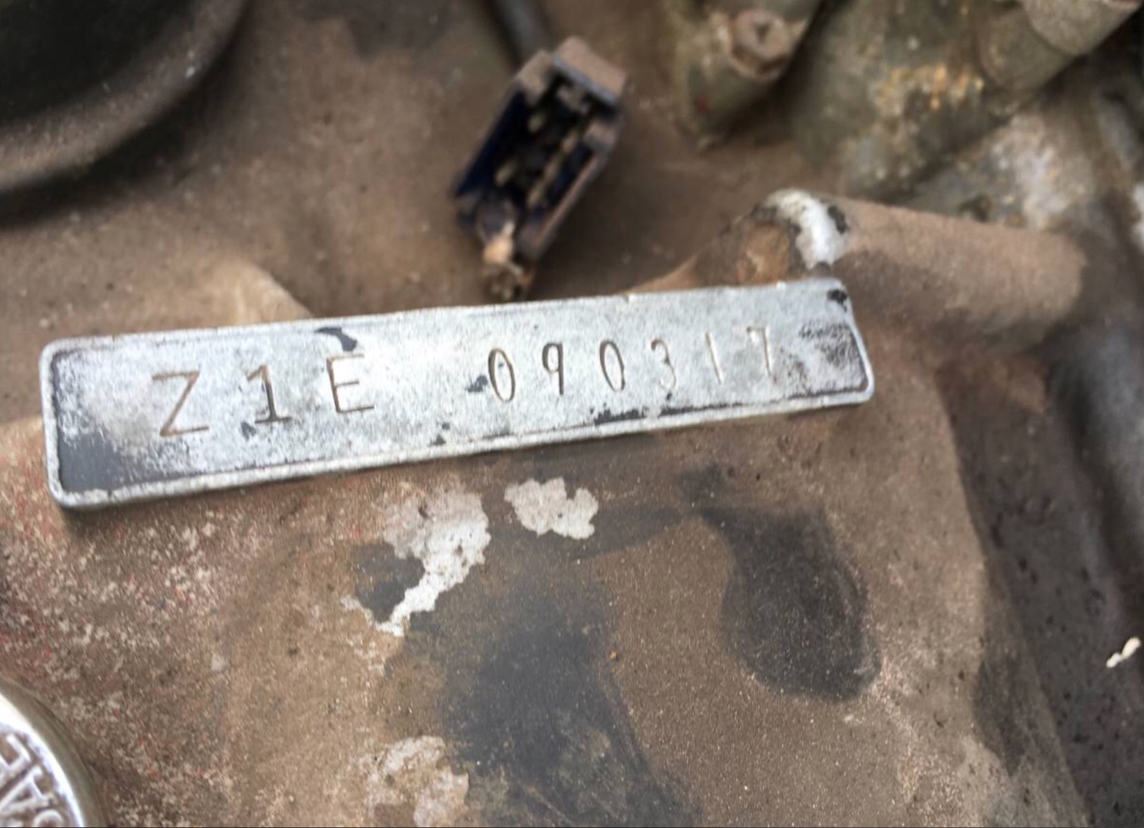

Thank you for the correction... Duh... yes newer!
Ok now we know they exist, now I need help determining what date the change was made. Would an 11/1975 built bike have the unmarked cases
