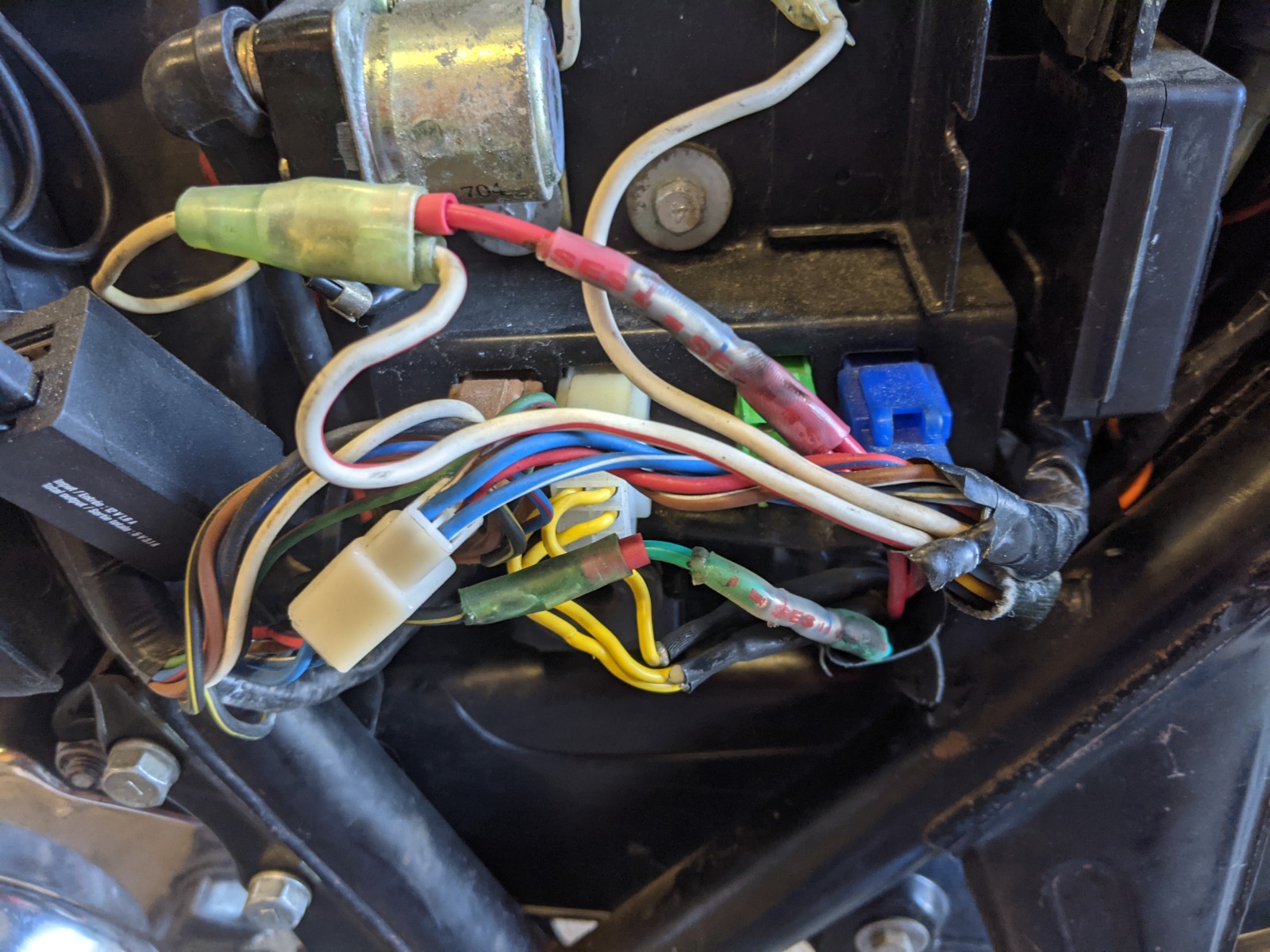

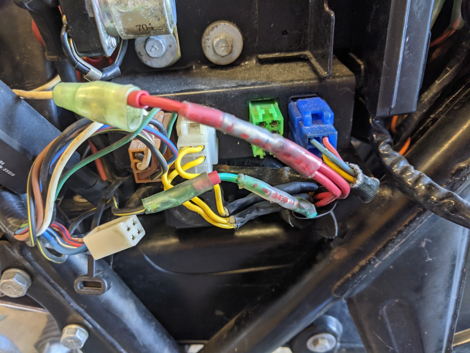

This evening I replaced the points with a Dyna-S ignition. Simple install. Used the double brown plug inside the headlight to get switched power. My only issue is that the wires on the dyna are about 6" shorter than stock. Had to get a little creative to get them to reach.
I also swapped out the spark plug boots with NGK LB05FP.
It could just be me, but my ear-o-meter would swear it idles better.
I also replaced the regulator and rectifier with a Ricks Electric combo unit. Can't seem to find any details on how others wired theirs in. This one is pretty simple. 3 yellow wired to the existing rectifier plug, two reds to positive, 2 greens to ground.
I didn't get as fancy with the install as I probably should have, but I didn't really have everything I should have at the shop either. But once I had the bike apart, I was kinda stuck there until I got things done.
The first photo below shows how it all looks together. The second photo shows what I did with some of the other wiring out of the way. I'm open to feedback if someone tells me I did this wrong, or inefficiently.
PS. Please excuse the El cheapo bullet connectors.

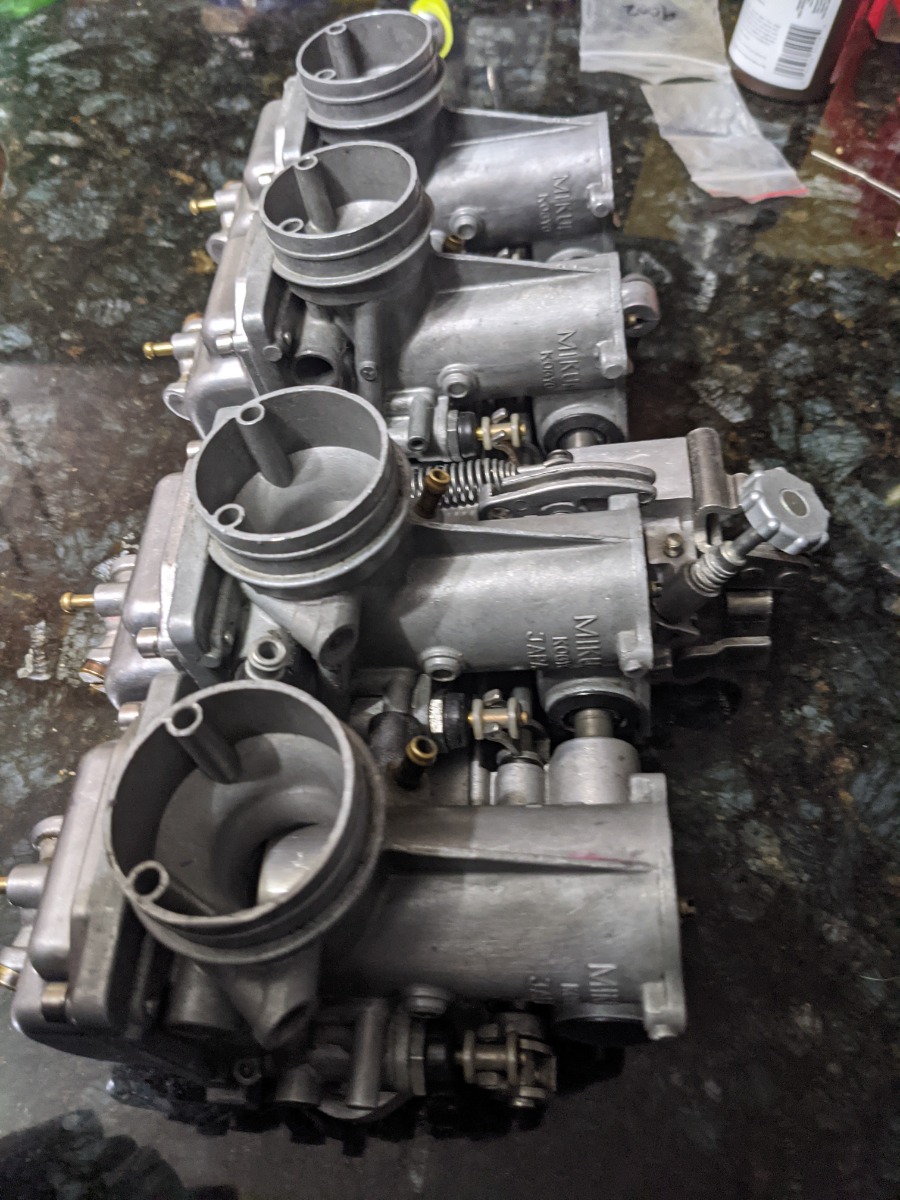

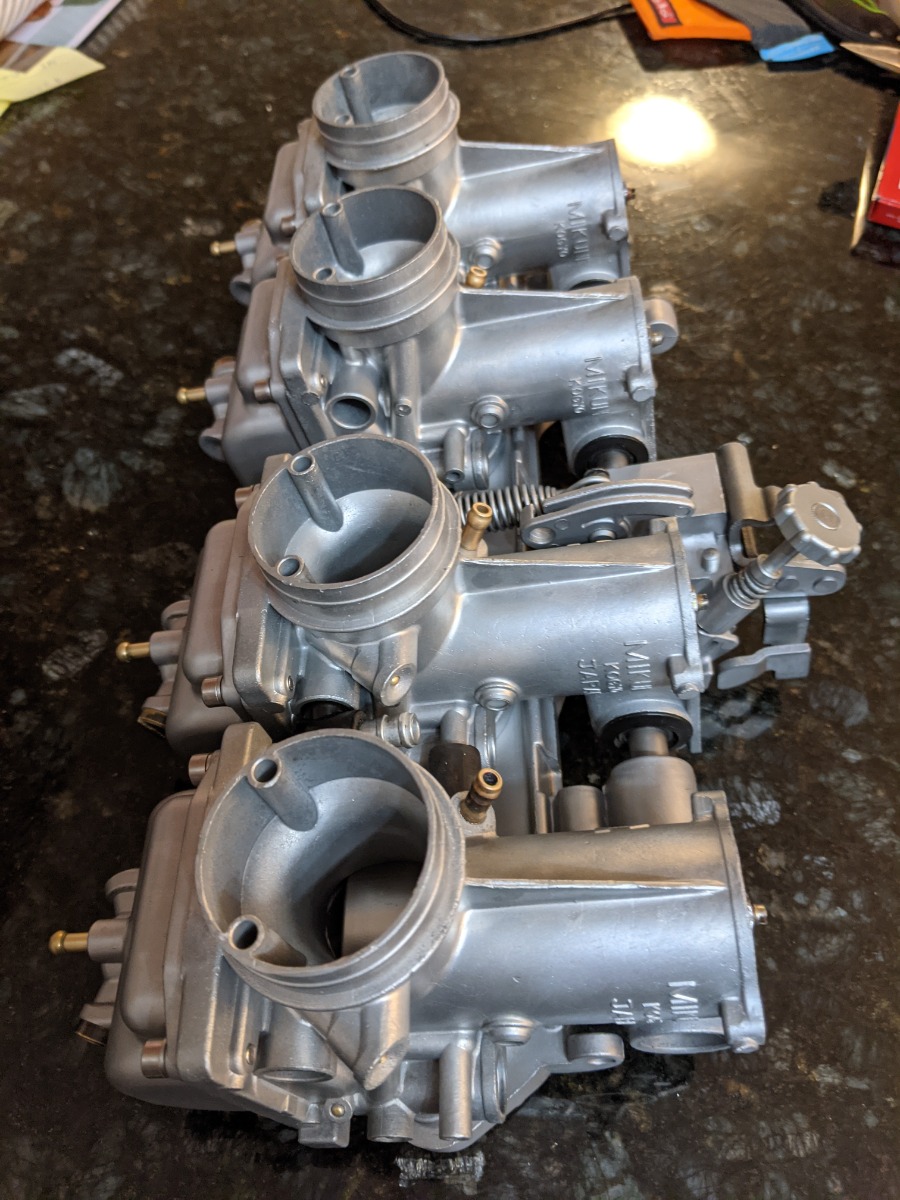

Wow! Been a while since I posted. Been a busy summer working, planning the wedding (4 days left!) And riding with buddies. I pulled the head a while back and dealt with valve seals. I powered through it in a day, just to prove I could. It was an incredibly long day, and I was completely bagged, but I did it. Stopped short of getting everything synced and running that night tho. I didn't want to push my luck, and felt like I had made my point.
Recently, I started having some really bad surging issues. Actually, I've had surging issues off and on all summer and kept managing to get rid of it by playing with the fuel screws. This time, however, it was really bad. Backfiring hard, sounding like gunfire, scaring small children and grown men alike kinda backfiring. I finally settled on what I'm sure has been my issue all along, which is the choke plunger seals. New choke plungers should be here very soon, if Canada Post ever decides to keep them moving, so I decided to take the opportunity to tear the carburetors apart and bring them to a new local motorbike shop that has a vapor blaster. Carbs came out beautifully, and I almost can't wait until winter to bring him the wheel hubs and motor to do. Almost.

Were the carbs still racked when vapor blasted? Openings & orifices plugged to keep bead out of internal passages? If not, bead is everywhere inside the carbs, slide crank bearings, etc .
Glass bead has a serious tendency to adhere to the workpiece, be it from surface tension, electrostatic attraction or whatever. Even after rinsing in detergent water, bead will often still be present. Sometimes it can be felt as a powdery feeling when running fingers upon the surface.
Bead is almost impossible to see in normal lighting but, bead adhering to a surface can be easily seen as follows:
Place the workpiece in an area of very dim light. Step back a few paces, 6ft. or so. Hold a bright light source such as a good LED flashlight just under eye level & shine it at the workpiece. Any remaining glass bead will reflect the light very brightly.
Best way we've found to remove bead from carb bodies is detergent water in an ultrasonic tank.

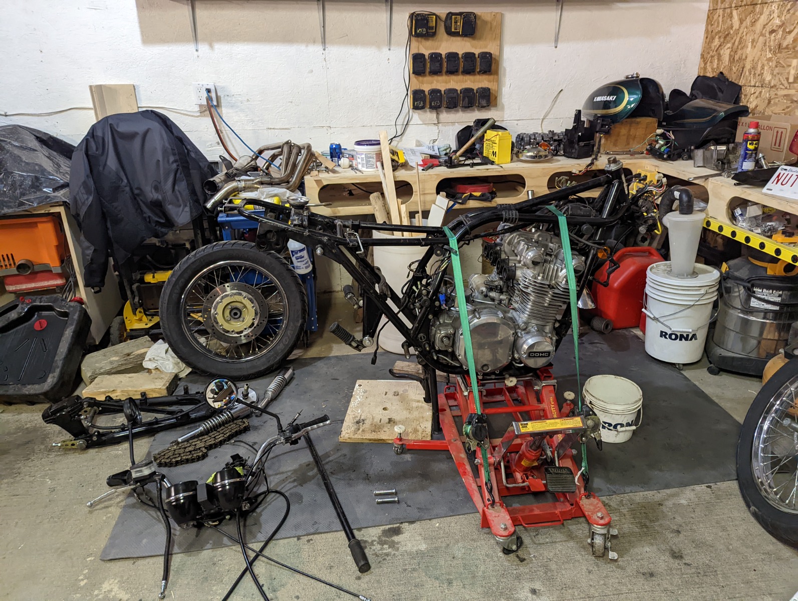

Wowza has it been a while! It's been an incredibly busy winter at work, but the 1000 is FINALLY going back together. I have popped in a few times to check on everyone's projects, and to see if Mikaw has made any momentum on his A4 (spoiler alert:nope).
Had the frame sandblasted and responded all the black parts. The cases, cylinder, head and valve cover are getting vapour blasted while I wait for a few bits to arrive to put it back together. I believe the delivery date on that stuff from Kawasaki is around April 21, so should finally have her back on the road at the start of May.
The wife got me a proper bench polisher for Christmas, so I've been polishing up all the engine covers real nice.
Also, picked up a 1978 KZ400-B1 a week or so ago for $500. It runs, and is mostly all there. A few parts for that bike is also on the way to get it back on the road (speedo cable, master cylinder rebuild, etc) although I'm still trying to sort out someone who can pull that large dent in the tank.
Now I guess the race is on to see if I can get one of these bikes back on the road before my new Z900RS SE shows up...
