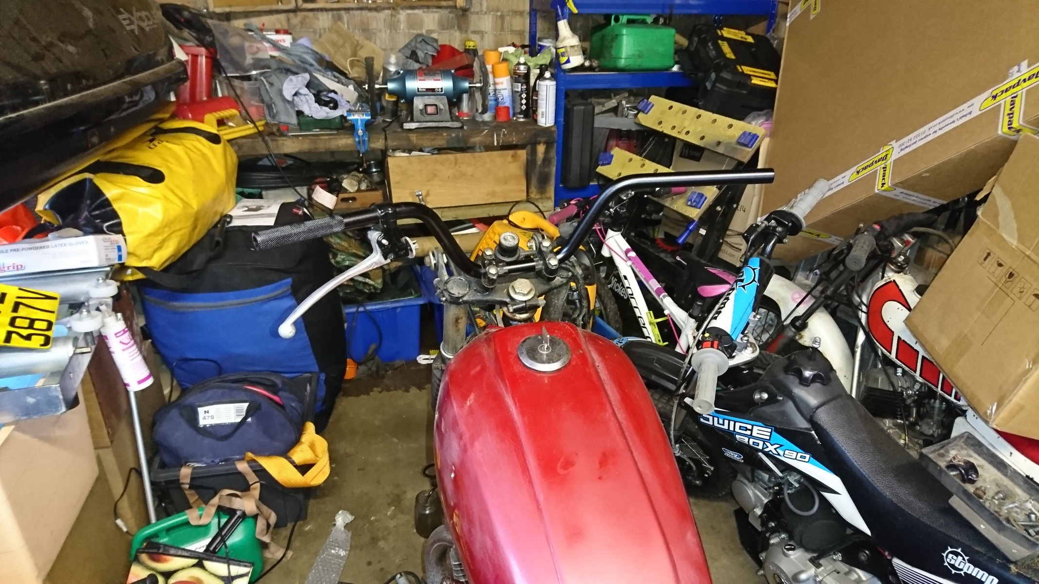

New bars arrived today, think they will be fine.

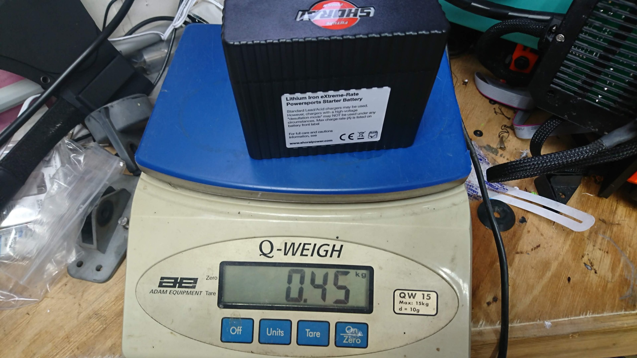

I want to do away with the air-box and battery mount, so looked for the smallest battery I could find. As the bike has a kick-start thought I don't need the battery to be able to turn the engine over, so I bought the smallest lithium-iron that Shorai do. It is tiny and weighs nothing!
I installed it on the bike and started it using the kick-starter to check it charged okay using a volt meter, all was good, then I tried the starter motor thinking the tiny battery would struggle to turn the engine over but cranked it over faster than the lead-acid battery did! [attachment=125796]

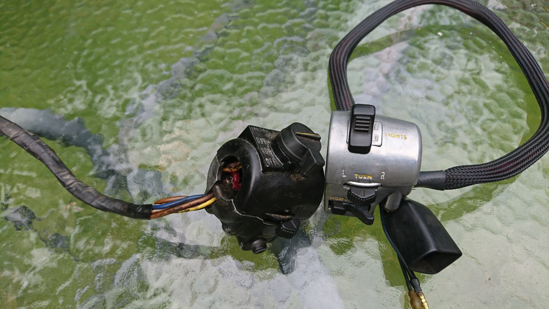

Still waiting on the wheels so I thought I would do a few little jobs on the bike. Wanted to make the switches look more "retro" so took them apart, cleaned the contacts, polished the housings and fitted braid instead of the plain black sleeve.

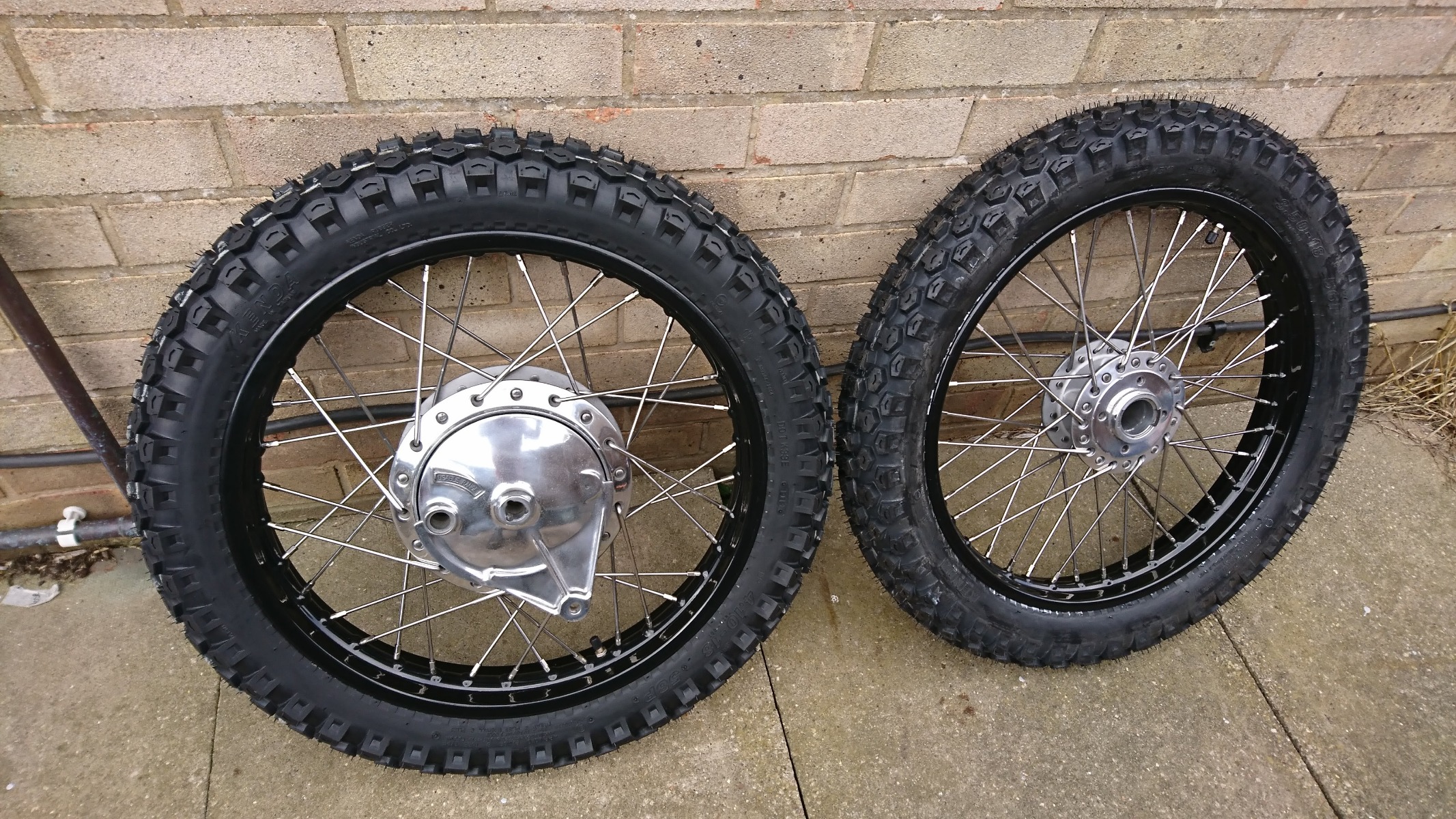

I have got the wheels back after having them refurbished, I think they look great.
