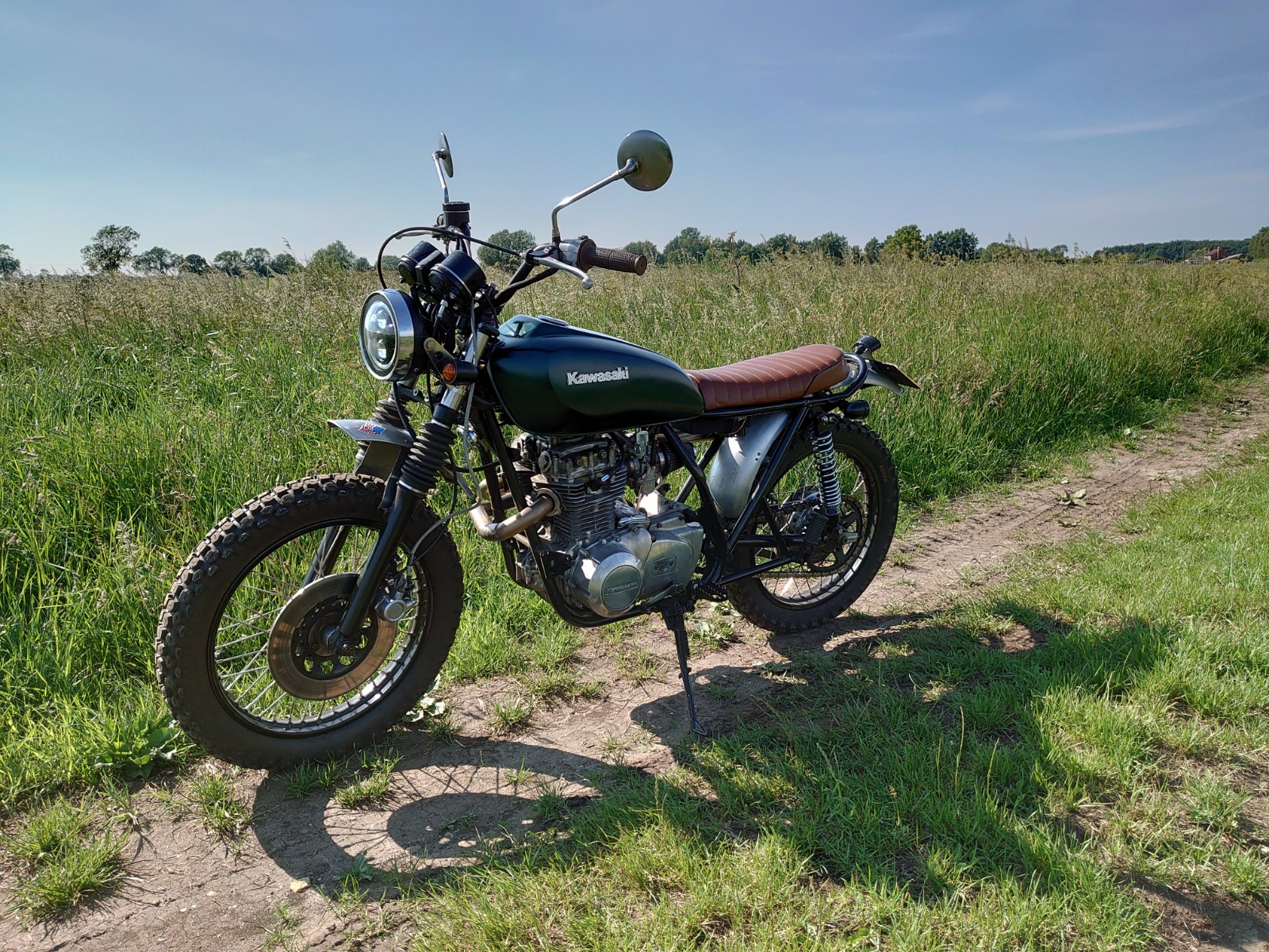

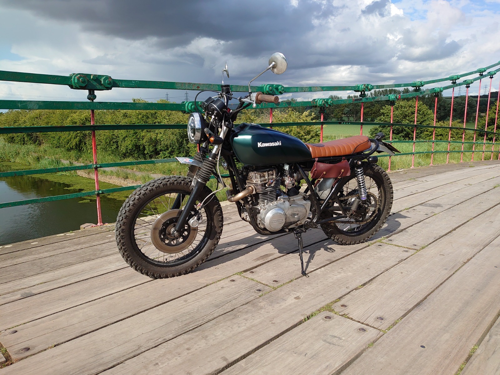

Looking super nice! I would keep the mirrors, a set of bar end mirrors will give it a more modern, street look and I think you have made a good job of stepping away from that look.
The following user(s) said Thank You: Pookie
- Posts: 8358
- Thanks: 2772
Re: 1979 UK Spec Z400B2
22 May 2020 05:36
I agree. I think those mirrors look just right on your build.

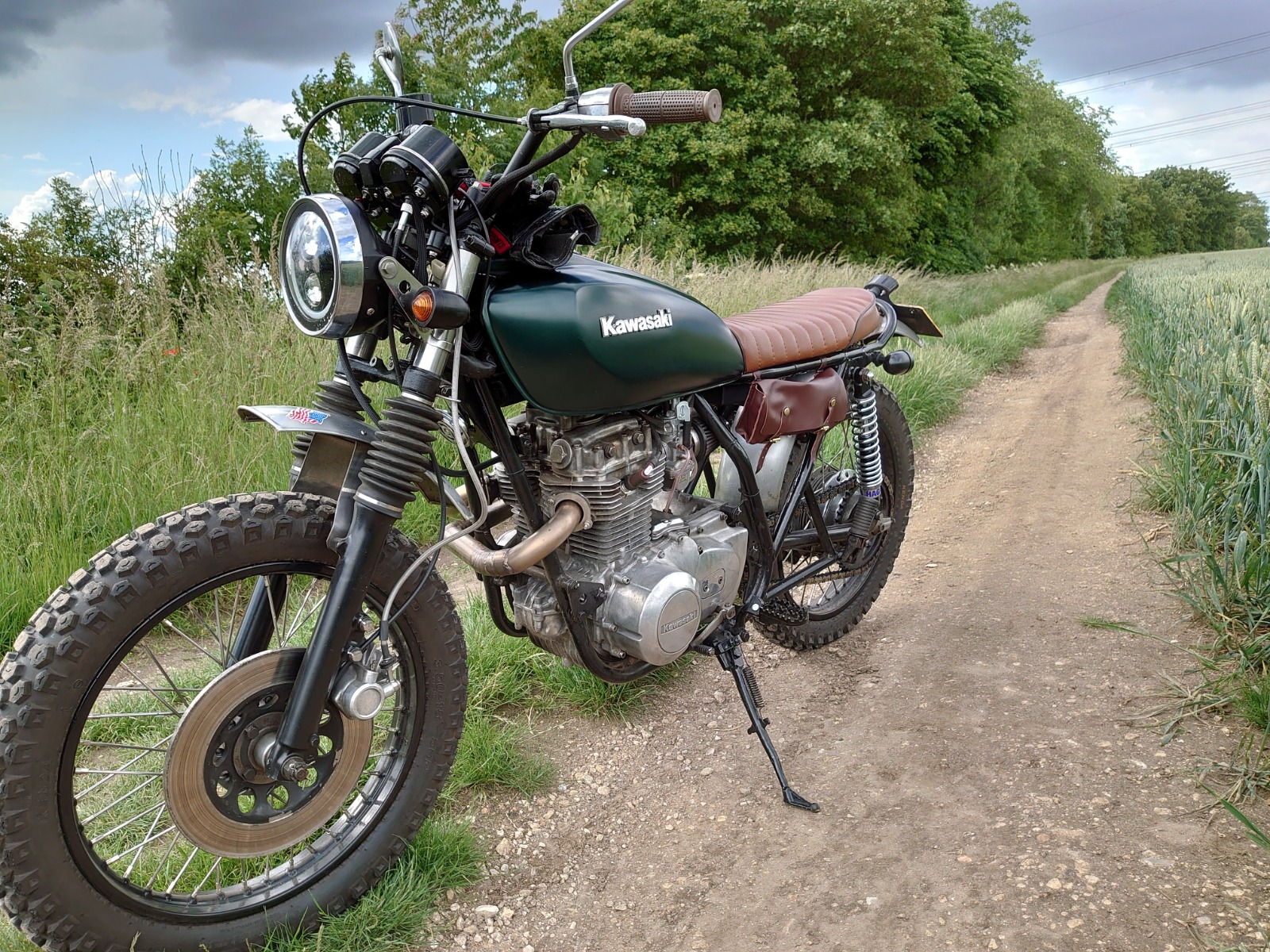

I have fitted the new HAGON shocks and now it rides much better, I went for the ones with adjustable damping in the end.

I took the bike out down a few green-lanes to try out the new Hagon shocks, they worked great, but the forks bottomed-out a few times so might look at progressive forks springs.
Or am I asking too much, it rides great on the road and the bike as never built for off-road use so I might just live with it!

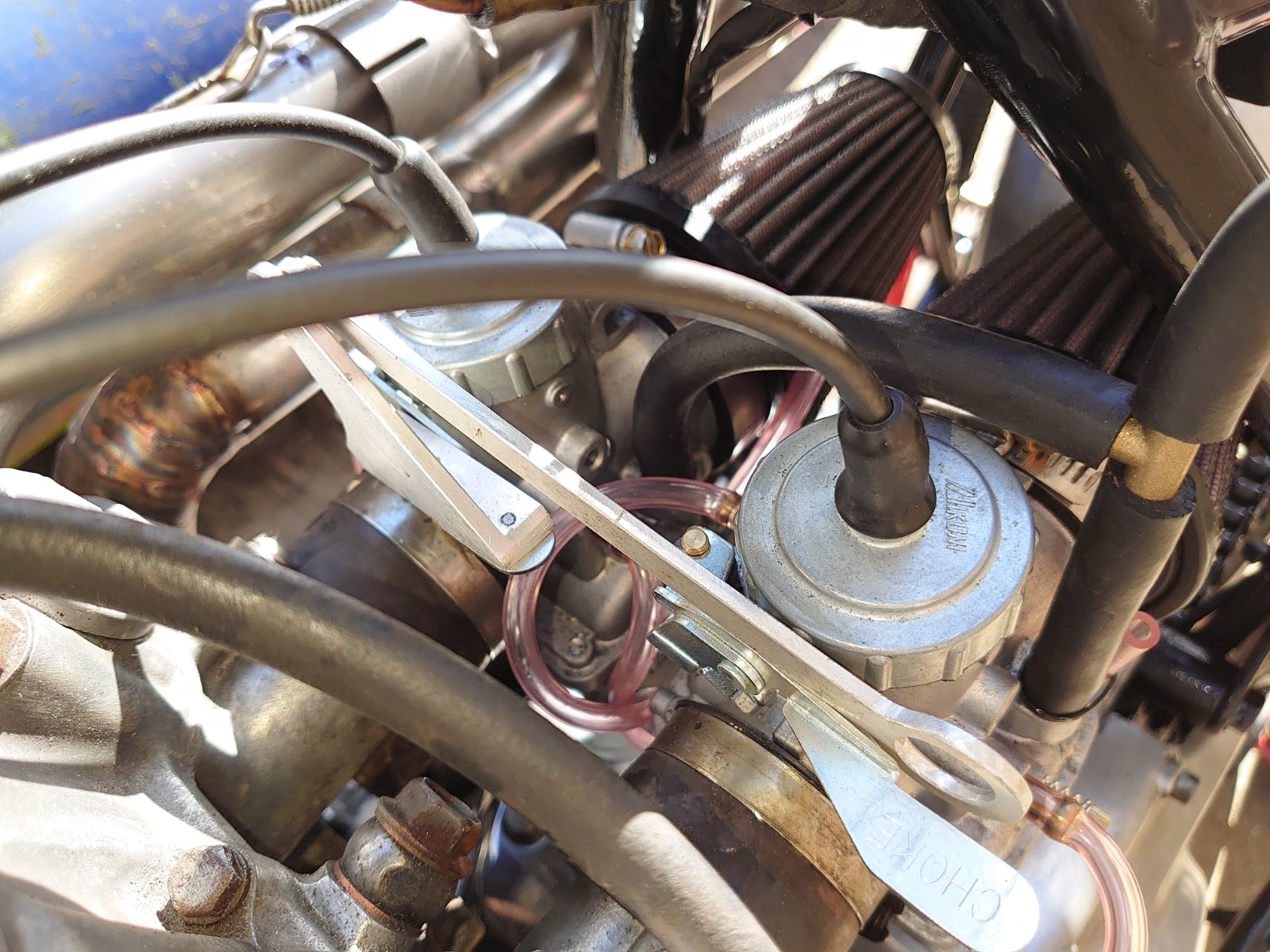

This is how I rigged the choke lever, the high level exhaust pipes are in the way so can now operate both from the left
-hand side.

That right side choke lever looks great! I'm going to have to figure out a similar mod on the dual carbs I'm working on.

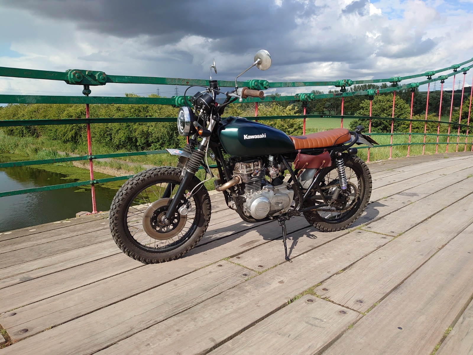

I needed something to keep my lock and a few tools, so bought some leather and made a side pouch.
It works well and does not get in the way!
