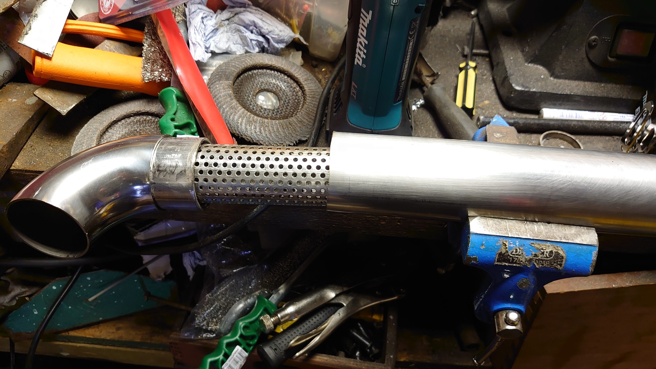

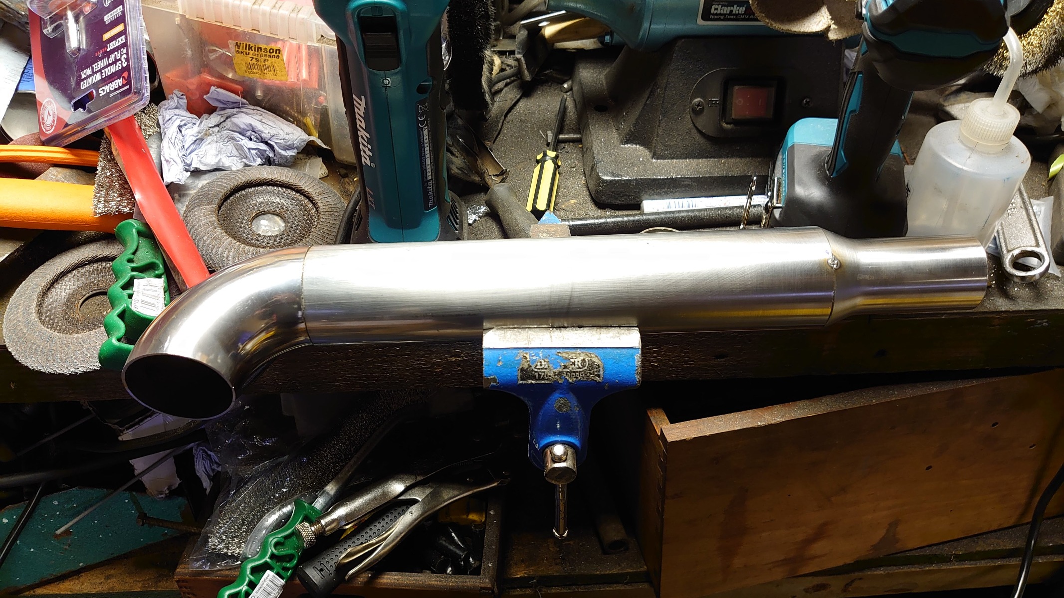

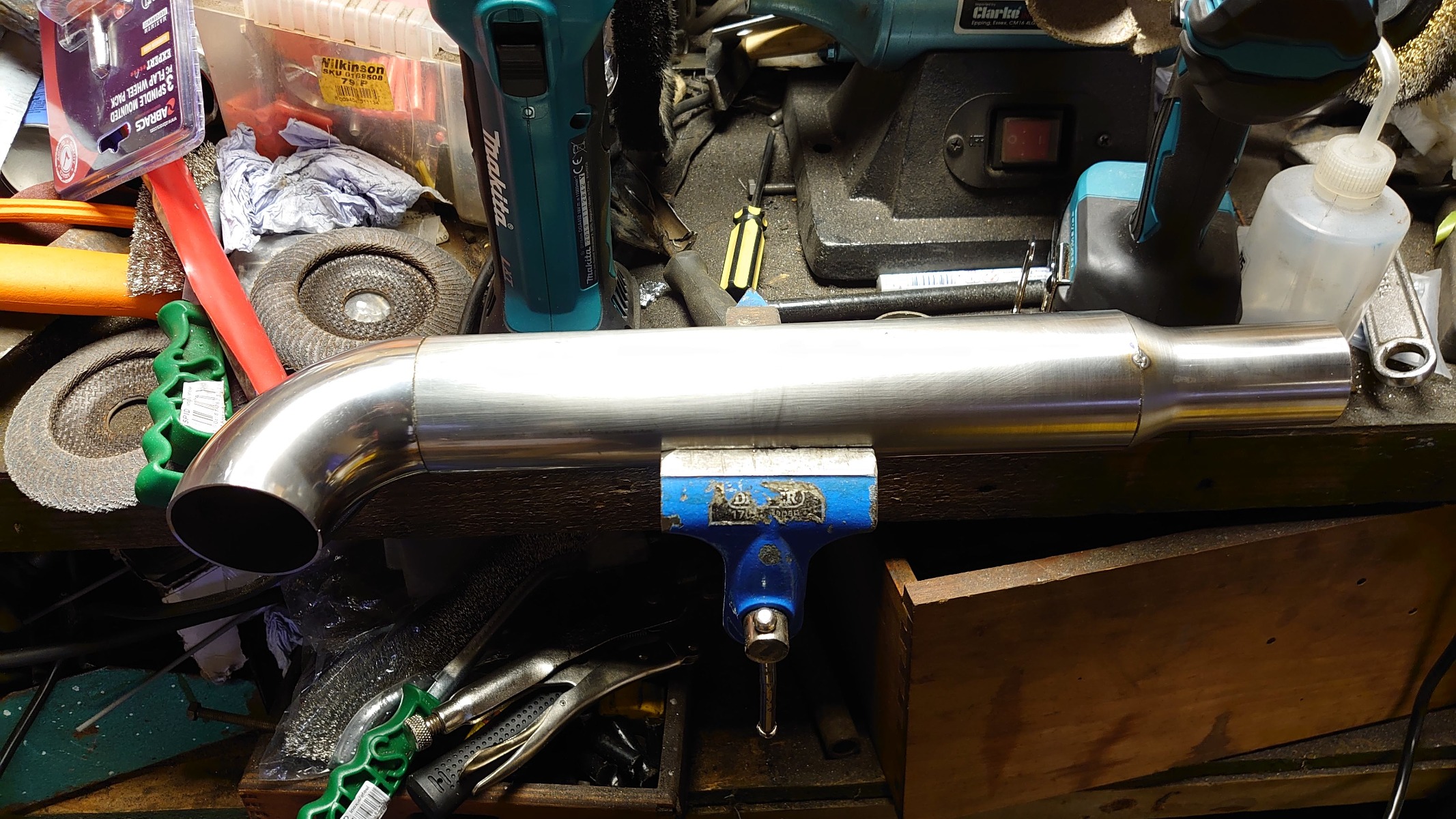

Photos showing how I made the silencers, exhaust wadding will be wrapped around the perforated tube to keep the sound level down a little (I hope).

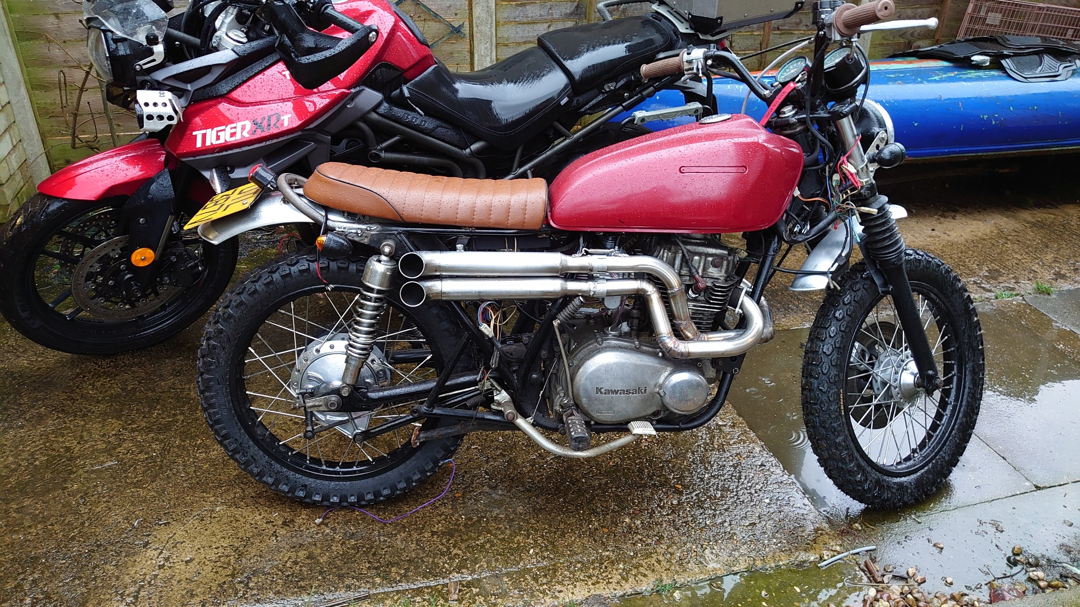

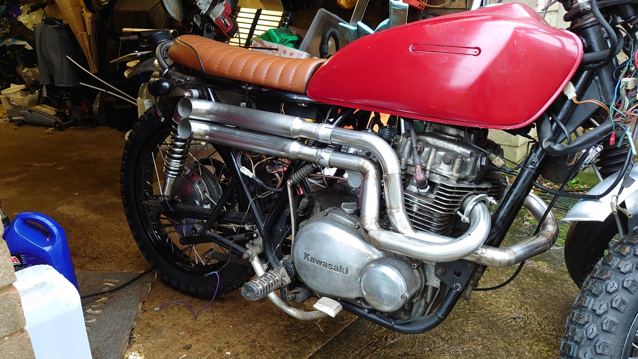

Got the exhausts tacked in place, just need to weld it all up!

I hope you have asbestos pants. :laugh: :laugh: :laugh: Ed

650ed wrote: I hope you have asbestos pants. :laugh: :laugh: :laugh: Ed
I have a plan! Watch this space!

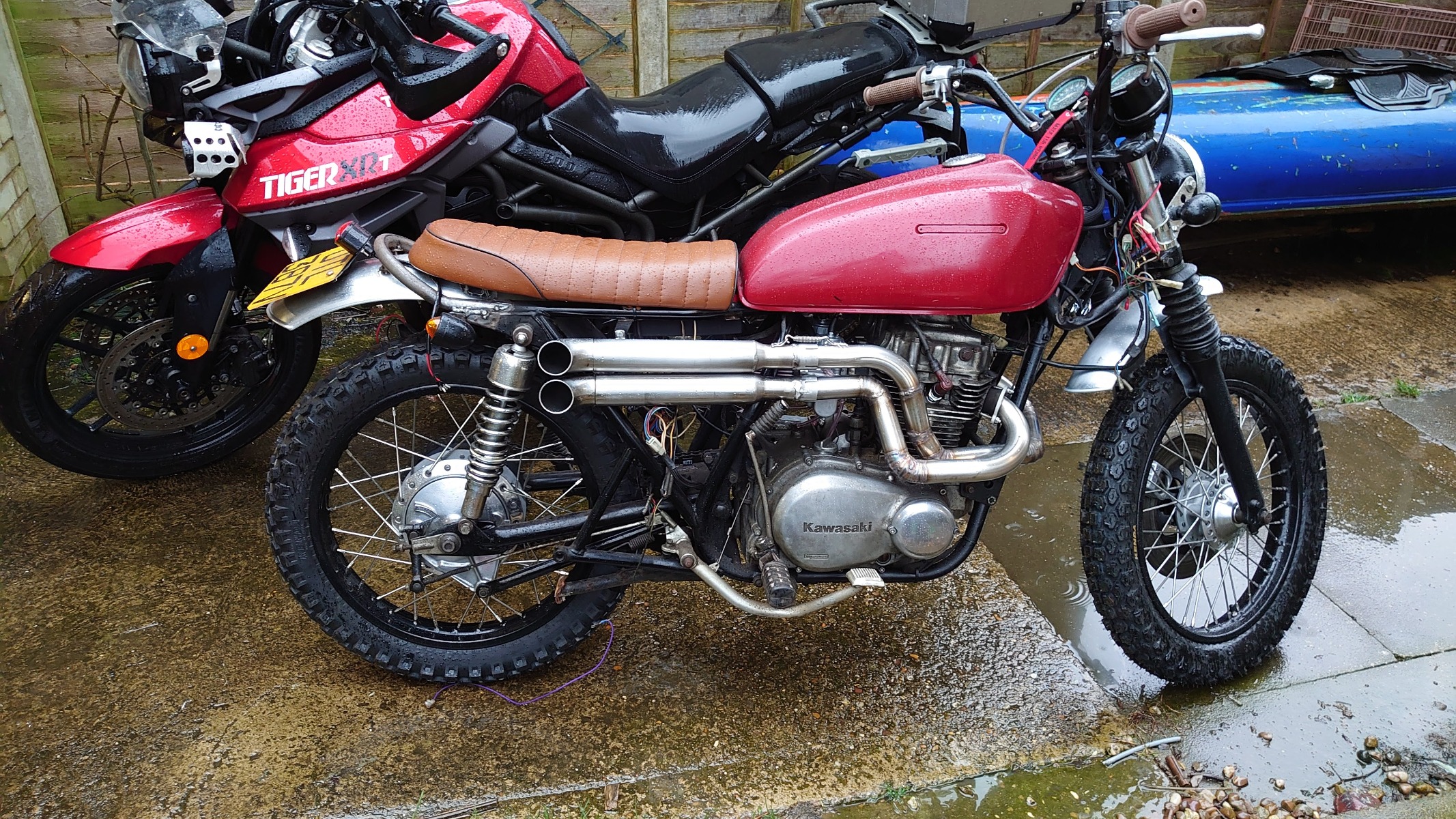

Finished welding the exhaust, started the bike and it sounds great (if a little loud). Time to tear the bike down to get the frame painted.

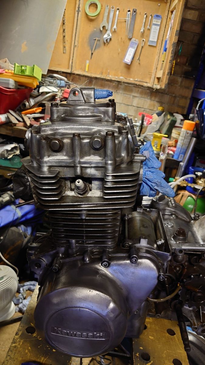

Started cleaning the engine, not going the whole hog and rebuilding it just a good clean. Also striped the forks today to fit new seals and change the oil, awaiting the seals.

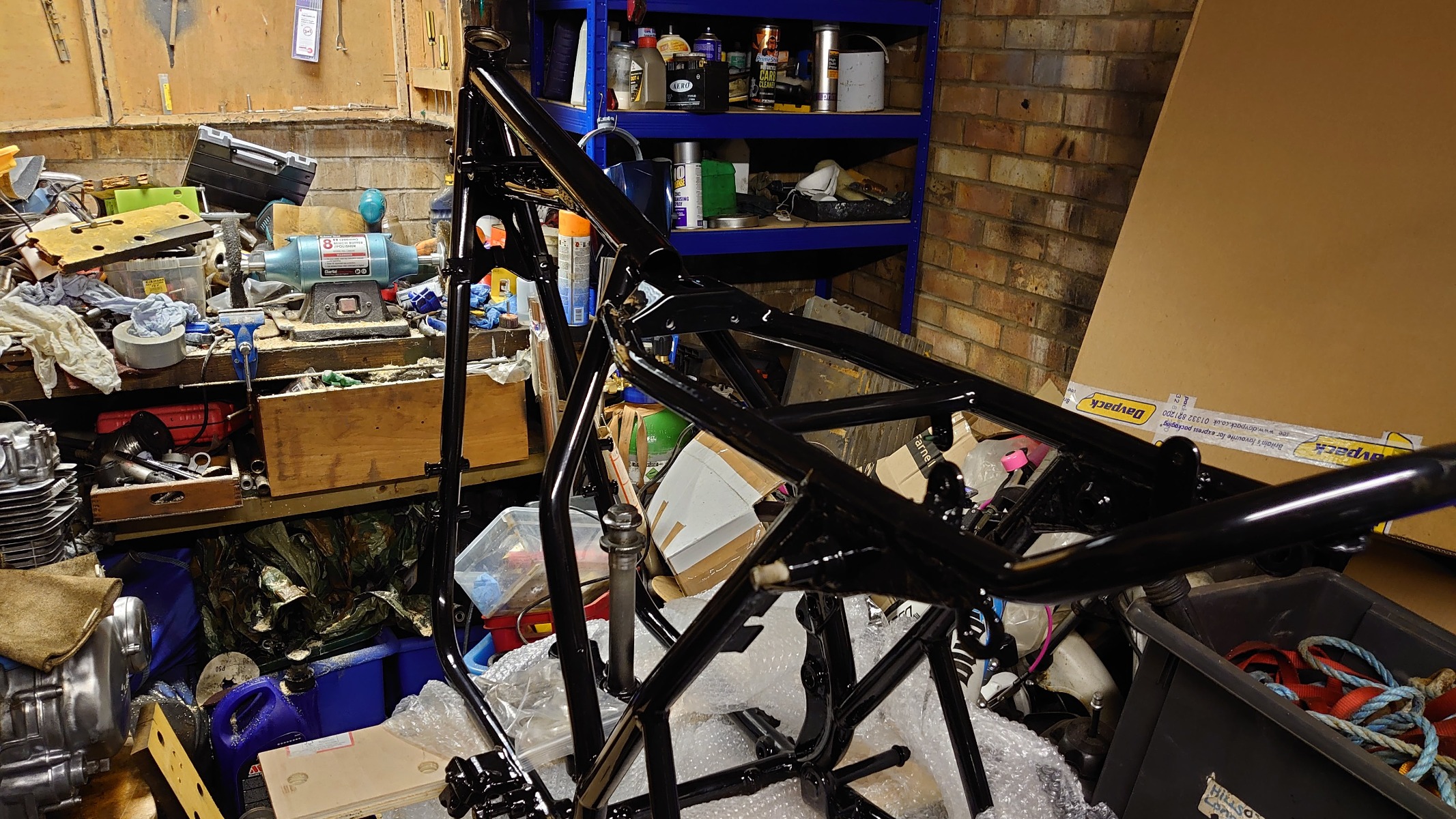

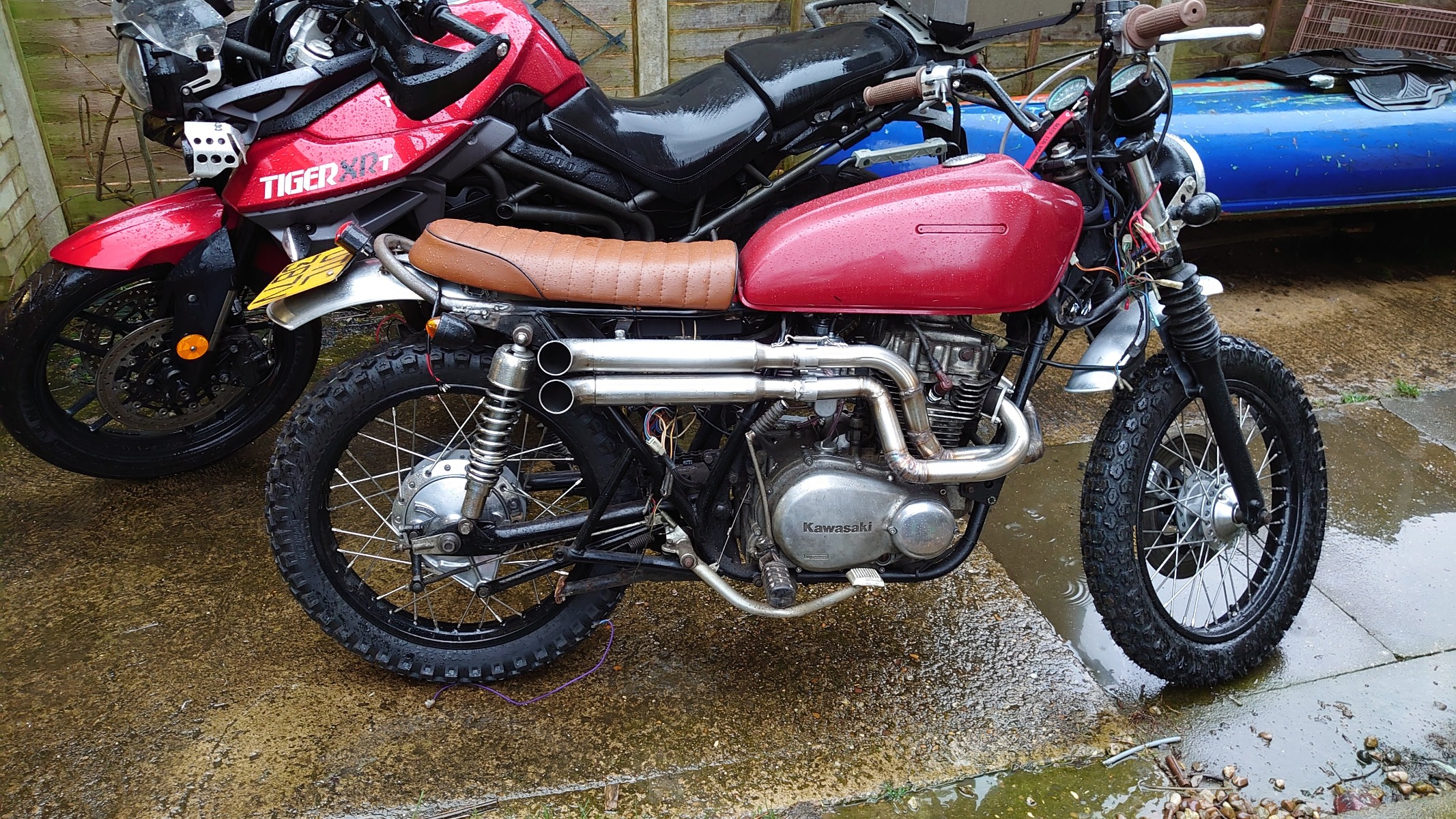

The rebuild has started!
I've got the newly powder-coated frame back in the workshop, I'm very pleased with the finish, you can't see where the welds are.
I've inserted a photo but not sure if we get to see for a while, but I'm sure the boffins are doing their best to sort the forum.

Well the photo uploaded okay this time so here is the earlier one!

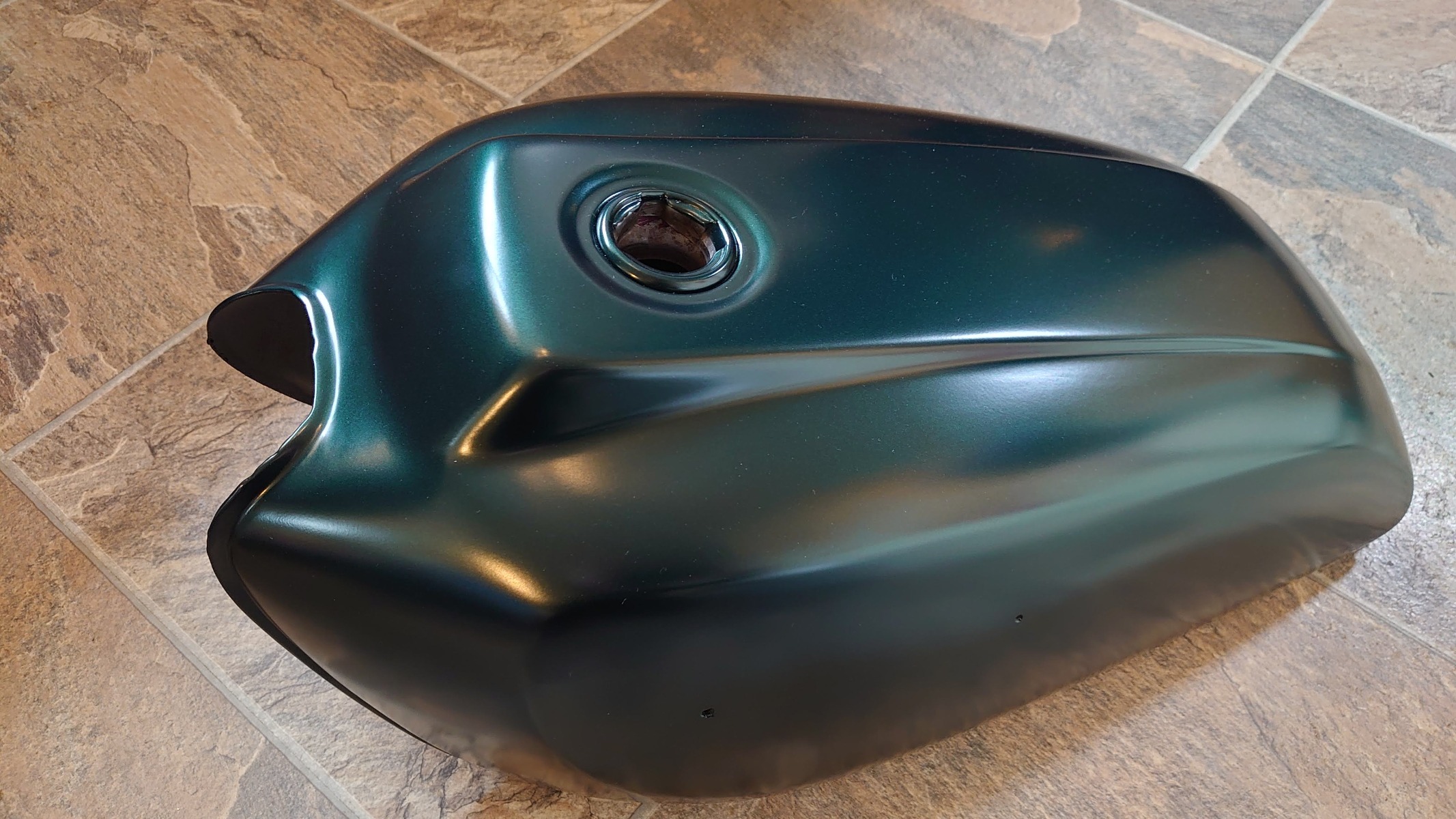

I had a call from the paint-shop yesterday, they wanted me to look at the swatch they had done, for the colour of the tank. I've gone for British Racing Green with a bit of bronze powder in satin, looks great!

Being to collect (and pay for) the tank, I'm very pleased with the colour, just what I had in mind.
  • TexasKZ
  • TexasKZ's Avatar
  • Platinum Member
  • Platinum Member
  • Posts: 8244
  • Thanks: 2707
Re: 1979 UK Spec Z400B2
17 Feb 2020 04:55
#819477
Nice
