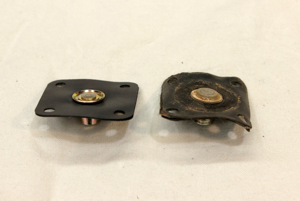

My next task was accelerating pump and its fuel valve. OEM diaphragms for both of them are not available now, so I bought this K&L repair kit:
Triangle thing on very bottom of second float bowl is valve actuator. As I wrote in one of my earlier posts, there are three types of Mikuni VM24 carburetors for Kawasaki KZ650 with accelerating pump. On some Mikuni VM24 carburetors chamber of valve actuator connected by channel to mostly same point where vacuum port for fuel tap is. Thus valve cuts fuel off when manifold vacuum is strong enough to overpower valve diaphragm spring. On some VM24 carburetors (like rack I own) there is no vacuum port in body of second carburetor, thus spring always keeps diaphragm in one position and valve is always open. This means that accelerating pump always has fuel and is ready to operate whenever you jerk throttle. Third type of VM24 carburetors have no valve at all, just uncovered place for diaphragm. In these carburetors accelerating pump always has fuel too.
Here is K&L valve diaphragm in comparing to OEM. That needle you may see on one side of diaphragm presses the valve in float bowl and opens it.
K&L spring is slightly stronger than OEM.
