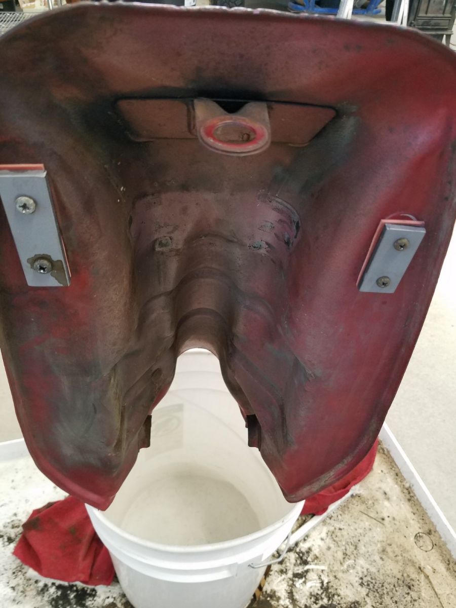

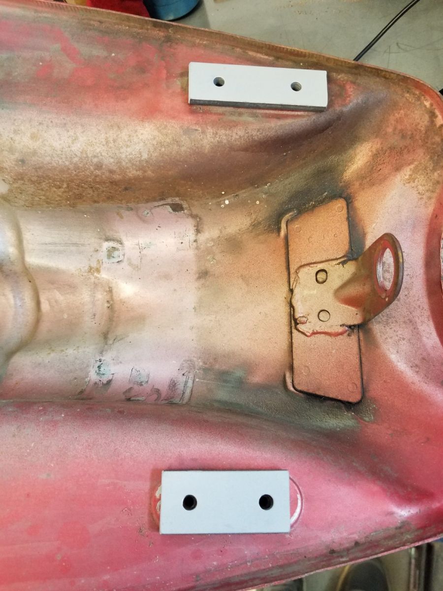

Getting the tank prepared for another round of chemicals to get rid of the rust. I made some block off plates from some 1/4" x 1" flat bar I had in the shop.
After reading the safety precautions on the POR15 Cleaner Degreaser, I was surprised at how "human unfriendly" this stuff is. Avoid skin contact, clothing contact, eye contact, vapor/mist/fumes contact or inhalation. Geez!! The rust remover was touted as water based, but it is a diluted phosphoric acid solution. Both present issues with disposal after use, more so the Cleaner Degreaser since it needs to be diluted at 4:1 ratio with hot water for use. More fluid to dispose of than the original container will hold once it's mixed. At least I can get the Rust Remover back into the original container. The Cleaner Degreaser is labelled as containing potasium hydroxide, butoxyethanol, and alcohols. A call to the county disposal may be in order.

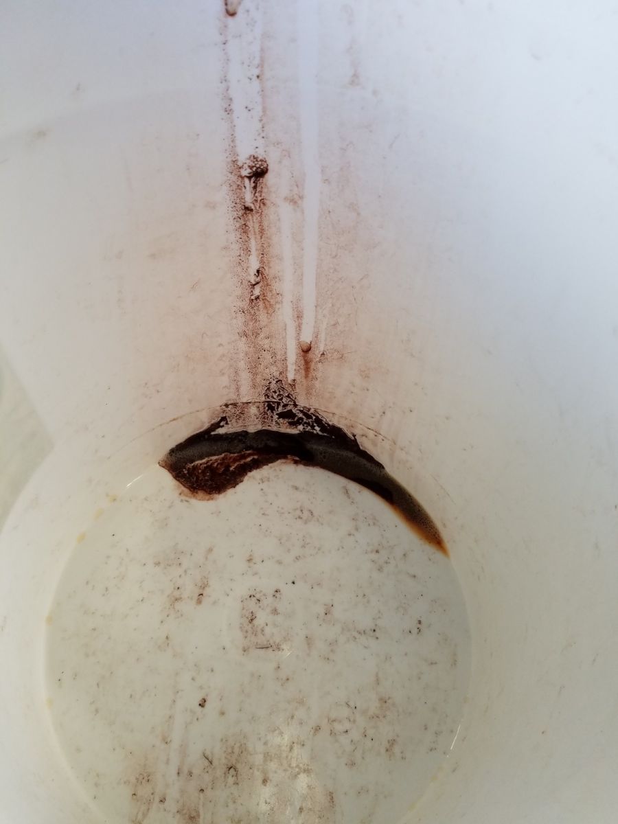

2-1/2 gallon mixture was put in at 140 deg F. Shook and rotated the tank for several minutes, then placed it back end first into a 5 gal bucket. Let it soak for a couple hours. When I took it out for another shake and inversion, a small sign of weepage on one plate. I can live with that!
It's now soaking for the second half. I will drain and rinse it tonight. Tomorrow it will get the Rust Remover treatment, a rinse with water, then a flush with a gallon of WD40. Once the bore scope reveals all the rust is gone, and it is sufficiently dry, I will bead blast the entire outside and take it to the paint shop. That is, providing no pin hole leaks show up! Fingers crossed!

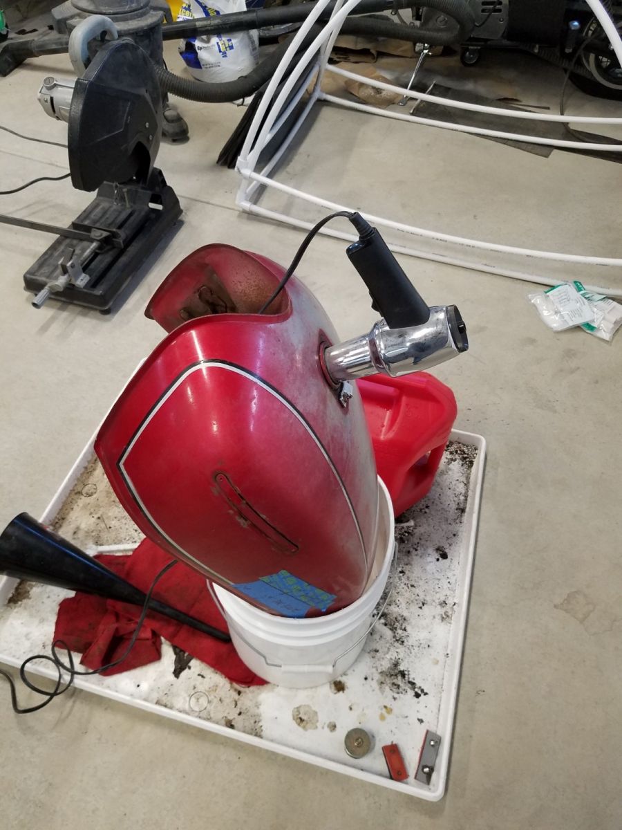

16 Apr 2020 19:03

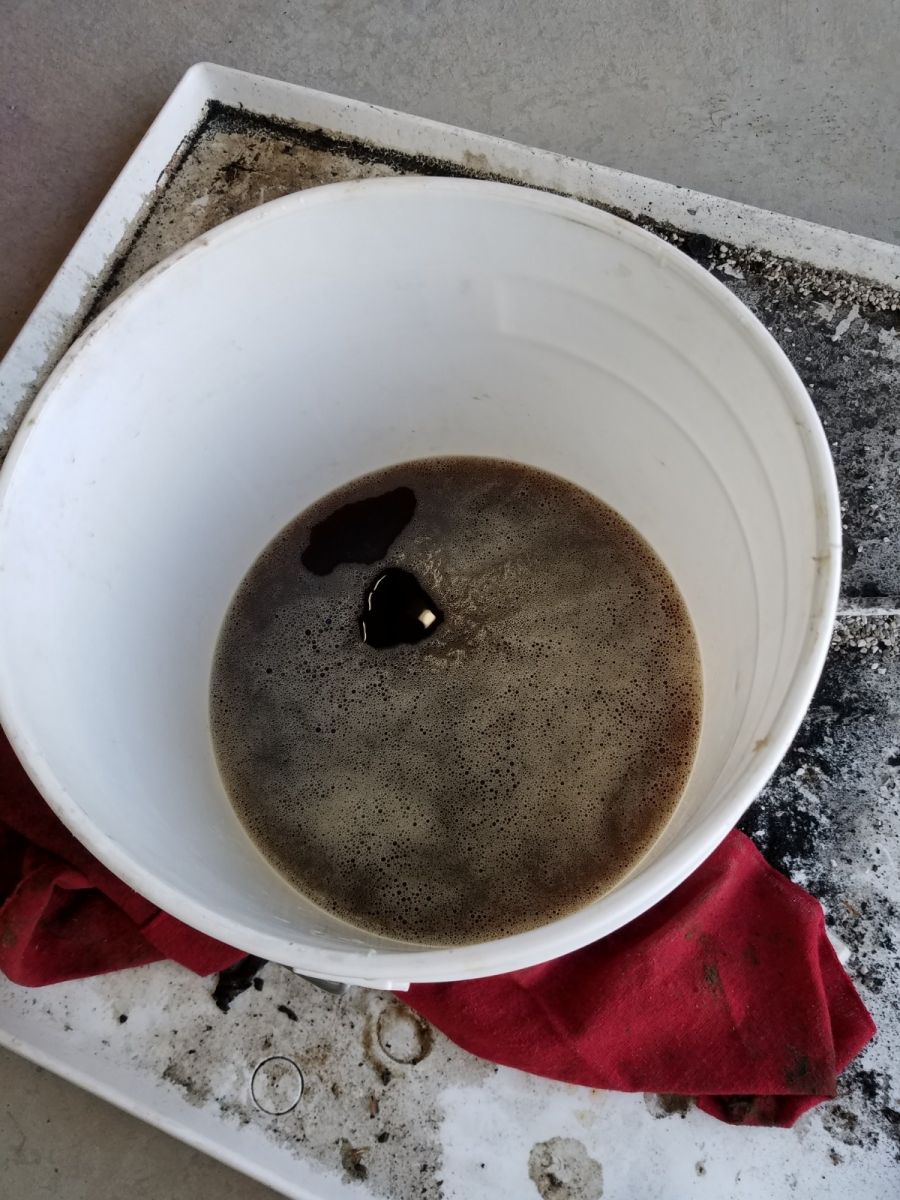

What went in clear, came out, well, not! A good bit of sediment at the bottom of the bucket.
Using a heat gun to dry the tank. I will see how it looks inside in the morning. The cleaner had the same color and smell as the inside of the float bowls. So I guess it did what it was supposed to do. Hopefully no more evidence of old fuel gunk.

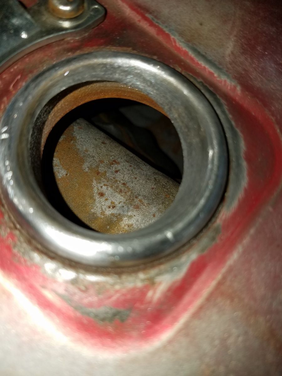

I have to say I am thoroughly impressed by the POR15 Cleaner Degreaser. Despite the cautions needed to handle it, and dispose of it after use, it certainly did the trick. All I can see inside the tank is orange rust spots. No more blackened areas. Time to move on the the POR15 Rust Remover.

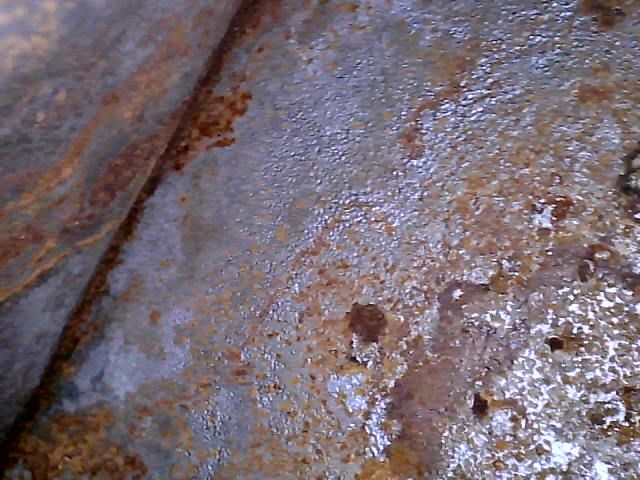

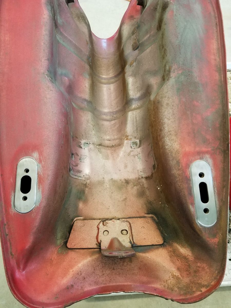

Re: Saving a '81 KZ750-E
17 Apr 2020 11:59

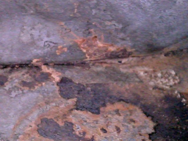

Before the cleaner
After the cleaner
Before I add the Rust Remover, I cleaned up the sealing surfaces removing all of the old paint and grunge.
After the cleaner
