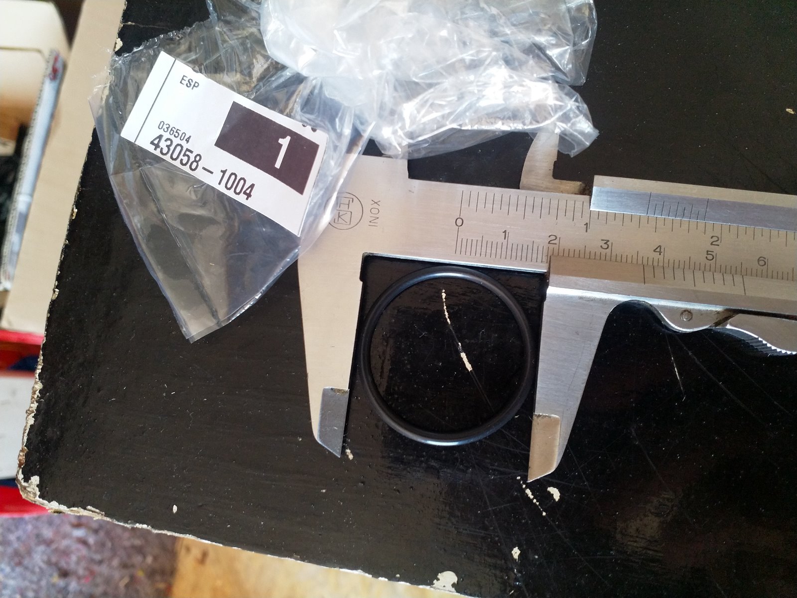

Impressed myself today by remembering to measure the o-ring
Cross-sectional diameter: 2.1mm (probably just 2mm)
Major diameter is about 36mm (the callipers in the photo below read 36.1mm)

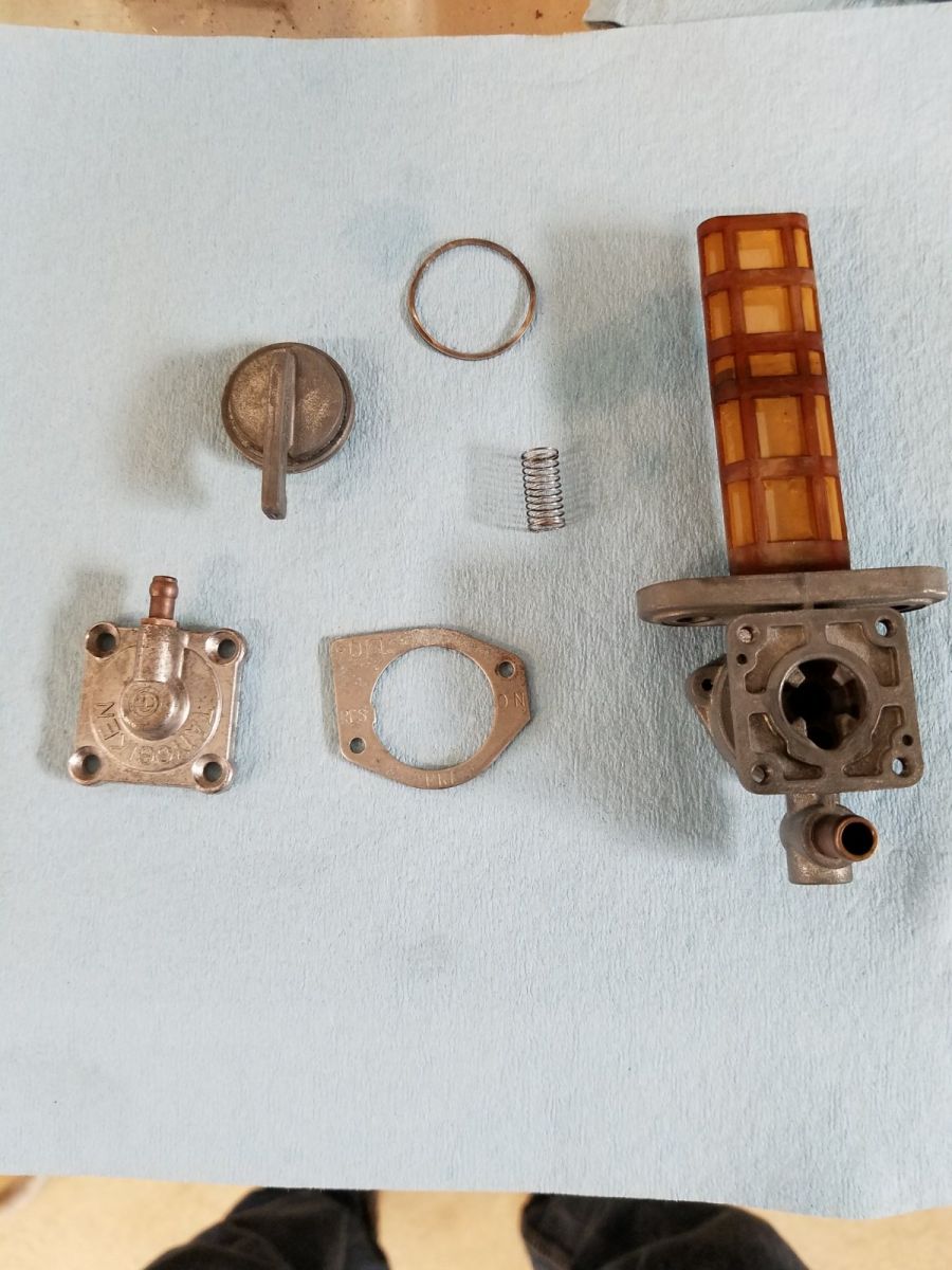

I came up with the same OD with measuring the groove. The depth is 1.75mm, and the width is 2.75mm, so I was guessing a 2.5mm cross section. The petcock parts including the screen and frame survived the parts dip. Everything cleaned up well.
With your help, I managed to track all the parts down on Partzilla. $44 shipped works for me just to plug the hole. We will have to see if the switch works when the bike gets completed.

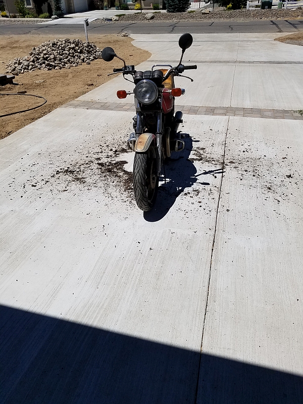

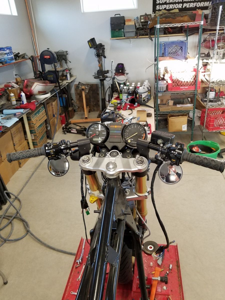

Half of my POR15 chemicals showed up today, but it was the second step in the process. The cleaner/degreaser won't arrive until later next week. But on a brighter note. I also got my new mirrors today! A bit tight, and the final adjustments will need to be done when it's on the ground.

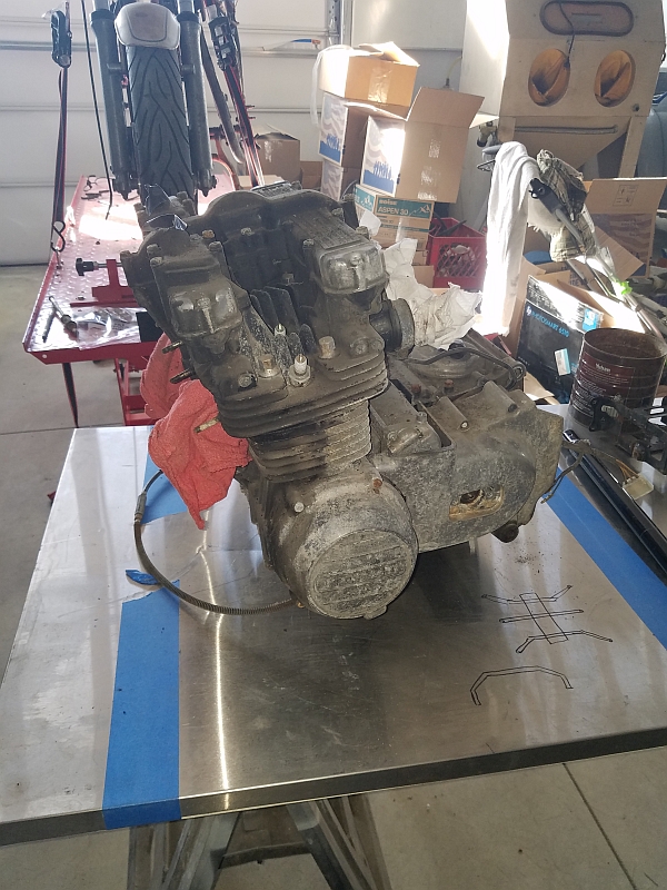

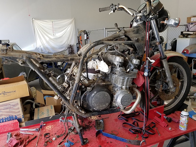

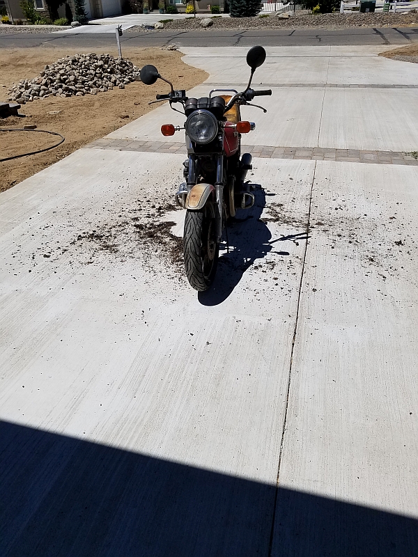

I was going through some older photos of when I first started working on this project. Just a reminder of how bad this bike had gotten before I picked it up. Hopefully the original owner (a very close friend) will be able to come for a visit after all the travel restrictions are lifted to see how much his old bike has changed since he last saw it!
The debris field from the first time blowing it off with compressed air. After all the bodywork was removed, I had this same amount come off a second time from areas the air couldn't reach.
Unfortunately the PO's maintenance, or just plain washing it once in a while, was virtually non-existent. Refinishing the engine cases is still something I am not really looking forward to.

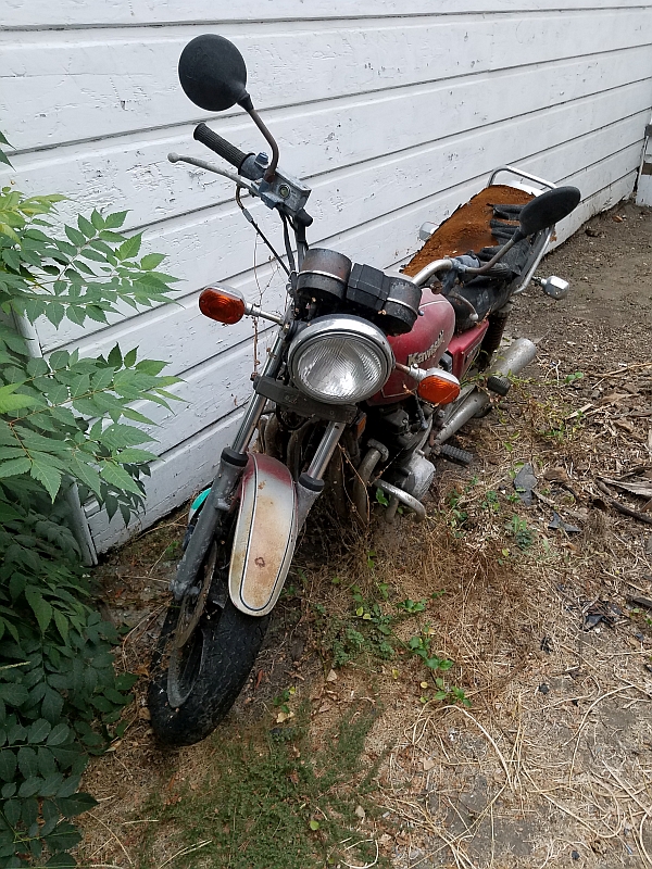

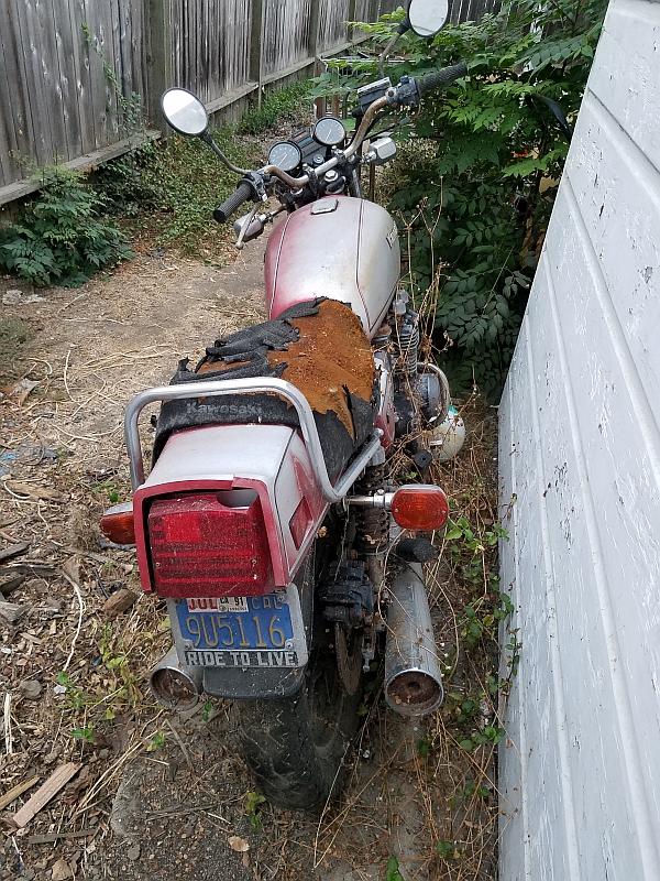

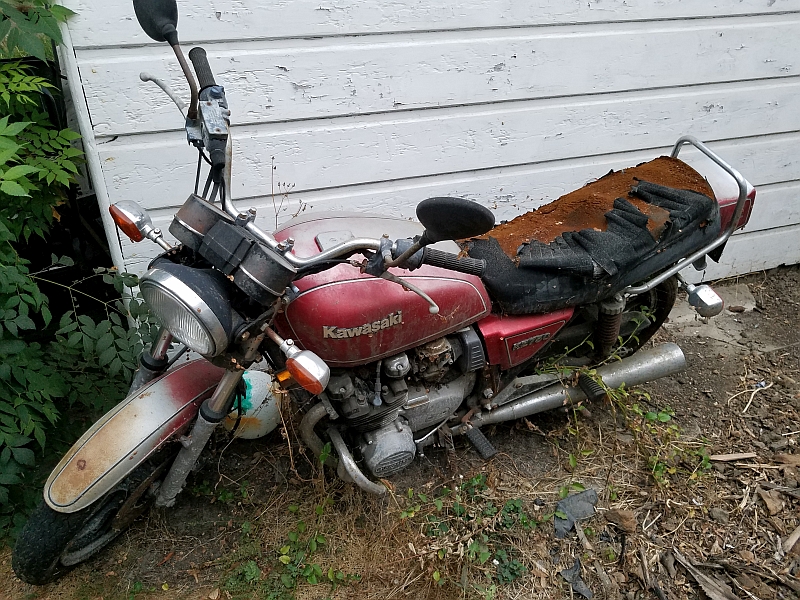

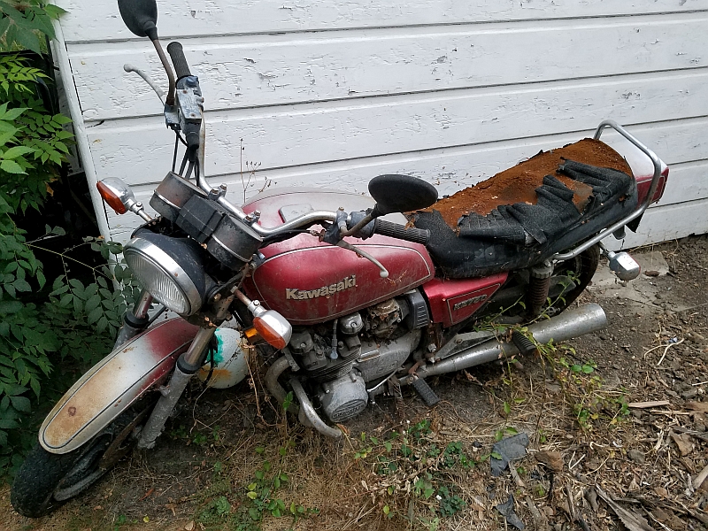

These are from the day I picked it up. I had to take off the front wheel and get a new tire put on it just to roll it to the trailer. Surprisingly enough, the rear tire was still holding air. Twenty eight years in one spot. The front tire was gone due to sun exposure, I guess the rear was more covered and didn't suffer as much damage.
The registration tags expired in July 1991. It was kept active on a non-operation ever since.
