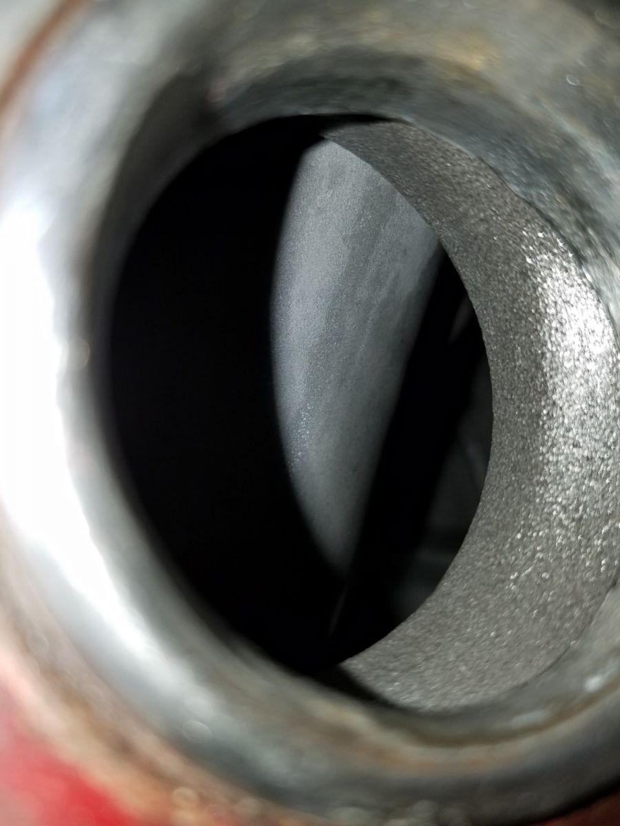

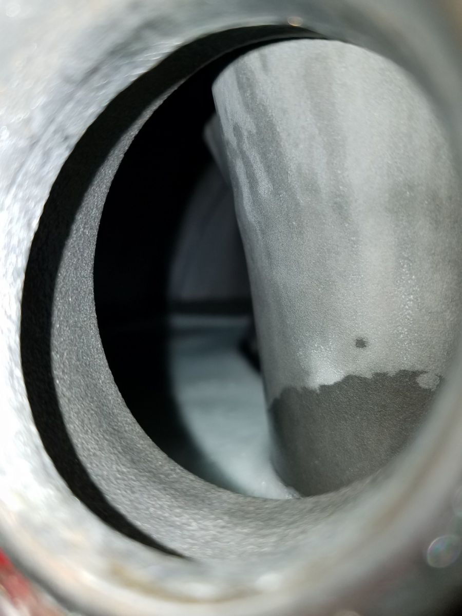

24 hours into this soak, so I turned the tank nose up (was vertical, nose down). I couldn't resist peeking inside to see how it's going. At 3 gallons I figured the fluid line is still below the fill neck. It looks like this stuff is doing the trick!

The inside of the tank looks really clean and rust free, you did very good job Skidmark!!! Now it´s time for the final coating.

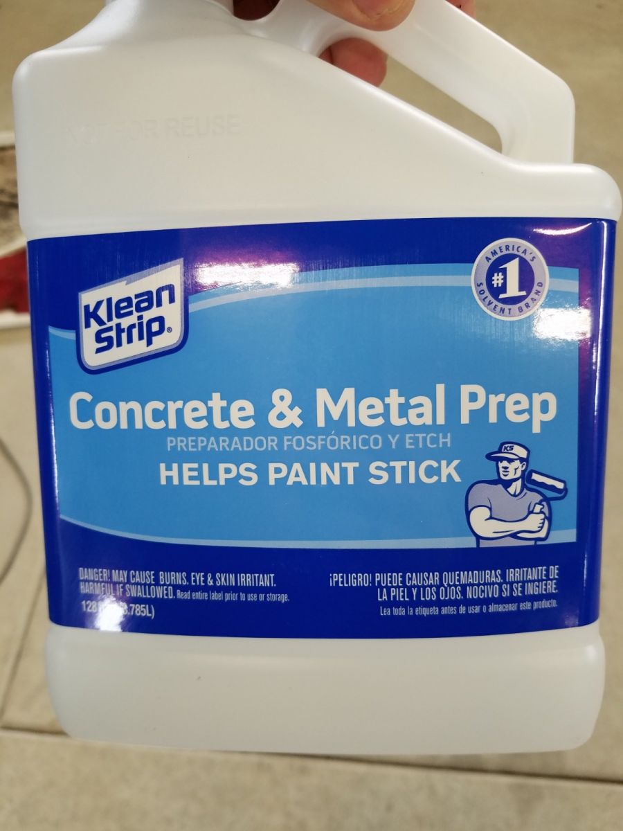

May i ask. what brand of phosphoric acid did you use?

Nessism posted this link earlier in my thread:

Kudos need to be given, once again, to Nessism. His advice through this process so far has been a tremendous help. I tried my own way to clean this tank, and his earlier suggestion turned out to be the one that worked the best. This forum rocks!!
