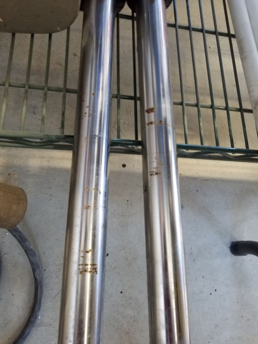

I'm only really interested in the uppers - mine have a bit of corrosion. It's not bad and you can hide it by turning it towards the downpipes. But if I could find a decent replacement I'd probably chuck it on the shelf until next winter and then swap it out. Probably better for you to keep them together, though. If you do sell them it will be easier as a set.
Postage would probably be a killer for me anyway. Still, let me know if the uppers are in good nick and if you'd be willing to separate them - normally I'd just offer to buy the forks as a set, but postage...

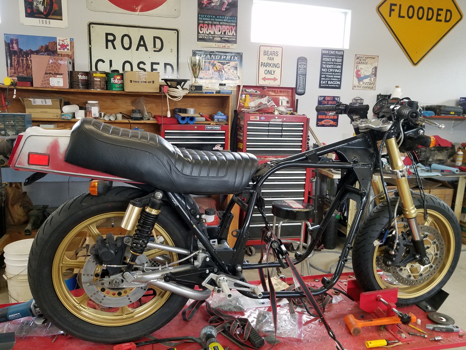

I finally got to sit on the bike, with the seat, rearsets, and bars in their place. It will be interesting seeing what fatigue I have on long rides. It's been 26 years since I have owned a ridable motorcycle. A year ago I got to go on a ride using a friend's bike, and I must admit the first five miles were quite, uh, exhilarating! Borderline terrifying, actually. But it all started to come back (from the cobwebs) and was able to settle back in.
