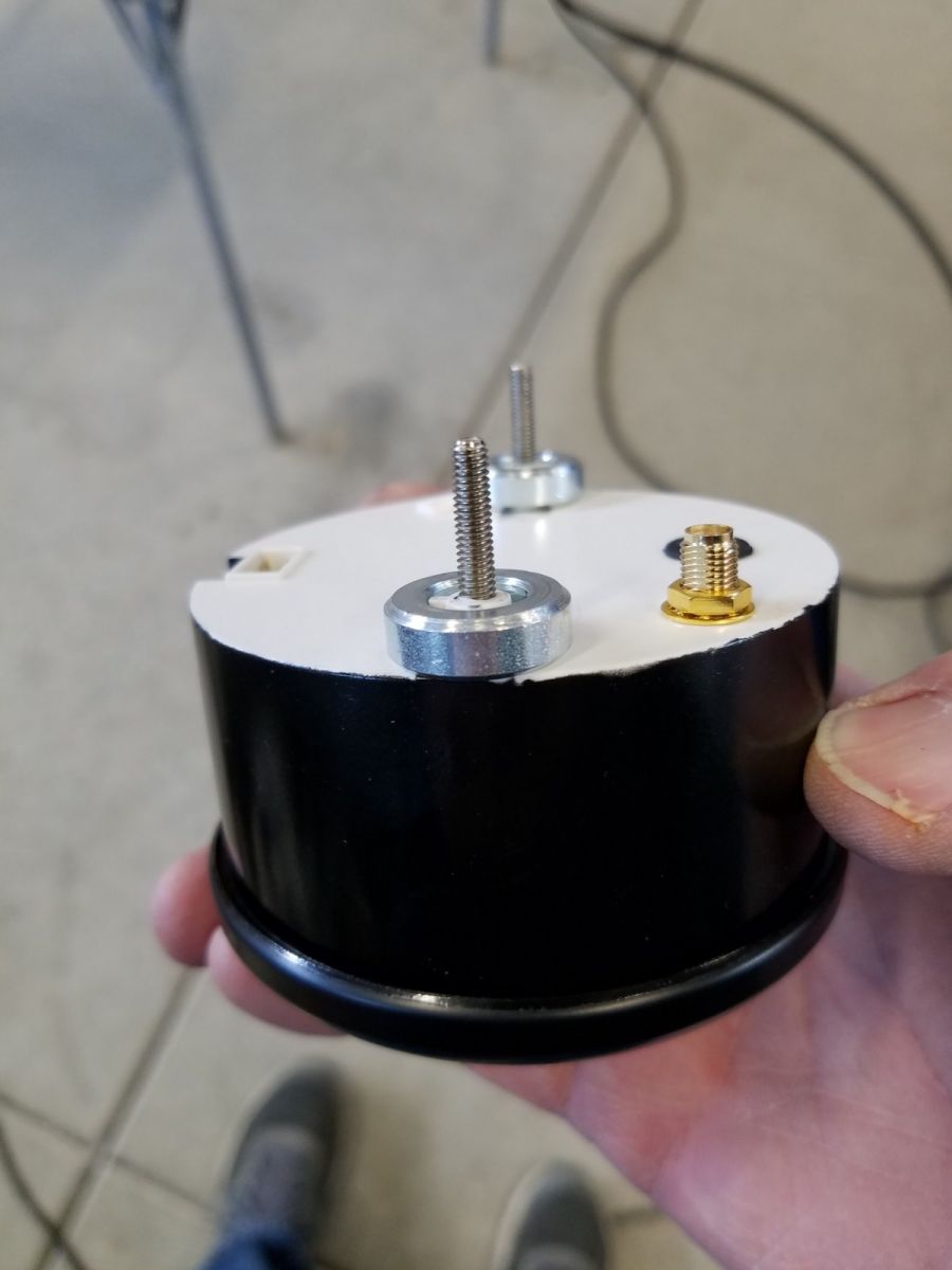

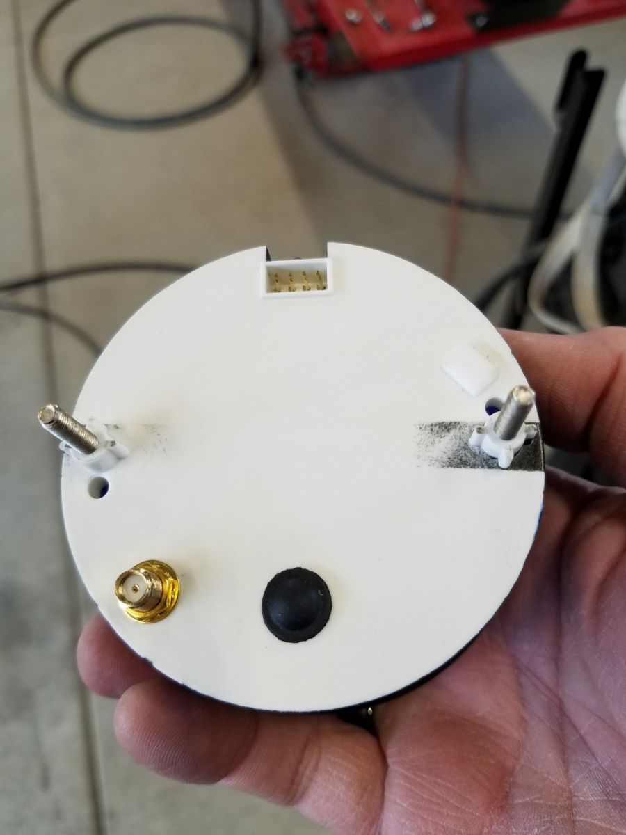

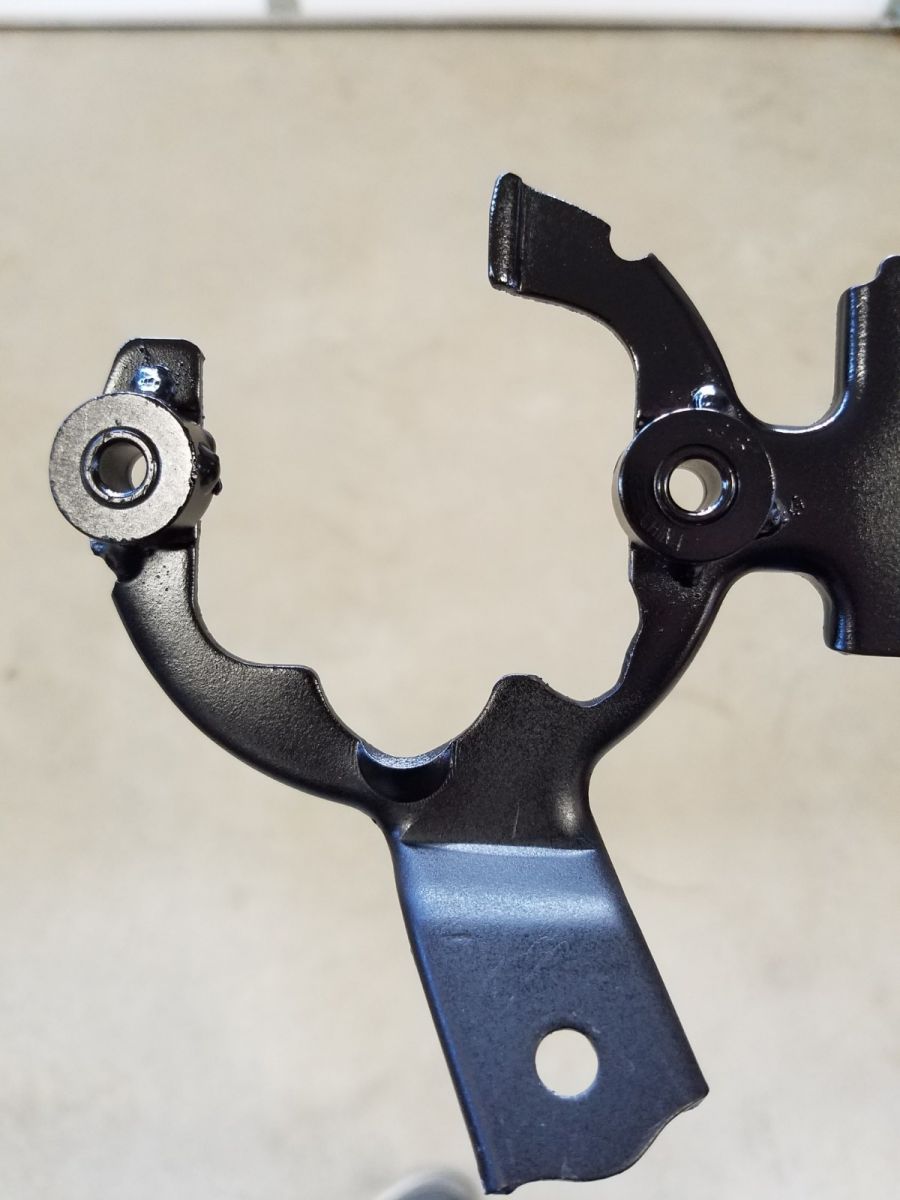

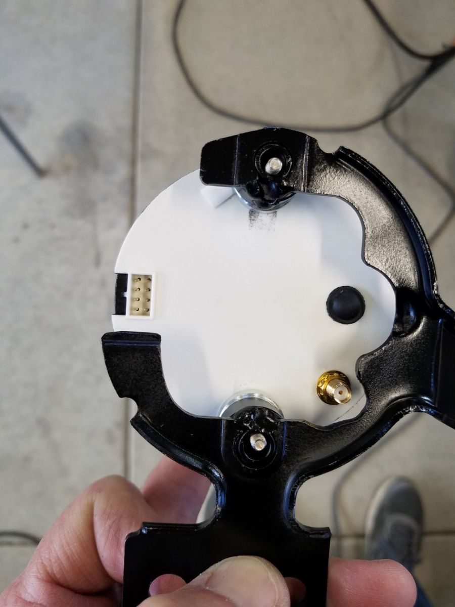

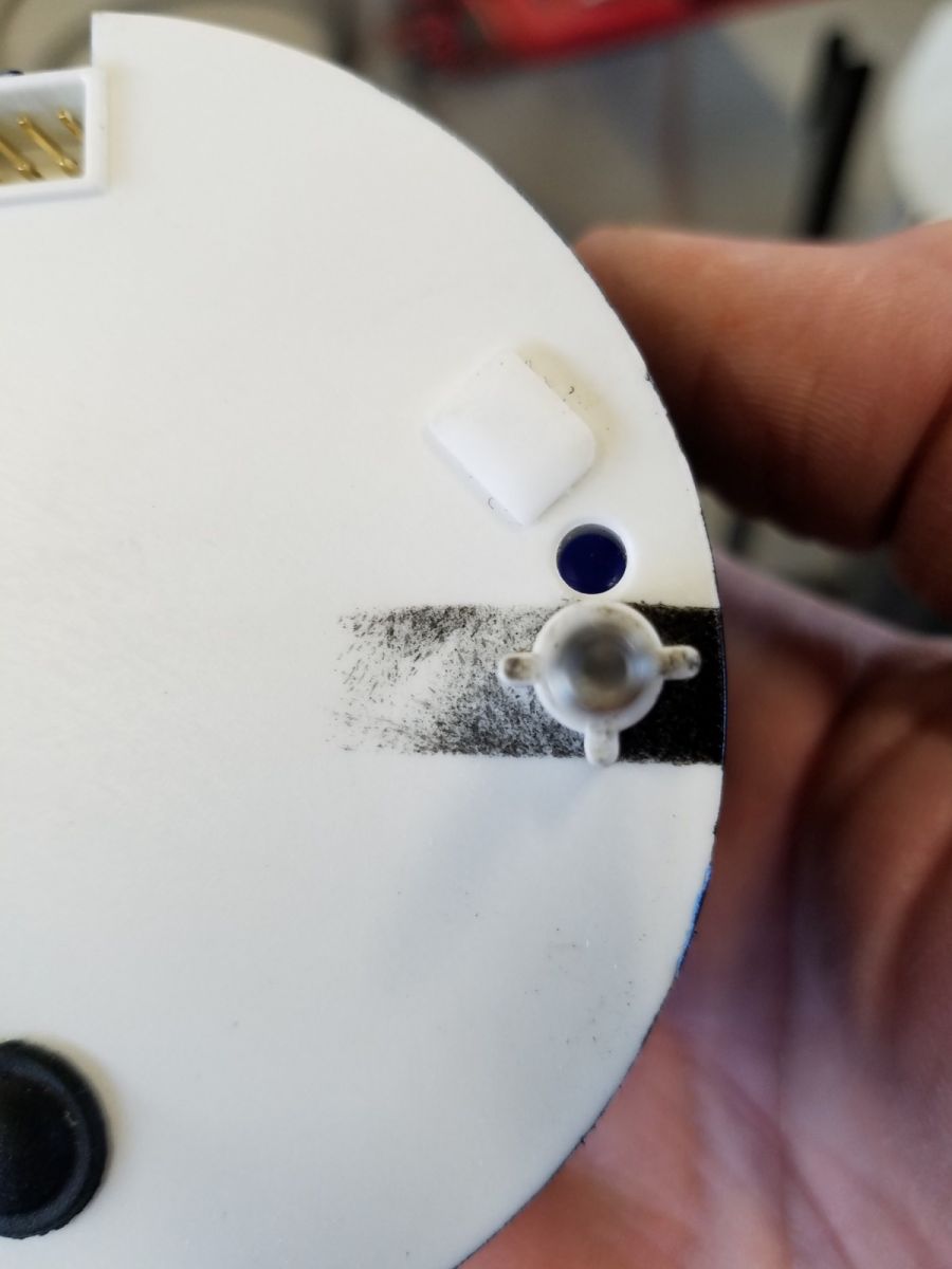

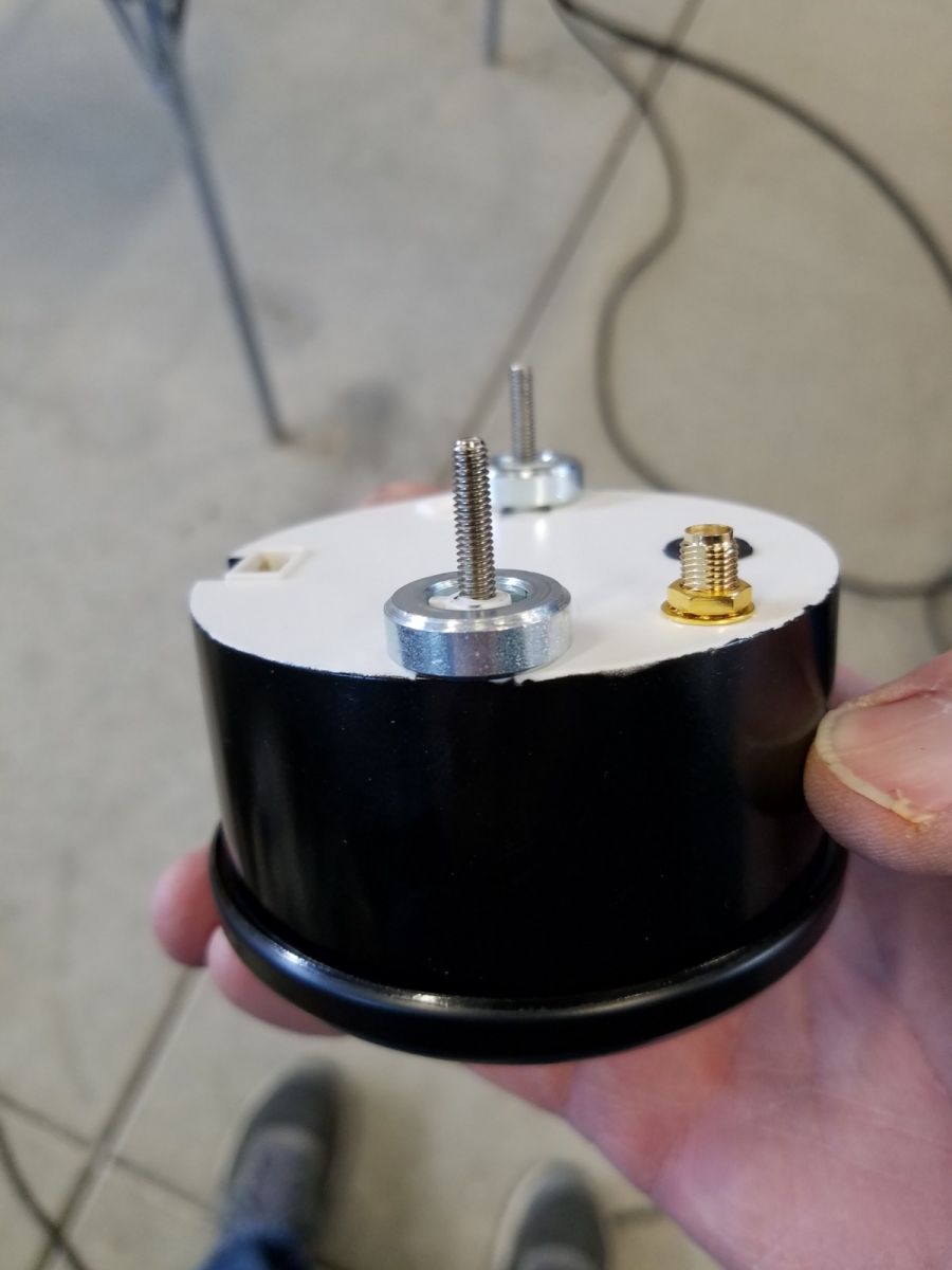

While the petcock is soaking (or desolving!) in the carburetor dip, I thought I would post up my mounting solution for my gps speedo. I am using the stock gage mounting bracket since I am retaining the oem tach. The speedo was advertised as a motorcycle or car application. Unfortunately it came as a panel mount. I didn't want to fab a new bezel or panel for it since I would never get it looking decent. Here is the back of the new gage.
An unusual configuration for this application in my opinion. My solution is not a rubber mount, so I hope there aren't any vibration issues.using some steel spacers and set screw collars, I created a larger surface area at the correct height to match the tach. I tack welded the set screws on the collars after tightening, then tack welded them into the stock bracket.

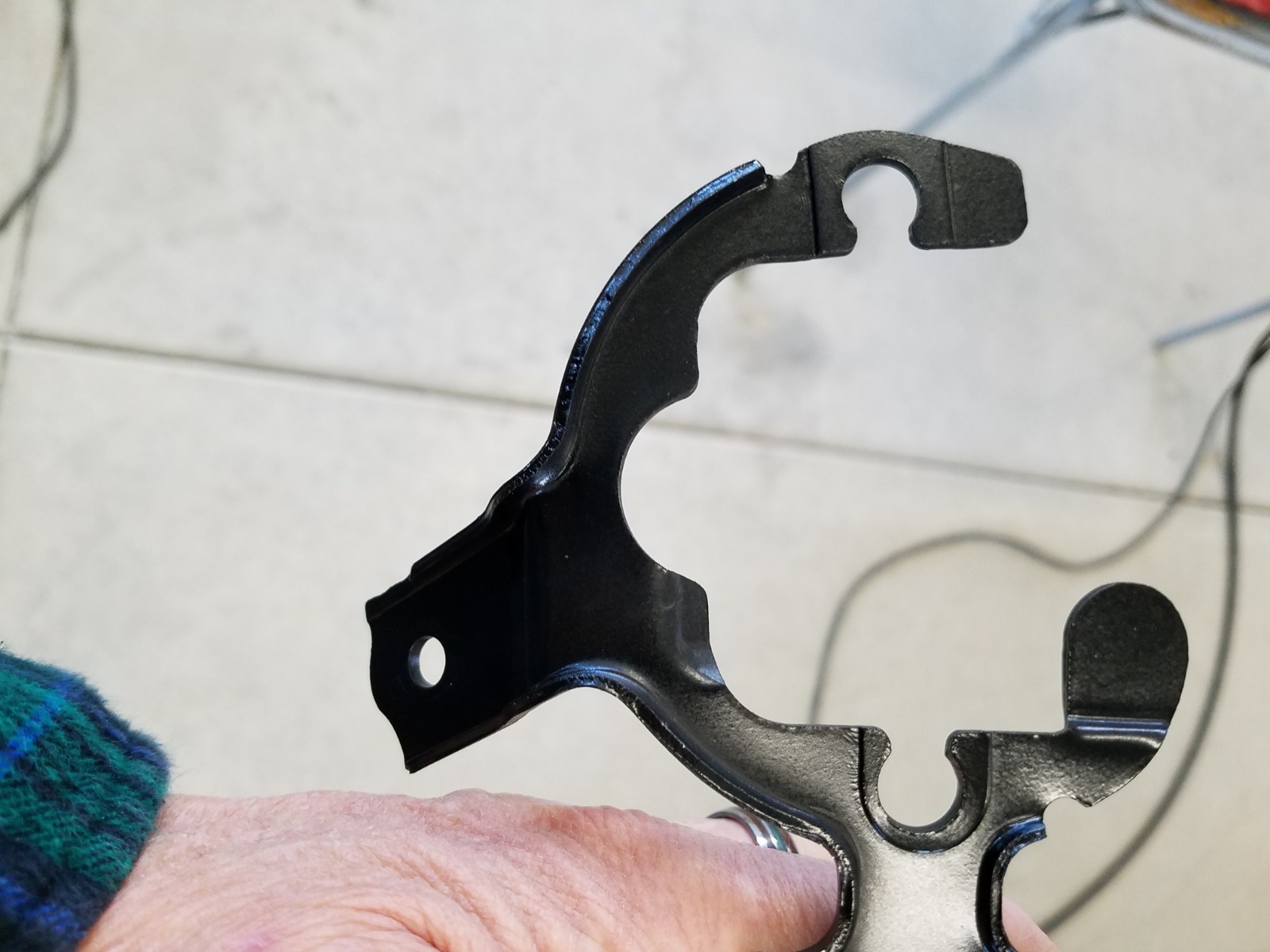

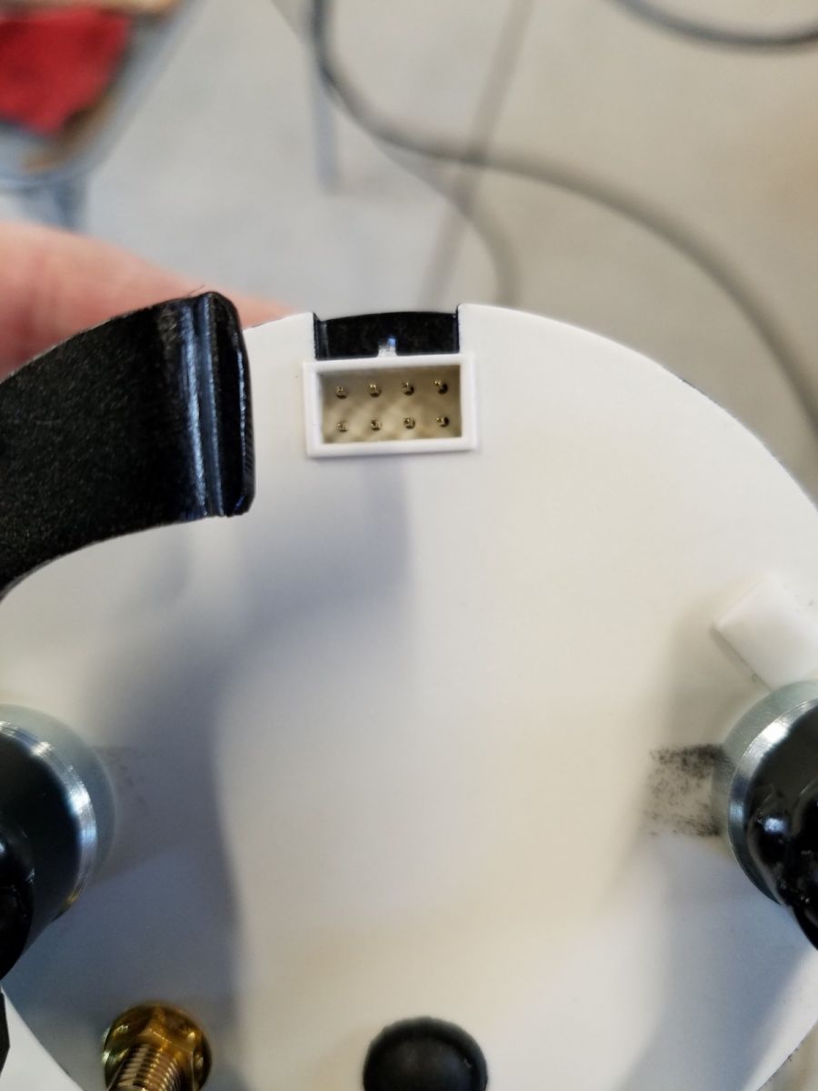

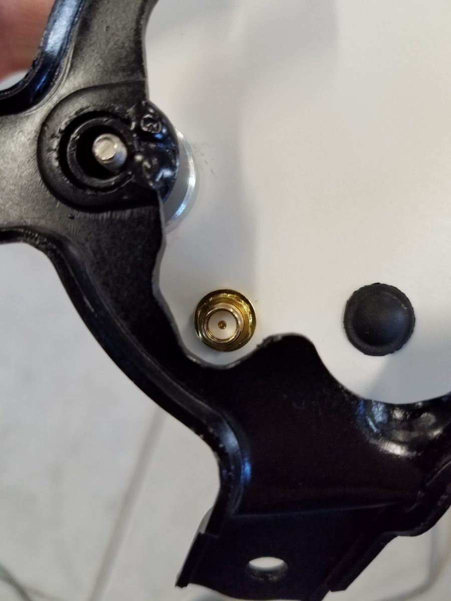

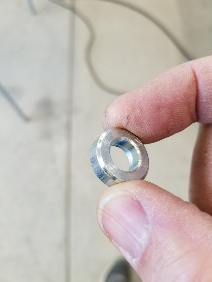

The speedo had a slightly shorter spacing on the mounting studs than the stock set up. And a much smaller diameter thread. This spacer set up allowed the gage to sit flush on top of the plastic stand offs. The centerline doesn't match, but it maximizes the area of contact.

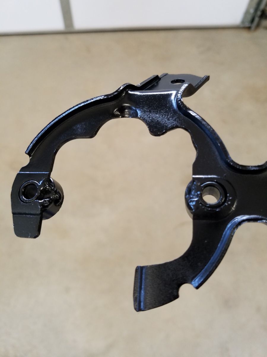

I also had to clearance the stock bracket for the signal cable, and electrical wire connector. This is the tach side for comparison.
The areas that were clearanced.

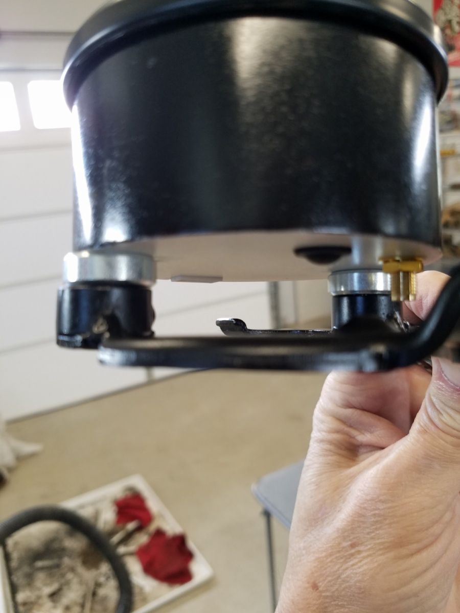

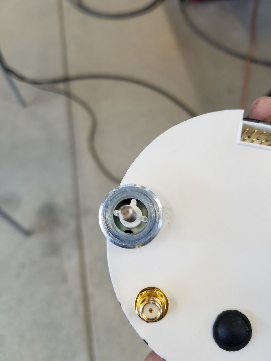

In order to increase the mounting suface area at the gage contact point, I found some spacers at the hardware store that fit perfect on the gage.

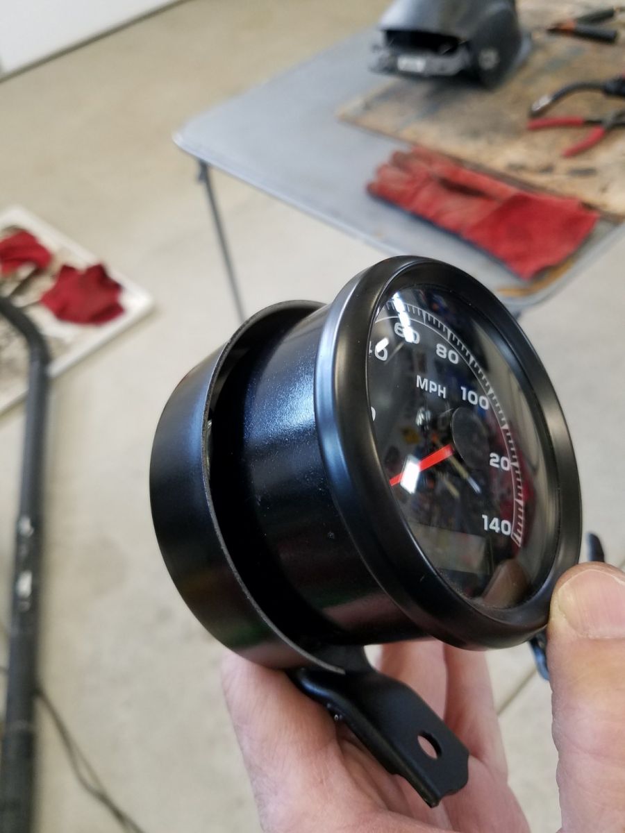

I painted the outside of the gage semigloss black to match the stock speedo bezel.
It still looks like it is mounted in a frying pan, but from the front of the bike it looks better than I could have fabricated, using both stock gage bezels.
