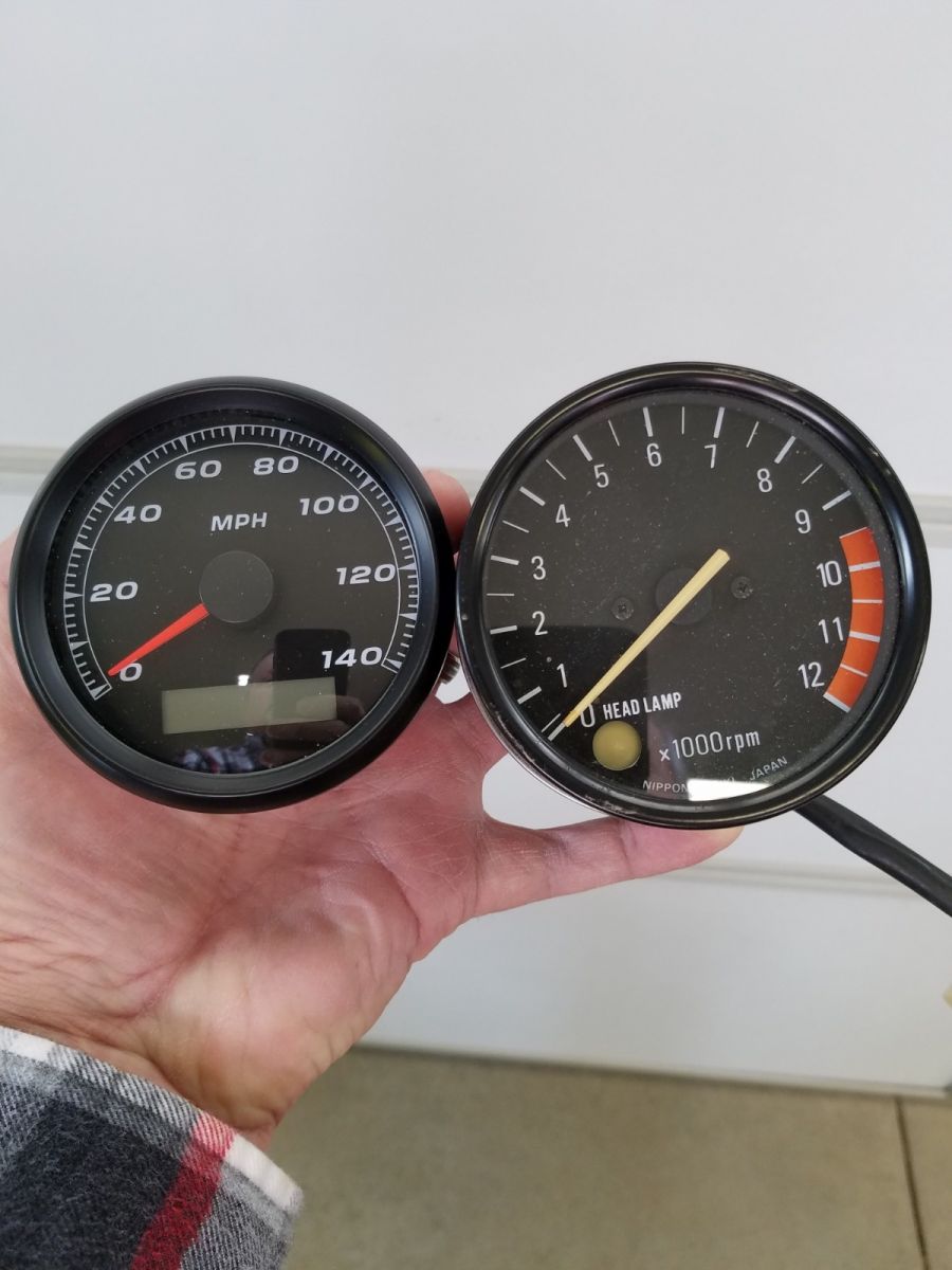

I've been gone for a little while. Trip to Canada, working on a neighbor's tractor, and life in general pulling me away from the bike project. Finally have some free time, and look what shows up.
Now I need to design a clean mounting method. This is a GPS driven speedo that is meant to be mounted in a hole in a dash panel. Since I won't be running a nose fairing it will need to look clean when installed.

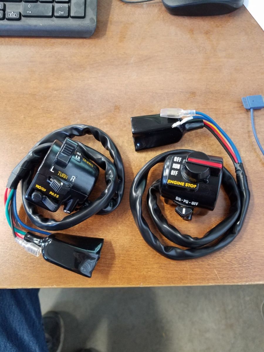

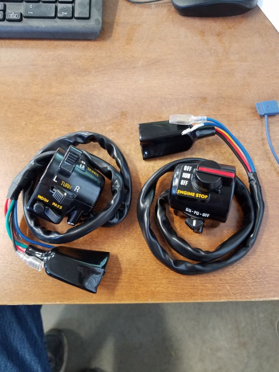

I went ahead and bit the bullet on these handlebar switches. A little rewiring and they should work fine. They look just as advertised.
DoctoRot wrote: rebuilding those switches might be a test of insanity. they look pretty shot. if if you pretty l them up i think the terminals and contact points will be still problematic with that much corrosion. You can get some reproduction KZ900 switches that work well, and have a very similar look. I run them on both my KZ's. only downside is the kill switch is orientated right which is easy to accidentally hit with your hand. I solved that problem with quick turn throttle sleeves.

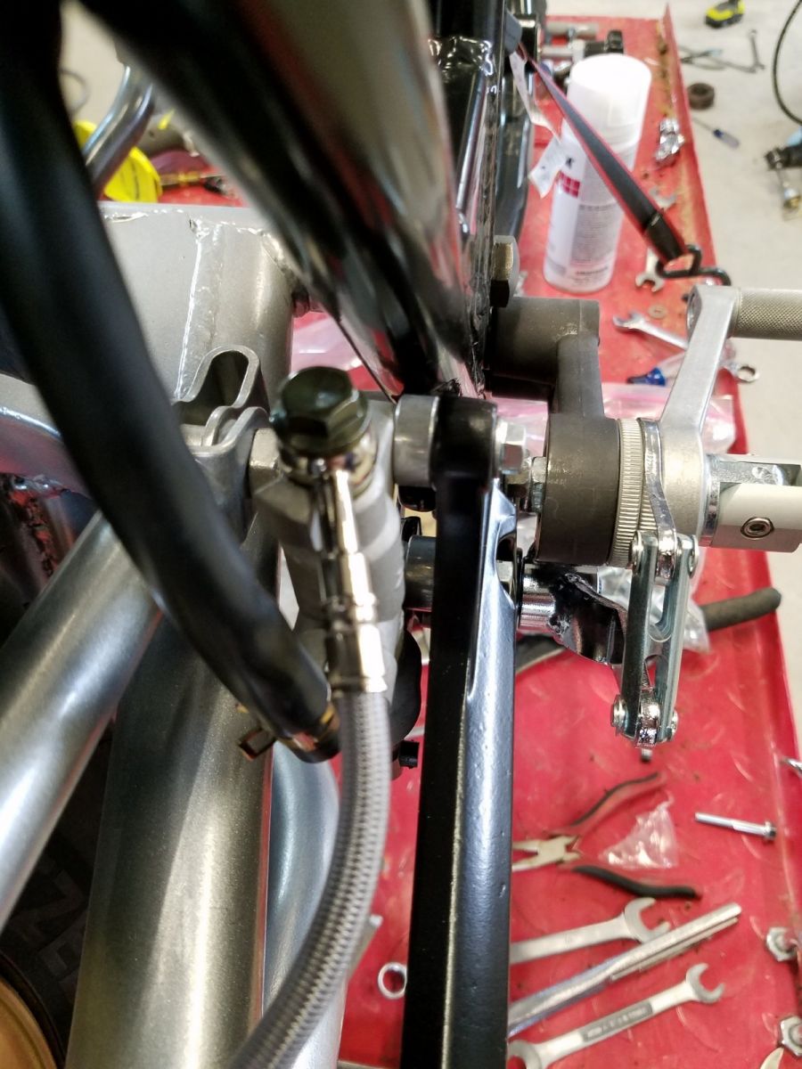

11 Mar 2020 15:40

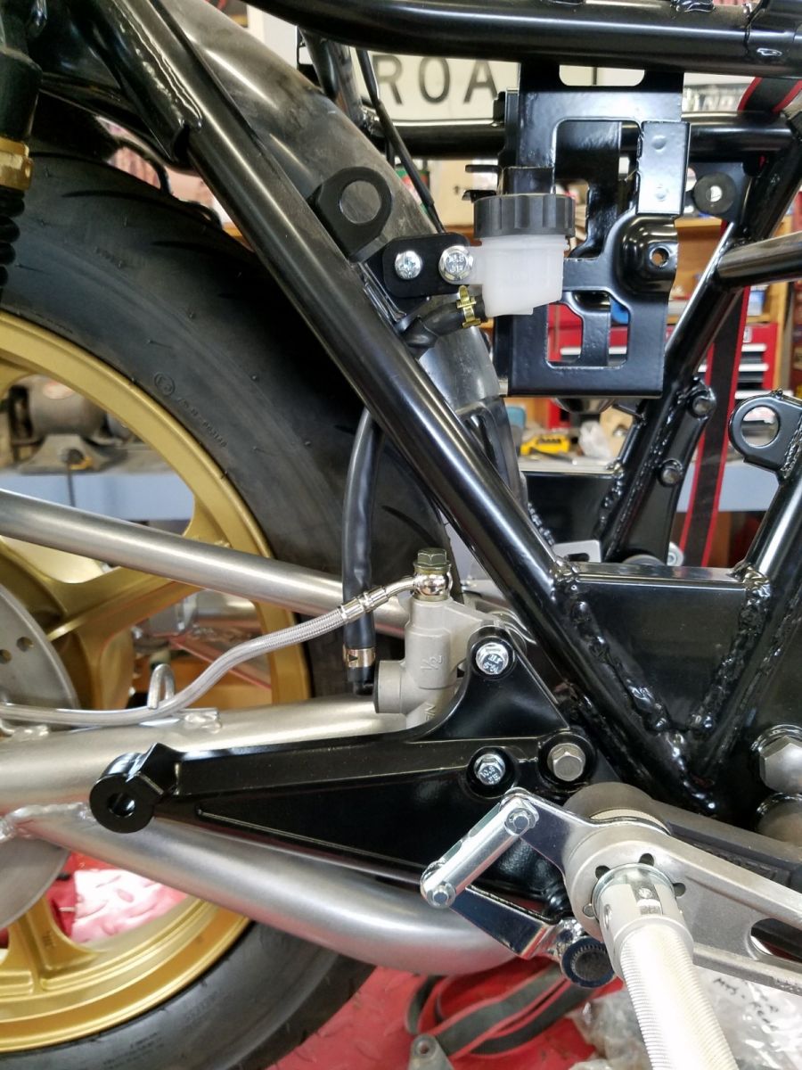

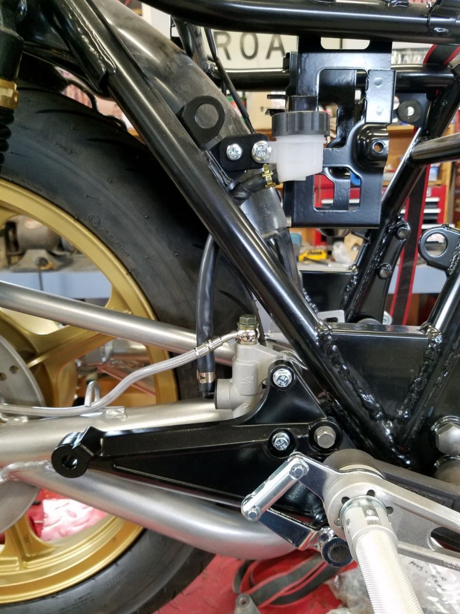

I finished installing the rear brakes. Now both front and back brakes are ready for fluid and bleeding. The spacers worked out good mating the newer MC to the stock bracket.

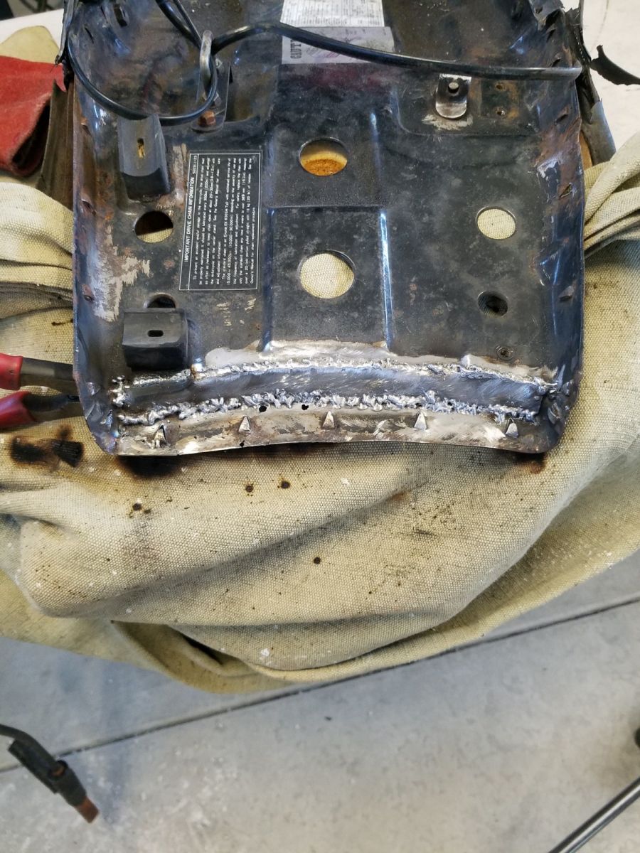

Re: Saving a '81 KZ750-E
13 Mar 2020 13:56 - 13 Mar 2020 13:57

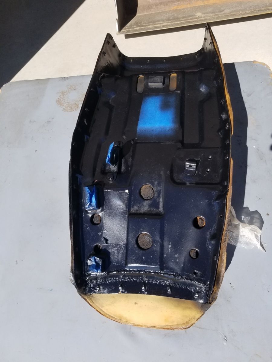

I ended up having to add a strip of steel sheet to the front of the seat pan to repair rusted through metal. I wish I learned how to TIG weld! Using a MIG welder for thin sheet is difficult at best, so don't critique too harshly. Some painting and clean up and it will ready for the upholstery.

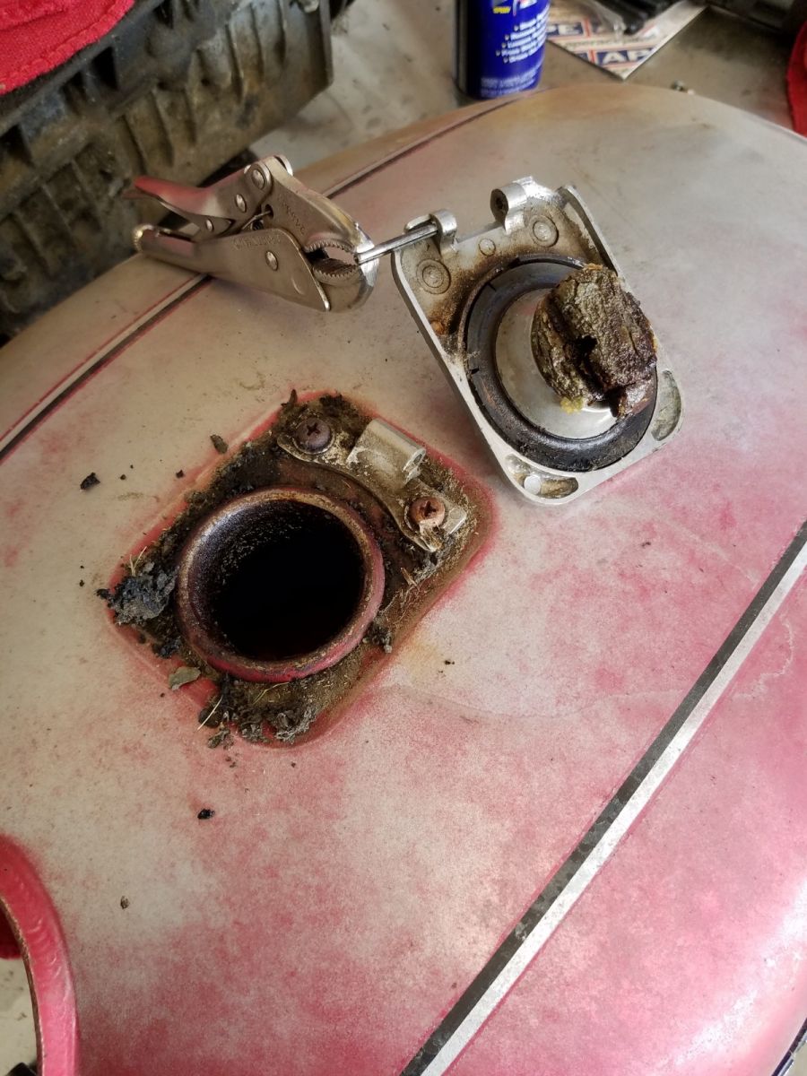

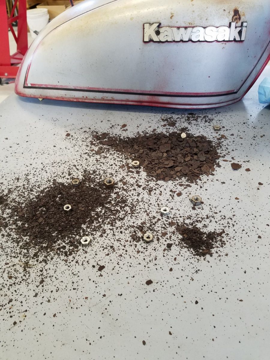

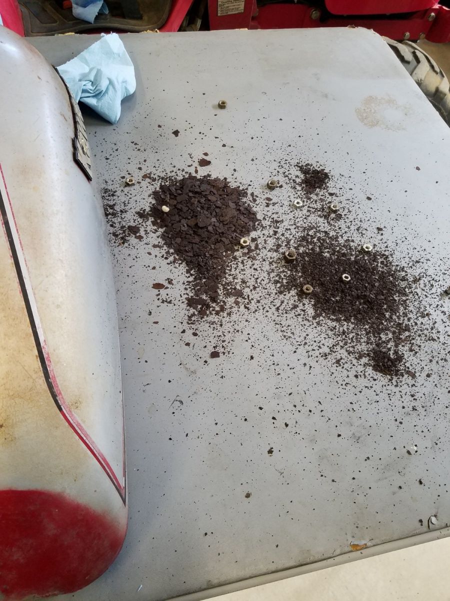

After draining the 28 yo gasoline and letting the tank dry inside, I threw in a handfull of nuts and got to shaking. Wow. I didn't expect this much to come out...

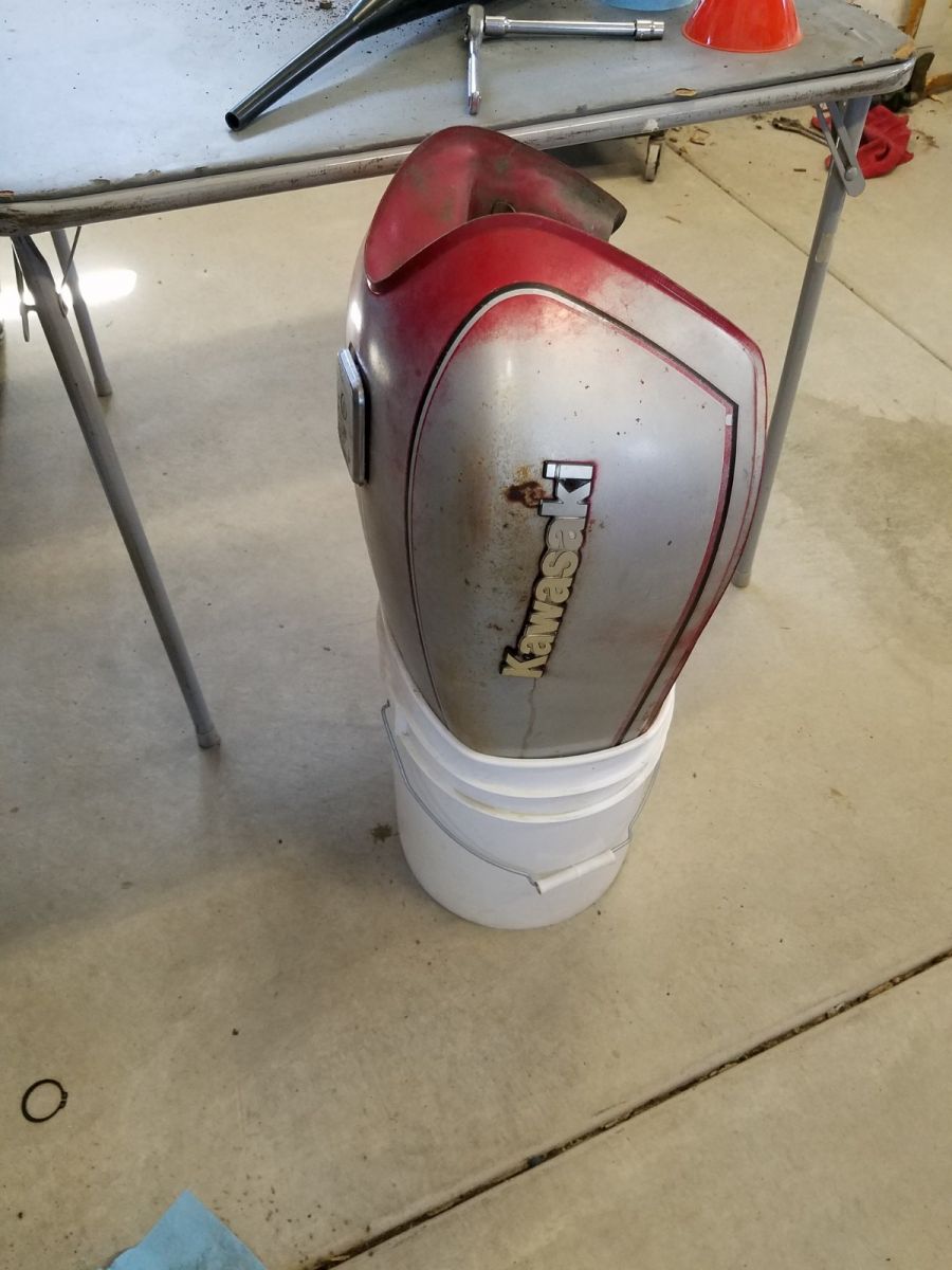

14 Mar 2020 14:09
I love the fact that the shape of the tank works great with a 5 gal bucket! My sophisticated leak containment system. The old petcock o-ring is seeping a little. The gas cap leaks a lot, so I will pick up an expanding rubber plug for when it gets flipped over for the other half. I put about 3 gallons in it, so it will be above the soak line. This tank is about 4.5 gal capacity.
