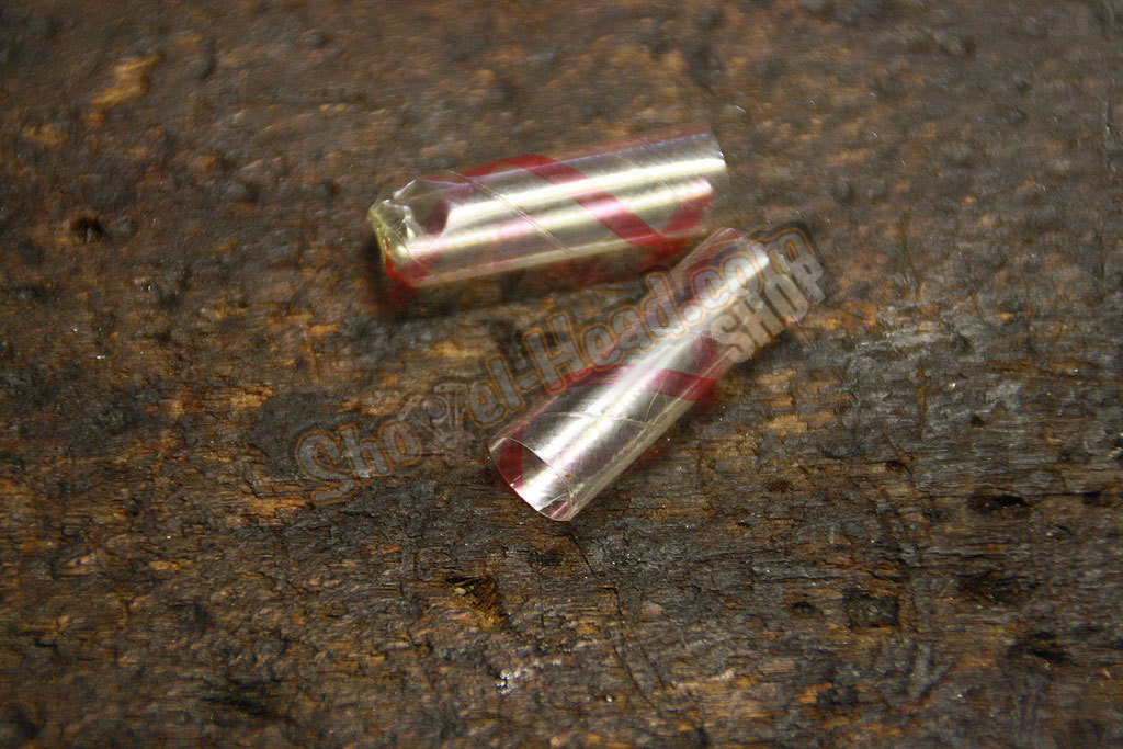

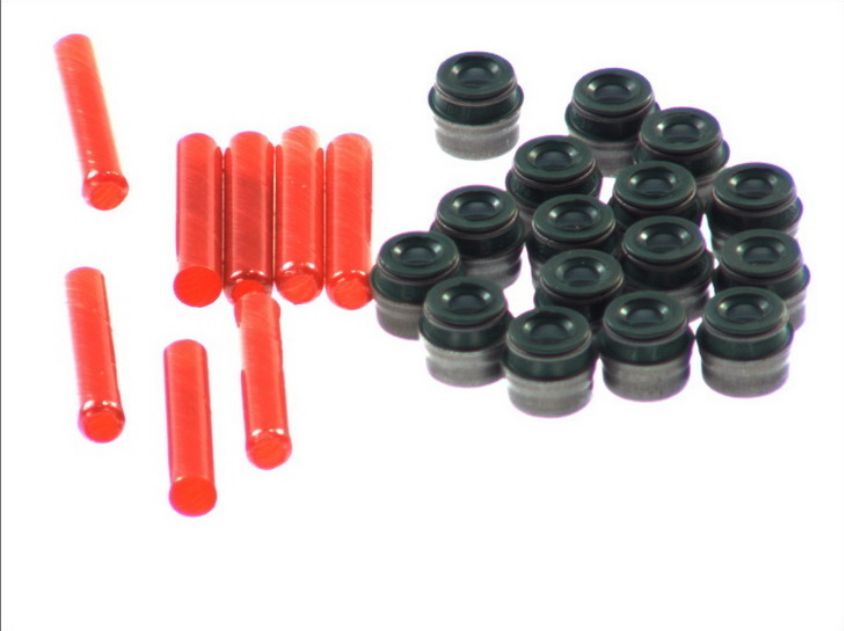

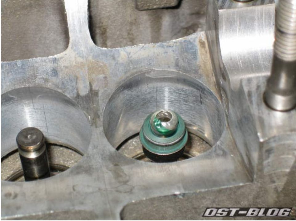

28 Jun 2018 16:11 - 28 Jun 2018 16:13Scirocco wrote: And always use a condom for the new valve seals. :laugh: :laugh: :laugh:
The condom i am talking about is a plastic tube that goes over the valve stem (valve keeper groove), to protect the sealing lip of the new valve seal to cut and damaged by the sharp edge of the valve keeper groove.
kzrider.com/forum/11-projects/607620-197...ject?start=20#780153
Michael
Great post Scirocco, I will use it as a reference for my valves. I am missing all those tools.
