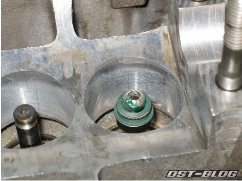

The condom i am talking about is a plastic tube that goes over the valve stem (valve keeper groove), to protect the sealing lip of the new valve seal to cut and damaged by the sharp edge of the valve keeper groove.
