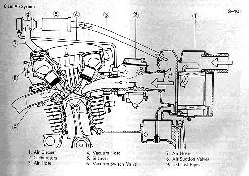

17 Jan 2019 14:28 - 17 Jan 2019 14:30Actually, that is almost exactly opposite of how the system works. It is not an EGR system. The system introduces clean, filtered air into the exhaust ports in order to encourage the burning of any unburned fuel and to dilute the pollutants to keep the EPA happy. The reed valves prevent exhaust gasses from entering the system. The vacuum lines connected to a vacuum valve that controlled when the fresh air was introduced to the exhaust. Most folks just connect the two reed valves as describbed, but some folks also thread the ports and install threaded plugs to completely disable the system.hardrockminer wrote: . The hosing was originally connected to the air box to route unburned gases back into the combustion stream. For some reason they included hoses off two of the carburetor boots. If you've put plugs on all your carb boots then there should be nothing else to do..

Thanks for that explanation. I just put plates over the ports, and eventually I switched to a '78 head.
What was the purpose of connecting to the carbs?

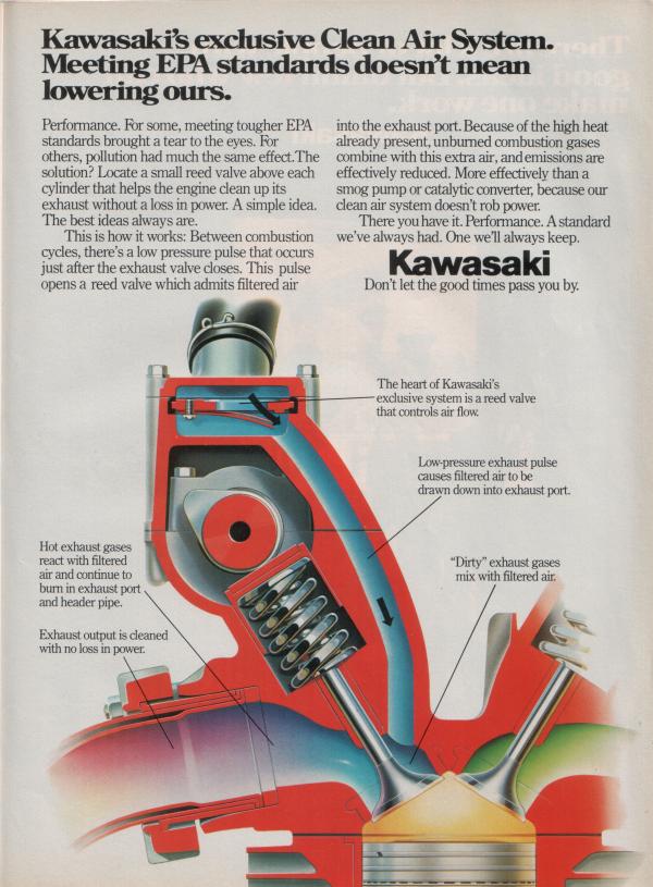

Re: 1979 KZ1000 LTD B3 Help wanted - Bike will not start
18 Jan 2019 06:37

Wow thanks Patton,
Reading the Kawasaki add almost makes me feel like buying a vacuum valve with the hoses and installing it. They are usually available on E-bay. The only thing is that my air box doesn't have the fitting but I know those are available too.
I am hesitant between eliminating everything or going full factory.

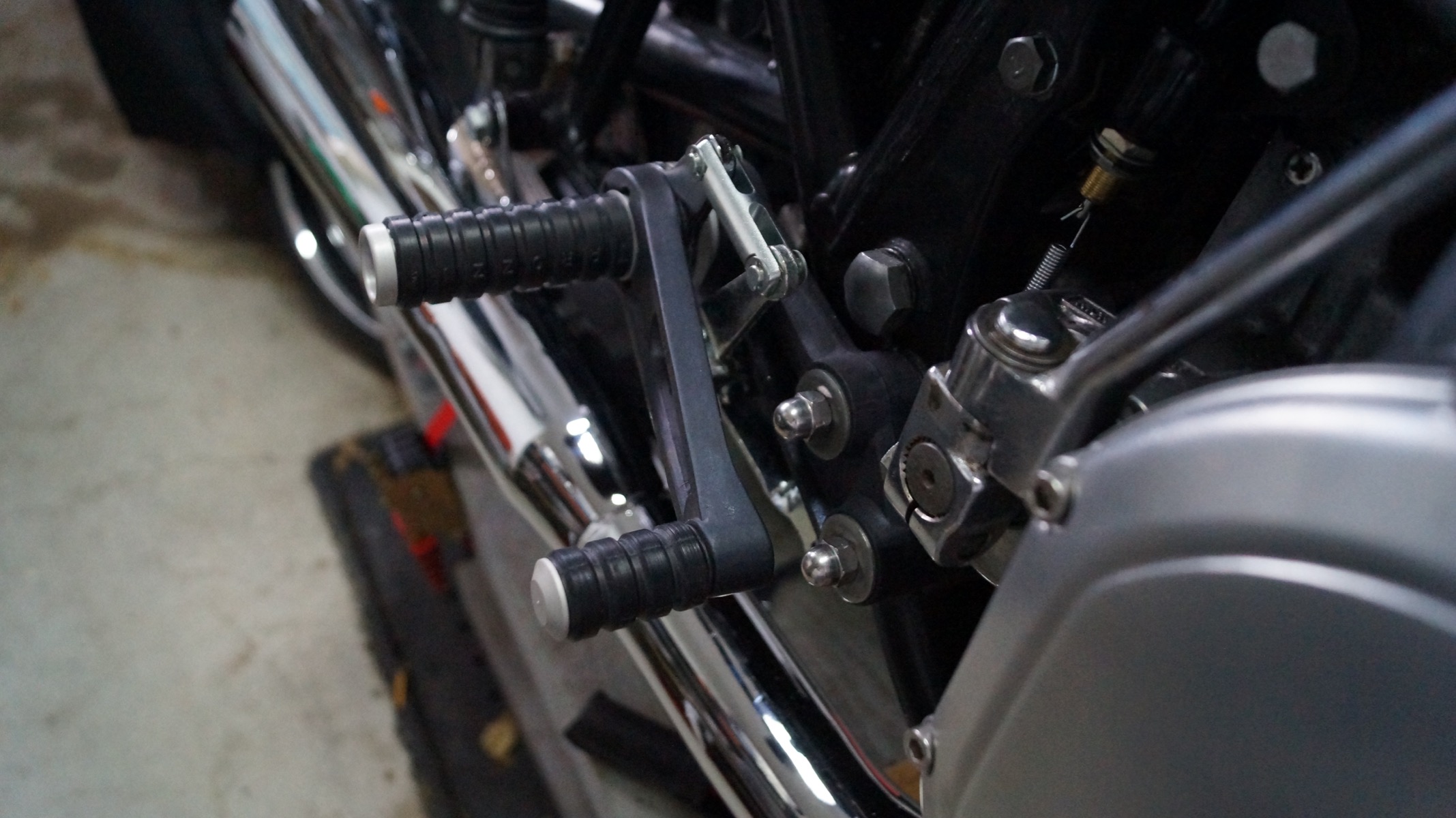

Can't really work on finishing tuning the bike as it's so freakin cold so I went ahead and did the install on the Tarozzi rear sets which came in last week.
I had some worries about being able to fit them as apparently the MkII model was not supposed to fit on a LTD.
The install went fine. Clutch side was basically plug and play. On the brake side, I had to use the original master cylinder shaft as the one supplied was on the short side but aside from that it fits very well and happy.
