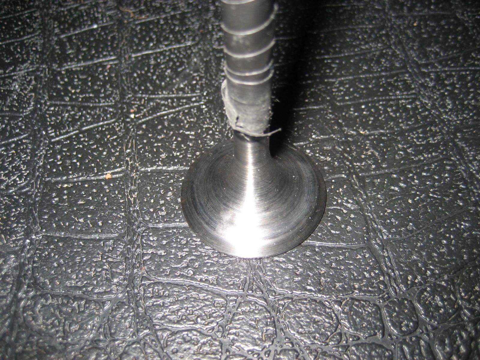

Here some pics for your valve maintenance.
Tools you need
Check the valve shaft for damages like scratches, dents, pitting or other stupid things the PO does.
If you seen things like this buy new valves.
Tools you need

If your valve shafts looking good go to the next step, valve stem diameter (min. 6,90 mm)
if out of spec bring it to the old metal recycling
If not next step...
If not next step...

Check the valve stem bend, (max. 0,05 mm), one turn around and shift to different shaft position.
if ok, next step...
if ok, next step...

and some more pics
Took me 5 minutes of work for one valve rough cleaning without mirror polishing i prefer.

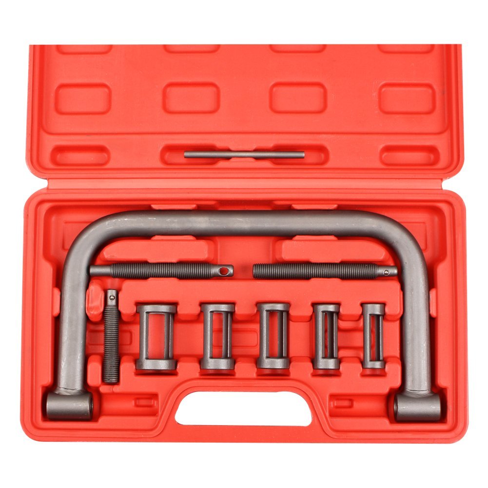

Why you want to buy new. You don“t know how bad or good your valves are.
The valve tools, (removal/install), you need are available on Amazon or evil-bay.
Valve spring compressor
Valve seal pliers
Valve shaft seal pusher
and always use a condom for the new valve seals.
Valve seal pliers
