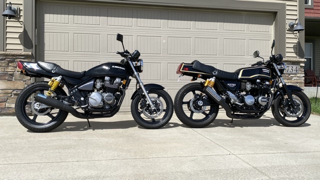

And then there were two...
Since I now have lots of free time, I got my Zephyr 550 out of mothballs and gave it a make over.

soo seems kinda like the elephant in the room.
but,
gold stripes for the zephyr???
asking for a friend ,lol
looks good man!
