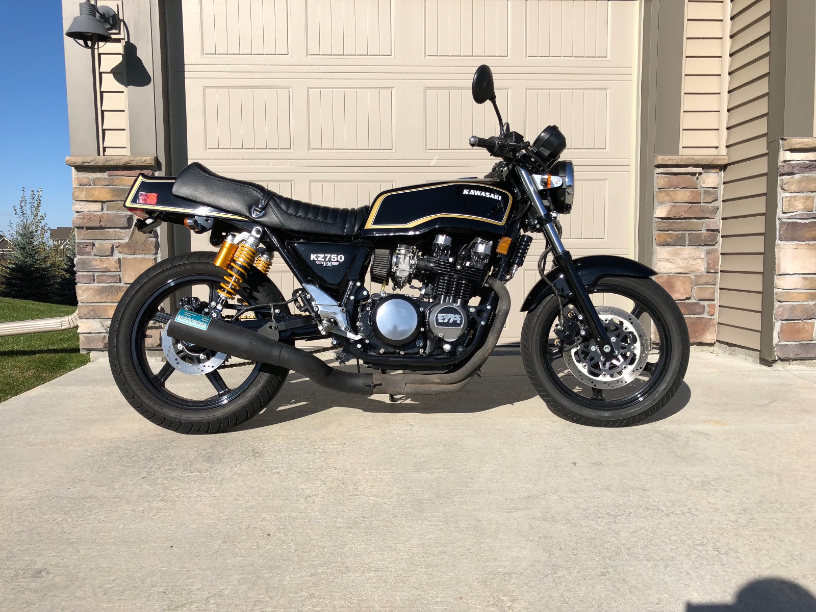

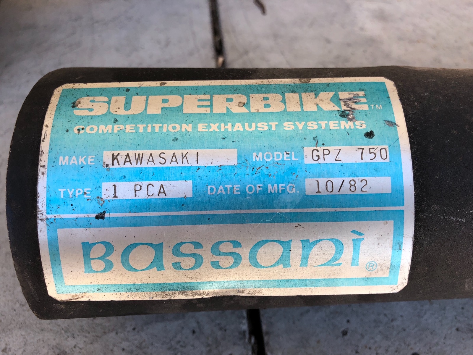

So in the span of a week I got a set of vintage Yoshimura cams and a gpz750 Bassani Superbike exhaust system for my bike.
I am still waiting for my degree wheel to show up in the mail so I can bench measure my cams.
I measured the lift with a dial indicator and the lift numbers don’t match any of the numbers I have found in my research. They are almost the exact same lift as my current zx750 cams which is a relief in a weird way. But I need to get a better idea of what the duration and lobe centers are. (More on those later)
But I have been waiting 5 years for the opportunity to buy this exhaust and today it is finally mine. The header even has all the spigots still on it. (They are almost always missing) The muffler and mid-pipe was absolutely destroyed in a crash, but I found a mint condition Bassani muffler from a gs1100 on eBay one night. So I have all winter to restore it and perfect any fitment issues the Suzuki rear section might cause.

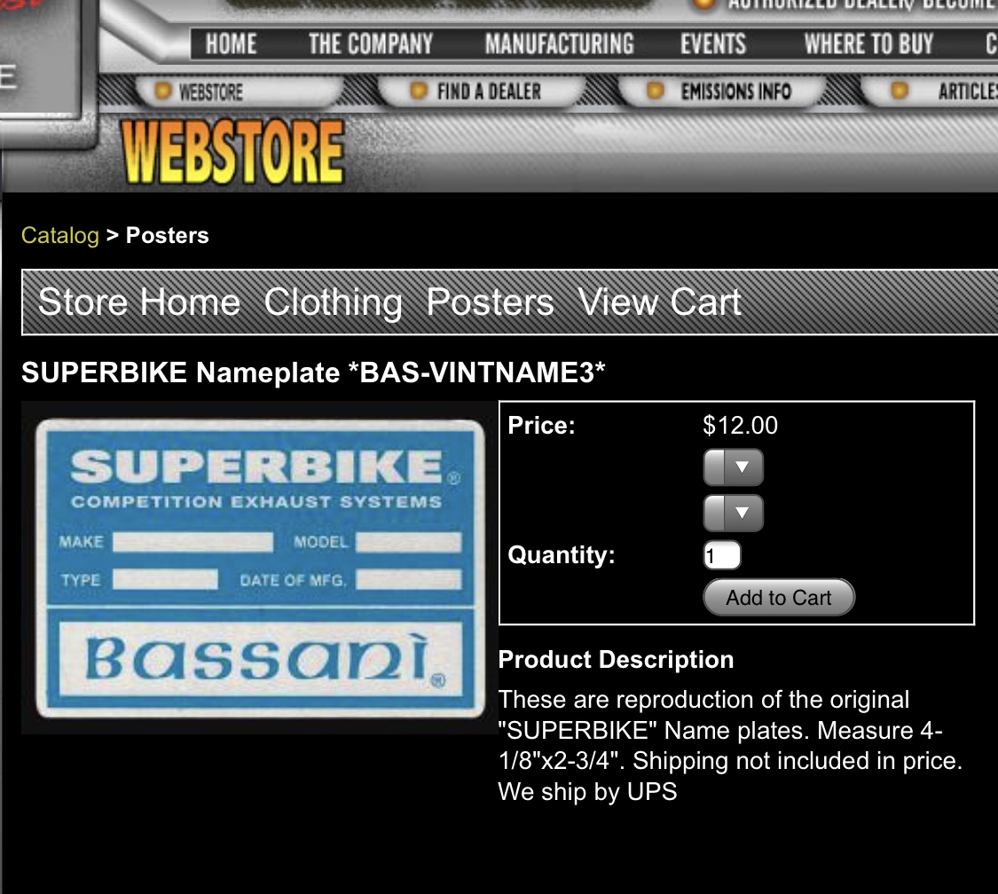

Damn, I sold a blank, unstamped Bassani Superbike plaque sometime last year!!!
Didn't go for that much either.
I think I heard Bassani had a few of those plaques for sale just a few months back. I would give them a call!!!

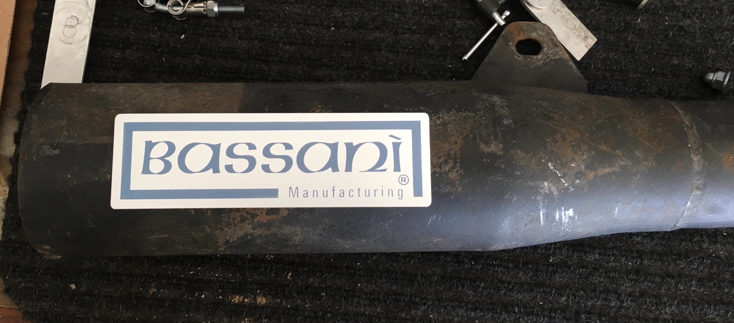

I wish I had know! I would have definitely bought that. But as you mentioned, Bassani is selling reproduction name plates on their website.
I also have an original name plate, but it isn’t the giant one like you have. It’s way smaller so it doesn’t look quite right.

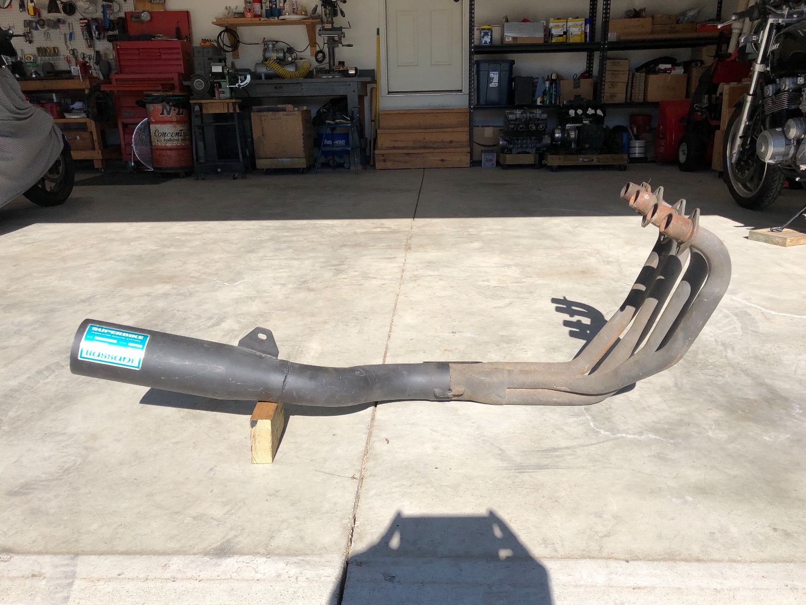

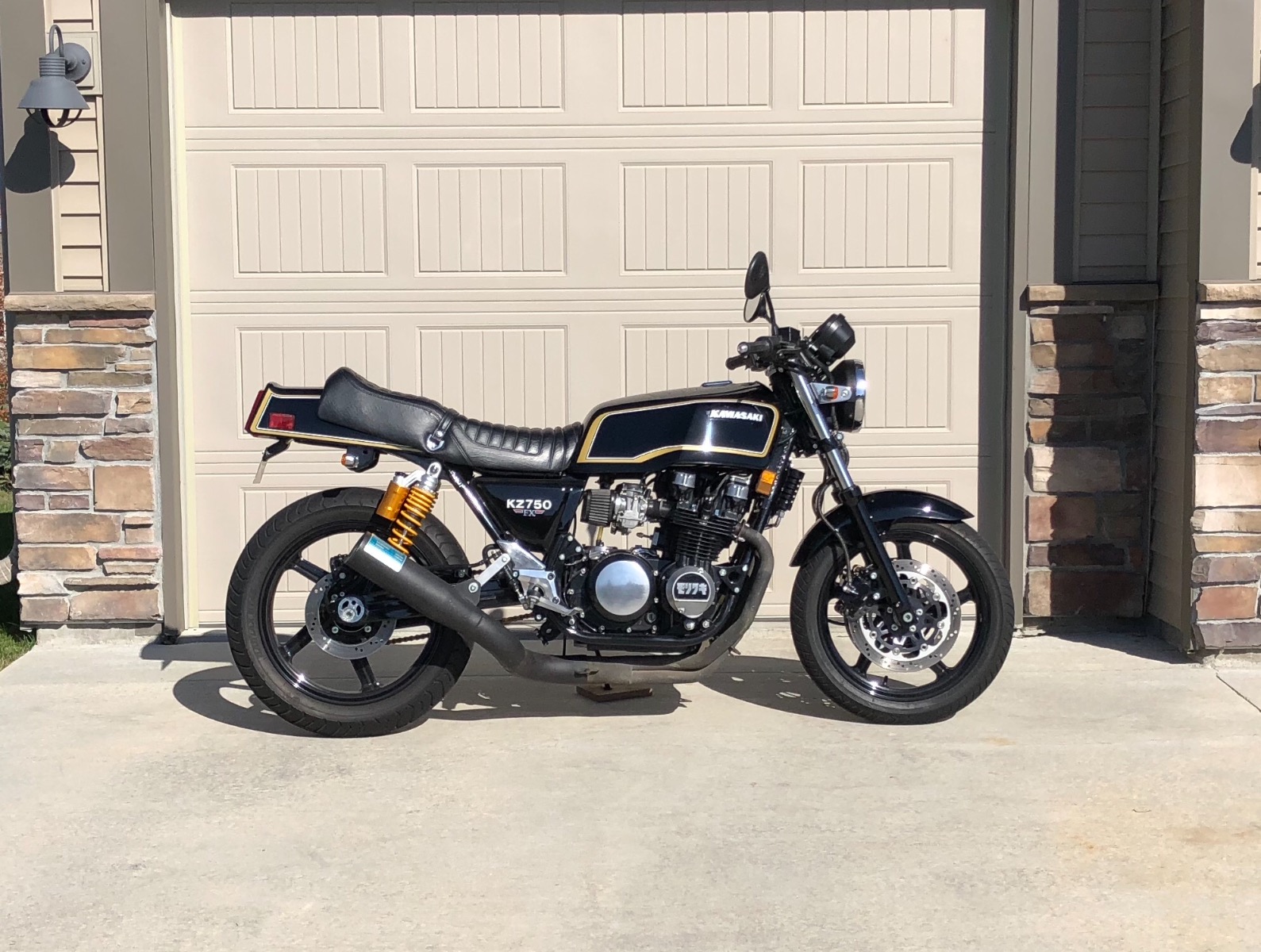

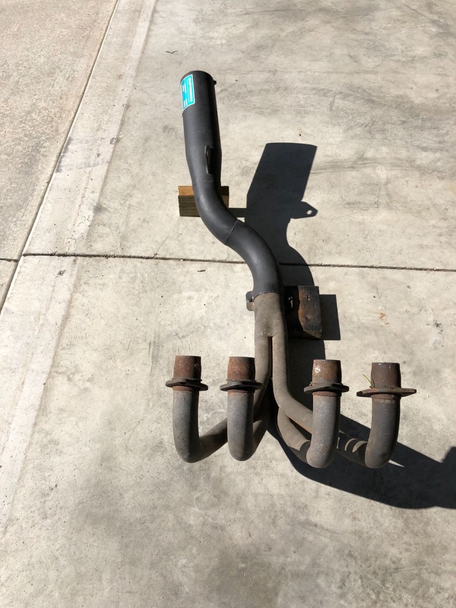

I test fit the Bassani exhaust on the bike and the gs1100 rear section wasn’t all that far off. But there is only 2mm between the muffler and my swingarm and I don’t like how straight back it goes. So I had to cut the mid-pipe to space it out from the swingarm and give it some upsweep.
So this is my current mock-up after two days of continuous measuring, thinking, cutting and fitting.
Before:
After:

Your rework on your Bassani looks fantastic!!!
I remember spending hours cutting up my Bassani, and rolling the pieces around to form the upsweep part of my pipe.
What month is your Kz750 going to be Bike Of The Month???

21 Oct 2018 16:59Thanks Dr. Gamma! I find it poor form to nominate myself for BOTM, but maybe once I get everything back together others will like it enough to give me a nod.
It was nerve-wracking cutting into the pipe for the first time. I cut it right on a factory weld seam and ended up taking a pie-cut section out of the crushed gpz pipe to create the proper upsweep bend.
Right now I’m having trouble getting the spigots off the header. They are fused to the header with rust, so I am heating them and drenching them with PB Blaster and a atf/acetone mix. I need to be certain that these stuck spigots won’t cause a situation that affects the fitment of the muffler section. Once I know that there are no surprises, I can take the pipe to be TIG welded together.
But right now I’m in a holding pattern waiting to get these spigots off and my degree wheel to arrive.
