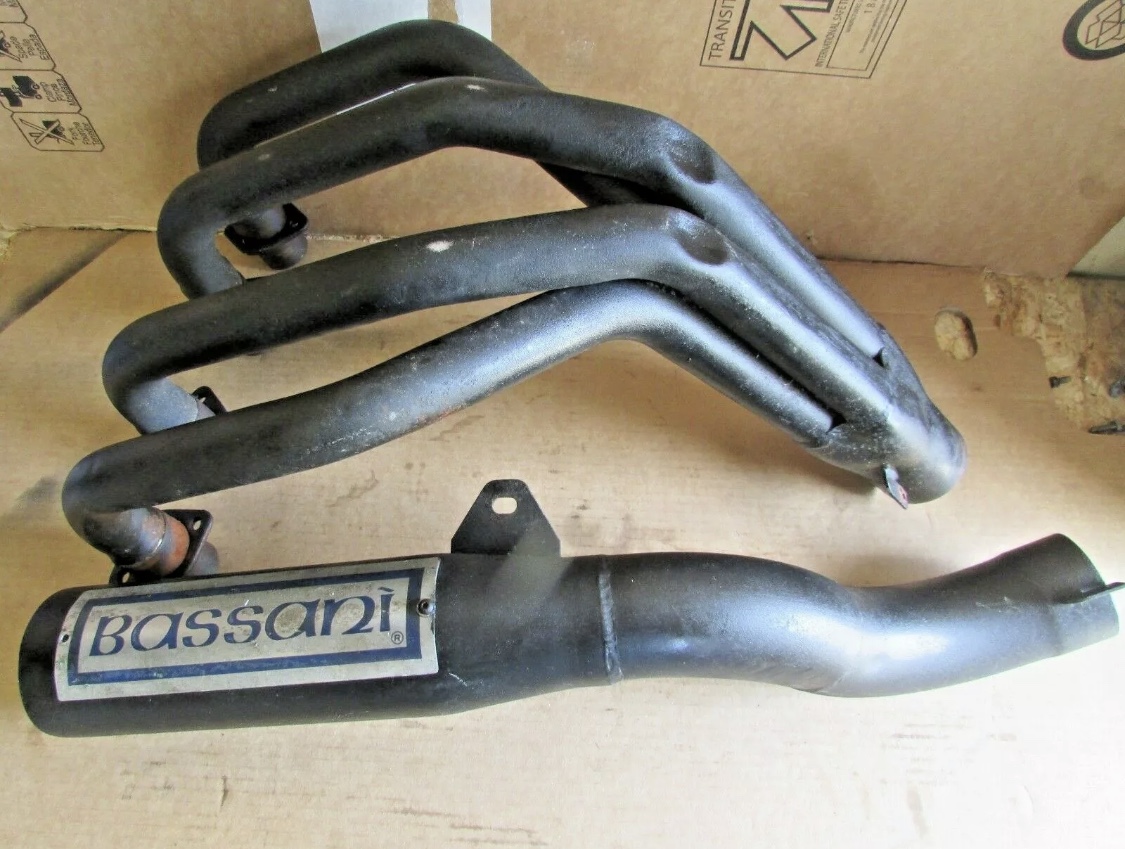

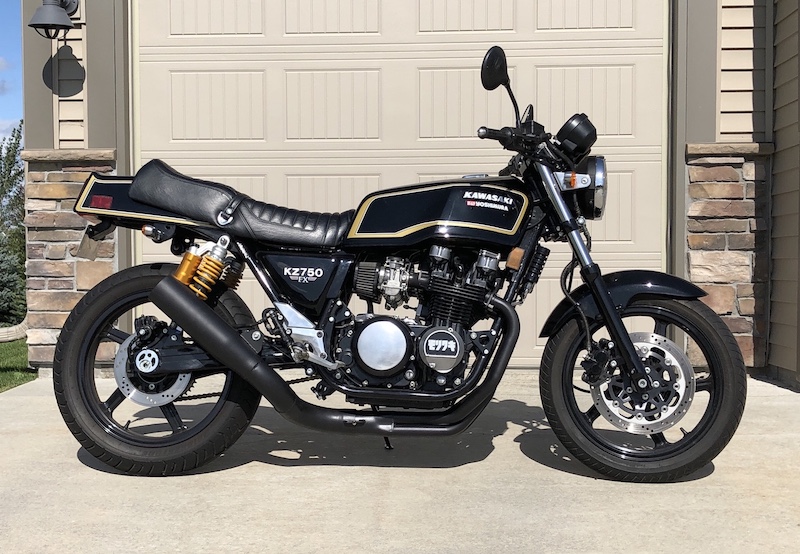

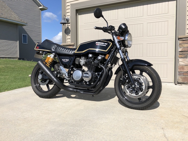

Now that the exhaust is done, I am essentially done with this build. There isn’t any more that I wish to do to it other than enjoy riding it……for now…..

Its a real pleasure to look at some real craftsmanship!!!! Your bike is a work of art in my book. Give yourself a huge pat on the back for this whole project.
I like your fixture for the top tensioner when you degreed your Yoshimura cams in. Better than cutting up a whole valve cover just to get that center piece.

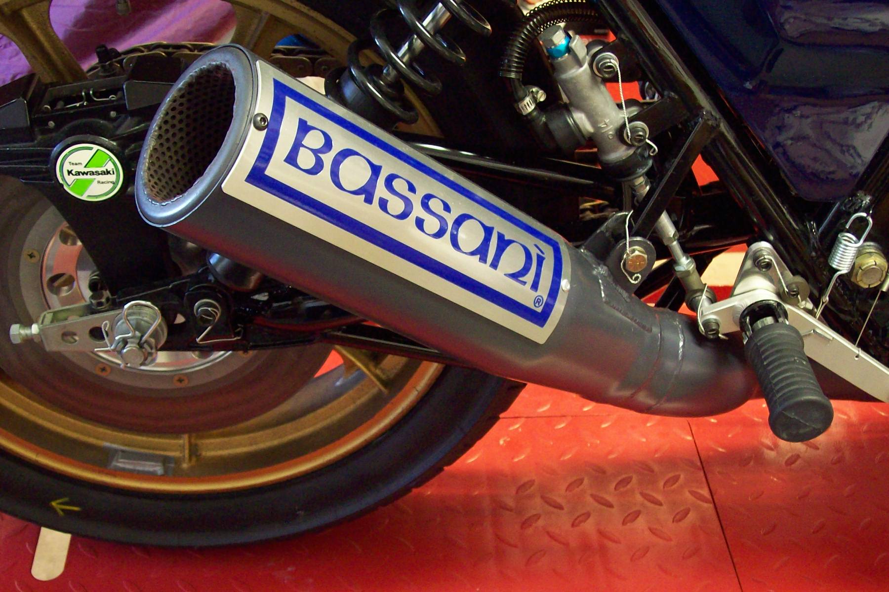

I am kinda partial toward Bassani pipes. Your's came out looking great!!! You NEED to find you one of those 3 inch baffles for your pipe!!! I would love to hear your bike with that pipe at some high RPM's!!!! Where did you find the BIG Bassani emblem??? It does make the whole bike look better!!! I thought I was the only one with the old Bassani emblem.

I really appreciate the positive comments Dr.Gamma. Coming from you that is high praise indeed. I have been wanting a Bassani exhaust since before I even started building this bike. I had been trying to buy this one for five years and it took me another year to finally get it done.
I found the emblem on another Bassani system that goes to an unknown Suzuki. So I am in the process of restoring that one as well and passively shopping around for a gs750e or a gs1100e to fit it too.

31 Jan 2020 12:20Dr. Gamma wrote: I am kinda partial toward Bassani pipes. Your's came out looking great!!! You NEED to find you one of those 3 inch baffles for your pipe!!! I would love to hear your bike with that pipe at some high RPM's!!!! Where did you find the BIG Bassani emblem??? It does make the whole bike look better!!! I thought I was the only one with the old Bassani emblem.

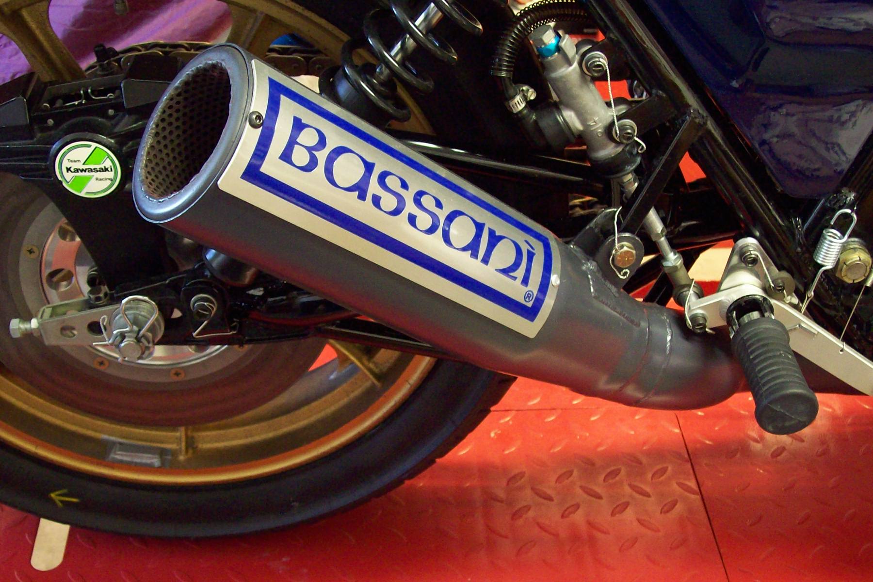

Well Dr. Gamma, you got me thinking and so I went back to the internet and bought a bunch of stainless bits and after a whole lot of thinking and tinkering I came up with the closest I could get to a Bassani 3" race baffle.
Making the end cap took me the longest time to figure out. I started with a cheap fart can baffle for import cars and after some work on a lathe and extruding the hole to 3" with a steel cone, it turned out almost perfect.
And why make one baffle when you can make two for twice the price. So now I have one for the mystery Suzuki Bassani system that I took the giant Bassani emblem off of. (Now that it has a baffle, I need to sell it as well...)
I will have to wait till warmer weather to install the new baffle and get a video of it running. So stay tuned...
Making the end cap
Finished product.
