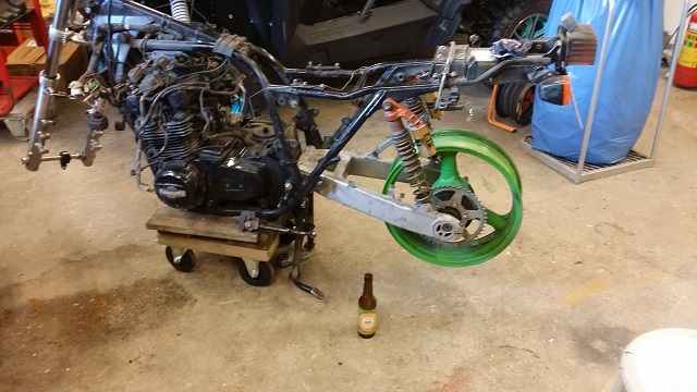

And, well I have, a sorry looking project.

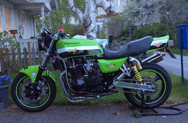

on the green 750 what is the front and rear end swap from? Looks great.
