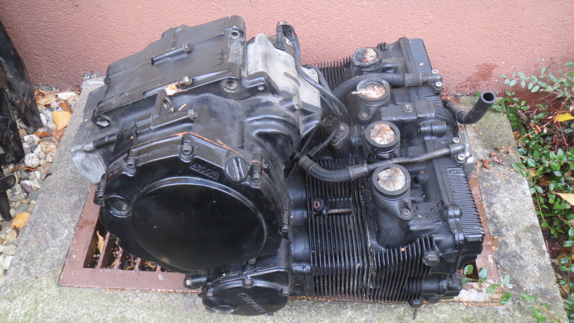

Nice, looks like you want to do an Suzuki GS1200 ccm engine conversion.
I have all parts too but i am a little undecided between the GPZ/ZX 1100 UT or GSXR 1100 engine.

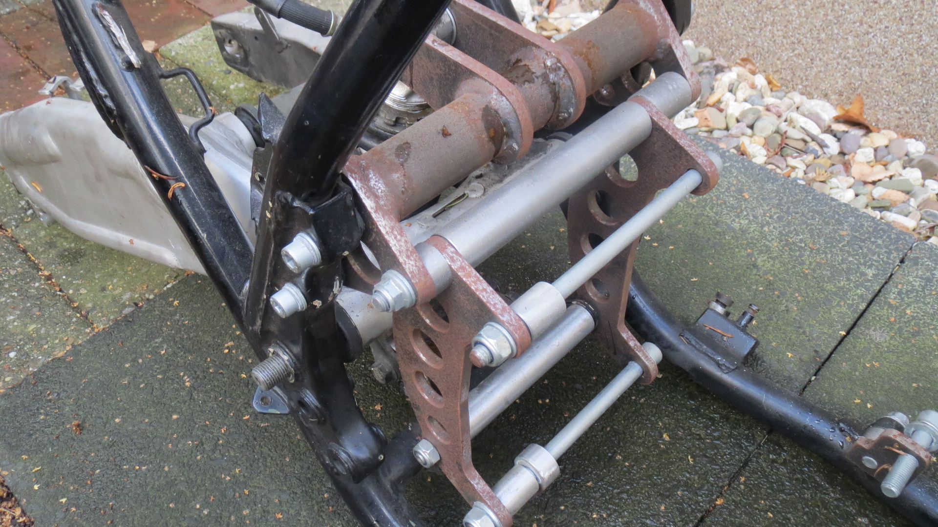

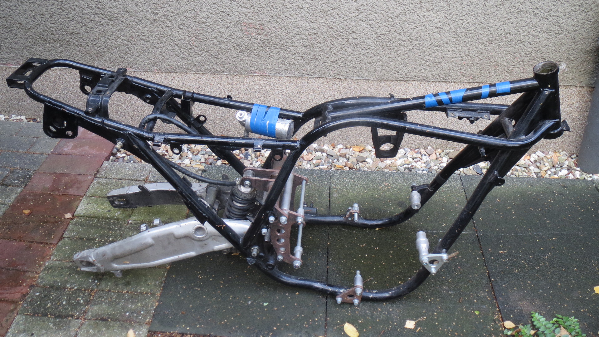

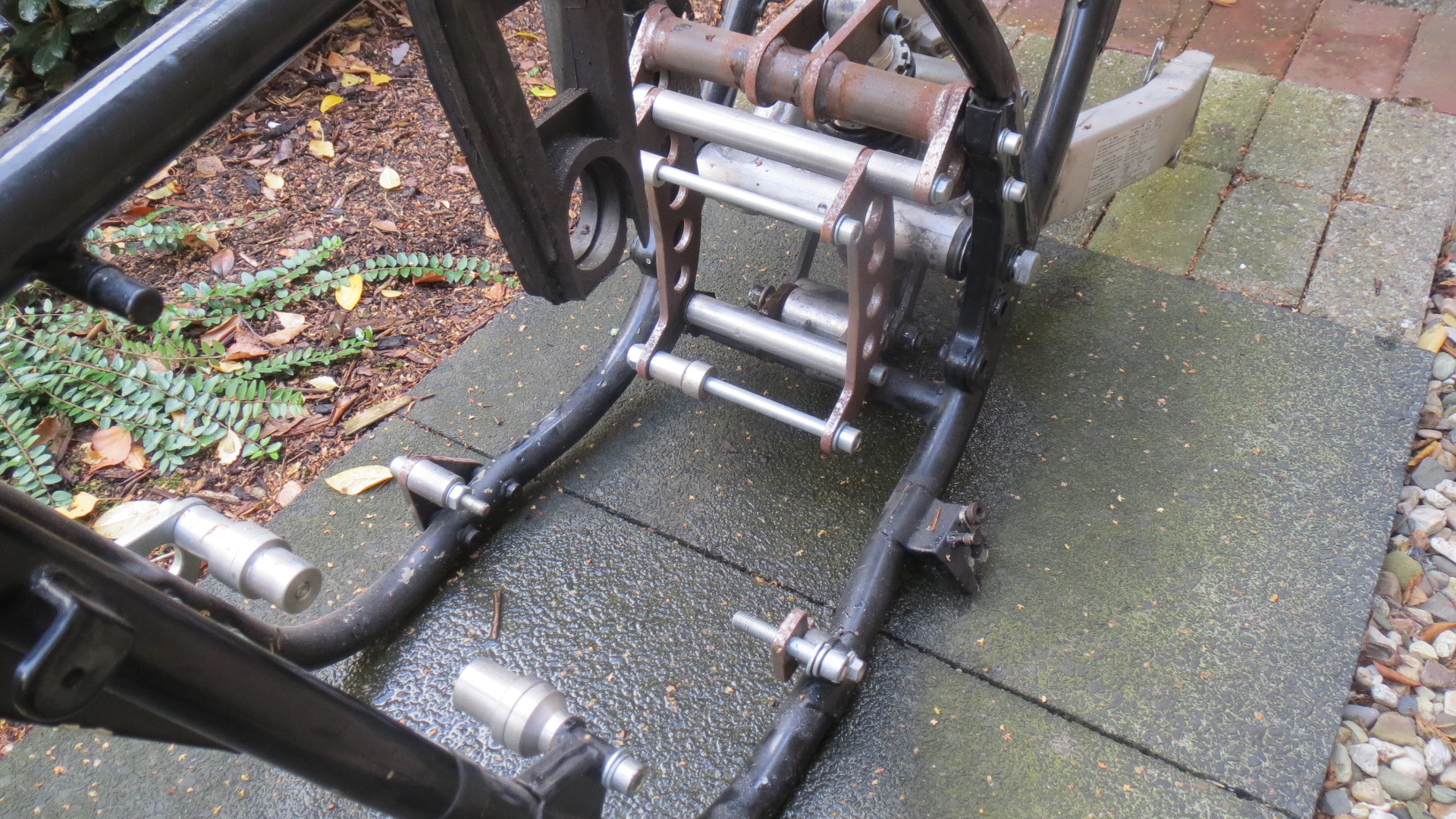

Haha I was waiting to see if anyone would notice that. I have a cunning plan (well i think it is anyway). I am going to build the Kiwi GPZ with a Bandit 12 motor while I am rebuilding the GPZ motor from the two I have. I had a bandit 1200 motor sitting in the shed with loom, carbs, etc and thought why not! If I don't like it no problem, just swap the GPZ1100 motor back in when it's finished. If the it's awesome with the 1200 motor in it I will build a 2nd GPZ1100!! How's that for a plan
Love what you have done with the mounts on your frame. Any chance you would be able to let me know some of the measurements of them? Would save me a load of time! Also really like the way you have done the front mounts. Looks like factory!

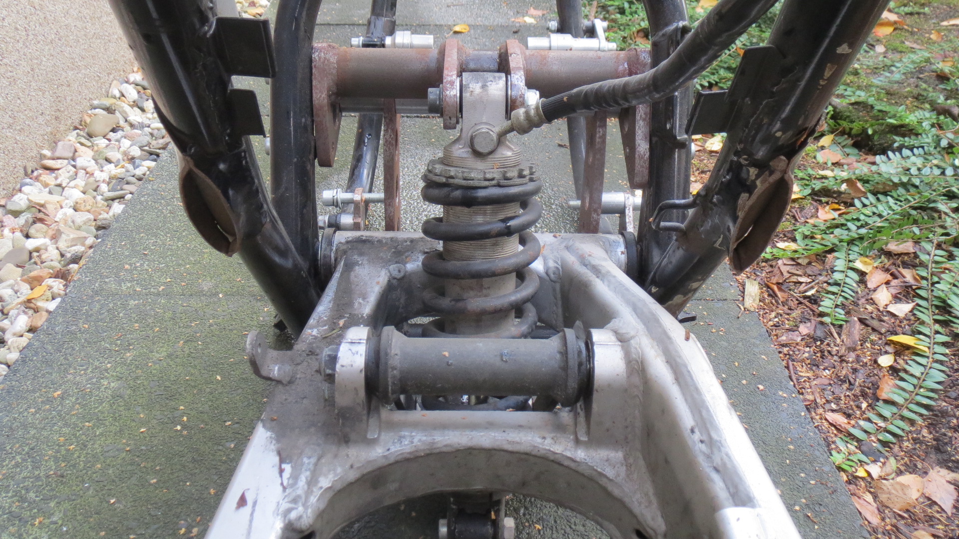

Swingarm is in now. Not 100% as I have a bit of work to do with the linkages to get it sitting right and working well. Currently I have put a GSF1200 shock in to work things out. The Mk1 Bandit shock is 306mm eye to eye and to get any height out of the back things jam up at the mo. I have a selection of lower links and will try a few different combinations tomorrow and see how I get on. So as she sits today it puts me back where I was about six years ago!!

do you mind me asking what bearing configuration you used for the front end? i used a ZZr front end too and had to have a whole steering stem made and pressed into the lower fork clamp. Ill be kicking myself if there was an easier way. Plus to make the rear shock work i had to take a bit of meat away from the swing arm to stop it rubbing, about 20mm if i remember but i used the older model arm Plus i had to widen the front cowl/fairing bracket? if that what we will call it to stop the forks rubbing on it.

Wow.. ok that’s a whole load of work around I didn’t have to do.. ah well. I used a W.P shock I got from Scirocco, was close to the standard gpz shock size. Yea just looking closer and there is a big difference between the older and later swing arms. Not sure if you can grind away at the newer one and there are no pin bearings on the swing arm on the older ones.
