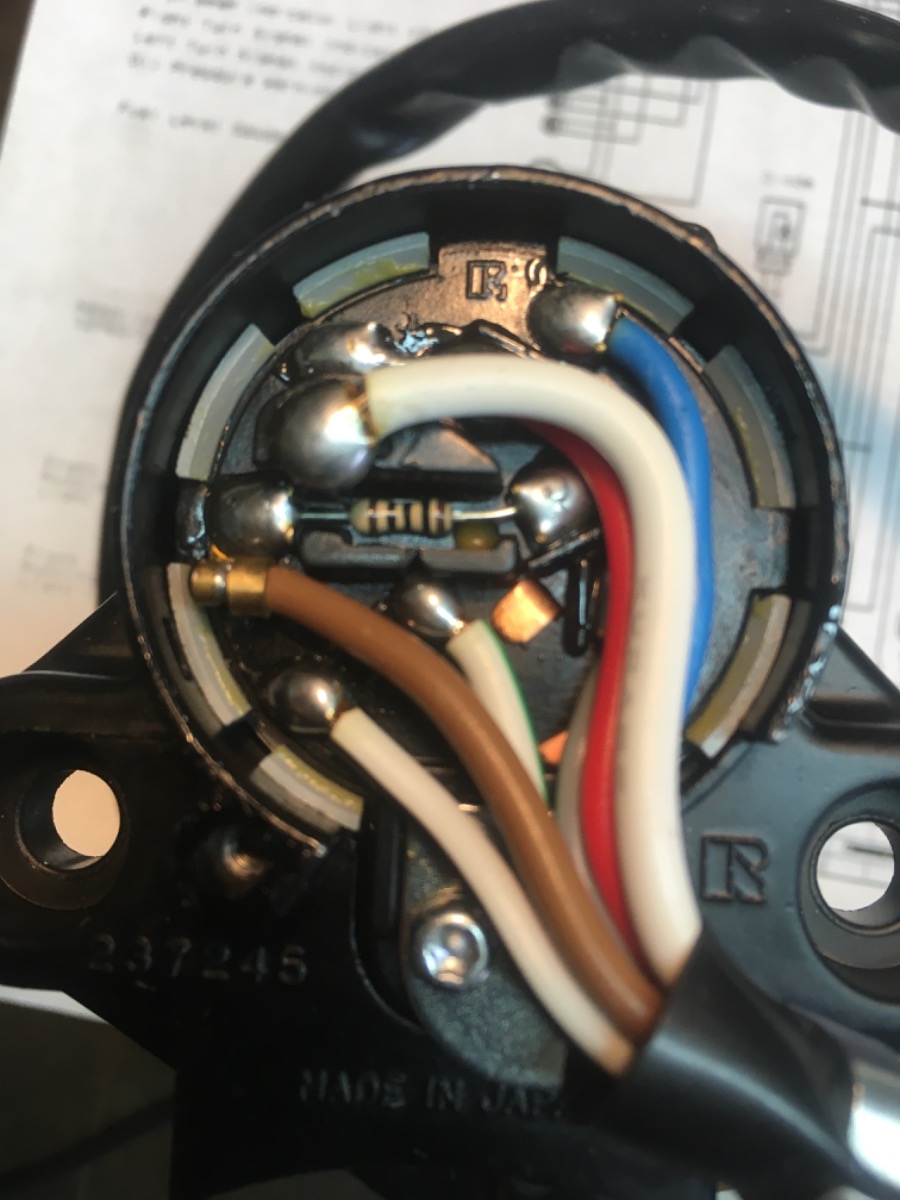

Started on fitting the ignition barrel a while back. To get it clear the frame as it sits in the ZRX triple clamps it requires a bit of metal to be removed! I had a go at getting everything to clear using an old ignition that was pretty much toast. Now to grind the clearance into the good ignition. Also need to wire in the Kawasaki ignition barrel to the plug from the Bandit 1200. The only niggly bit there is that Suzuki Bandit's have a resistor buried in the ignition that needs to be in the line to the CDI or the bike won't start. Next job lol.

There is a resistor in the ZRX ignition or there is a wire that leads to one. Maybe the brown wire. I’m recalling owners reporting problems with the resister going bad on ZRX's.

Here is a pic of the ZRX 1200 switch. You can see the 100 Ohm resistor in the middle of things. If the Bandito wiring harness has one, too, then one of them probably should be removed. Do you know the resistance on the Suzuki resistor?

On Kawasaki it's the grey wire. The ignition module gets battery voltage on the brown for power and approx 9v on the grey as a signal to switch on. If it see's battery voltage on the grey wire it thinks it is being hot- wired ( ign switch by- passed) so won't start

Thanks for that picture TexasKZ. I looked in the ZRX manual and it shows no resistor in the schematic.
