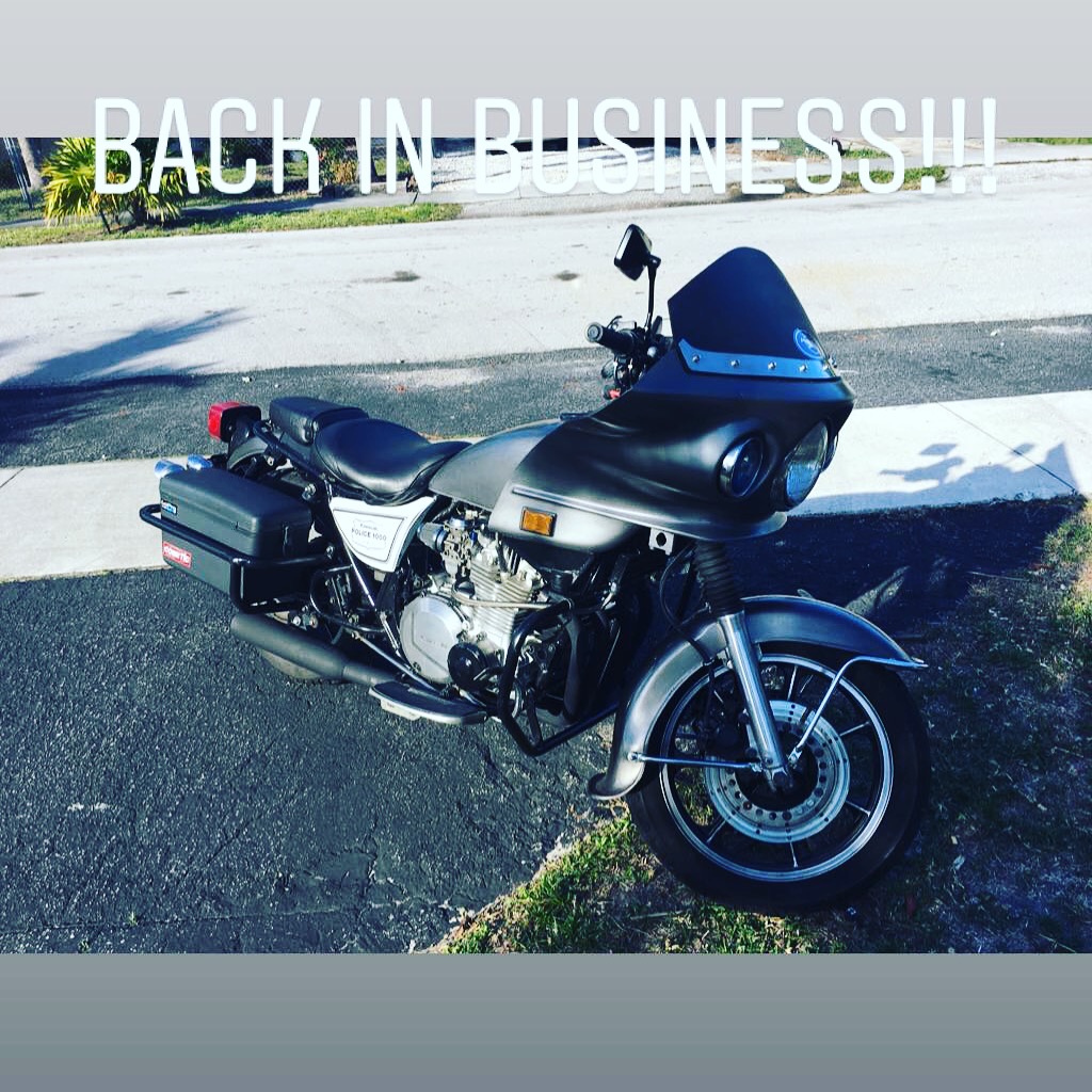

Sorry, Hadn't seen this question.
I don't think so...
I guess people are now used to seeing Harleys to the point where KZPs are now seen as a novelty.
My wife was worried about women flocking to me, but I calmed her nerves letting her know that the bike is only a dude-magnet! LOL
I have never had a bike which attracts as much attention as this one!!!! Every red light or fuel stop is peppered by thumbs-up and all kinds of questions about the bike.
I even had a guy riding a Victory Cross Country Cruiser ask me if my name was Ponch... :laugh: :laugh:
It's all good fun...

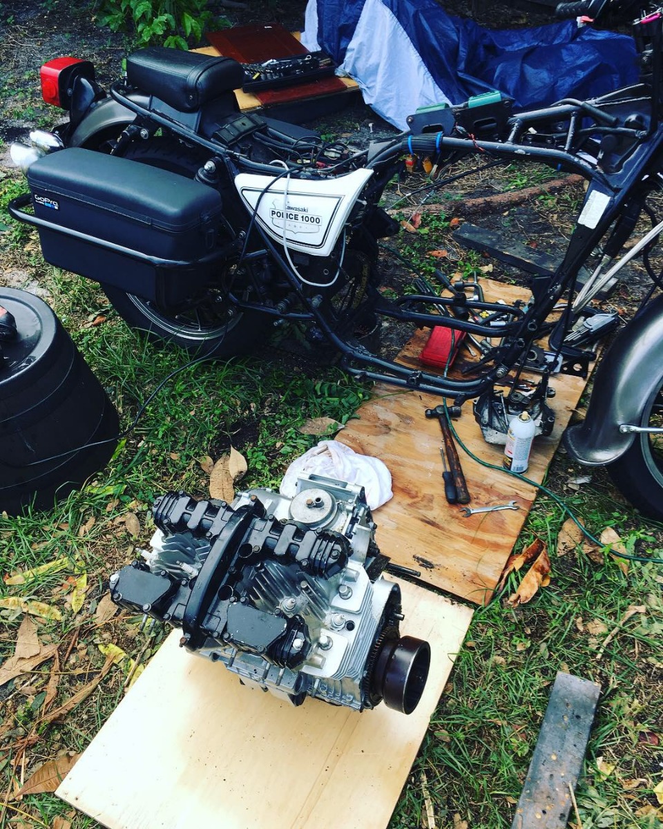

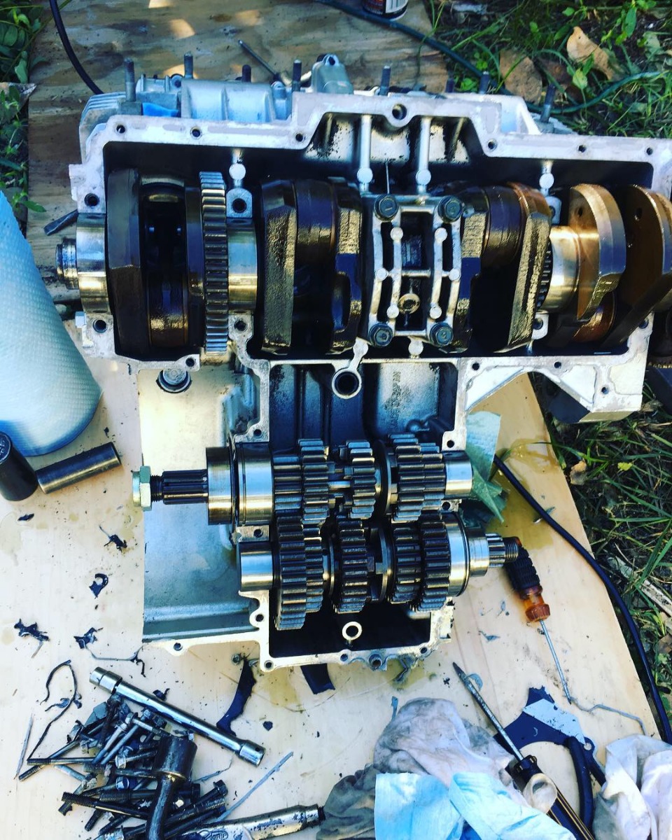

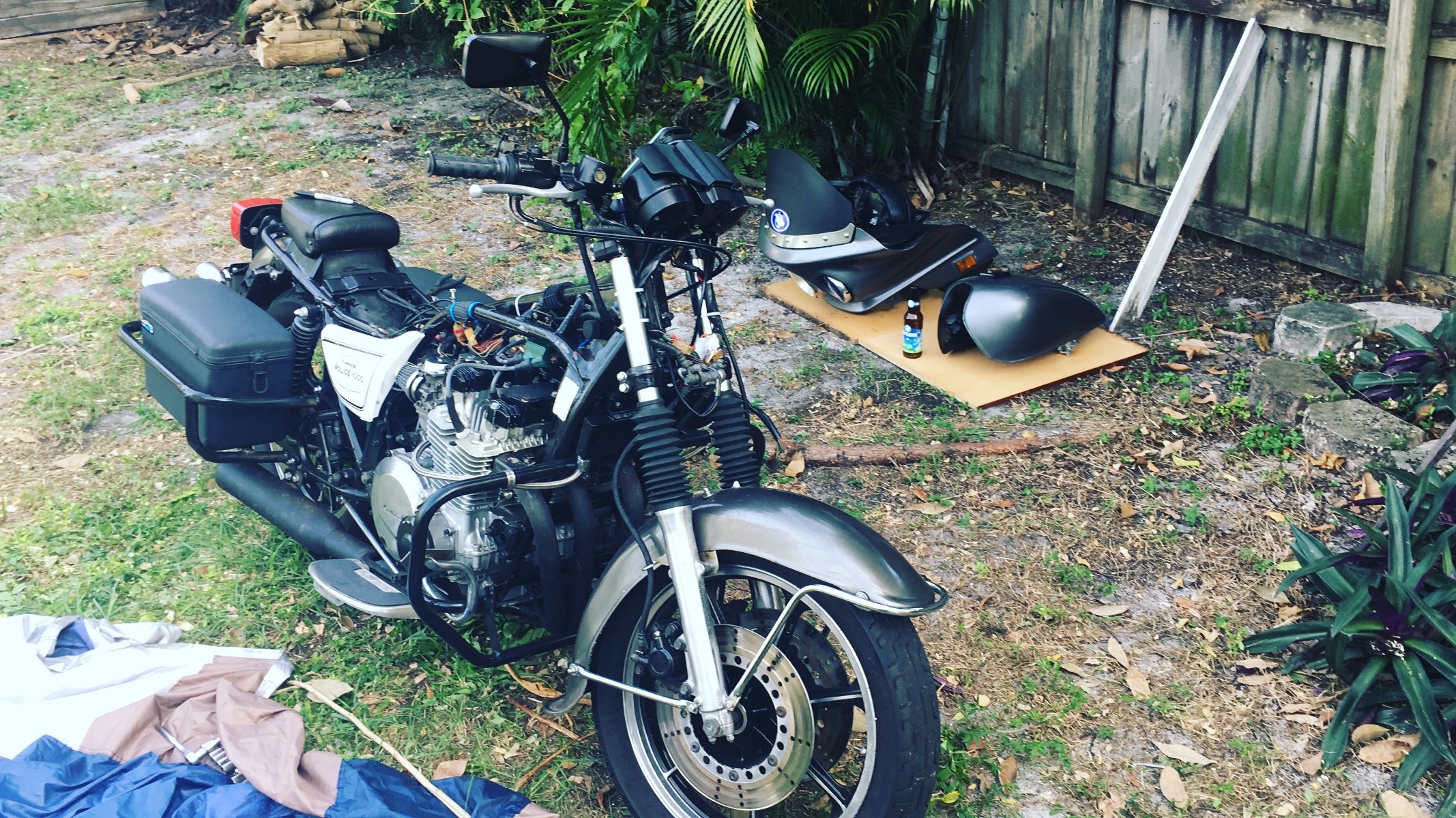

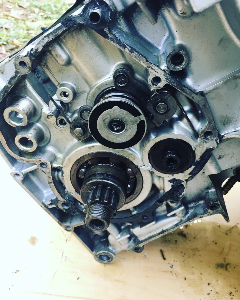

I always wondered why a perfectly good KZ would be left to rot under a tree. The answer came to me when I finished my build....
All that abuse, cop work, escort work,hard upshifts and downshifts, take offs and hard stops most likely resulted on a stripped 2nd gear... These bikes are strong, but ultimately the hard duty does take its toll.
I was a bit heartbroken to go through such a lengthy build only to miss a tore up transmission, so I rode the bike as it was until the "winter" came to Miami.
I waited patiently until the temperature "dropped" into the upper 70's (25 Celsius) so that I could take on this next project, as I would have to do it on my friend's backyard...long gone are those days when I could work on my bike from the comfort of my AC... :lol: :lol:
Kinda sucks going back on your work, but oh well...
Engine out
Side covers out!
Thankfully I bought a parts bike way back... remember? This was a great investment as I had a ready to go tranny ready to drop in... (fingers crossed for a good 2nd gear..)
The balance...:
Engine out
Side covers out!
The balance...:
- Total cost of job, under $100 between gaskets, silicone, oil, filter...
A couple of weekends work... I was taking my time..
Busted knuckles
The feeling of satisfaction after taking my bike on an afternoon ride after the job... PRICELESS!!!
