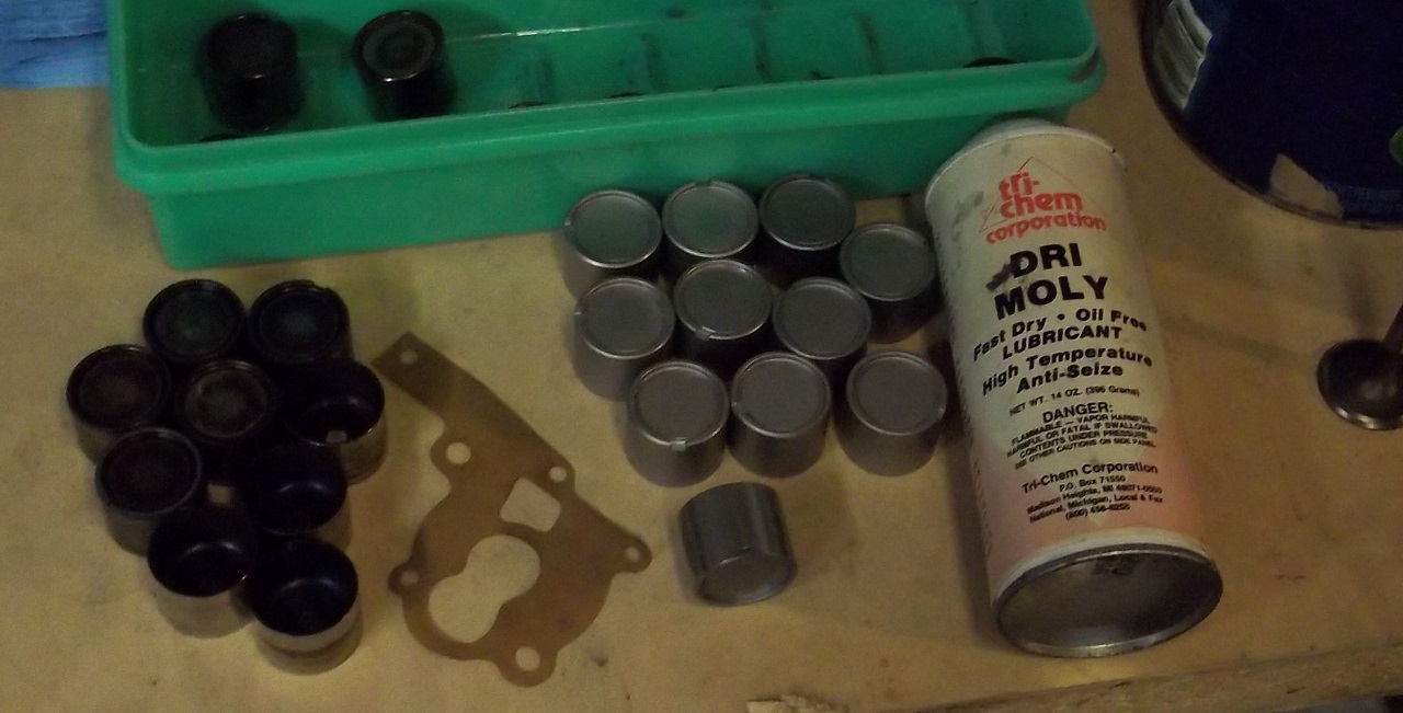

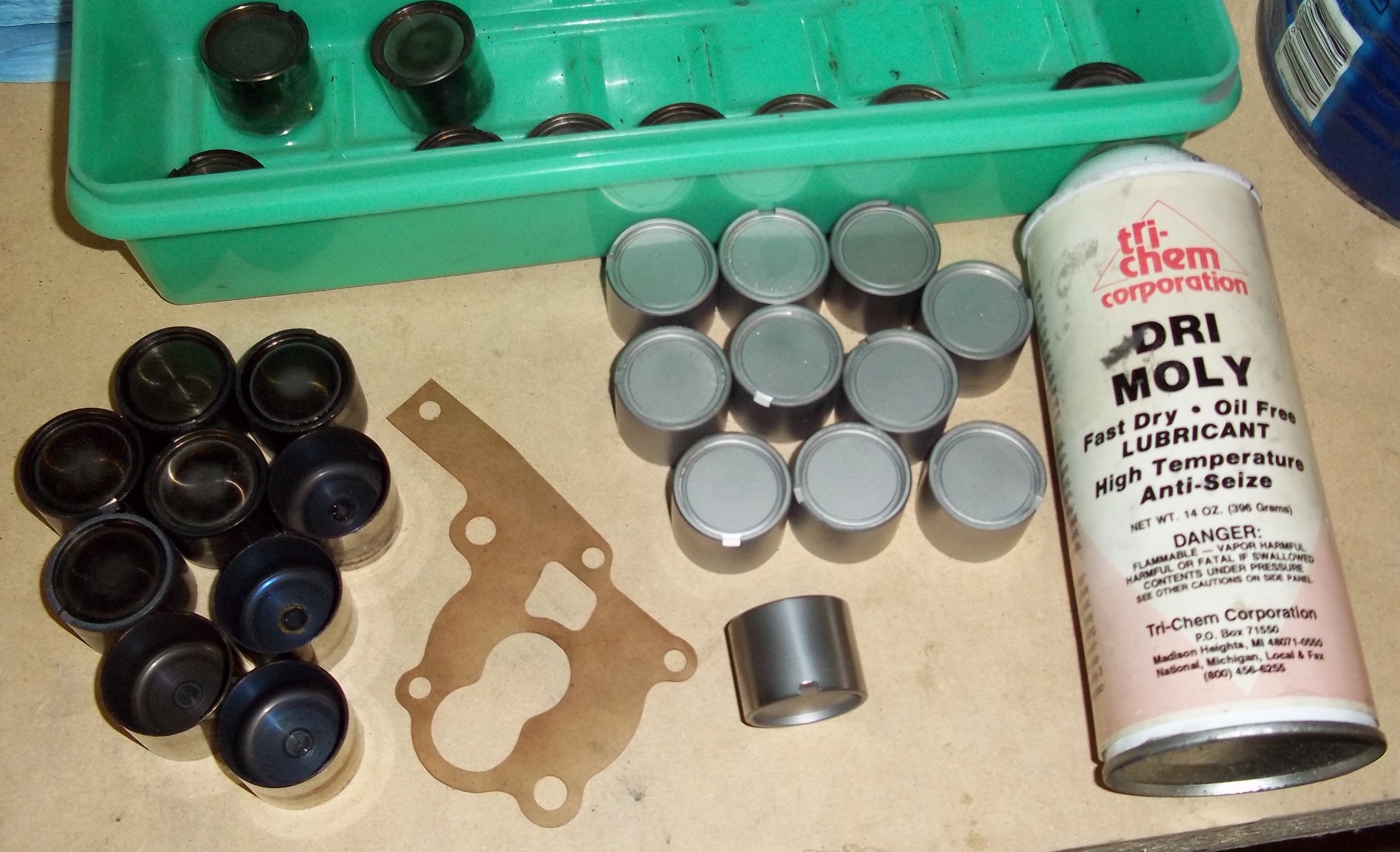

I have used mixed and used lifter buckets for years. I always would glass bead them first. Then you can really see them.
Here is a set out of a street turbo engine. Talk about heat! They are blue! under neath. Those I won't use.
Plus a polish after the glass bead will show any imperfections.
Fine wet sand paper and light oil will help them clean up also.
As we all know these engines were built so good with exacting tolerances. Mixing parts was not too much of a concern for me, but mine were always street racers or drag bikes. I never had a long mile stretch on a road driver.
Then I like this Dri-Moly film. I would spray it, looks like primer it is Molybdenum Disulfide, particles that burnish into the metal surfaces.
withstands heat up to +1050 F. I also coat cams and piston skirts. It is real exspensive. But when I ordered it for the company, 1 always never left the receiving dock :evil: Ended up in my lunch box.
Back to the oil pump. Pain to get apart, super red loc-tite.
Here is a paper thin gasket. If anyone wants it? PM me and I'll mail it to you. I won't ever need it
But that sure is one nice rebuild Everything's rebuilt! Keep up the good work.

Rats, I already did order one, but I got it cheap. I have another Z1 to do next year, but it is also a 75 and odds are it has the later pump, so I won't take and hoard that, much as I am tempted to

The stack of steels and fiber plates in the clutch.
