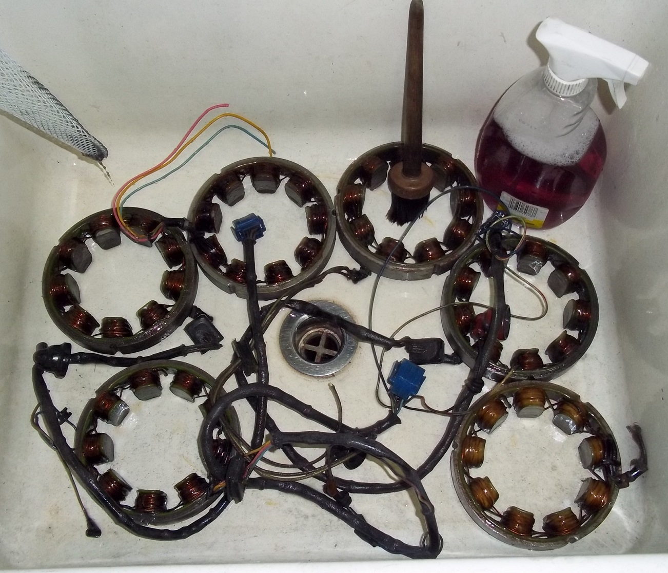

16 Dec 2015 07:00swest wrote: Get a new grommet. Major source of leaks. They're cheap. I wouldn't soak it in anything. It's where the wires go through that's the problem.
I just sealed mine up. I think the cloth insulation wicks the oil out. I cleaned up all the wires best I could with brake clean and degreaser...then cleaned them again. IIRC, I used form a gasket and let it soak into the wiring then stuffed the opening in the cover with silicone and siliconed the inside edge of the grommet.

That should work. I use crazy glue because it gets deep into the webbing. I hate oil on my foot. :dry:

Time to find a good one. I do have a new old stock rubber grommet. Giving them a bath in the laundry tub.

I have three of them. I think they develop resistance in the coils and stop charging as well.

Would some kind soul be willing to hack one of these (intact) blue connectors off a junk stator and mail to to me please? I would be eternally grateful...
