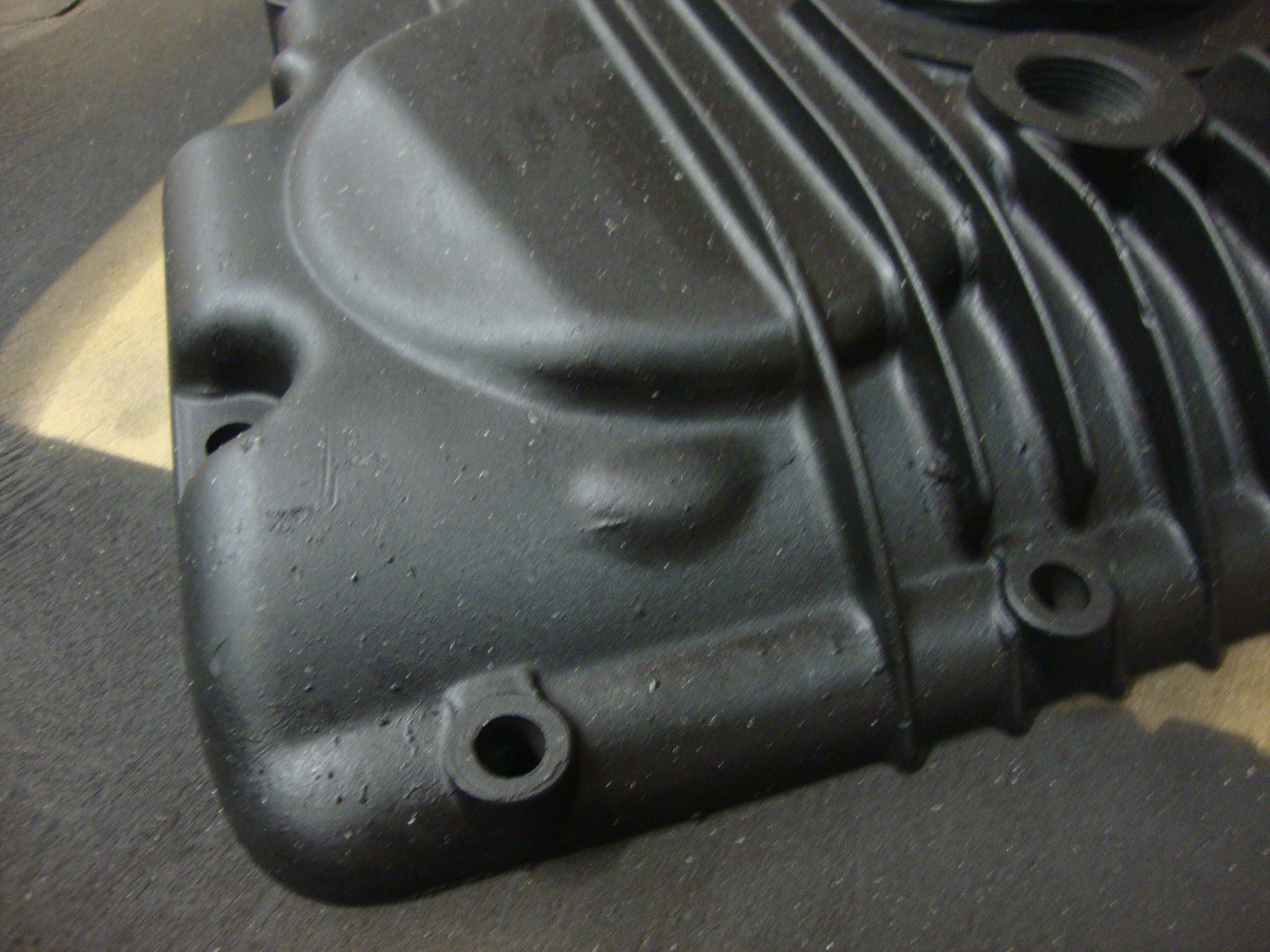

Today was better. I flipped the bike over and got the sump gasket fitted.

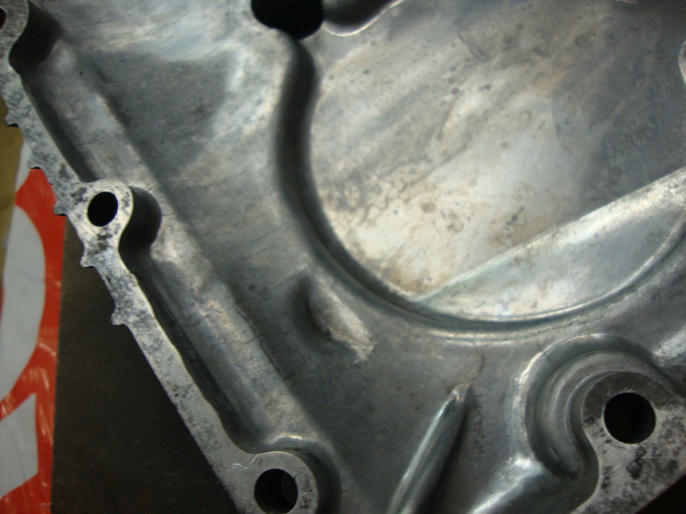

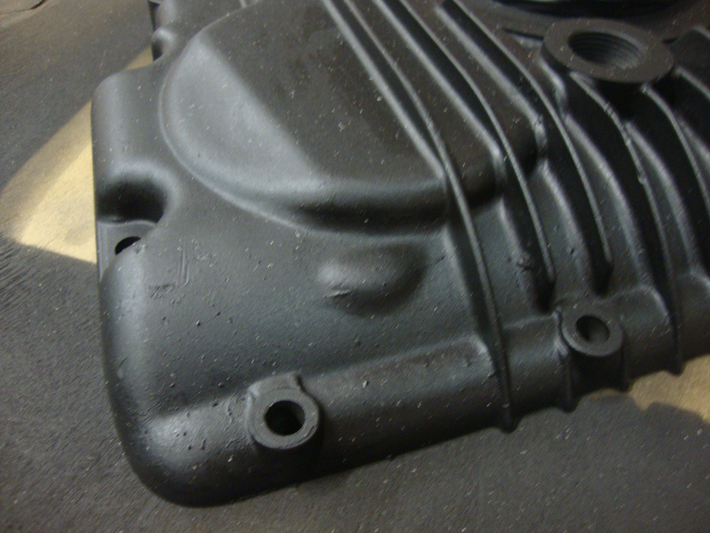

I noticed a strange bulge though.I dont know if its meant to be there or not??
Anybody know if this is normal?

That case bulge. I think you'll find that is manufactured into the part for clearance of some other mating surface/part. Otherwise, it's been my experience when a depression that size is made into cast alloy/AL, it doesn't end up looking so smooth with edges so nice and the case will show signs of hairline cracks from being distorted by interference of another part.
Guess, I'm thinking that's one "issue" you don't have to worry about.

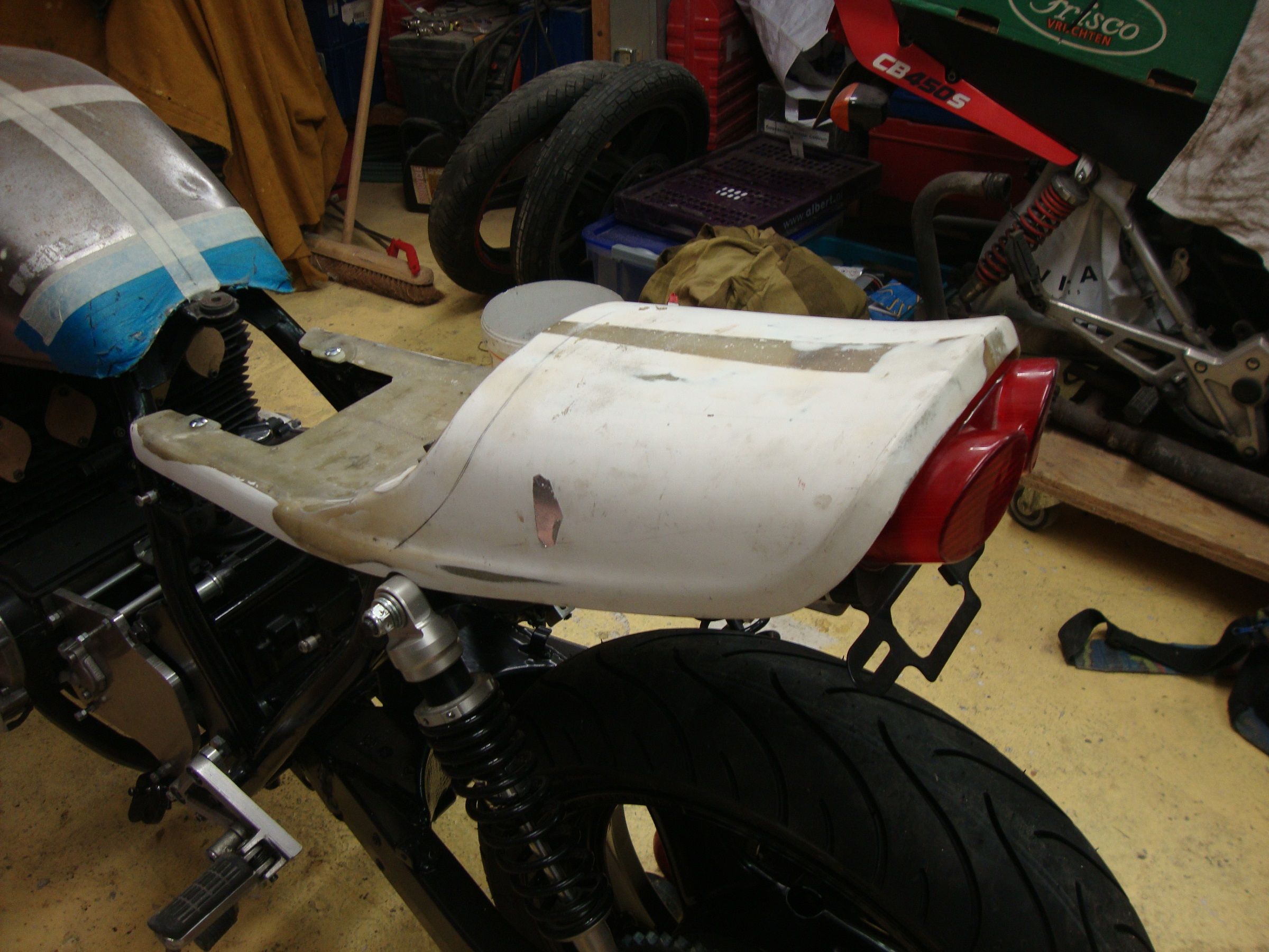

Digging that look davido! Is that a stock duck tail or you fab it up entirely? Going to be sweet!

Love the progress David, looking really good and I agree with Wrench, that ducktail will look killer when it is all said and done! Keep it up you are getting so close to the finish line buddy!

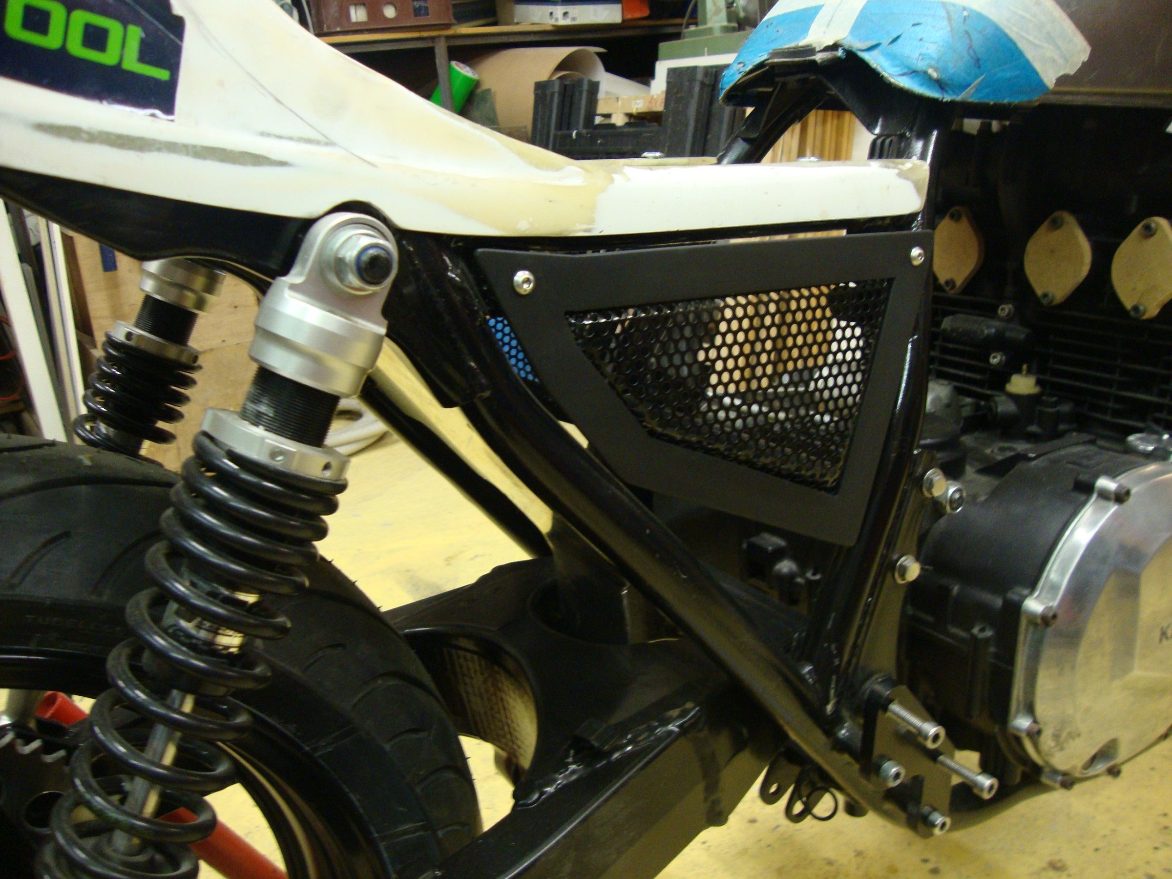

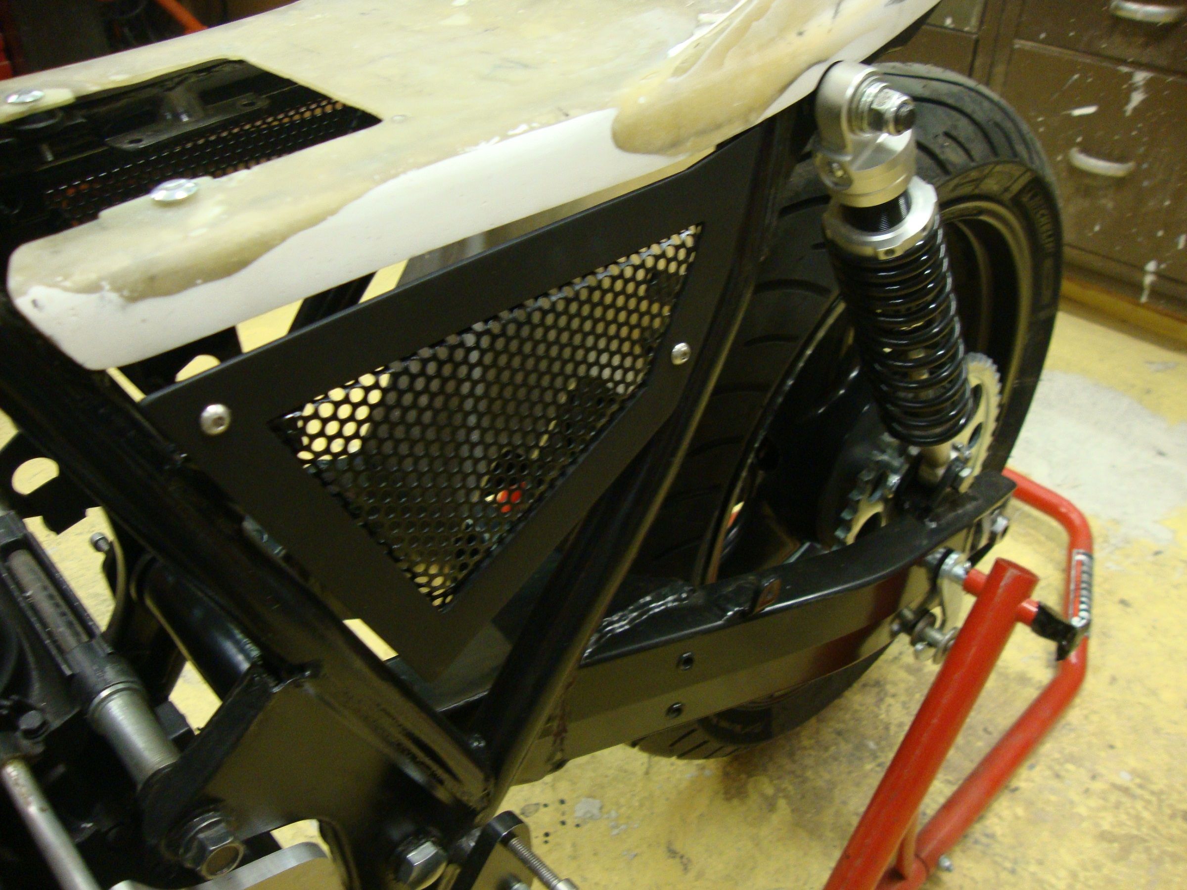

Thanks for the input boys. Im relieved that the bulge isnt a problem,though it is a bit weird.

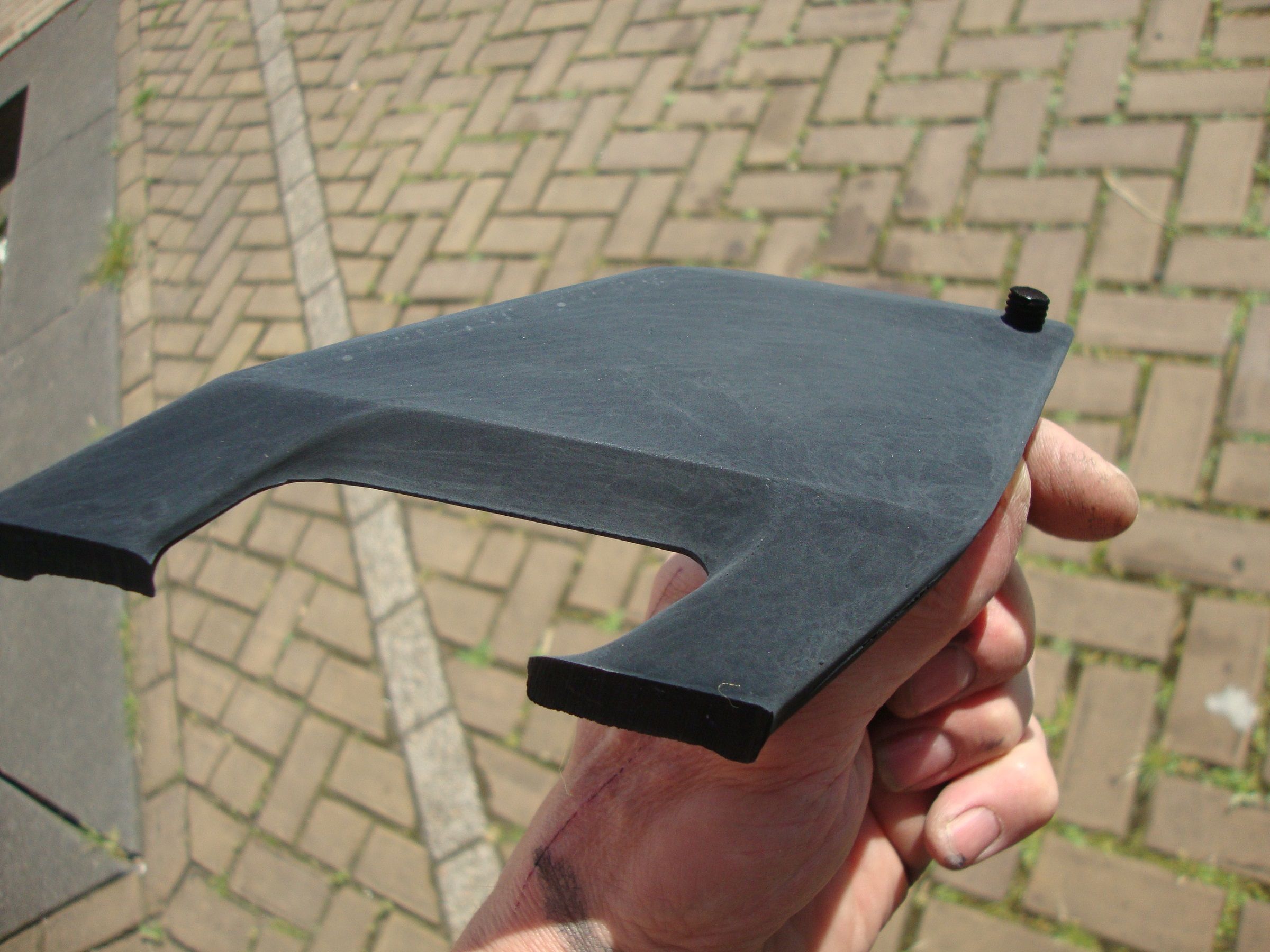

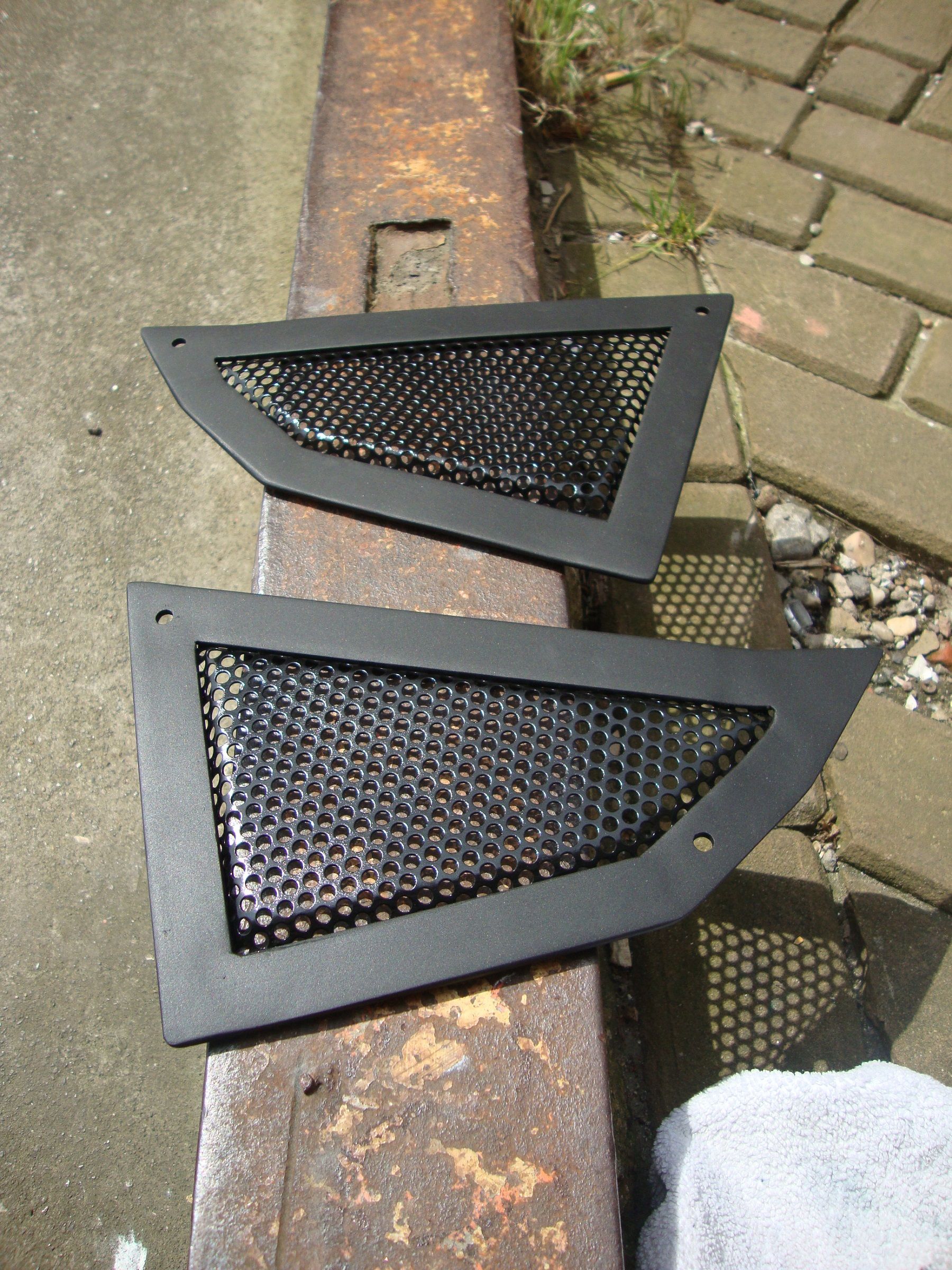

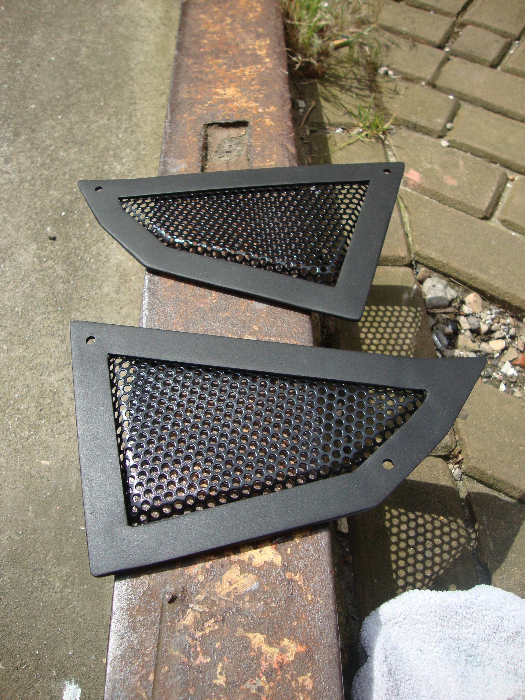

I sanded and repainted the panels today (with the same crap paint) I dont have very high hopes for the finished result. I think I will strip them and take them to the blasters before repainting with a different paint. What a pain!
The electrics are pretty much sorted for now (fingers crossed) I did solder a couple of earth wires on the indicator bulb holders and found a double earth feed into the loom,that took them. So that was ok. Im going to ditch that though and go for 2wire aftermarket indicators.No running lights or hazard lights. I got the european switches wired in,which Im happy about and it all seems to work.Im waiting now for a load of electrickery stuff from these people;
www.vehicle-wiring-products.eu/?jssCart=...bb90a1514c1ec50a81f3
Multi connectors,bullet connectors and some fresh wire (in the right colours!!) and I think I also ordered a blade fuse box.Should arrive this week sometime.

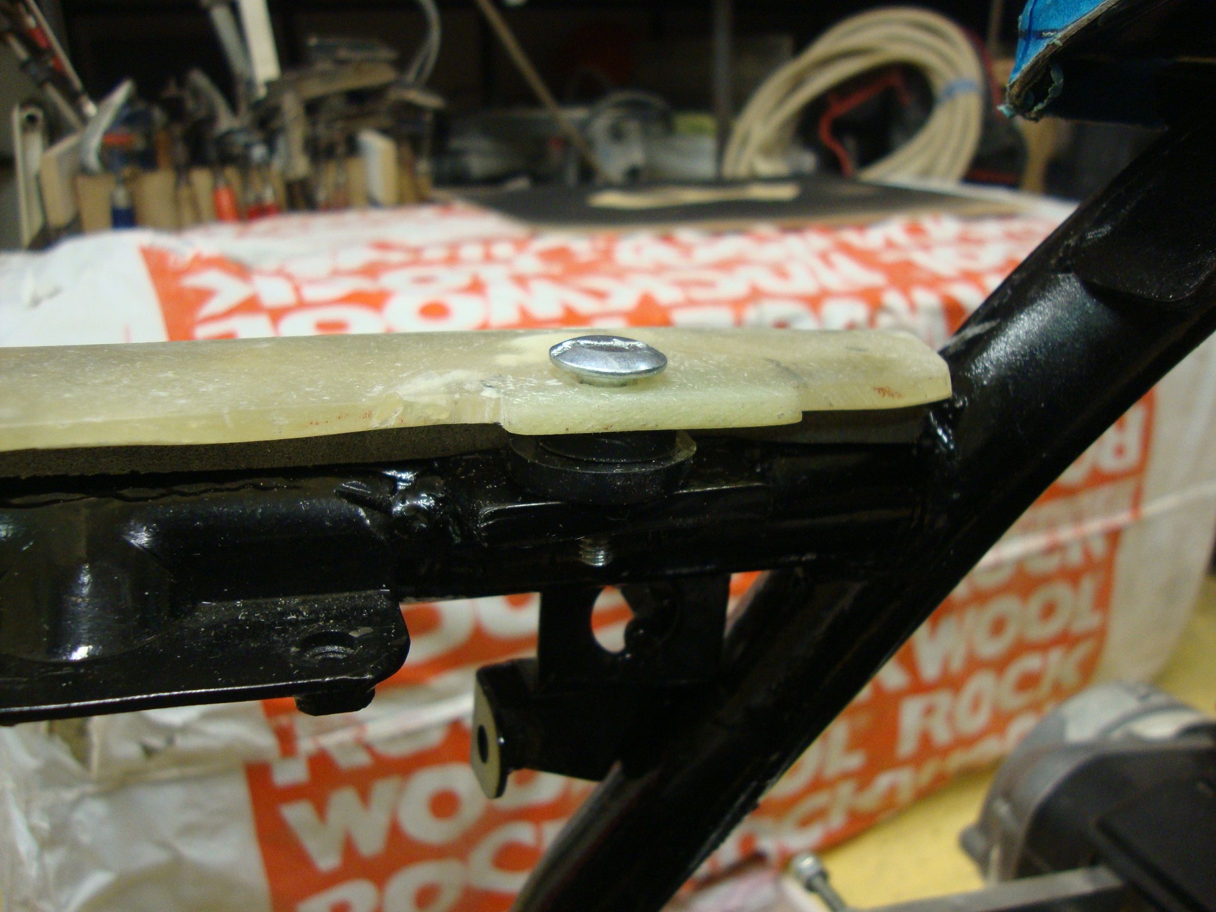

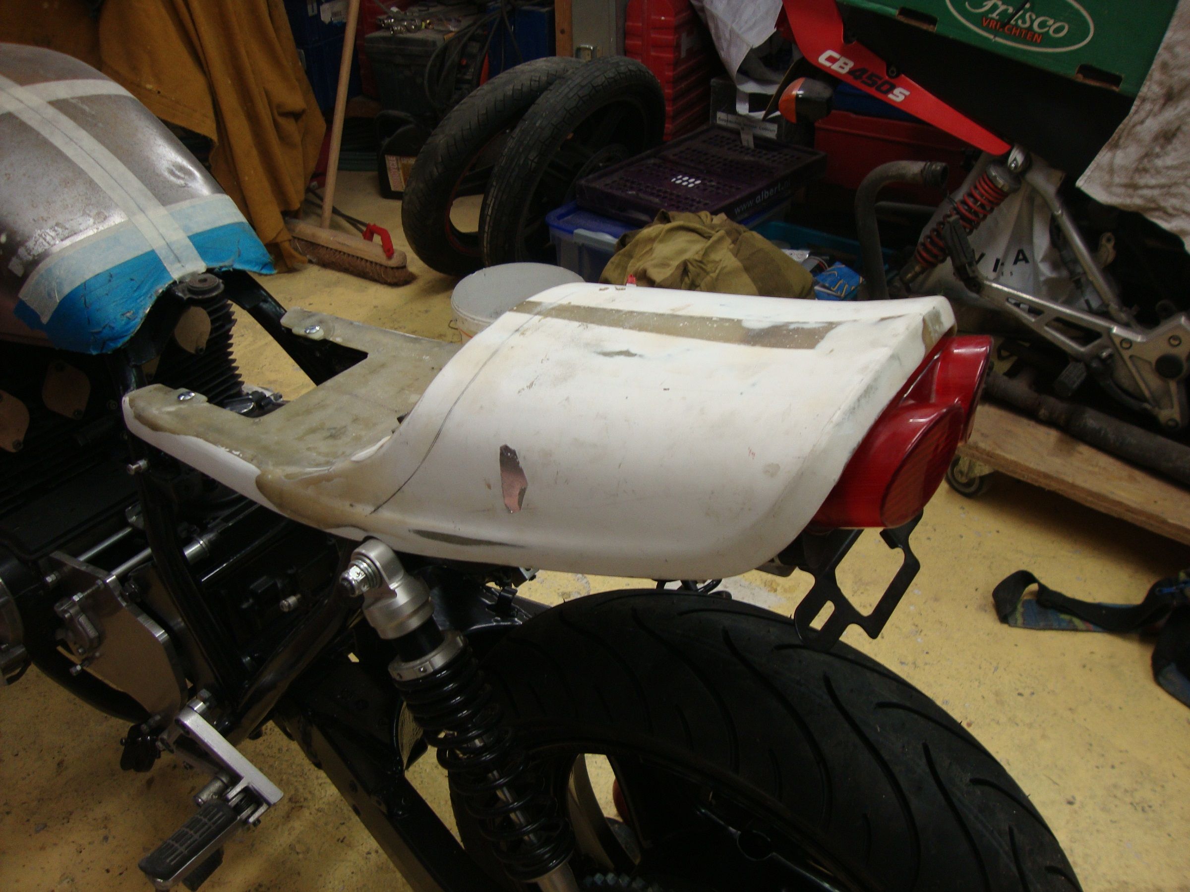

The 'Ducktail'. Yes,Im well chuffed with that. It was a fiberglass Z1 repro from ebay..It was too narrow for the frame so I had to slice it down the middle and re-fiberglass it. The whole process is earlier in the thread somewhere.(my first time fiberglassing!).I still have to sand it and fill some small holes before painting.Thatll come later.

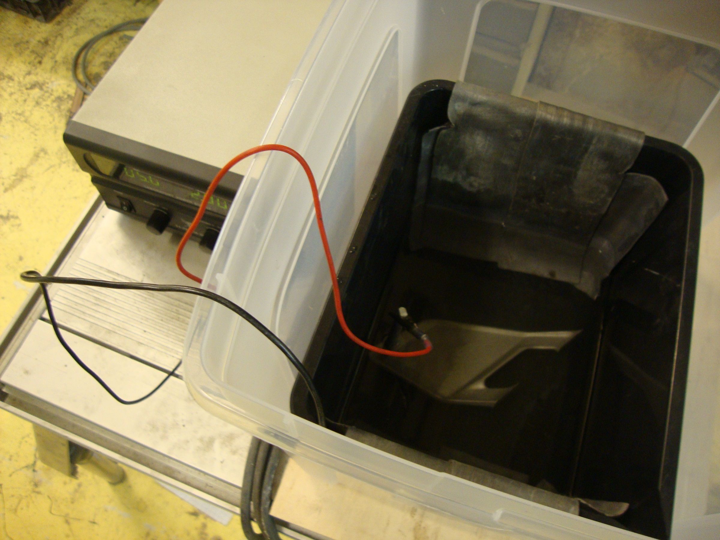

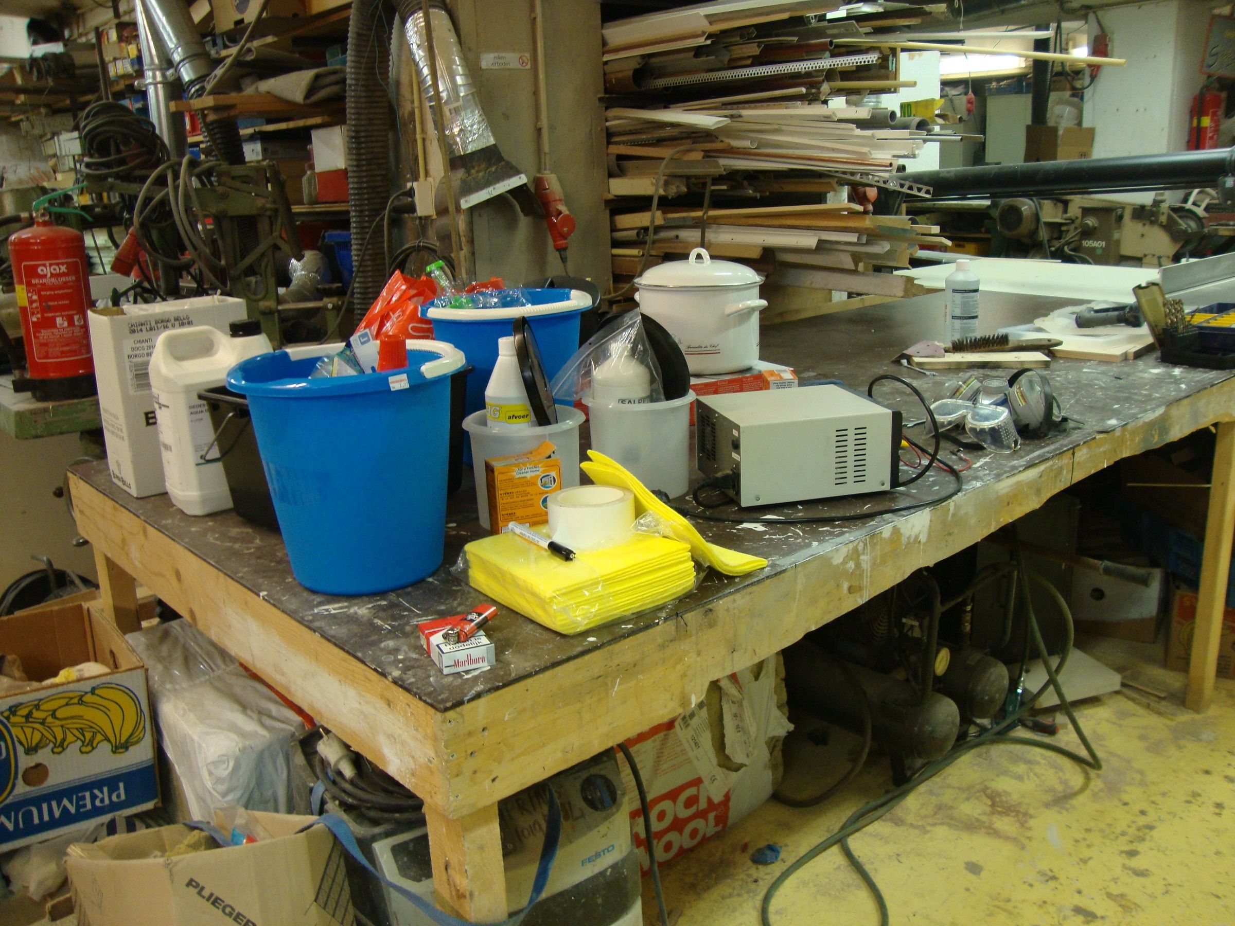

So,I finally got all the lotions and potions together for my first attempt at anodising aluminium.Many hours of research on the interweb gave me a basic idea of how to go about it,
All the bits and more

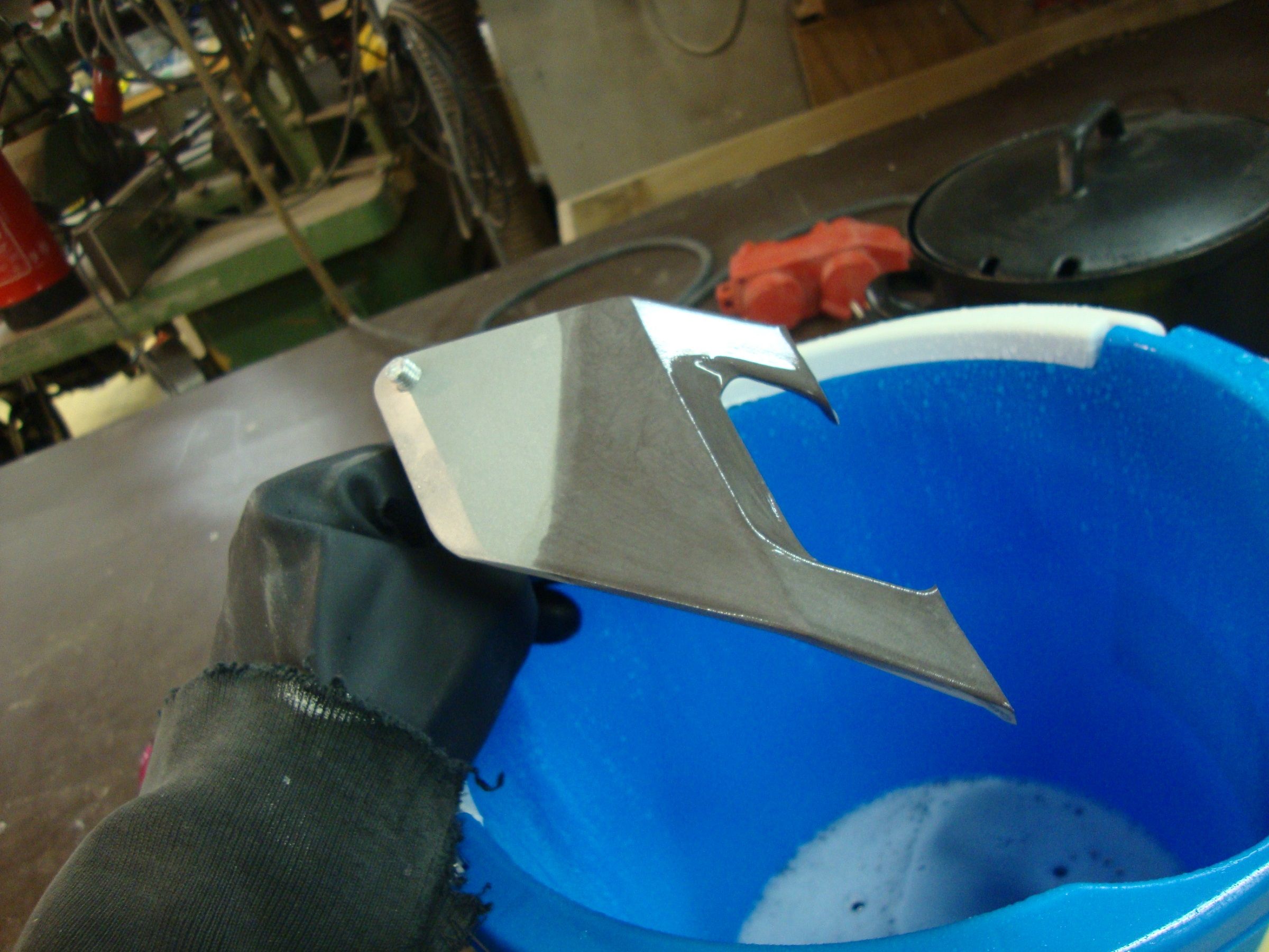

The first attempt was very patchy and I could scrape it off with my fingernail.Not good.Second attempt was an offcut from a CBR footrest.
First stage after a good cleaning,was a dip in drain cleaner (couldnt find proper caustic soda.)
The pot was too small for the whole piece,so I just dipped half of it to see what happens.Follow that with a Nitric acid dip and then into the
anodising bath
Finding pure Sulphuric acid hasntbeen possible so far,so I ended up using battery acid (only37% Sulphuric acid).
Then 20 minutes in the dye bath and half an hour sealing in simmering water and here you have it.
Result.
This is just my second attempt,so I have a long way to go. A better acid/water mix. I need to sort out the Volts/Amps on the tank as well
and maybe be a bit more accurate with the timing and the temperatures.
But its a start.Chuffed!
A curious thing,as a side note. The CBR piece was sandblasted on one side only,and as you saw in the photo,only half of it was dipped in the caustic and nitric pots.Yet the result was a uniform matt coating all over.Front and back dipped and undipped ends! Not sure whats going on there.
P.S. Let it be known,I am not a chemist and am kicking myself yet again for not paying attention during chemistry class in school!!!

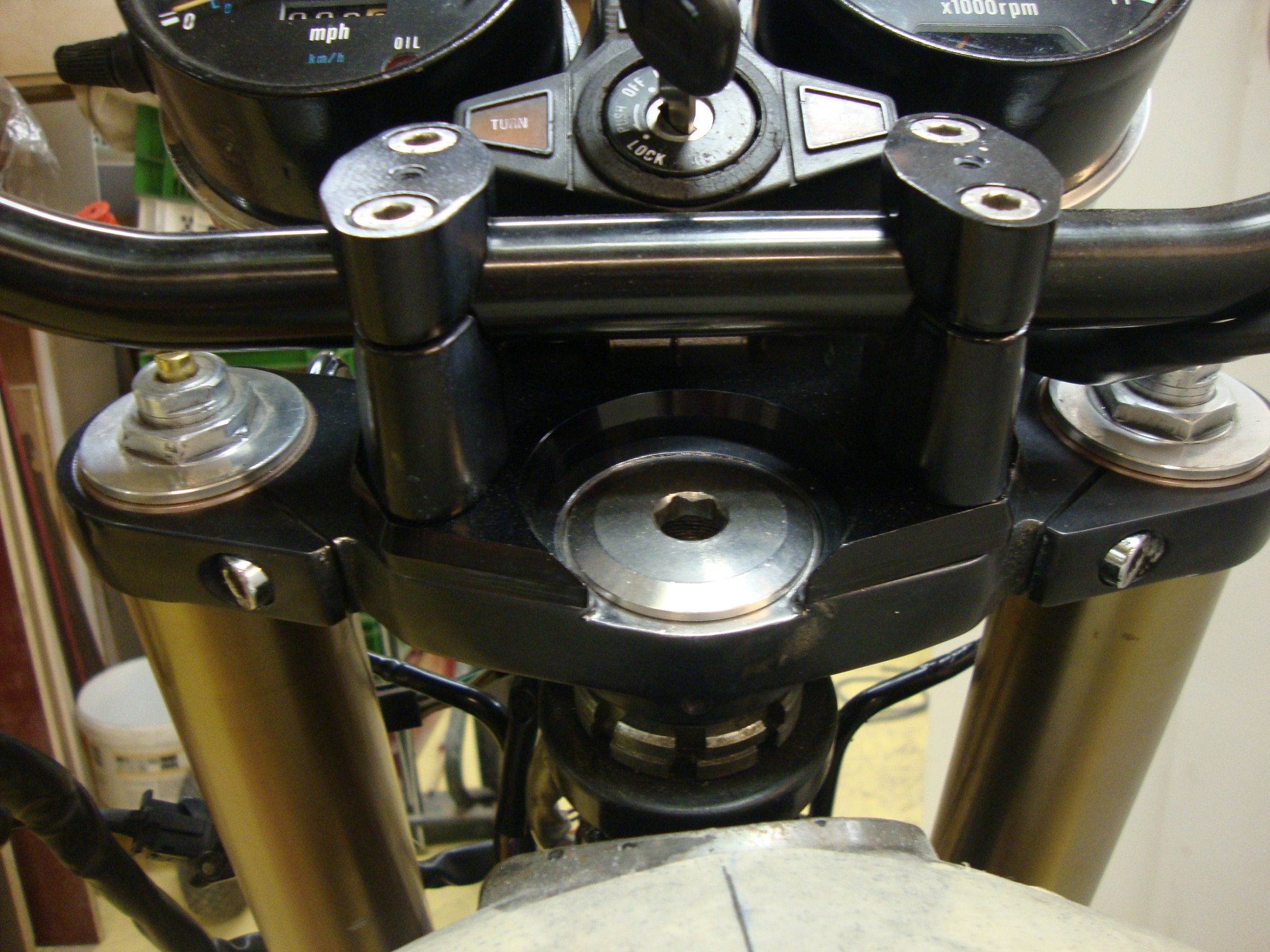

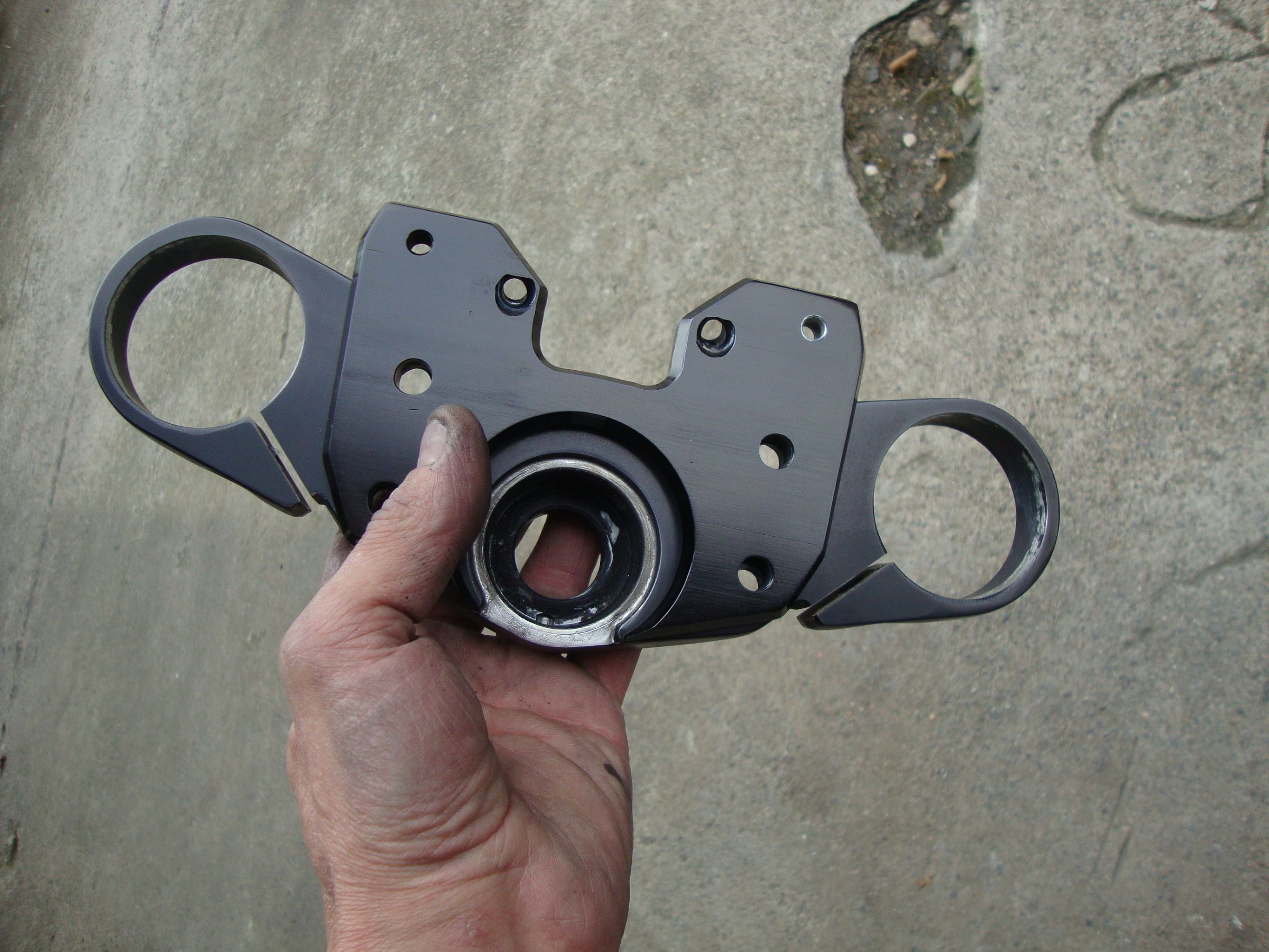

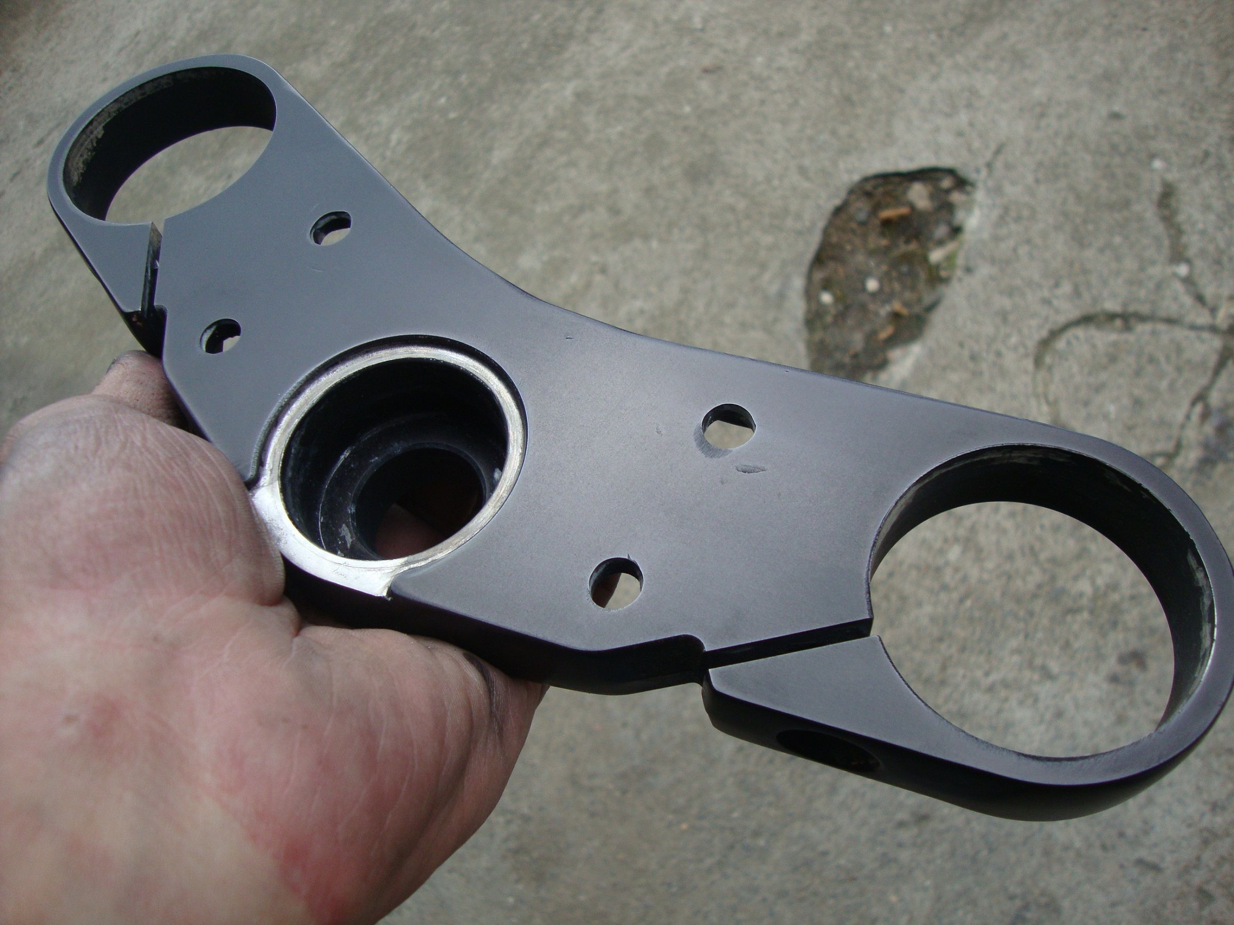

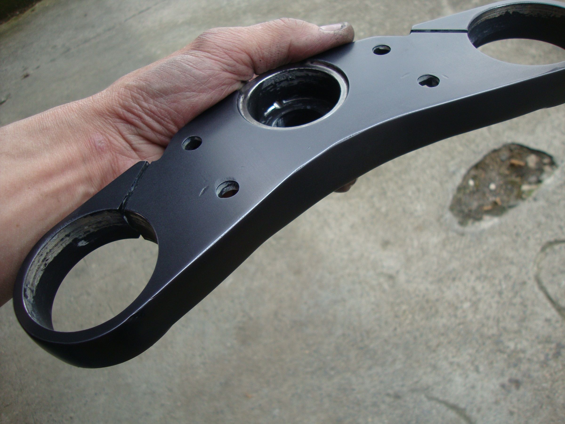

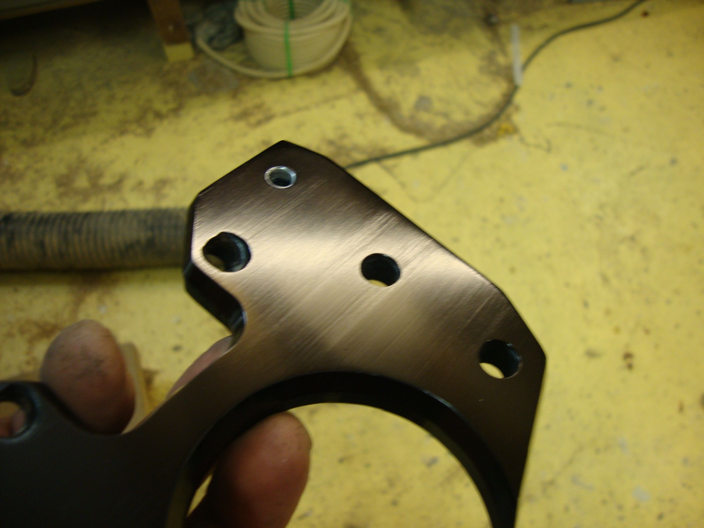

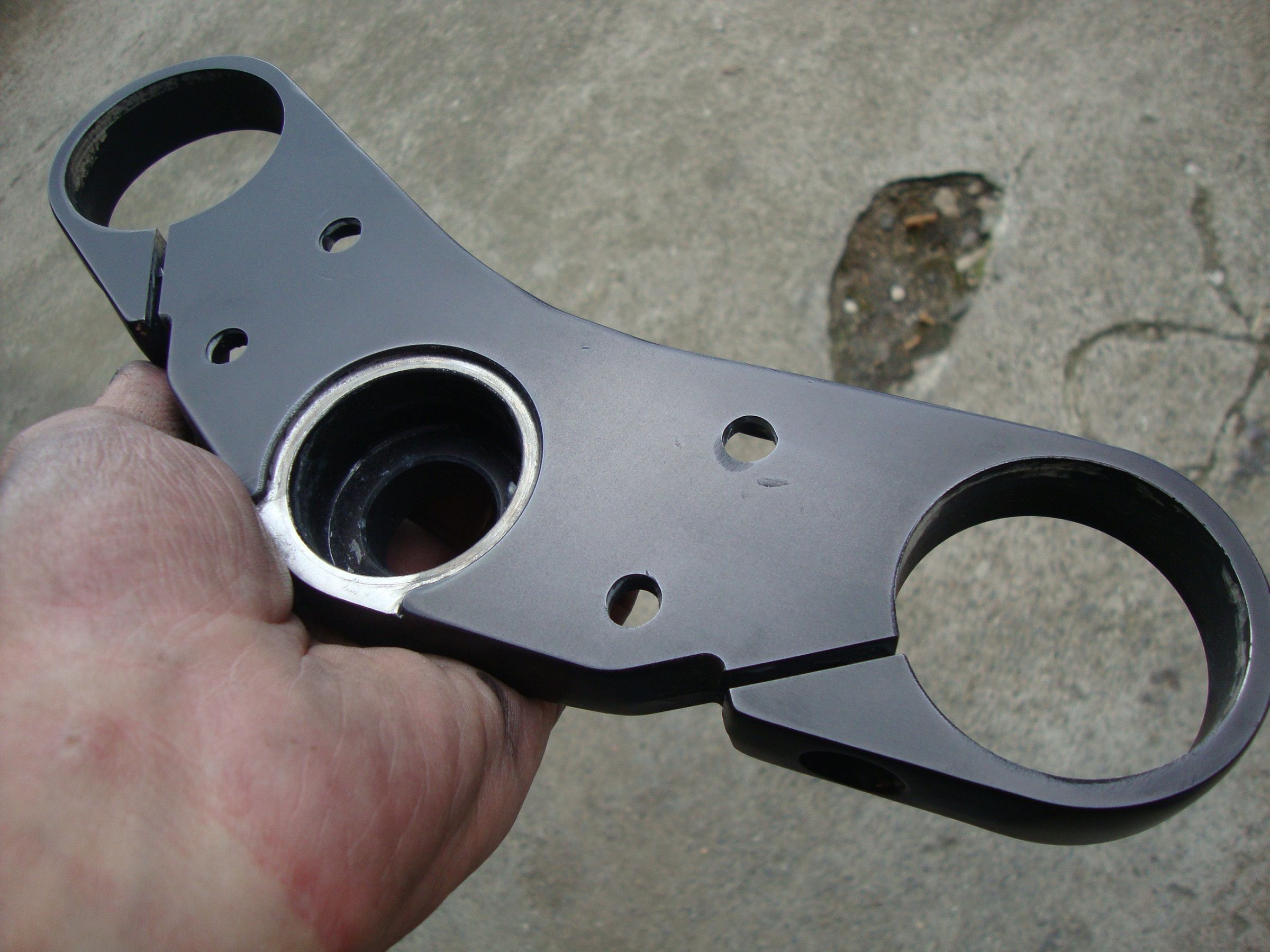

Another busy weekend playing with chemicals and things are improving.

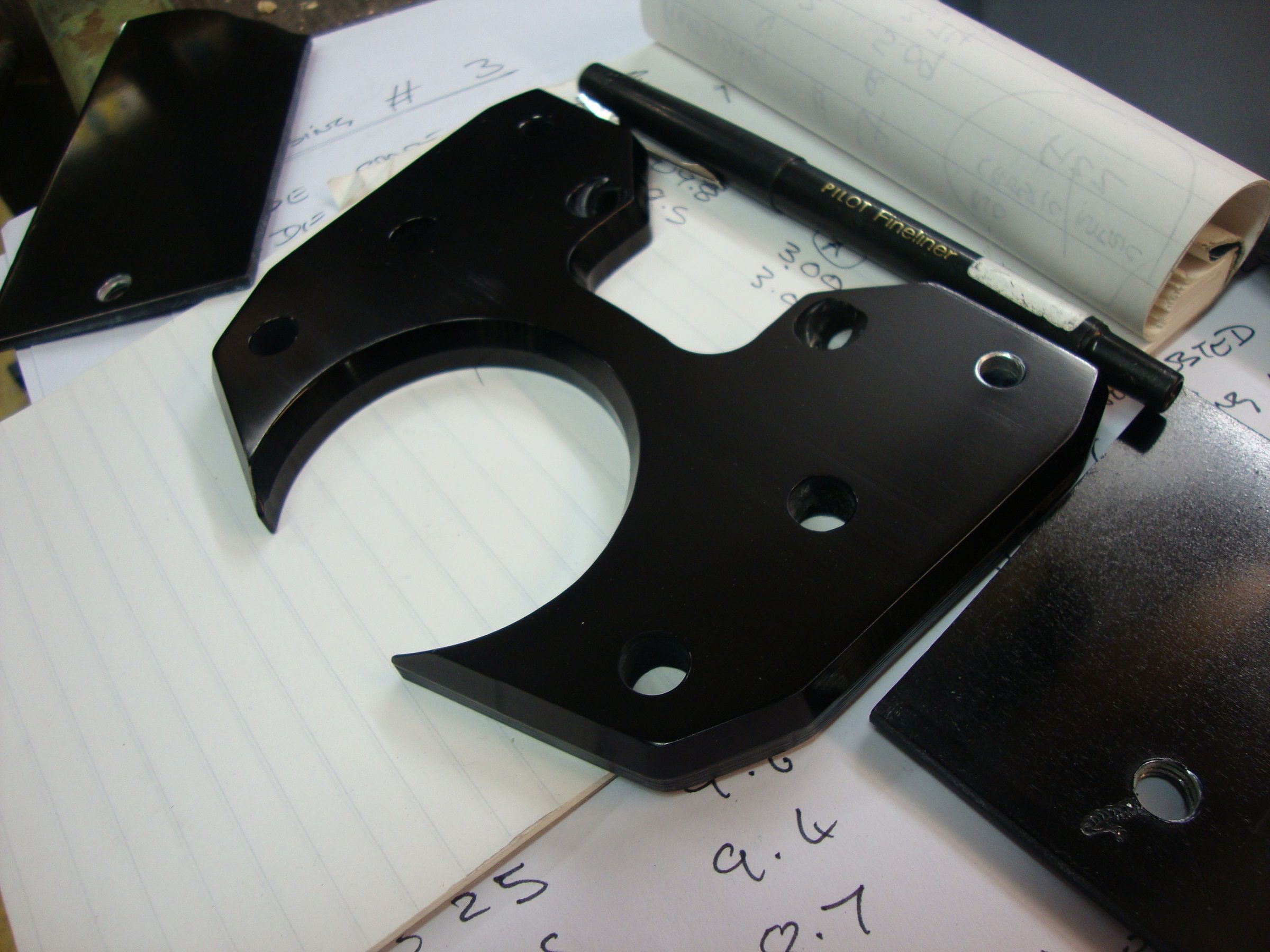

The bracket for the clocks and ignition switch came out nicely. A bit of a shine on it.
and the sanding marks give a nice effect

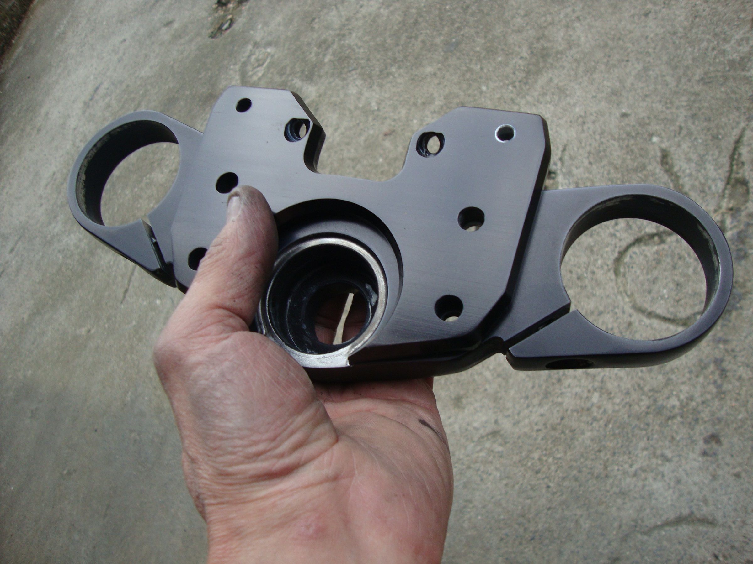

The top yoke was a bit duller.Dont know why as I polished the bollocks out of it
It still looks good though and they work well together

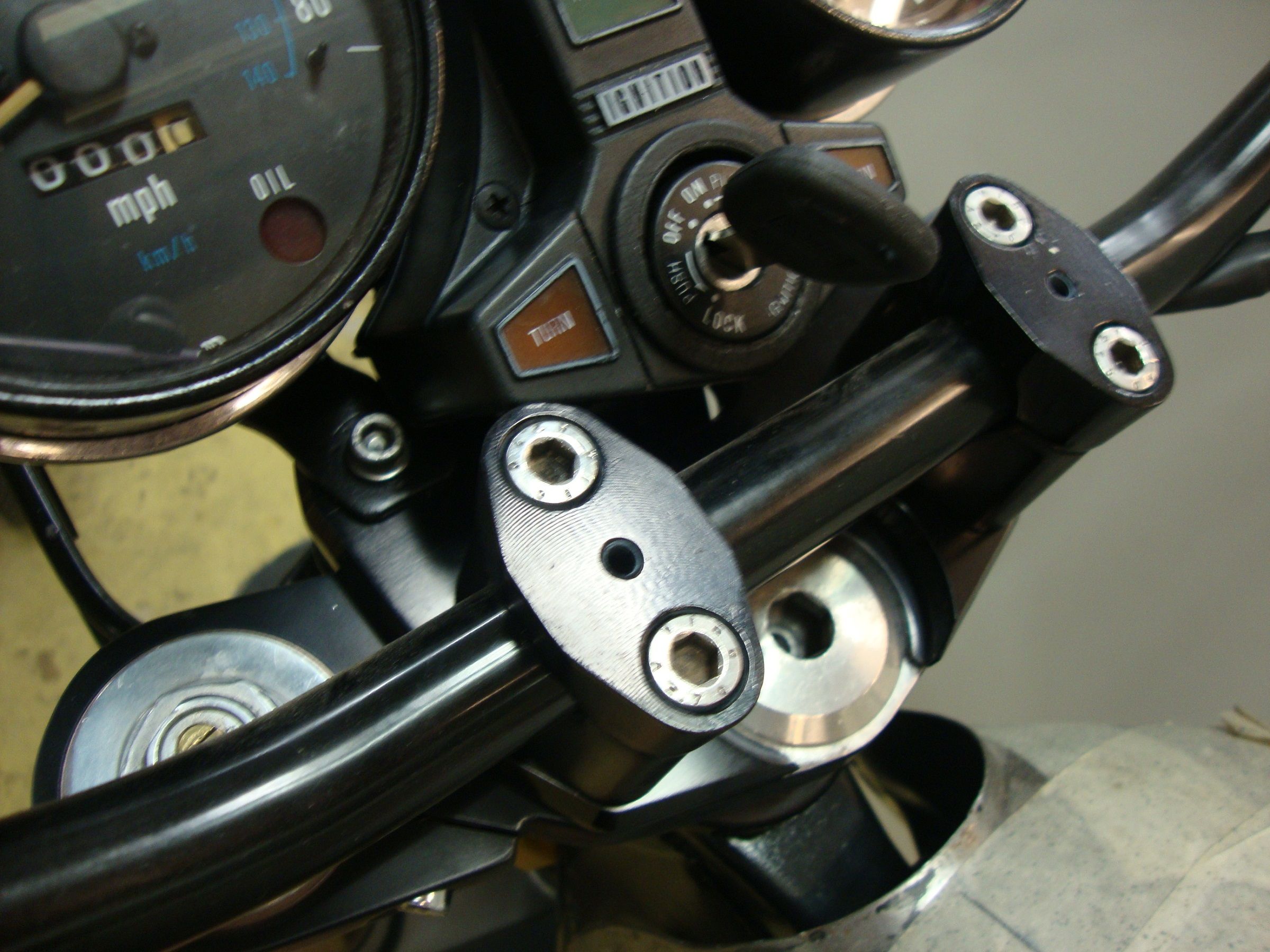

So,im well happy with that little lot. I can start getting the steering together now. Finally.
Ive also anodised the rearset mounting plates that I made a while ago.I havent polished them yet,so Im not sure how they came out.(gloss or matt) and I did want to do the rearsets themselves but the brake side has a steel shaft in it (which wont come out) so Ill have to think around that. Or maybe Ill just paint them.
Im also thinking about anodising the engine cases. But Ill need a bigger boat for that.

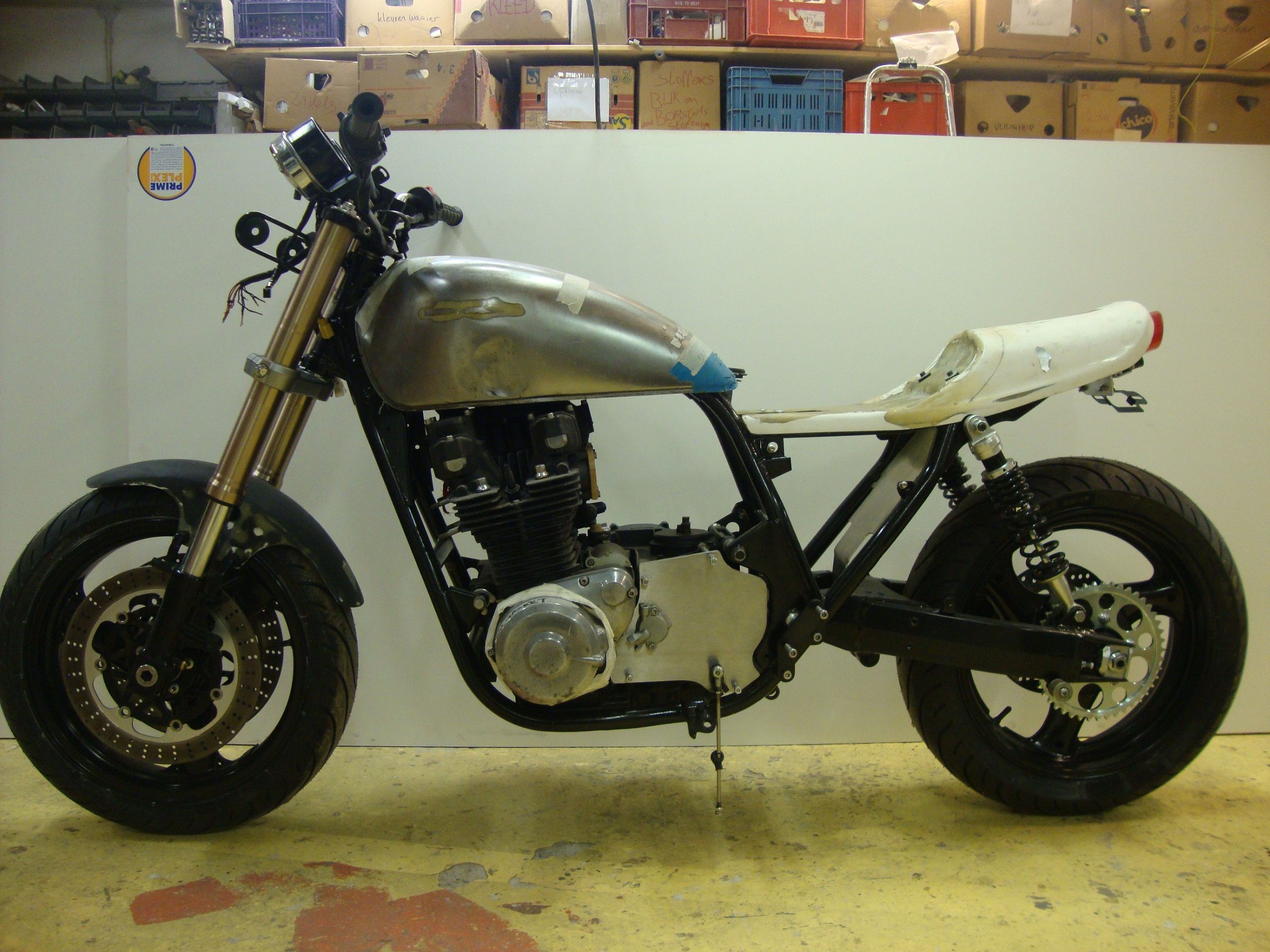

Today, a bit more painting. Some assembling and a lot of going through boxes trying to find odd small parts that I put away somewhere 2 and a half years ago!!!
Heres the FOP all put together.Its been a long time coming.
and I finally got a good finish on the side panels
Thats it for this weekend.I also got the rearsets painted,though theyre not dry yet.I was hoping to anodise them but the gearshift side has a steel insert in it which I just could not get out,so no way I could put that in the anodising tank.Ill maybe get the chance to put them together and fit them sometime this week. Ive also got to get the brake/clutch M/Cs back together.

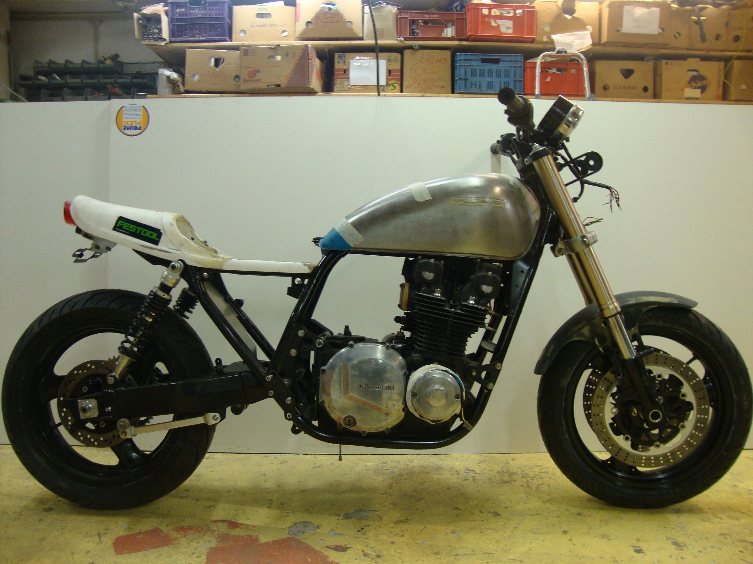

Im now starting to think on a colour scheme and whatever go faster stripes etc. So I took a couple of side-on pics to play with in photoshop.
