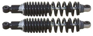

shocks are sagged a bit...those old street strokers loose their oomph by now....ikon makes a dial a ride that is nice for the kz and handle killer

What, you don't like the pretty blue coils? I bought the bike a couple years ago for my father to ride, but I think he was a bit intimidated because his feet don't touch flat on the ground. Plus he's 74 now and a bit afraid the bike would break him. I took it for a ride when I got it home today and it feels like a hard tail. For sure new shocks will be on the list. I do like the looks of the ZRX shocks with the piggy backs.

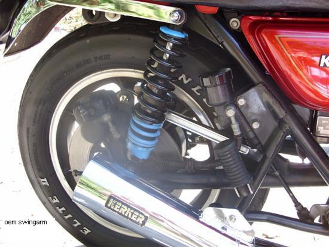

That's wierd. The mount in the picture looks like an after thought. I just looked at the mount behind the side cover and it looks OEM.

Frame No. Z1F-090121 should be a 1976 KZ900-A4 (with rear drum brake), but the unexposed rear brake master cylinder would be on a 1977 or later KZ1000 frame.
All the 1976 KZ900LTD frames were manufactured at Kawasaki's USA factory in Lincoln, Nebraska.
The bike at hand seems to have a 1977 or later KZ1000 frame with VIN label from a 1976 KZ900-A4 frame manufactured in Japan.

11 Nov 2012 08:25Somebody used master cylinder mount off differant frame possibly,Id put my money on somebody cut the steering head and part of frame tubes off a 900 frame with a title and butt welded it together onto a kz1000 frame without a title,that would explain the busted frame tube where they welded it together and ground it down to hide it.Haybus wrote: That's wierd. The mount in the picture looks like an after thought. I just looked at the mount behind the side cover and it looks OEM.
something like that should always be slugged with a piece of tubing inside the frame tubes and plug welded before butt welding origional tubes to tie them together .
Can you remove gas tank and post picture of backbone tubes on top of frame?
Whats the numbers on engine cases?

This is a 77 kz900 frame Ive got sitting in my basement,theyre actually left over 76s that kawasaki unloaded as early 77s in my book anyway.
Anyway the frame is the same as a 76 kz900a series bike,notice no master cylinder mount they used a drum rear brake on the regular a series kz bikes till the 77 kz1000 came out in mid year of 76.
So somebody did a little modifying somewhere in its past
