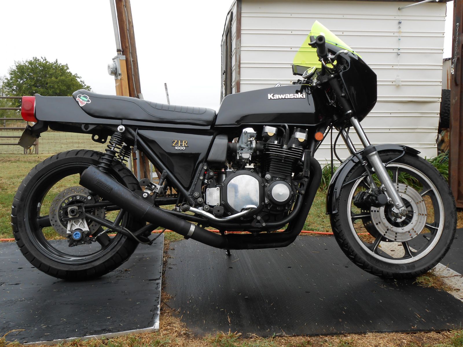

No eBay APP ID and/or Cert ID defined in Kunena configurationCheck this out Jarrad. Sorry, just seen it sold
Les
