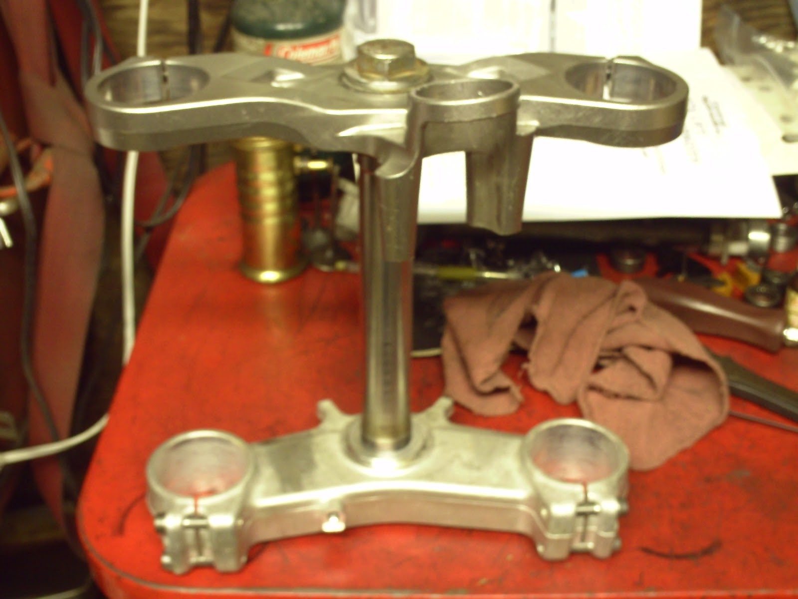

Well Leon (531blackbanshee) has been working on my triples quite diligently. He was also kind enough to send me some pics of the work for a better understanding of how it works, so I'll share with you all (hope you don't mind Leon).
Stem pressed out of the KZ triples
Bushing made so the stem can be pressed into the ZX-6R triples
Bushing on the stem before weld, and after.
And the stem all together.
All in all a pretty neat process if you ask me, and appears to be superb work!
