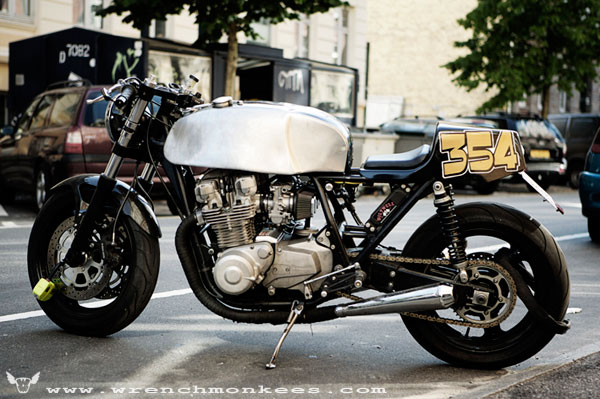

here is a wrench monkeys bike with the same tail to give you and idea of what it could look like.

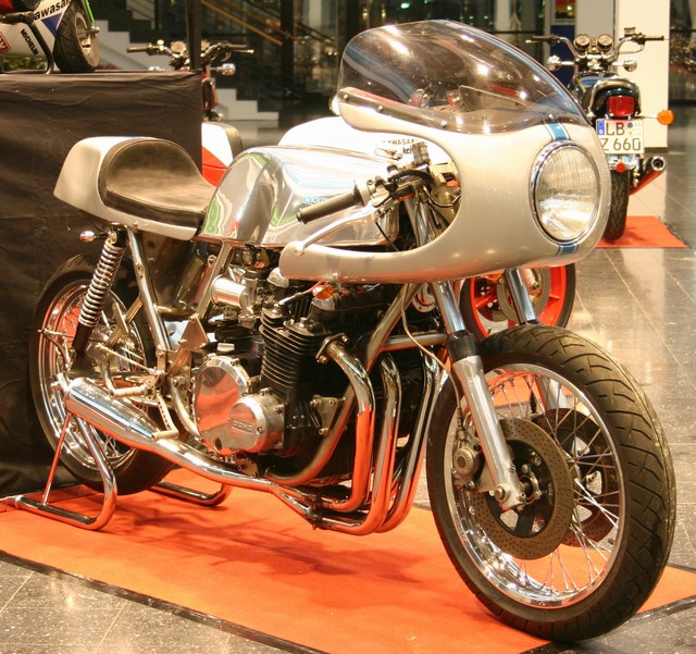

here is another kz with the ducati tail but also with the ducati fairng and a hand made aluminum tank aswell.

I really like those tail sections Leon. Do you know if I would need to straighten the dip in my frame to make those work? I'm probably going to flat black out all the body parts until I get my whole conversion done. I went on airtech streamlining and there are so many cool tail sections it is going to be hard to decide. I've started making a aluminum tail but so far it looks like I'll be buying one. Thanks for the links. Keep the ideas coming.
