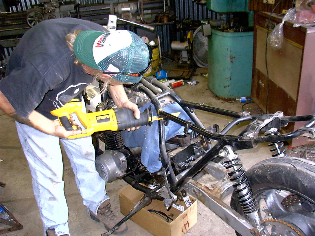

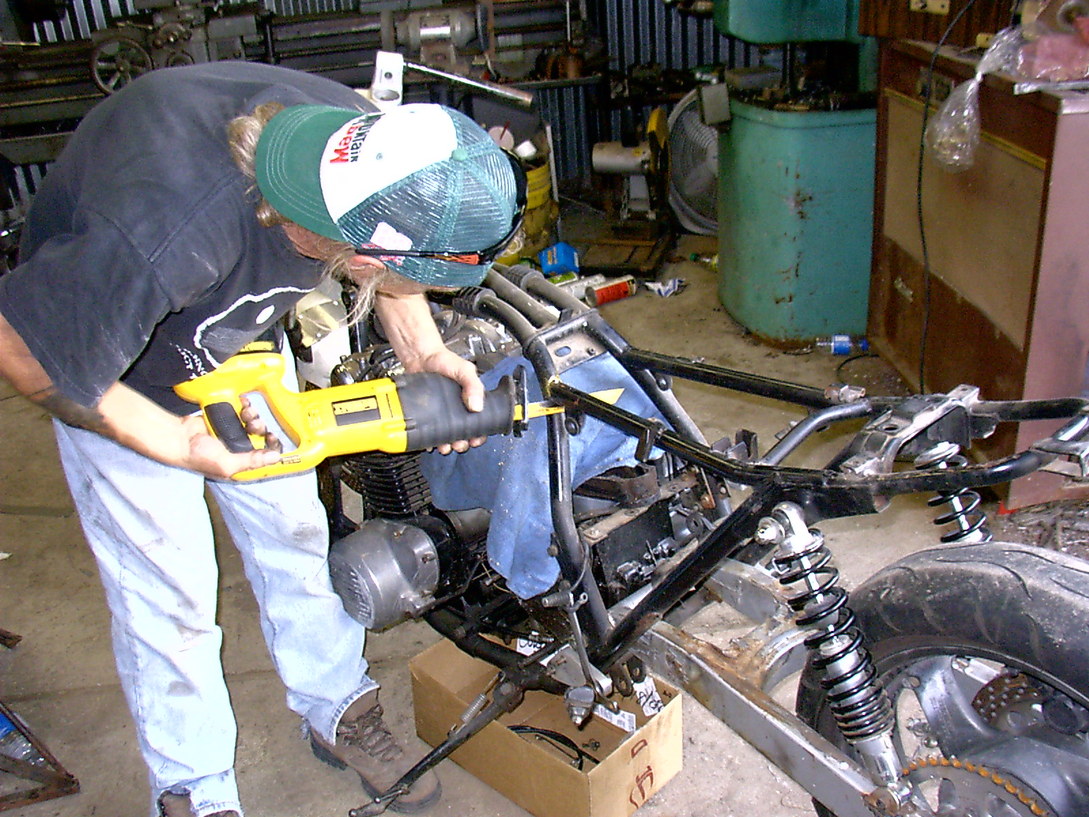

well first you give your buddy a sawzall :woohoo:

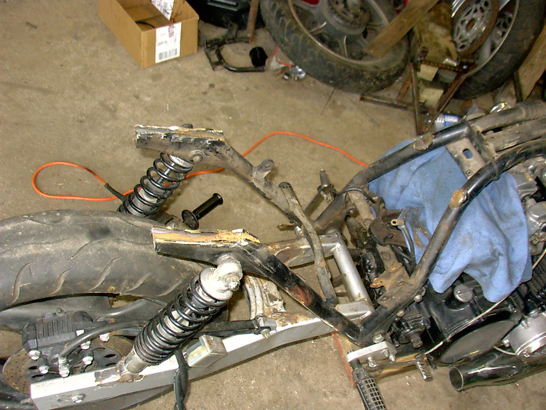

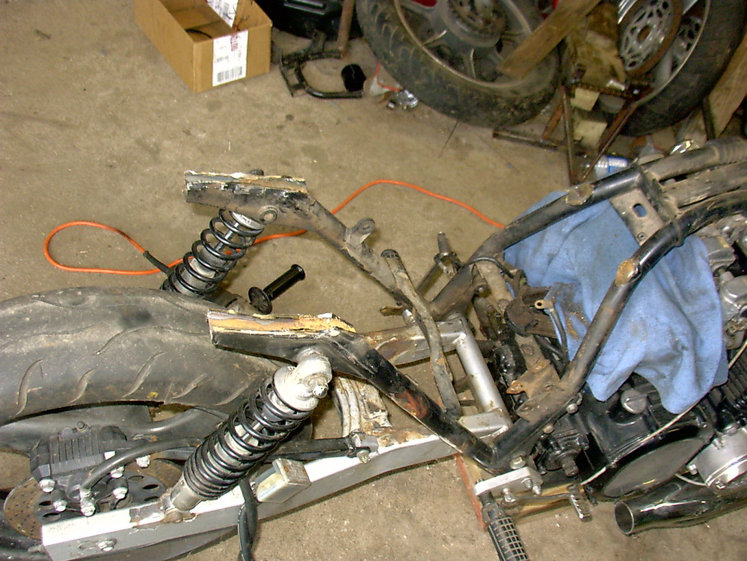

and after a couple whacks here and there it looks somethinig like this. :ohmy:

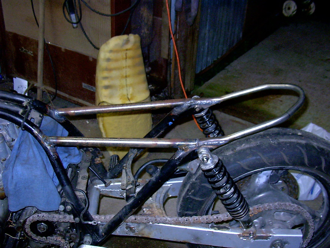

and then you fit and tweek some tube to your satisfaction.ours looked like this :whistle:
a couple cross braces to tie it all together maybe a gusset here and there.

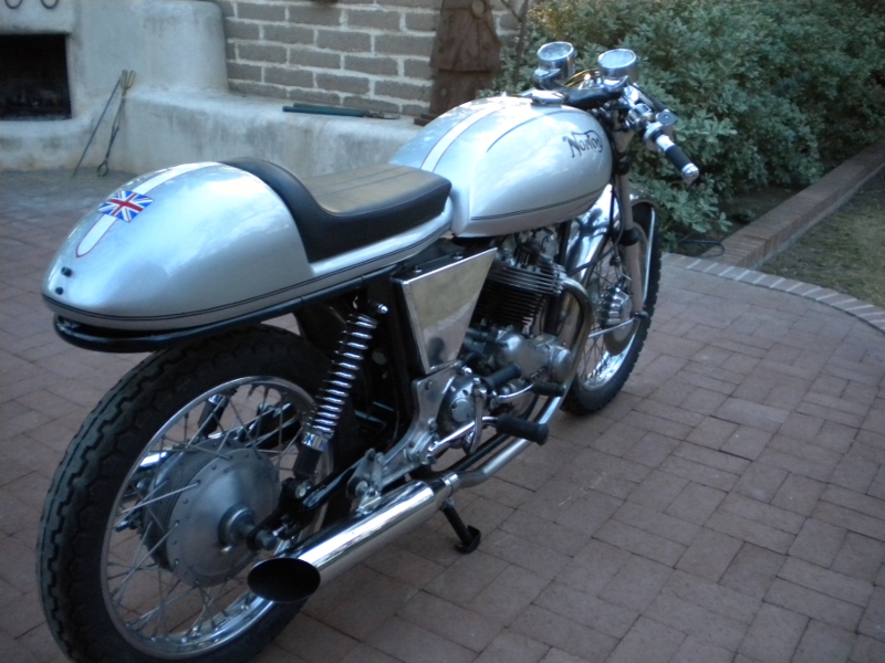

you can either tuck it up under the edges of the seat/tail or have the tube just right under the edge.like this bike from the ad you posted.
