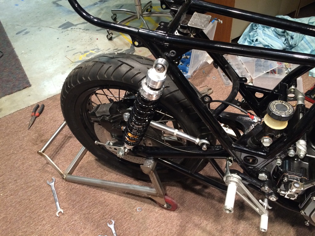

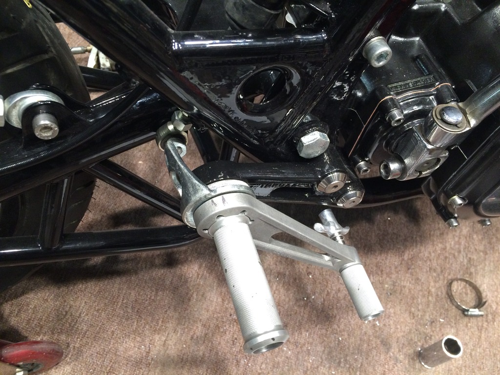

Unfortunately I wont be getting a garage till this summer so the bikes have to stay in storage. I am going to do some assembly and figure what else this and my other project bike need. So I'm going to take a crap load of measurements of different things I want to machine/fabricate so i can continue progress (at a snails pace) while they are locked up. its the best compromise i could find.
I finally have some time to work on the bike and started assembling a couple more things. Very pleased with how the rear sets worked out, but I need to modify the kick for more clearance, and perhaps get some folding footpegs. which are a good safety feature as well for a street bike. My buddy also gave me this sweet stainless stand he welded up years ago for his track bike.

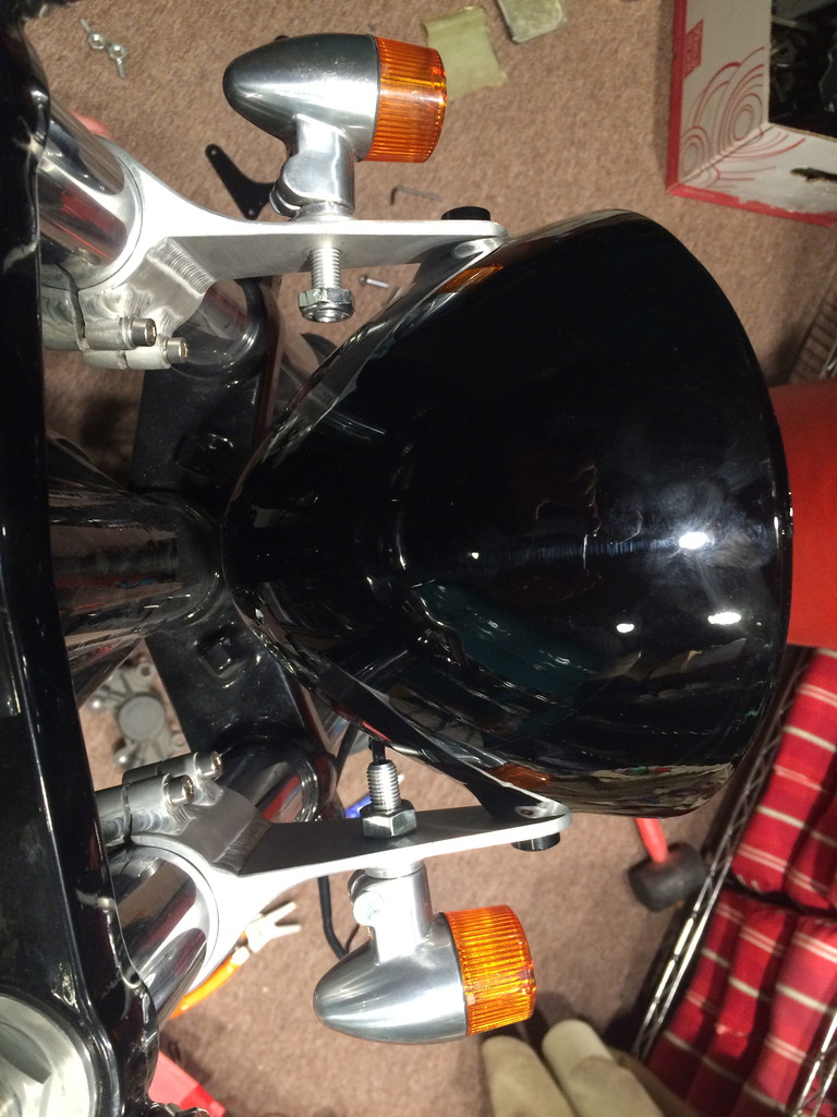

Also here is a design feature I'm trying to work out; I need to finish the back of the turn signal off a little more elegantly. I'm thinkin of triming the bolt down, using a flanged nut, and then routing the wires straight to the headlight bucket with a small hole and a grommet. Im not really satisfied with this solution as i think seeing wires bridging a gap like this doesnt look great, but im am stumped and not willing to remake the headlight ears. I was thinking about getting some cool expandable sleeve to dress up the wires a bit. thoughts?

Rearsets look great Doc. I think the turn signals will loom just fine with nicely done wiring loom. I used black on my bike and the wiring is hardly noticeable.

I agree. Too many other things for the eye to look at.

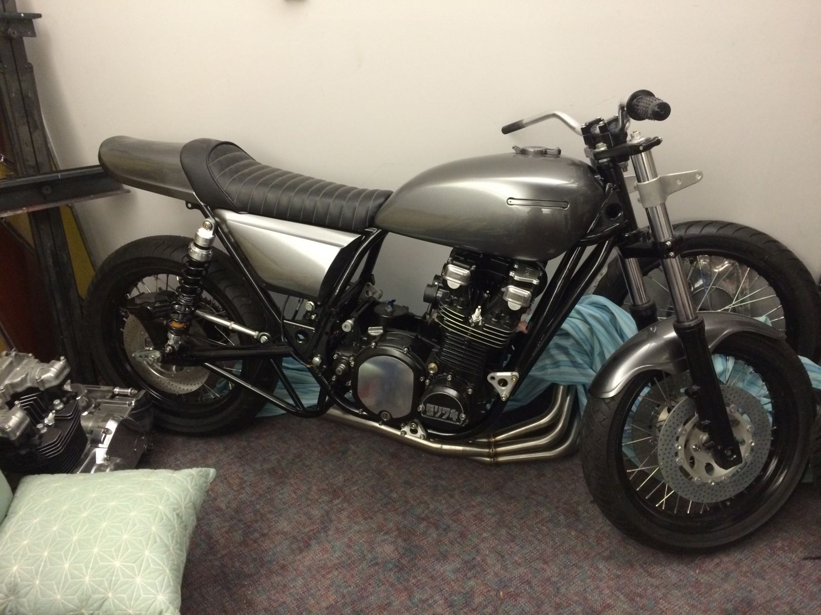

The forgotten child. I finally got off my ass and made some good progress on this. There were some fitment issues that I was dreading dealing with but my friend Eric sorted them out. Because this was the first seat pan I ever made I accidentally went a little too thin on it and when the seat cover was stretched over the pan it caused the whole back end to bow up and had an unsightly 3/4" gap to the tail. Eric bent a piece of titanium (according to him it was because he didn't want to paint it :
