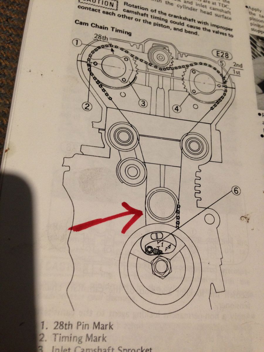

11 May 2015 14:54531blackbanshee wrote: having the engine out you can just pull the lower case without tearing the topend down.
If i just pulled the bottom case how would i get it around the roller? I dont see how you could swap chains with out a total tear down or using a master link. I don't really mind taking the time and doing it except i REALLY am dreading removing the liquid gasket from the case halves.

Pulling the bottom case means you have to split them.....I don't think it'll be such a problem getting the sealant off, I believe it just rolls right off (I would use a plexiglas chisel....I can make/send you a couple if you want). It isn't nearly as tough as getting old paper gasket crud off anywhere else. Once cases are split turn the whole motor upside down then unbolt the center cap (4 bolts) lift out the crank and there you go. I forgot to mention cams have to be out and chain loose.

11 May 2015 23:03 - 11 May 2015 23:16bluezbike wrote: Pulling the bottom case means you have to split them.....I don't think it'll be such a problem getting the sealant off, I believe it just rolls right off (I would use a plexiglas chisel....I can make/send you a couple if you want). It isn't nearly as tough as getting old paper gasket crud off anywhere else. Once cases are split turn the whole motor upside down then unbolt the center cap (4 bolts) lift out the crank and there you go. I forgot to mention cams have to be out and chain loose.
I understand what Leon was saying but the cam chain goes around the rubber roller that is held in between the cylinders and the upper case. The last two times i had to break the engine down after making an oversight in assembly, the case sealant was a PITA to remove because the engine has never been run. The gaskets lift up with no effort because they are brand new and haven't been hot. After talking to Z1 Enterprises today i am feeling a lot more comfortable about the masterlink. It is a very tight fit, and you just slightly peen the ends. There is very little lateral force on the link so it doesn't take much to peen it right. Apparently most failure comes because people over do it.

sorry vic you are completely correct.
i was slippin :pinch: .
the endless chain replacement is going to dictate a complete engine teardown.

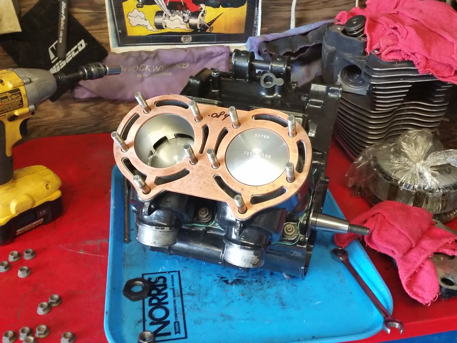

i just built this little banshee stroker motor
and forgot to notch the cases to clear the extra stroke and had to separate it and clean all the yamabond that i had just used :sick: ,
