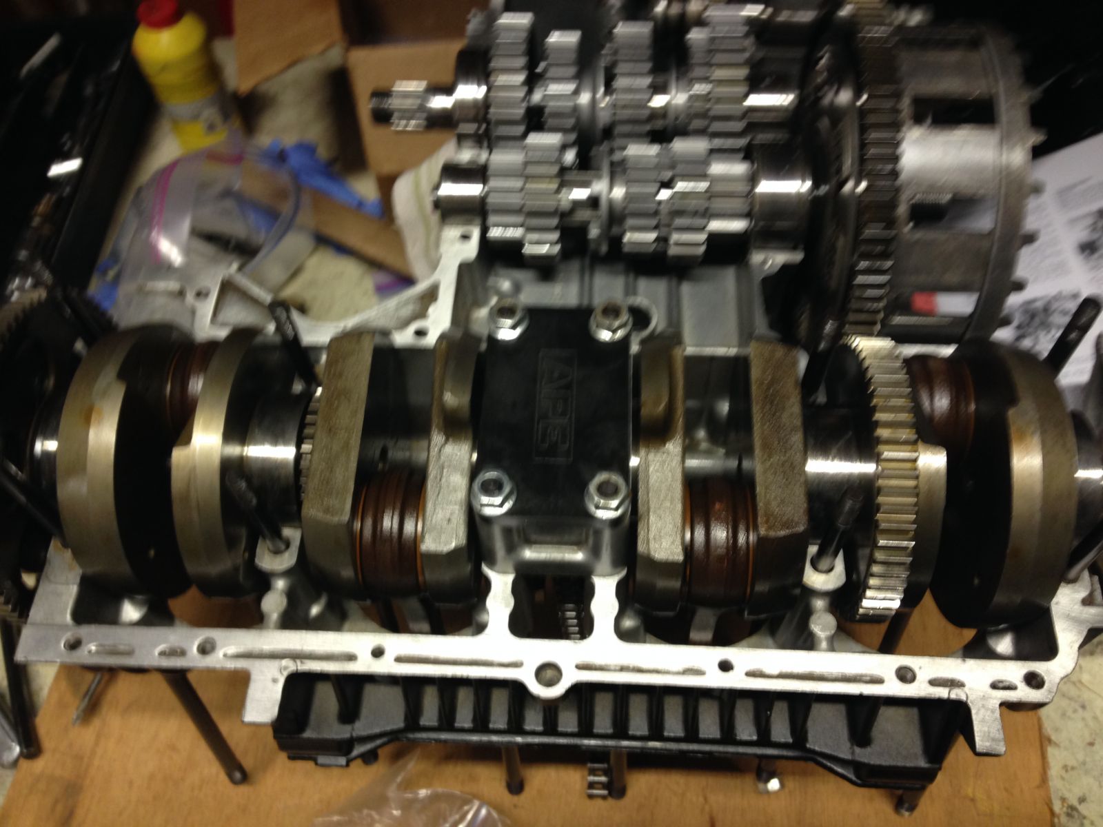

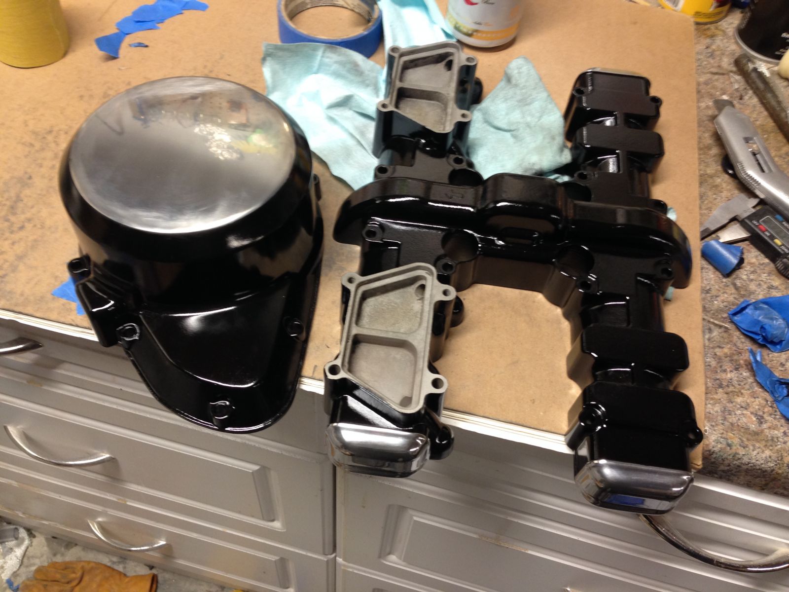

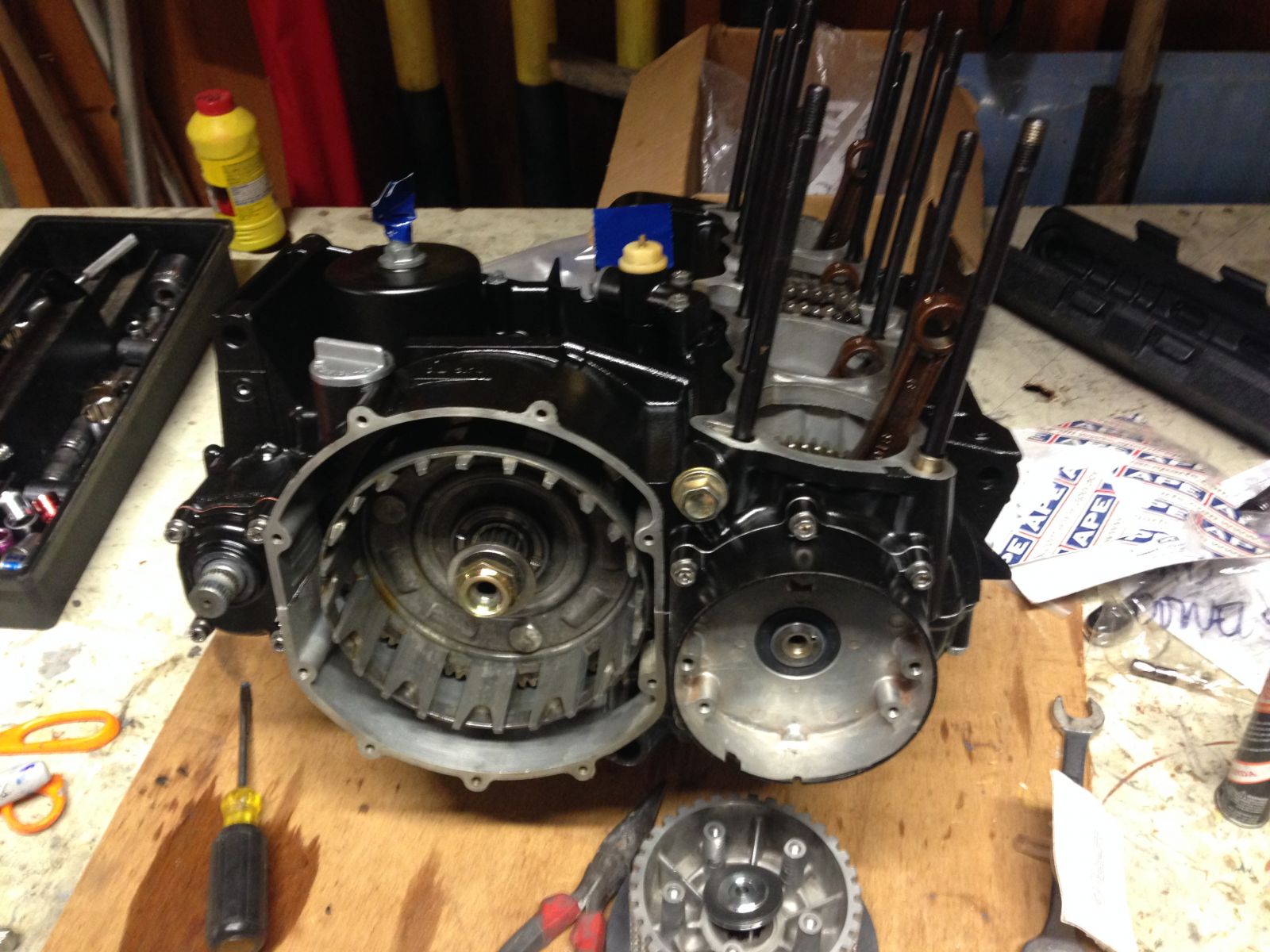

The frame has been sandblasted. Im going to paint it tomorrow or sunday. The caliper brackets for the front brake are finished. I will be picking them up from the machinist on monday.
I finally started on the engine build which i have been procrastinating on. While i was back there I had the main bearing cap machined down for this APE support plate while I was at it. I have a sneaky suspicion i will want to do something crazy with the top end in a couple years.
I have the engine pretty much assembled to the point I was at before. I also detailed the engine covers a bit and polished some stuff.

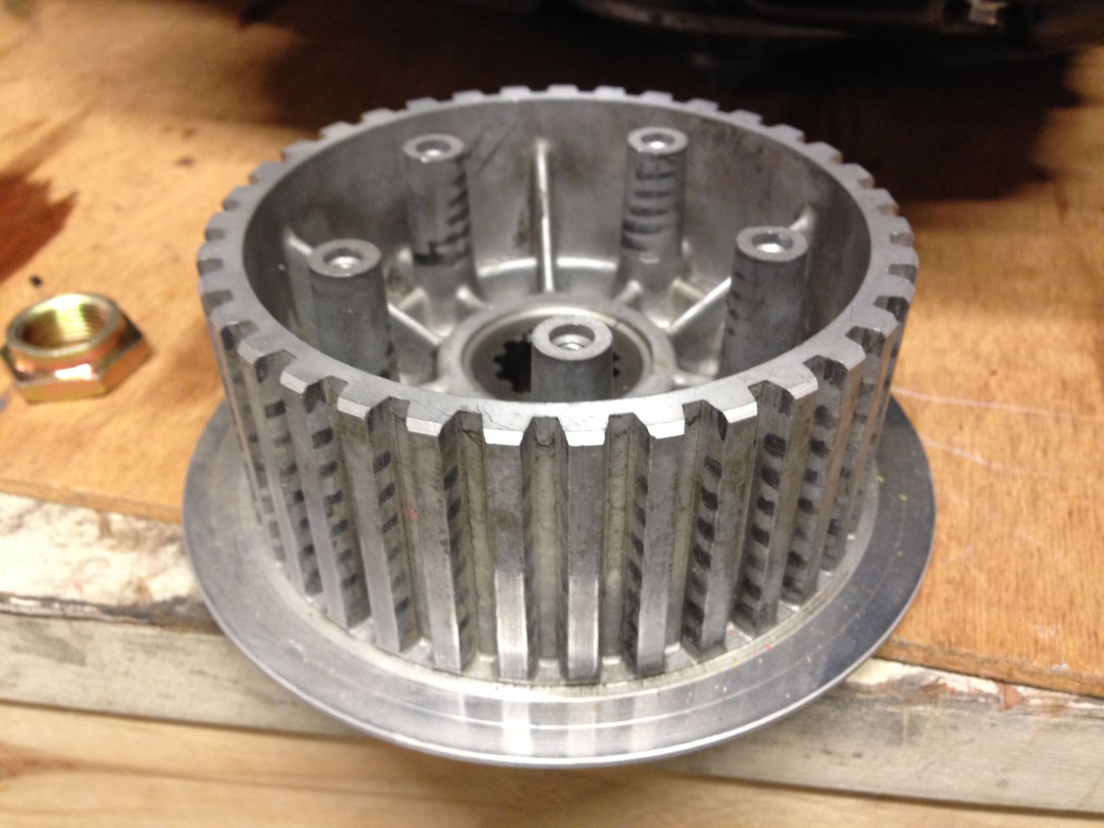

I took the time to carefully debur the clutch basket with a whet stone so the clutch plates slide easily. However, the hub has seen better days, and there are indentations from the plates, i'm worried about the clutch plates snagging on them and causing chatter. should I clean this one up or get a better one off ebay?

- Posts: 7442
- Thanks: 797
Re: 78 KZ1000 build
24 Feb 2015 06:24
if it is any consolation i've seen em much worse.i think i would just dress it up and run it.
