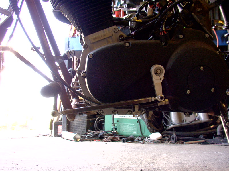

- TNBOBBER
- Posts: 87
Re: Bobbin my KZ1000 LTD
08 Apr 2011 10:46
Here's some close up pics of my forward controls by request. Note: the gear shift attachment is not splined, but I am having a buddy machinist make me a correct spline one for a permanent replacement. The one I made is working well. When on a 100 mile ride yesterday and loved my new forward controls.

tnb sounds like you have your shifter and the spline deal lined out.
i have a buell blast that i molested,and the shifter on it just has a little round slug that has the splines cut into it,and a clamping slit.it then fits inside the lever which pinches it.i cut it off and used it to build my lever for my forward controls.it has never slipped and i thought that it would be easy for some one to take a stock lever and trim it down to where you mount it on a spud and turn the outside of it round then make your lever have hole and pinch bolt to do the same thing in any custom application.
just another way to skin a cat.
cool little trick i thought.

- TNBOBBER
- Posts: 87
08 Apr 2011 13:02
Great idea, hope it help the guys asking questions. I've seen guys use their shifter pegs, too. They just cut them off and drill a hole to connect their rod end. The same with the spline brake petals. Here's a couple pics.
